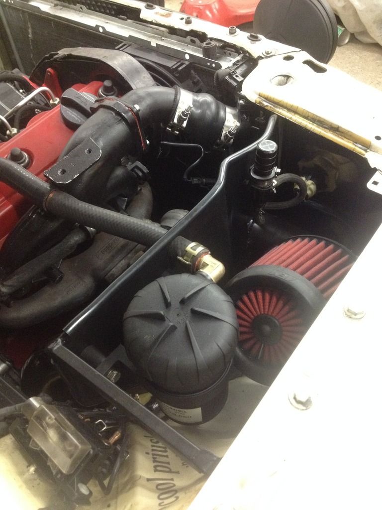

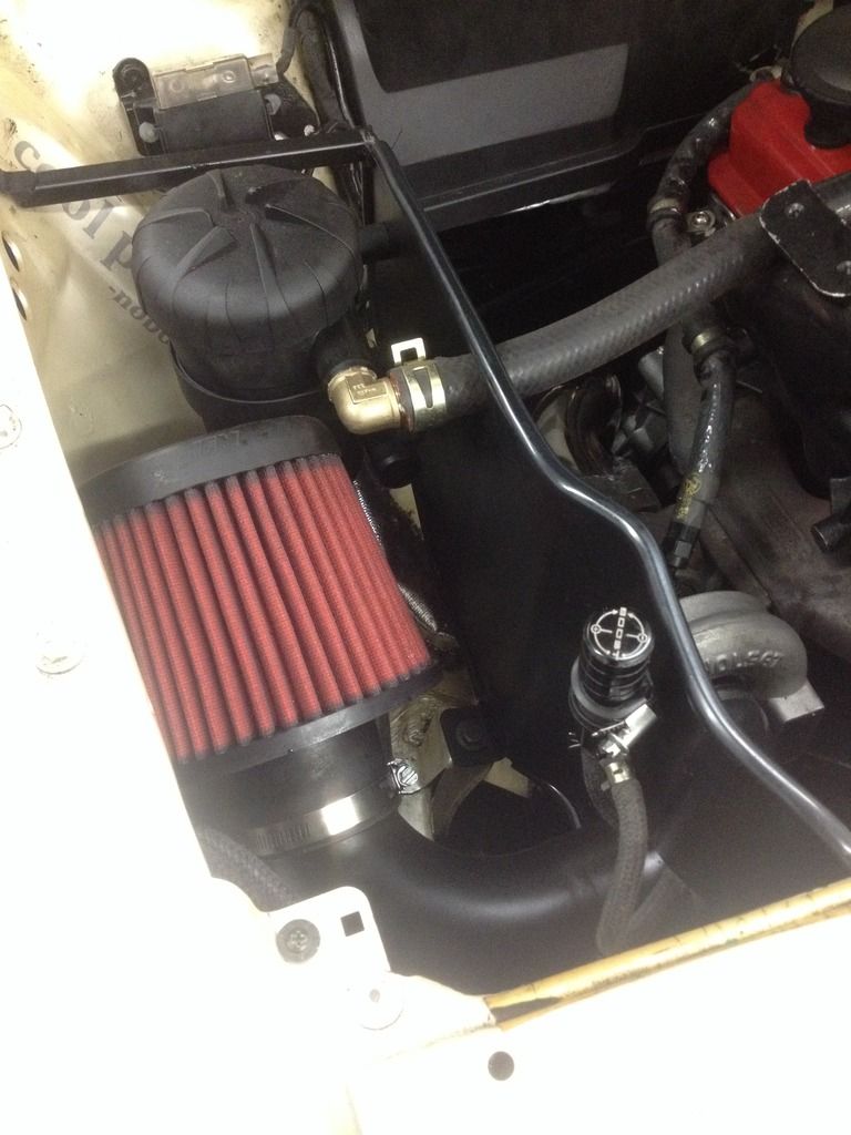

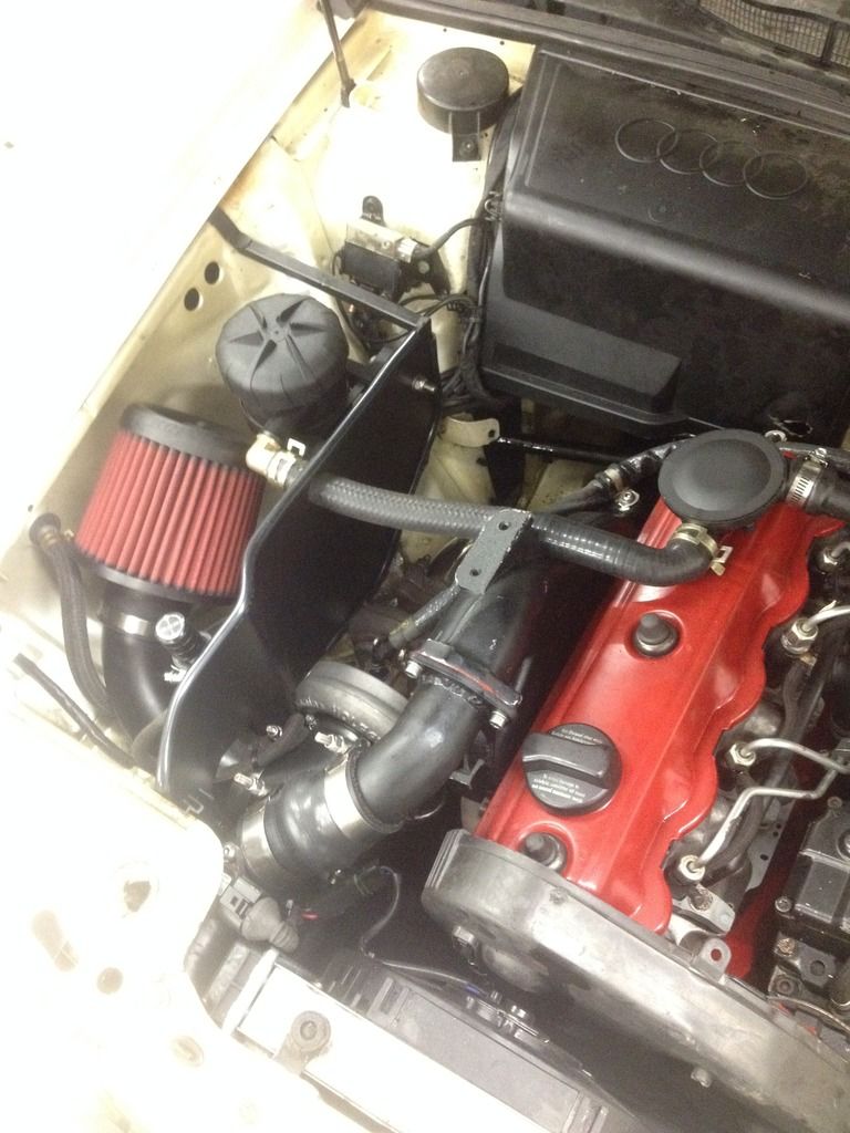

Here are some crappy pics of the intake I came up with. This box still uses the factory air ducting that brings air in from around the headlight, so it shouldn't suck only hot air. This little holset sounds sweet too, its pretty funnny to be hooning around in the snow with turbo spool noises, turbo stall noises and black smoke everywhere.
Finally got the car back in action, and switched to winter mode. Switched out the springs for a new set of H&R springs. Built a new air intake setup. Added a Mann Provent 200 catch can. Added a low point 1/4 turn ball valve in the lower boost pipe to test if any oil is collecting in there and drain as required.
Drove it around on the snowy dirt roads last night, shit i forgot how much fun these cars are. The diesel requires some clutch abuse to keep it sideways because the power band is pretty narrow, but it sure is fun.
Looks like my vacuum leak at my brake booster was the cause of all my oil issues. Crazy. I am getting zero oil out of the vent with the vac system capped off, and zero oil in the intercooler after a 30 mile beat.
