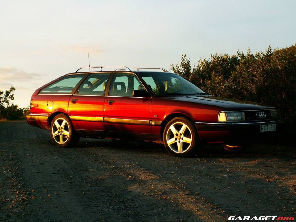

That or Ronal R28's. Both simple, yet elegant. (Photo credit crash1121 on MG)

Aktapod wrote:That or Ronal R28's. Both simple, yet elegant. (Photo credit crash1121 on MG)
Your avant?
Dmitry
Re: Kevin's 200 19v Project
I like those Ronals for a simple solution. They look good without being flashy.

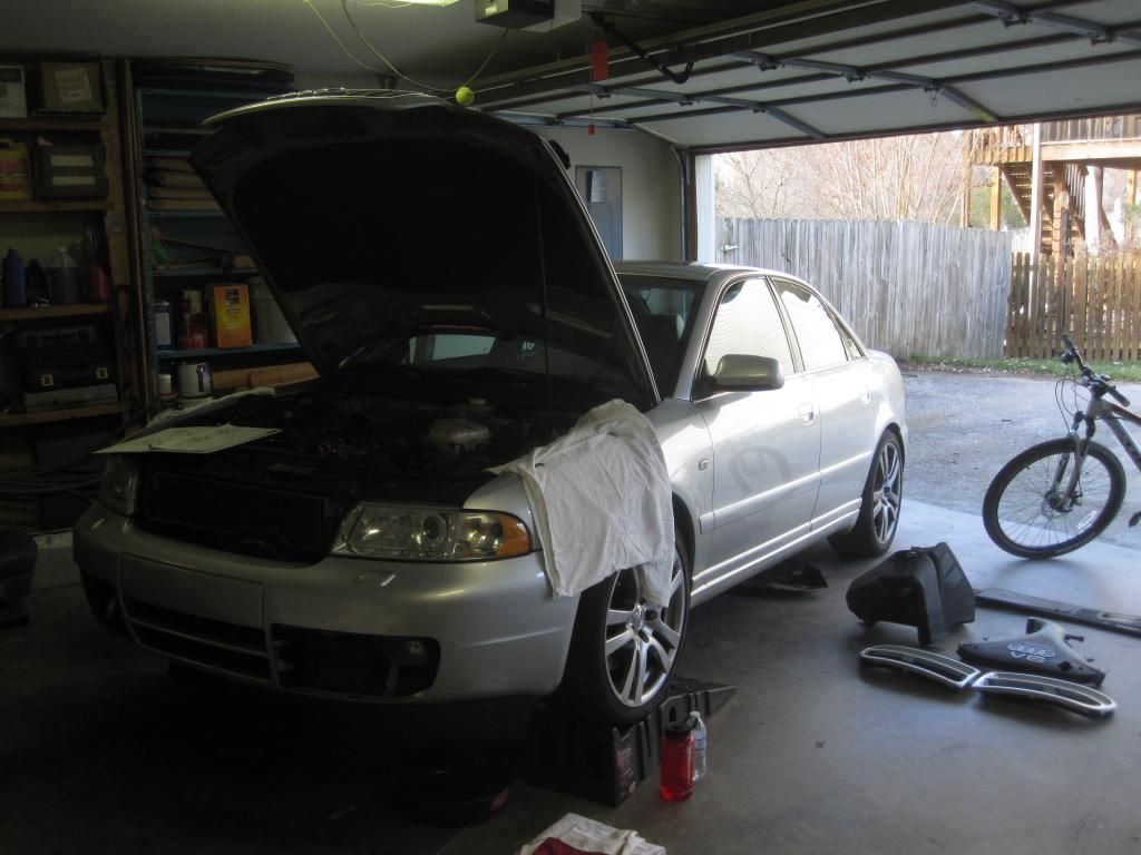

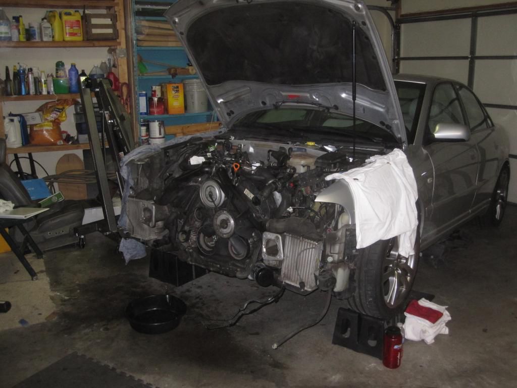

I'm know what you're all thinking: "Hey, aren't you the guy who writes really long posts about almost nothing? What happened to you?" Not to worry, I'm still here! But I've been really busy working on another project for my dad - his B5 $4.
Firstly, merry Christmas!!
Quick rundown on what's going in:
-rebuilt K04's with brand new BW CHRA's
-034 Motor mounts and snub bracket. Yeah, yeah, I know, but from what I've heard, these seem reputable.
-Full 3" SSAC downpipes
-APR tune and fueling
So pretty much the bare minimum to get the car back in running shape after blowing the old turbos. Sometime in the future we'll get proper supporting hardware, such as intercoolers, brakes, real downpipes, and suspension, but the costs of the operation had to be kept low, so as to keep my mother happy.

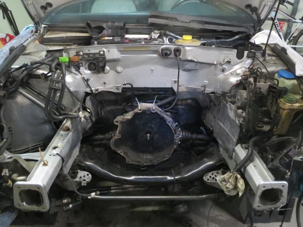

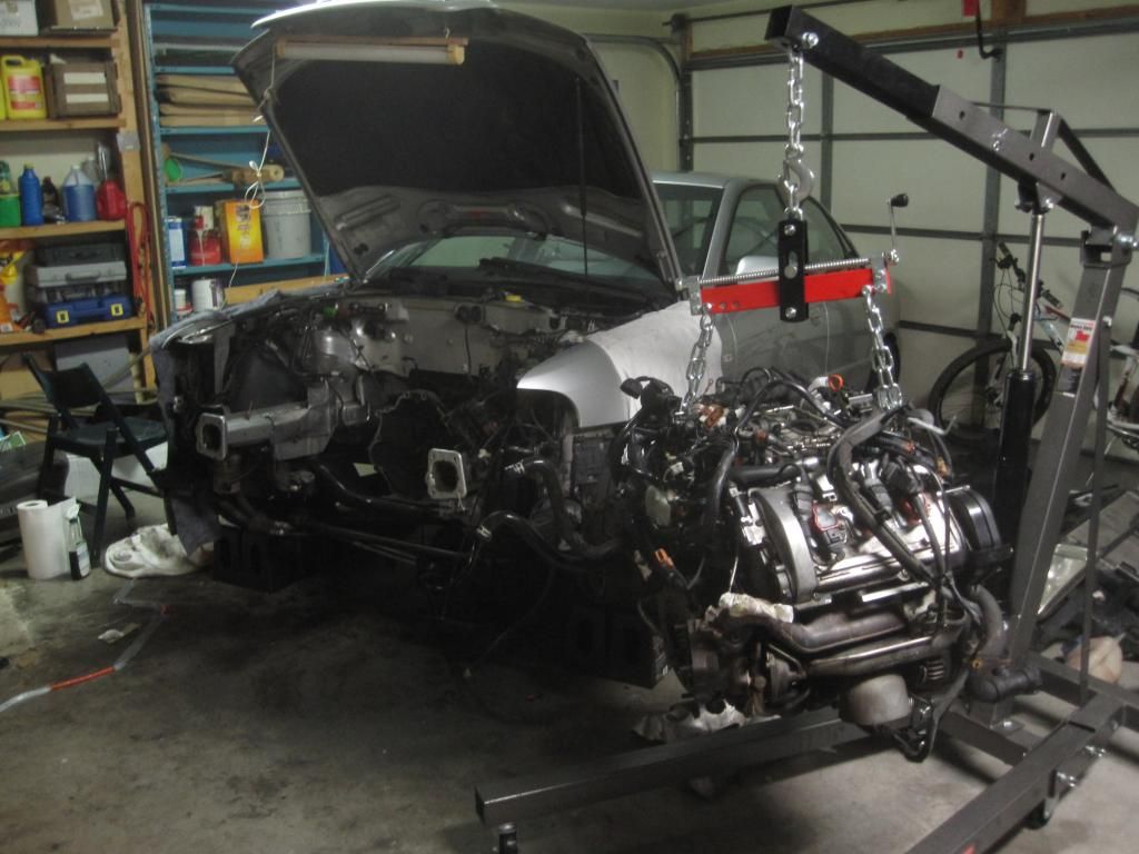

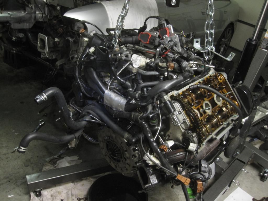

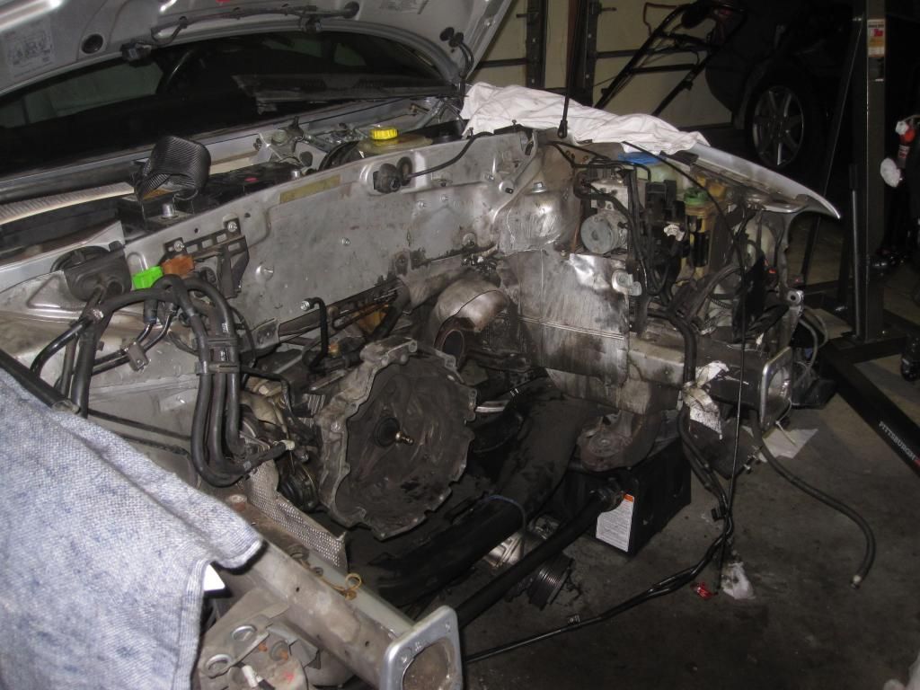

Anyways, never pulled an engine before, so I hope this this goes okay:
Ready to go back in! If all goes well (which it never does) I hope to have her running this weekend.
Re: Kevin's 200 20v + B5
Good work! B5S4 owners are masochists! :D
Good work Sven. I agree with Chris lol. How long do you have to put it back in?
