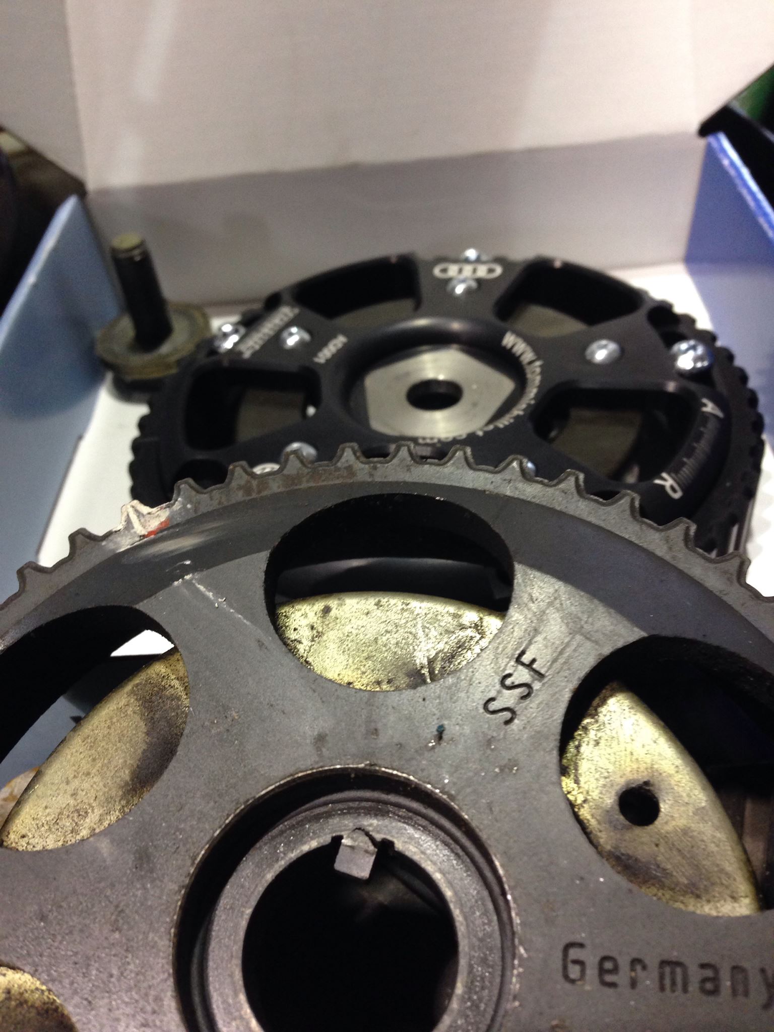

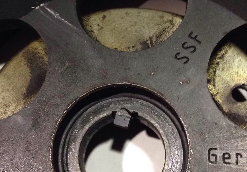

I touched the cracked keyway, and it fell off. I couldn't believe how close a call that was. I checked the camshaft for damage, and there was nothing but a little galling I corrected with an emery cloth. I replace the cam sensor and torque every little bolt down on the Tommi's gear, then set the final torque of the cam bolt to 48 ft-lbs. Happy with doing something right for a change... I head back under the beast. I get the inner CV bolts undone, and ready to be removed from the car for a thorough cleaning, inspection, and re-booting (Passenger's side was making a mean howling noise...) But before I dive into that can of worms, I decided to call it a night.

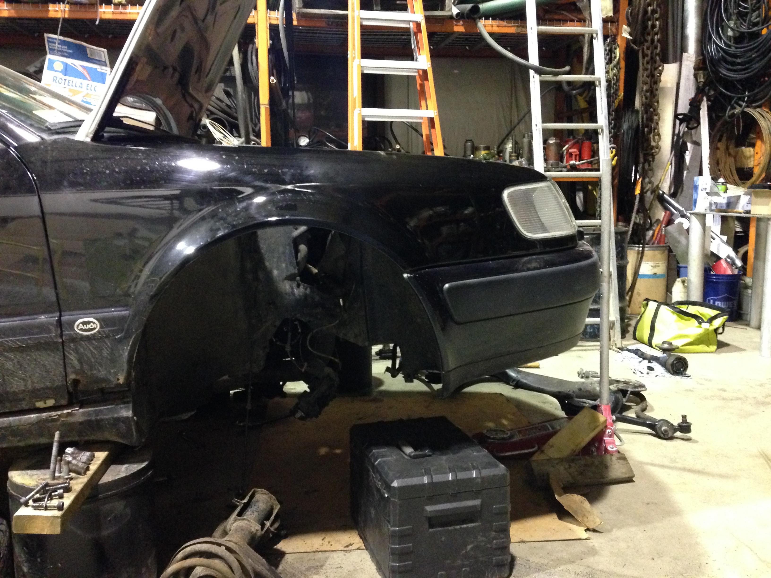

At this point, I'm ready to drop the subframe and front suspension down as one elegant unit... except that the ABS sensors are, again, hanging up the entire damn process. At the moment, they are the final umbilical waiting to get removed in order to allow the whole upright to go away. After the subframe is out of the way, out come the old, broken, nasty rubber subframe mounts and in go shiny fresh Thuppu Mounts. Replacing lower control arms is cakewalk compared to in the car, but those damn sleeves still present a royal pain in the ass. After getting the new LCA's taken care of, I put the subframe aside for a thorough cleaning before going in to the dirtiest job here...refurbing the CV's. After much protest, and a combination of the axle bolt trick and the BFH and drift punch trick, the two shafts are disassembled... the suspect passenger side goes first, and it doesn't look good. The first thing I notice is the c-clip is AWOL... and that half the splines outboard of the c-clip notch are stripped away, but the other half are completely intact. The balls, the cages, the inner race, all have serious galling, and I am finding pieces of axle and c-clip throughout the grease I'm removing...

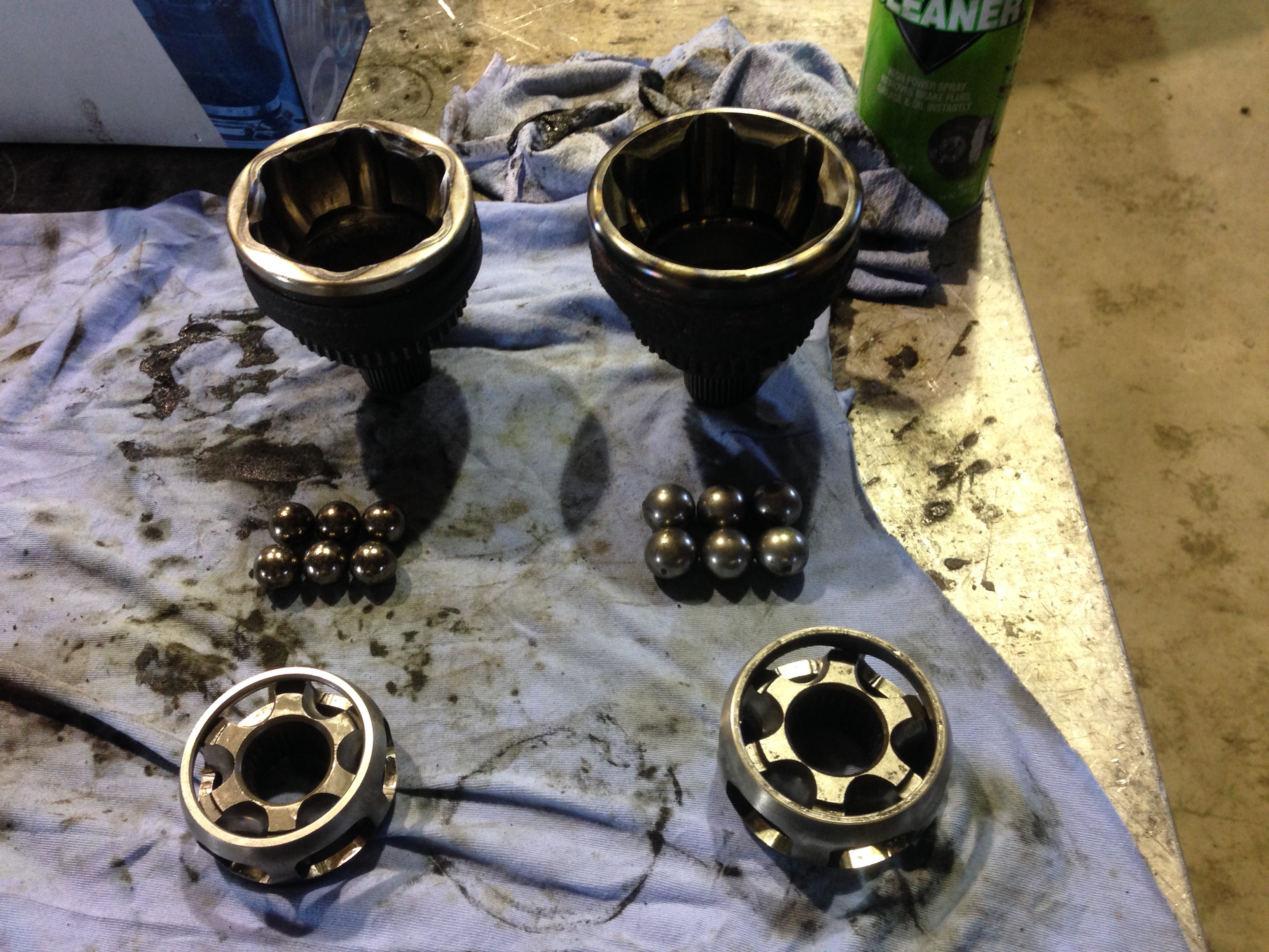

Does this look right to anybody? Again, frustrated and baffled, I leave that be for now and move on to something I know I can do...

Sounds like a solid weekend of repairs, however frustrating they may have been. Good save on the cam gear, although I wonder how you took it off (impact, no impact, cam lock, etc.) and if it may have just sheared then. The key isn't supposed to hold any torque; it is imply for indexing, so it may have been just fine as long as it was properly torqued onto the nose of the cam.

I'd spend the money on a GKN outer joint and scrap that odd one. Maybe someone has a used one that is tight you could have for less than a new one.

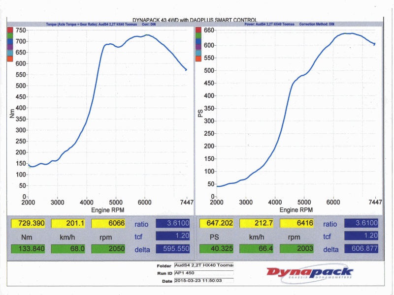

Dmitri sent this to me yesterday. 2.2l with HX40 super, Euro 99ron with heavy aquamist methanol injection, stock ecu tuned speed density.
- hx_super40_2point2.png (308.06 KiB) Viewed 36101 times
Re: Matt's billet HX40 Super URS4: That Got Interesting...
I'm gonna need rods.

I thought of that but the entire axle is thinner and wouldnt accept a typical gkn rebuild joint. I have to find a used OEM PS axle since literally every place ive called has said "nope, nothing in stock, sorry..."ringbearer wrote:Looks like you got a lot done.
