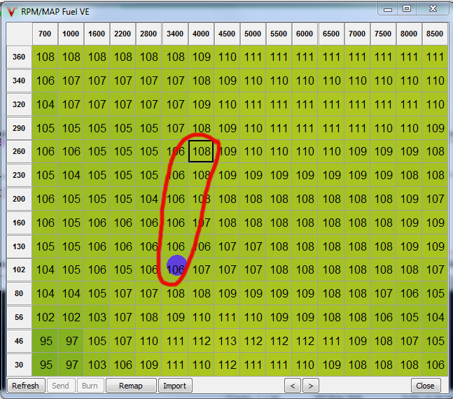

That's pretty sweet. I have a 3rd gear log here so not apples to apples unfortunately but at peak torque (ish) you're getting an extra 4psi on me. I imagine that in 4th we'd be pretty well dead even as it sits. BUT, that timing increase is going to help A LOT so I would expect your spool to improve.
Fatten up fuelling from 3500-4200. It should help spool a little and give you moar torques. The cells circled in the attachment.

Re: Justin (bangetek) 1996 UrS6
Thanks for the suggestions. any explanation of why i need a fatter tune under vacuum? It was really flat when tuned for 91ron however i did go back to marks suggested injector settings... maybe just getting into partial fuel cut down low? should i even be worried...
Well it should need more fuel everywhere... is it running bad? Misfire or fouling plugs? If not then that's just what it needs i guess.
Hmm guess it just needs a bit more down low
replaced the plugs over the weekend and no signs of rich/lean or detonation. I gaped the replacements too narrow (hard starting) so i will have to address that.. other than that car runs great
