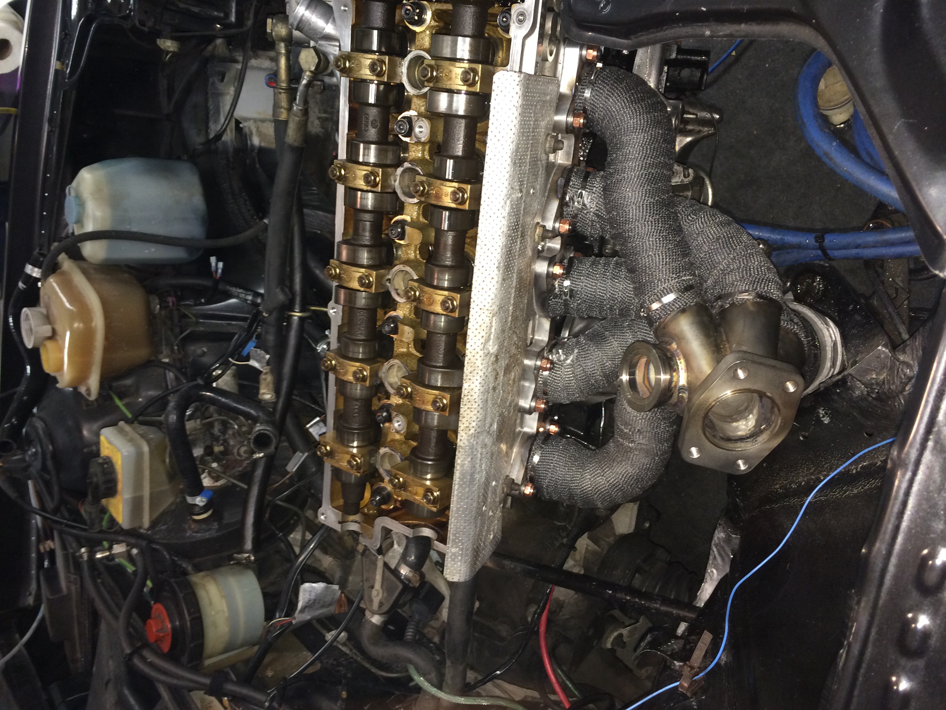

Re: Audi S4000 - Alaska
Making "headway"

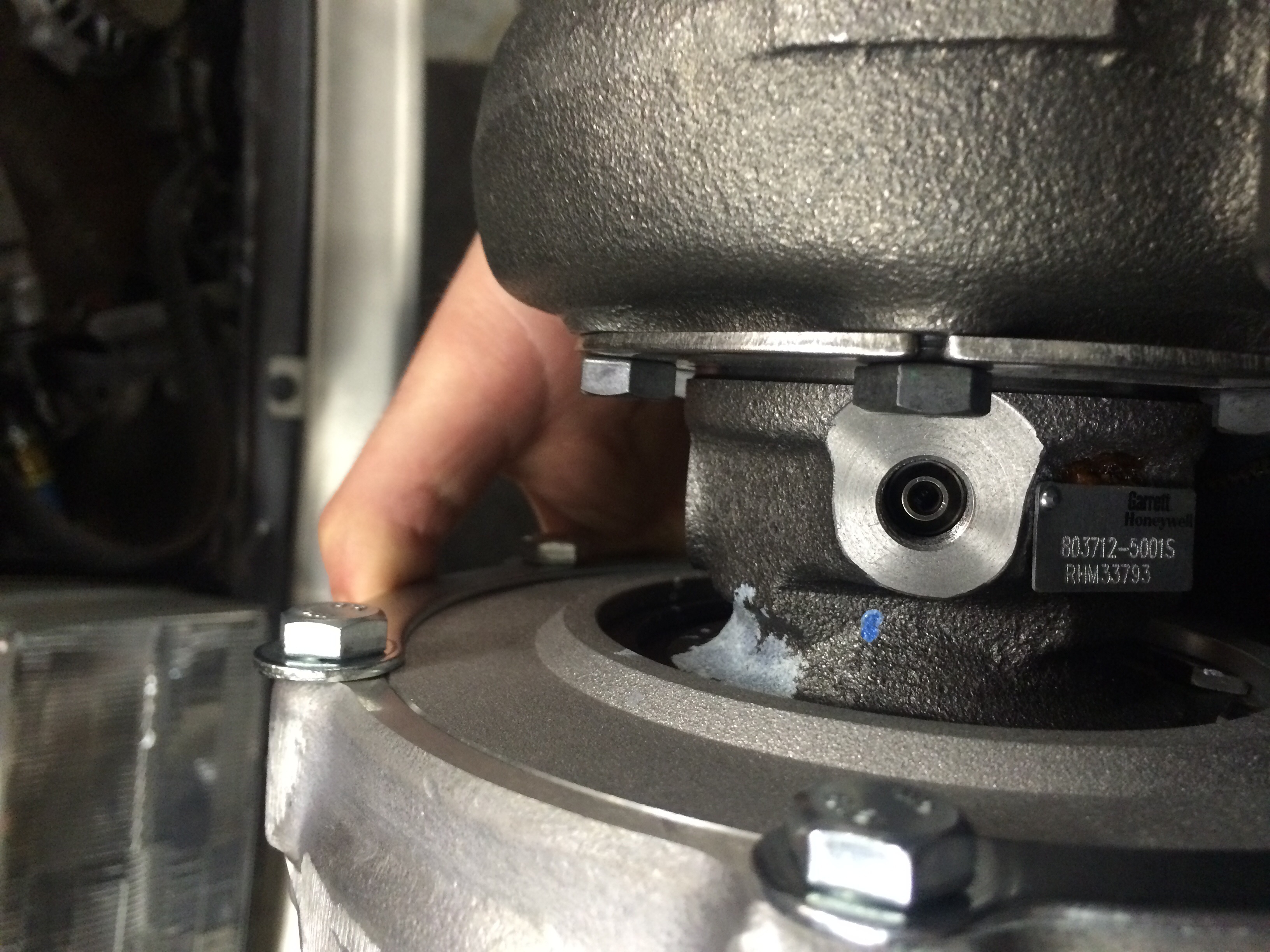

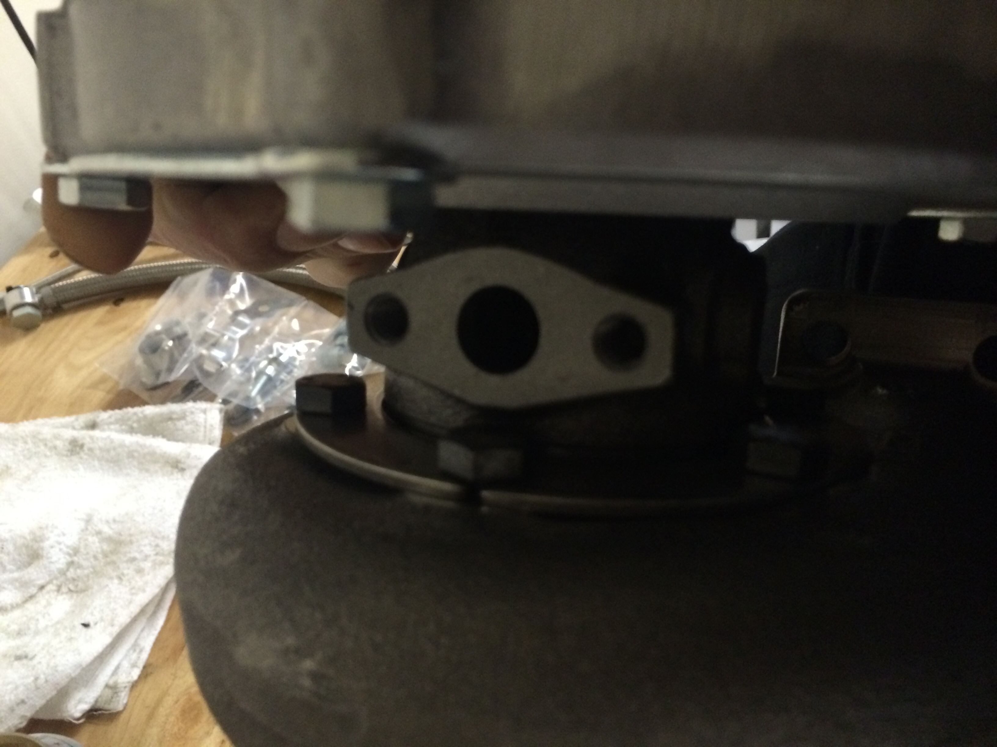

I have a question for you: How do you know which connections on the GTX housing are the oil supply/return and coolant supply/return? I need to get this thing oriented right and can't even figure out what hole in the turbo goes to what.
Oil inlet is the smallest and should have a restrictor fitting, oil drain is largest and needs a flange, use -10 hose at least.
Is this the oil inlet? What is that little piece on the inside? It's not a built in restricted is it?
This is the smallest hole on the turbo
- image.jpg (1.64 MiB) Viewed 52758 times
And then the opposite side would be the drain. It has provisions for a little flange

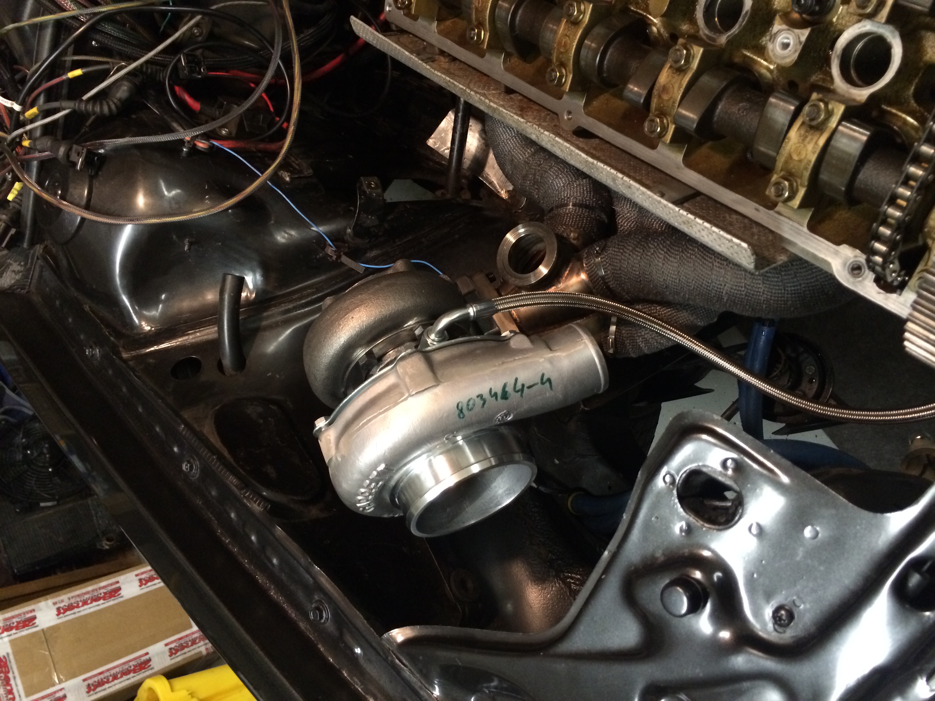

Like this
Yes, that's the inlet and drain. You need fittings like these

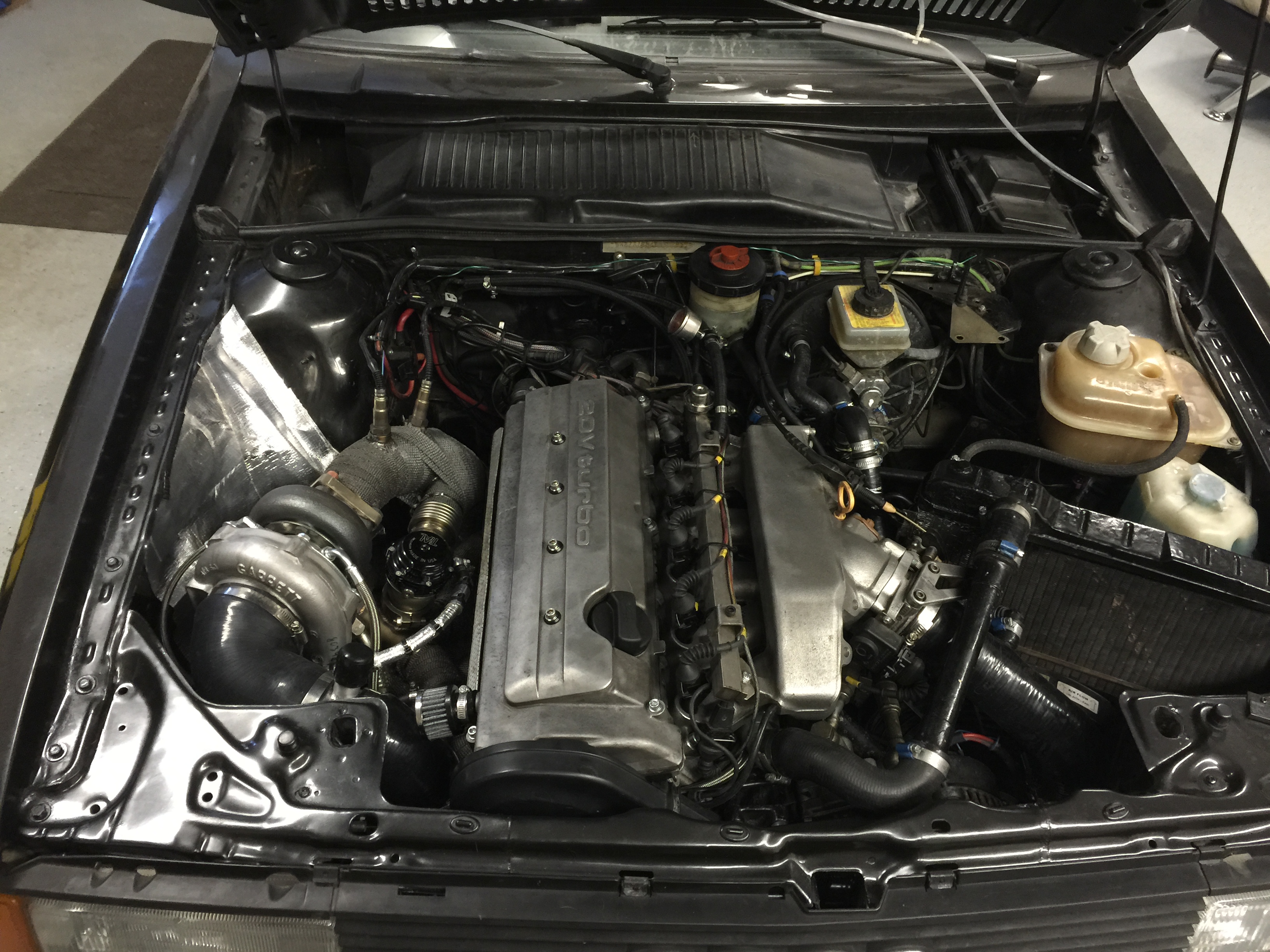

https://www.youtube.com/watch?v=ZHdbKgq ... rSrf_AXx_g
I am an idiot... "That's a pretty good idle"
All suspension/bushings/and mounts being done starting tomorrow.

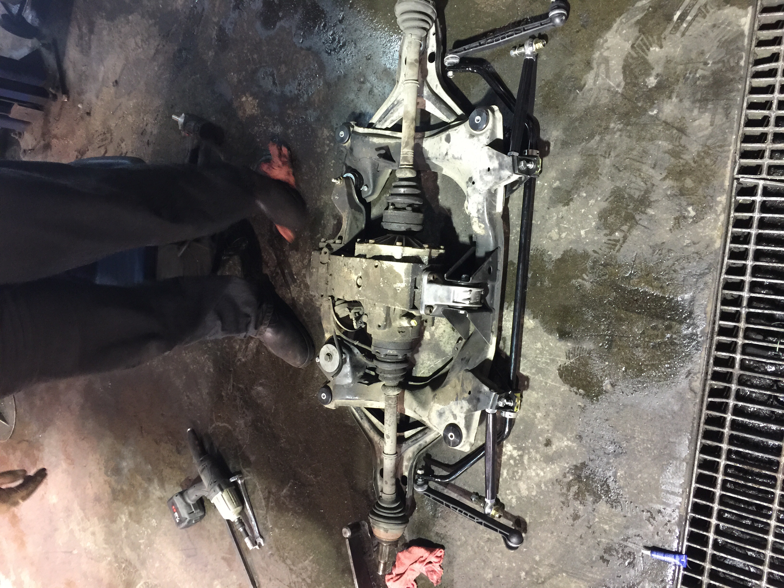

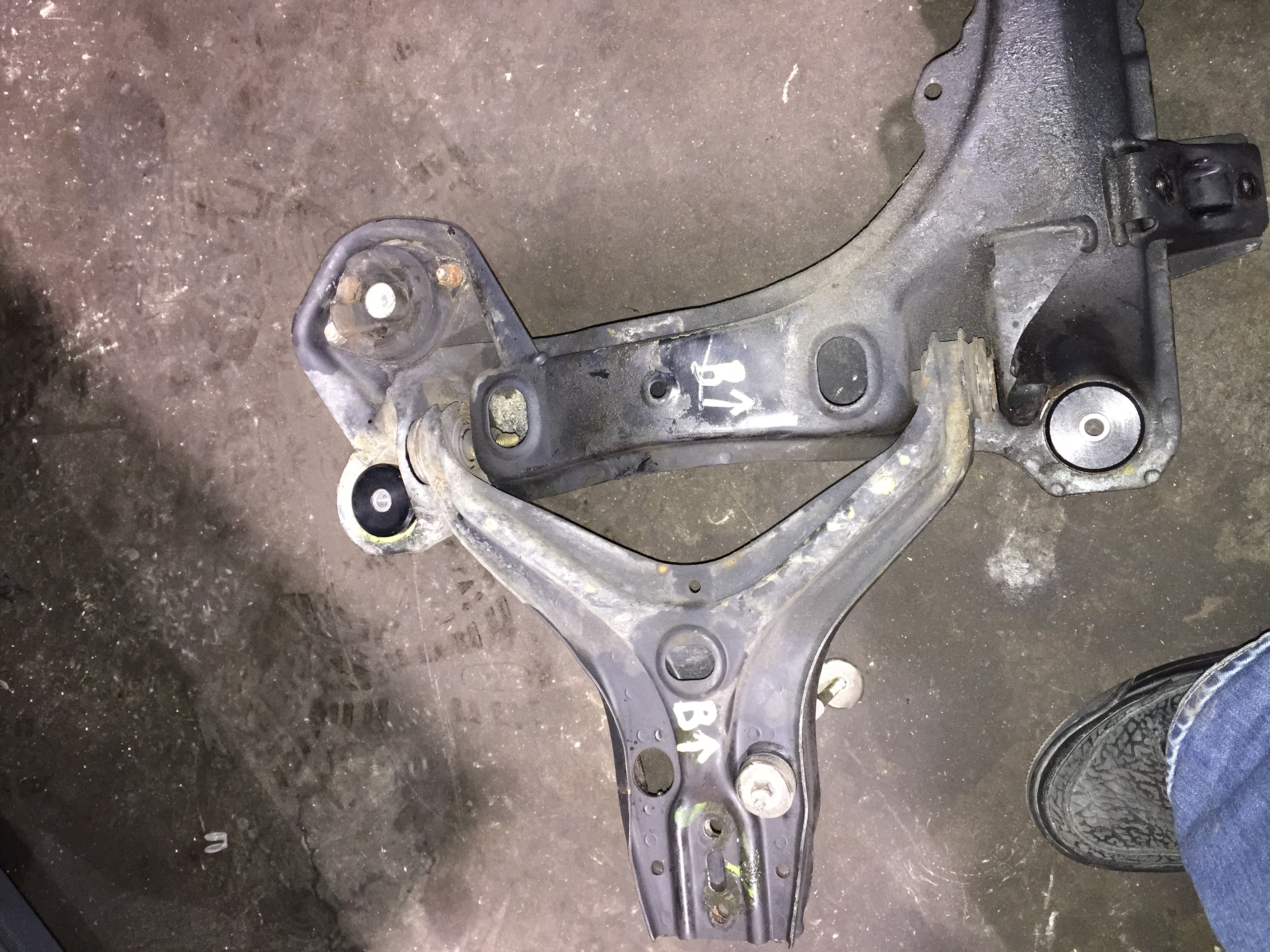

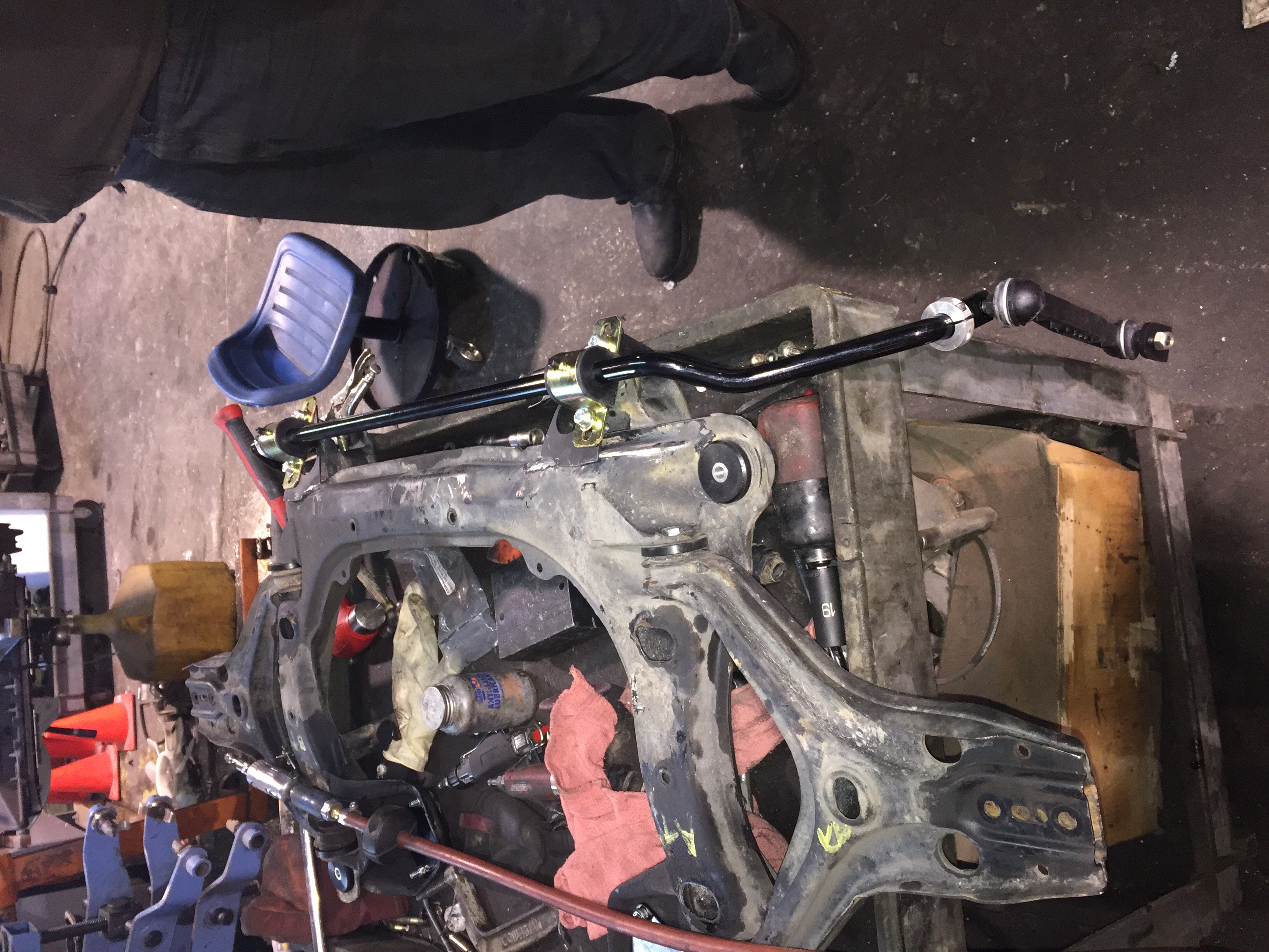

Subframe bushings and tranny/diff mounts ala HERSH performance. Subframe bushing were a dream to install. 2 piece setup, awesome.
Installed a rear sway bar and replaced everything that can be replaced under the car.
Installing my coil overs tomorrow then I'll report how awesome this thing drives.
Nice. Sometimes having a long cold winter can have it's benefits. My 4k was so ridiculously responsive with all the solid stuff and coilovers. Every little input yielded an output. You'll love it.
