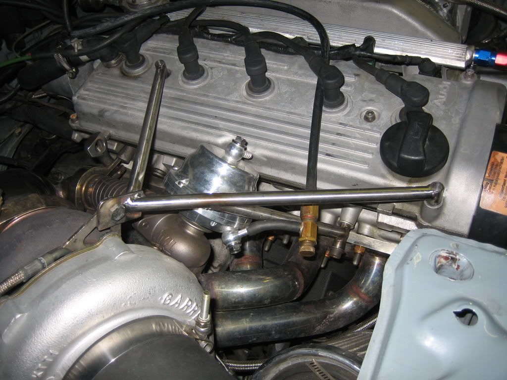

Hank (Shavedquattro) has one of those and running his GT30R on it. Before he installed it he reinforced all the welds on the inside along both flanges. I would have someone do that for you if you can't DIY. Other than that, it seems like a nice piece and looks good.
good tip! thanks, I'll see what I can do
that header is slightly different from the header I use, but it looks like the same quality. If you do not brace the wastegate better, you will get cracks on the collector. IT is too much weight on that wastegate, especially if you plan on using the Audi gate. the weld on the top of the turbo inlet flange also is prone to cracking if the header is not braced.
This is mine
All the flanges are not even close to being flat. THe head flange is probably 1/4" out or better. They all needed to be milled flat. I would really recoment ditching the audi wastegate flange and going tial. The Turbo inlet flange is not threaded which is a real pissoff. I cut mine off and ordered a stainless flange from Javad, and just welded it on.
So that is the bad news. The good news is that the runners are pretty robust, and the head flange has not given me any problems. The best news is that the I am making a buttload of power with the header...
Unless you have access to welders and mills, it may be costprohibitive to fix these headers. You could easily get a 200 dollar machining bill, and another 150 dollar welding bill, which makes it a 600 dollar header all of a sudden.

gotcha - yea I plan on bracing it and getting rid of the triple K flange. I'll give the tial some thought, but the stocker should work just fine for 350-400whp, right?
Good news on my part is that I do have access to a TIG and some nice milling machines and good friends who will either guide me through it or at least let me watch.
I'd rather do it myself though :-D
The stock gate will work just fine. I recomend the tial because it is half the size, half the weight, half the bolts to have to get through... And the best part is that you are able to get stainless flanges for 10 dollars vs the audi SS flanges that are spendy. Springs are readily availible in 2psi increments, nad the diaphrams do not rip or have problems.

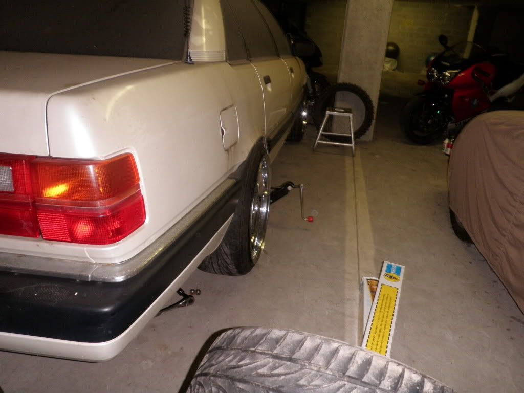

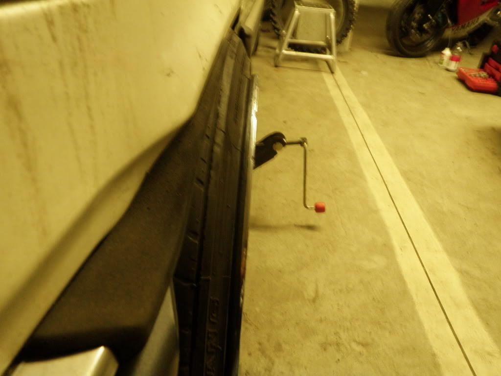

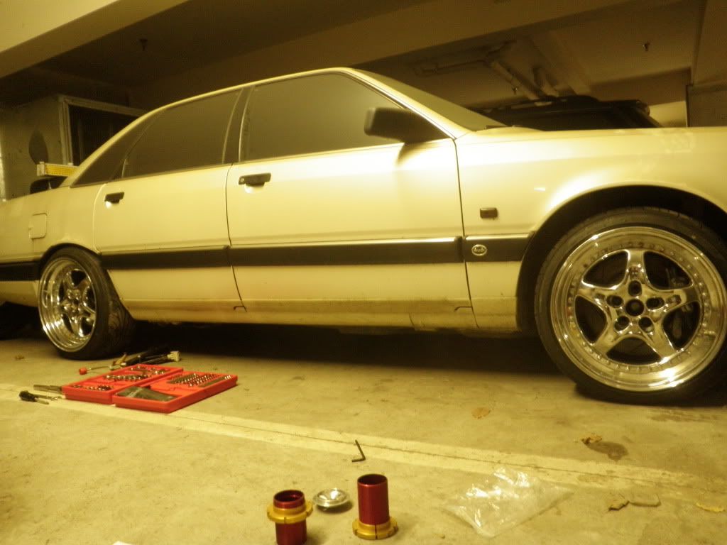

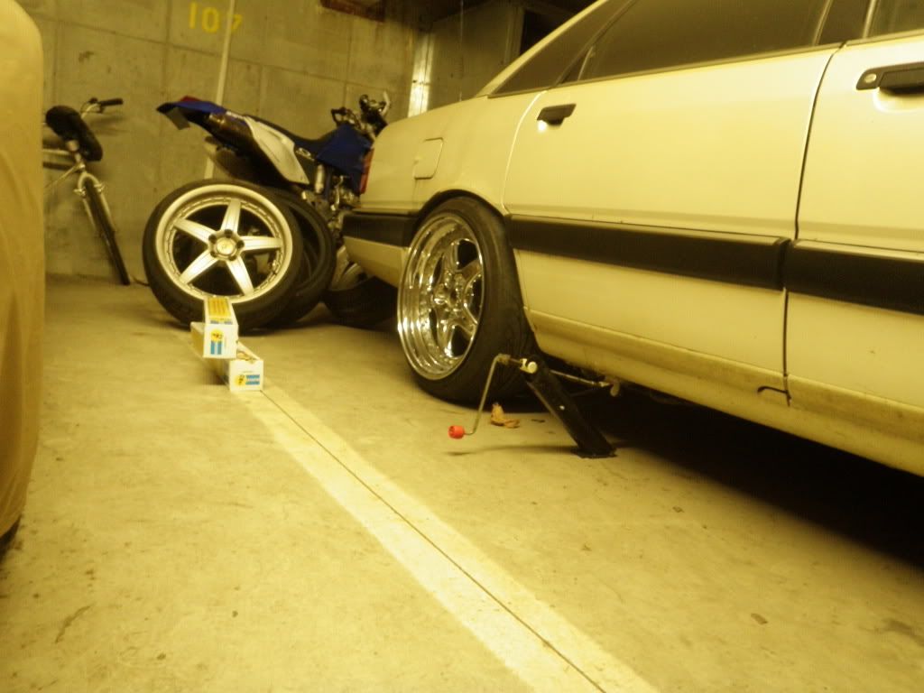

Ok, small update - got my bilsteins in so I finished with the rear coil over setup. I also began the fight to fit the wheels.
Yes they are stretched like mad, no I don't care if you hate it :-)
I'll hopefully get the front end taken care of tomorrow and lowered down 8)
Oh man...they look great. Can't wait to see it all done!
What are the wheel and tire sizes again?
I'm still just waiting on adapters to get mine on.
Sizes are: 18x8.5 with a 215-40 and a 18x10.5 with a 225-40. Offset is ET20

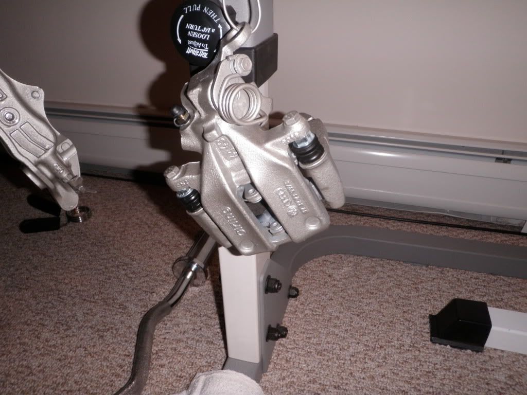

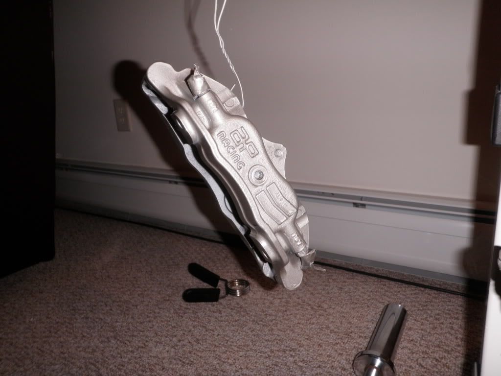

FIDDLE STICKING CRAP!! Rear calipers are expensive for this thing!
Anyway, got them covered up and looking much more presentable - going to go over the AP logo with some black paint after ample curing time
Just wanted to say one more time how effing awesome this looks
8)
motivation for more pics!!!
derrish_vulf
Post by derrish_vulf »
holy moly you just turned it up to awesome!!
Looks insane cant wait to see it lowered!!
