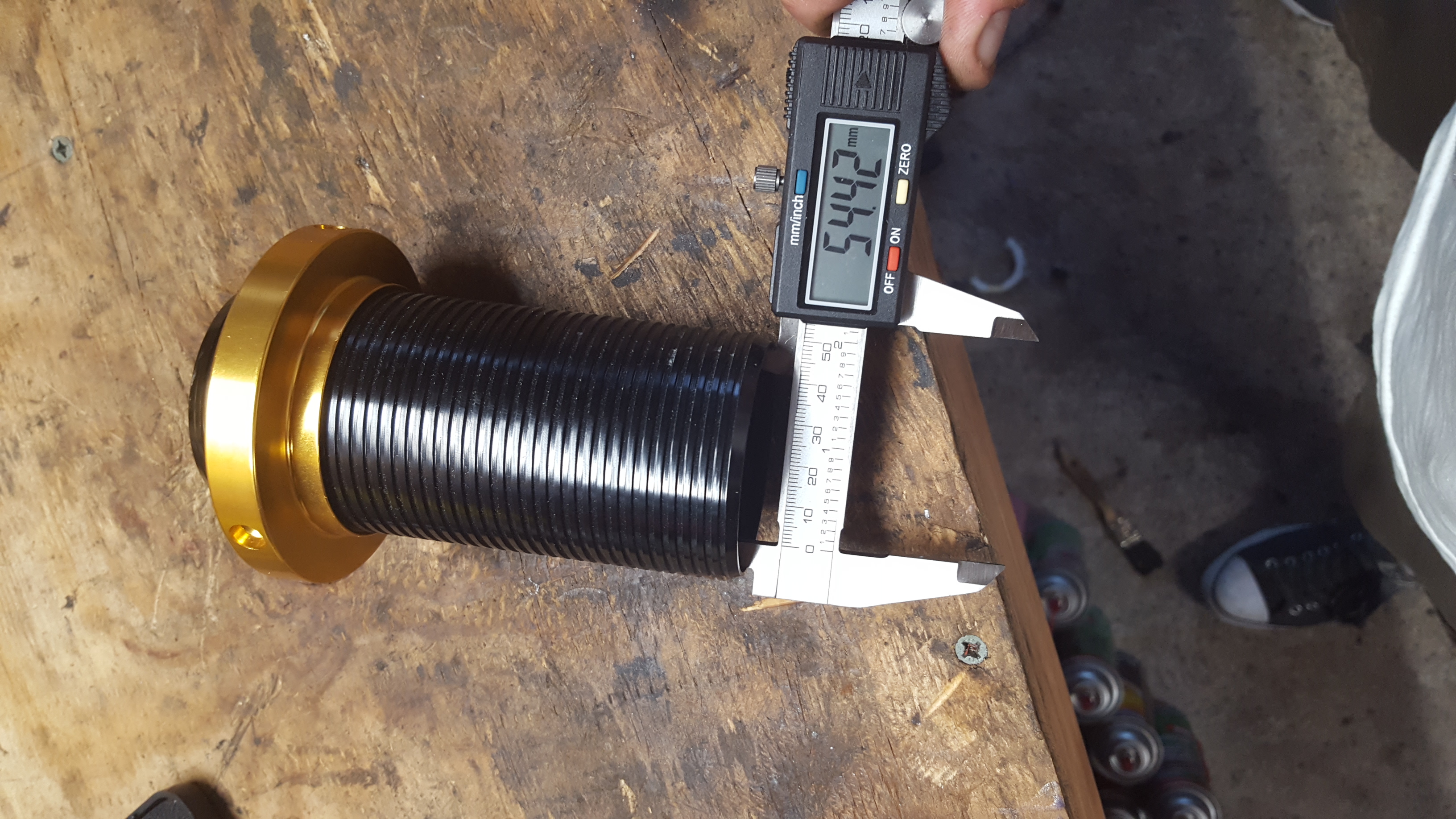

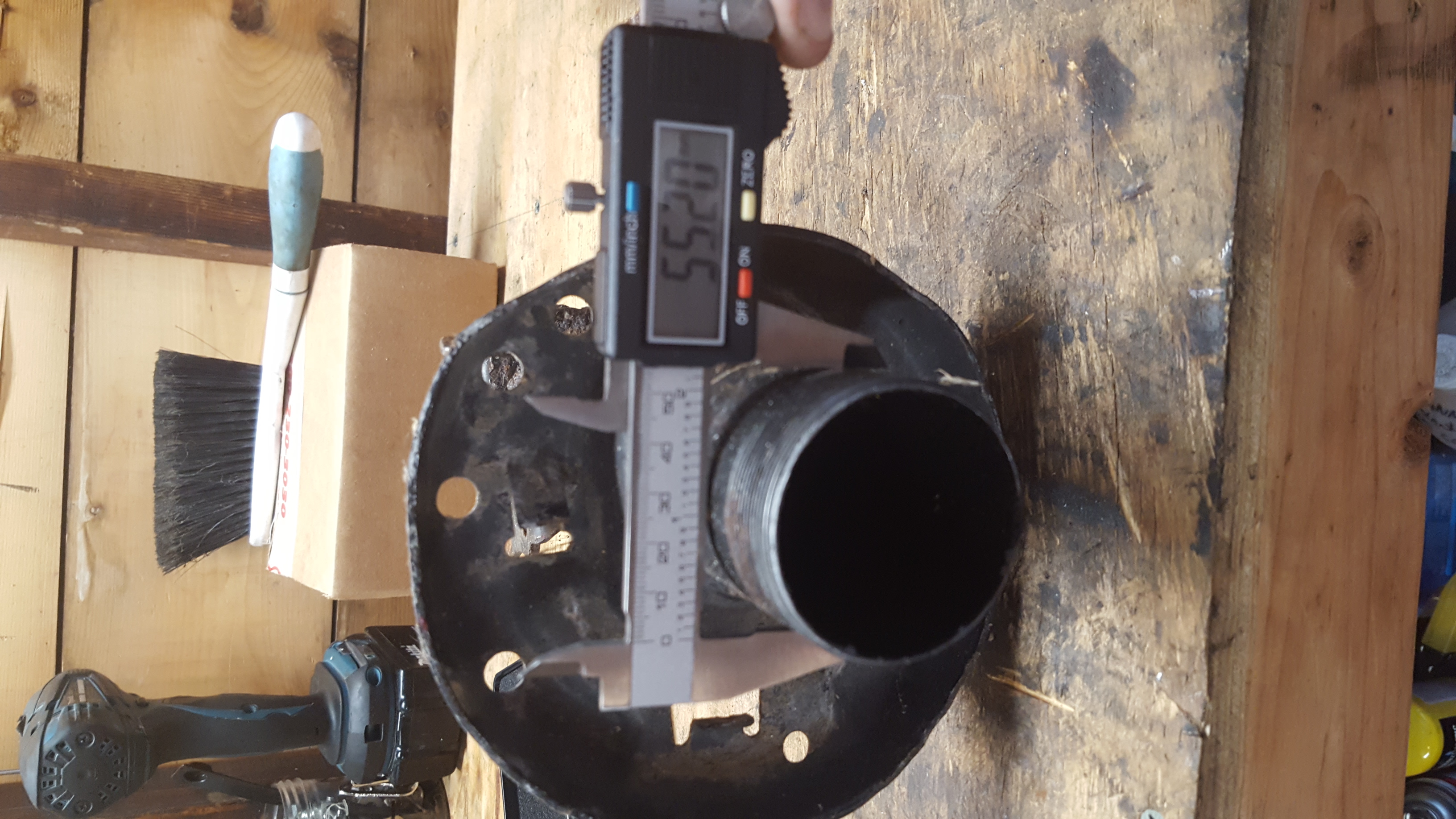

Im finally back on working on my coupes after a longer break and instantly runned in into little problem and wanted to ask for some wisdom from You guys. I have the coupe uprights and bought the sleeves from a1 and they dont fit on my up rights. They are tiny bit smaller. The question is should i look for another sleeves or maybe i could use urs4/6 up rights and built the coilover using them for the coupe. The coupe will get wide body later and i think using the urs4/6 up rights F/R would make it easier with custom lower control arms to offset the diffrence. Please let me know your opinion.

Re: Aarons NEW Coilover DIY, B3/CQ stuff.
To get the sleeves to fit you will need to grind down the housing some. I have done this on many uprights with no ill effects.

The sleeves won't pass the treaded area on the housings. Would have to take bit there which I don't think is good idea will post pictures when I get home.
The sleeves should easily pass the threads. Check to see what the inside of the sleeve measures. It should be right around 2.170" iirc.

Will check and post my results
DE80q wrote:The sleeves should easily pass the threads. Check to see what the inside of the sleeve measures. It should be right around 2.170" iirc.

Zaworek

Post by Zaworek »
hey going back to my previous post regarding the sleeves here are the images along with the measurements

Post by Rabbitracer43 »
Regarding the size, I had an issue with this as well, a1 is where I got my sleeves, one set wouldn't fit, so I called them and they sent me another pair and it was perfect, a very slight friction fit, it should be 2.170" which is 55.11mm
