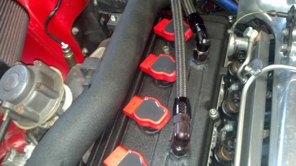

The other dilemma I'm having is buying coils for the AAN conversion. Viable options are the tfsi coils, but for nearly the same price I could get LS2 coils, but then the spark plug wires become an issue...
Re: Eli's 200 20v Avant, it's about damn time
For what it's worth, Marc told me we're going to run the tfsi coils on my revver engine... I don't see any advantage to LS2 coils.
The only reason I went to the LS coils in my conversion was because I liked the 20v turbo little spark plug wire cover that's on the 3b.
In hindsight, it was a waste on my part, but oh well.

That's what I'm thinking. That said, the 3b cover doesn't look bad with the coils on it

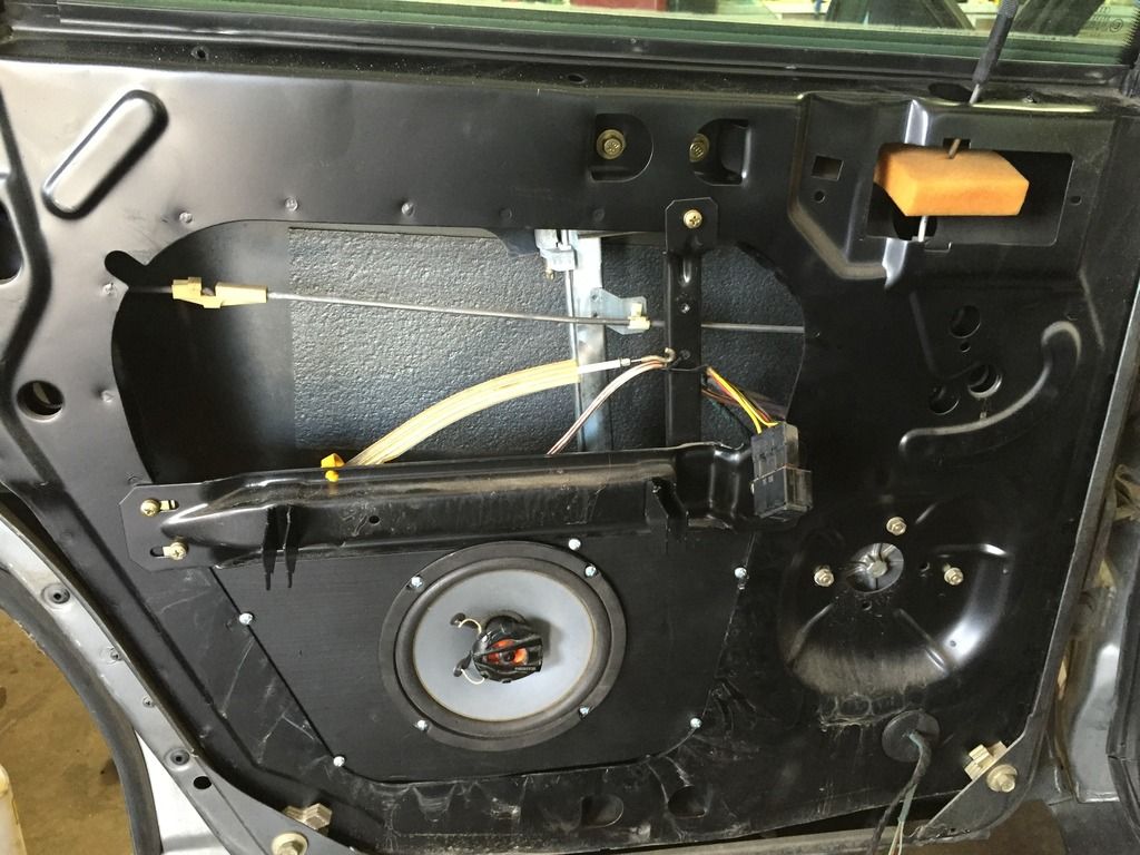

Got most of the way through installing my stereo system.
Didn't like how the factory speaker mounts to the flimsy door card, so I built a mount, there's a ton of room in the rear doors
The speaker won't line up perfectly with the hole in the door card but it's pretty close, I'll just get a grille for the door and it should sound decent.
I just mounted some 3.5" speakers in the dash and I'm still working on something for the front. If there's room I'll probably just do the same thing I did in the rear.
Finally a picture of the avant rear door like I requested! You think there is room to make a custom little enclosure there? I don't mind that it doesn't line up perfectly with the door opening because I intend to only use this for midbass.
