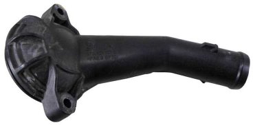

And another question: has anyone ever checked to see if a thermostat cover from an older I5 can be used on the OE 07K thermostat housing in place of this one?
Or... does someone have an older outlet around they might be able to take some measurements on?
It looks close to correct to me, but I don't have another cover to test with.

by audifreakjim
It's definitely an issue. See below what I am using with a remote thermostat and electric water pump so I can use the stock radiator location. If you plan to use the stock accessories on the 07k, you either need to cock the radiator like hank did or use a front mount radiator. For both you can just fab up a coolant line to work with the thermostat cover. This is why you almost have to have a tig or welder capable of making these things. It's all custom. Image
