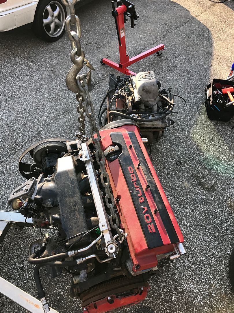

Yeah. it's the Maserati Engine.
Here's it the day before in the truck:

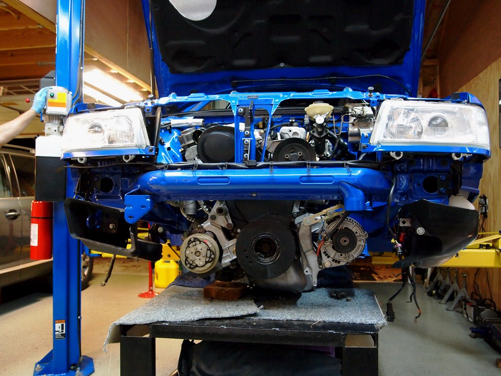

Re: Ben's 95 90 Quattro - 20VT swap questions
I think the deal with v-belts in small chassis builds have more to do with the AC, Alt, and fan being on the drivers side in the C4:
This will not work with a side mount rad, so Audi moved things on the ABY/ADU:
Saltinot's RS2
Saltinot's RS2

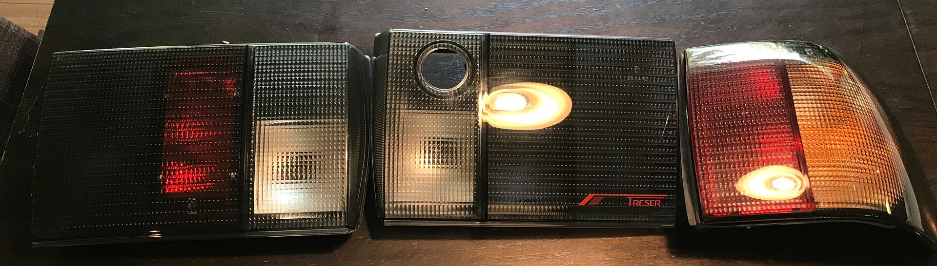

Long time no post! Most of my time and money has been put into the Maserati Biturbo I picked up last January that now finally runs.
I did find that last tail light:
I love the look!
Anyway, I finally have a plan and pulled the trigger on some go fast parts for this thing!

On the brackets, I guess if you have all AAN stuff you don't need anything from 7A to get PS pump setup because that's included in the AAN brackets. I think you'd still have room for the radiator (I did but mine was "tilted ") I ran a stock line but with an steel AN 45 degree fitting out of the PS pump to get angle the power steering out line closer to the block.
If you need to buy yourself room for the AC you can always get a fitting to convert the oil cooler inlet and outlet (the two fittings at the pump housing) to an which would allow you to make your own hoses and move the oil cooler somewhere else (say behind the core support or by radiator). M18x1.5 threads to AN
