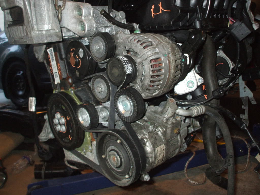

Ah, I think I figured out what caused my confusion.
In this photo:
07K belt setup DSCF9921.jpg (157.16 KiB) Viewed 116181 times
...I thought the pulley in the upper left area was the PS pump. But maybe it's the water pump?

Yes, the most upper left pulley is the water pump.
