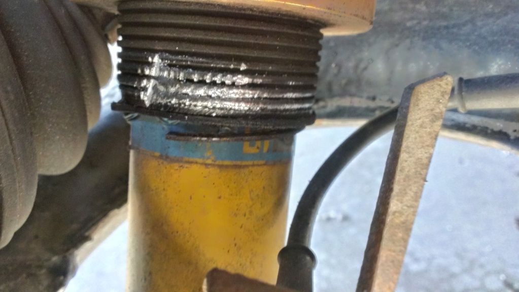

Here's how tonight went.
This might explain some play in the rear suspension...
Taking my time and pulling the entire rear subframe. Need to pull the differential but i'm afraid to do it by myself so that will wait till a buddy is around
Parking brake never worked, or actually worked too well and would lock up. Tried rebuilding but with no avail a few months ago.
New calipers, bushings, seals, mounts, hopefully shocks, springs, and coilover parts as well.
Next project is the same up front except pulling the transmission and putting in a Southbend Clutch.
One problem I'm facing tonight is the rear wheel speed sensor, any tricks or tools to get this guy out???

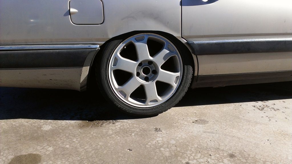

I like BBS alot, but that is some $$
I'd like to get 16-17" and run a lower profile tire. I like the fitment it has stock, but wouldn't be against a little more tucked
I'm only doing the rear coilover setup now, same helper spring and needle bearing needed back there?

You could use a helper spring in the back for sure, but the needle bearing is not needed. Of course, you need a spring coupler as well (just a piece of metal which holds the normal spring and the helper spring concentric to one another). These things aren't necessary, but they are nice to have. It'll help avoid clunks and will avoid the spring rubbing on the threaded sleeve's threads. Also, do not cheap out on the snap rings. They are like $10 from Acron I think. Make sure to get the ones mentioned in my DIY. Phil can attest to why you need/want them
I think you should go for some 17's so you can fit decent brakes if you want to in the future and the added sidewall rigidity is nice. The fenders on these cars are big enough too, so 17's are good for filling them! Some BBS LM's would look awesome.

I got some MAAAAAD low goin on
The stock shock will have a groove with a pre-existing ring already in it that is MUCH smaller than it needs to be. That rings needs to be removed and the Akron ring needs to be installed into that groove. I didn't comprehend that and had the akron ring on top of the ring that was already there. Somehow it lasted like 15k miles. But once that small ring let go it destroyed the akron ring and allowed my spring perch to rub against the axle and that corner of the car was essentially just sitting on the bottomed out shock.
Sucked.
It somehow DIDN'T rub like this either. Hah.
Sucked.

pilihp2 wrote:I got some MAAAAAD low goin on
Gotcha'
I will make sure to order those snap rings! Haha
Luckily that didn't damage anything else!
Called to order. Part #3100-0200 I guess has been changed.
Will update the actual part number when I get my parts.
I suppose it's meant to be 2" ID snap ring?
