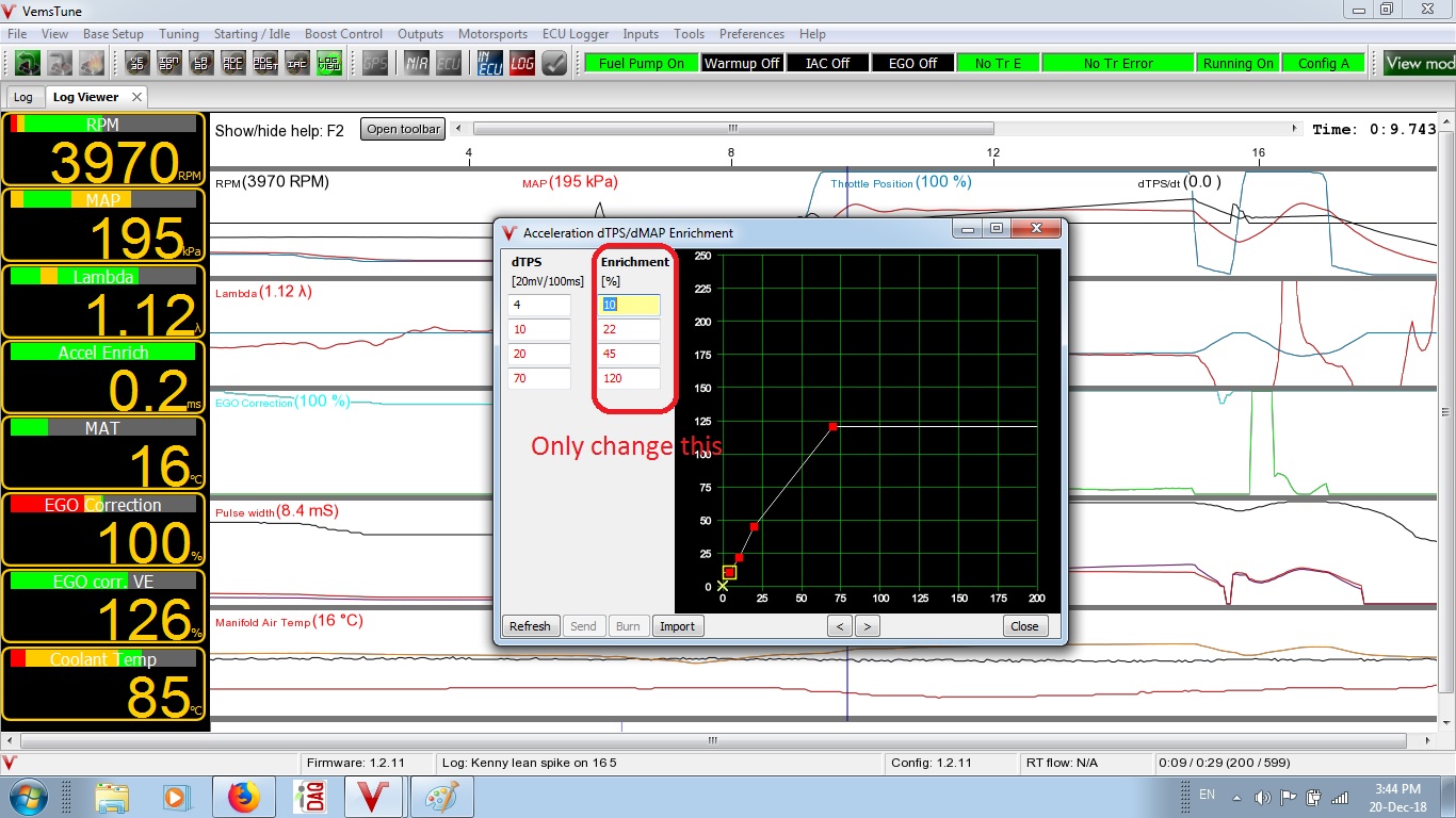

That lean peak is partially Accell Enr and incorrect injector ramp up. Looked through your config and noticed you changed strategy to simplified.
I changed that back to traditional with my injector settings, which work well for me. You changed afterstart cycles to only 16. That might be why it does not maintain idle. The stall on throttle off, might be not enough timing below the idle RPM. I have added 3 degrees to "catch" it at 700.
If you could make a log of about 10-15 minutes it would help. Letting it idle to get to about 50C coolant and then drive. An easy drive. No flooring!
In order to tune AE, you need to just press the throttle and hold it for 5 secs or more. That way the fuel stabilizes. Not on/off. Try small to medium throttle changes at idle, 2000, 3500rpm.
I have made some edits. You said my AE settings before did not work. Was it too rich or lean? Anyway, try this again.
kenny #15 changed idle and ego settings V2.vemscfg

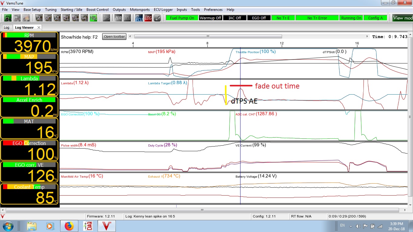

That lean peak has nothing to do with your compressor wheel. It is just injector and AE settings. Your AE settings don't go high enough. Highest dTPS you have is 26, while when you mash it, it shows 66! That is why you go crazy lean! See pictures.

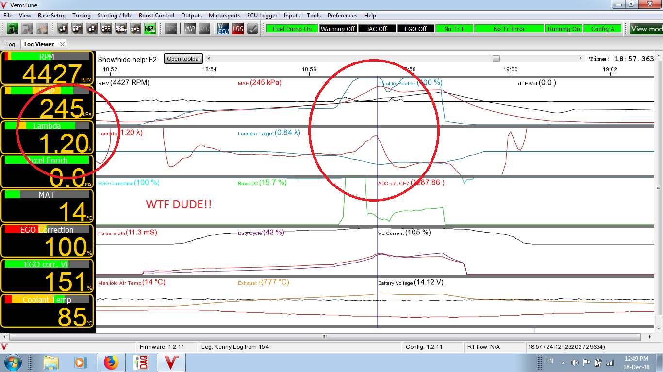

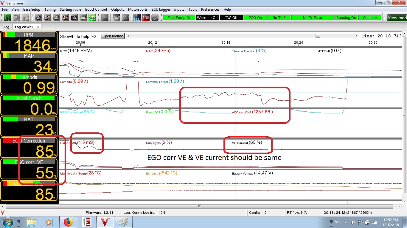

Another reason you have lean peaks on accel is because EGO is pulling a lot of fuel. It is canceled on throttle input, but it does have an effect.
I hate to say this, but your VE table needs a lot of work. You say it maintains target lambda with EGO on or off. Why does the log then show EGO correction 85%? I can see in the log with my settings that it pulls fuel almost everywhere. EGO correction should be 100% if on target. Another thing is that you reach very low IPW. Just 1.4-1.5ms. The Dekas are not really linear that low. They start to go unstable at 1.7ms I have noticed. That is why you have that weird oscillation in lambda and MAP between time mark 11.30 and 12.20, I think.
Is your thermostat new? Coolant never goes above 87C. I recommend you get a stock 87C 'stat.
I see the on/off EGO issue at the end. That is odd, but not because of the higher enable temp. That is something else.

If it goes too rich in boost, it is not as bad as very lean. 1.2 @ 245kpa is not good.

here is a run from today. as you can see the AE kicks in alot as i start to push the throttle, as it gets to 100% AE is gone and when i over boost to 205kpa i run lean for a split sec. thoughts?
I did 3 pulls and all were the same issues. This lean issue is my main concern right now so I'm trying to nail this down. Really need some help on the AE side of the house.
I've since adjusted the dTPS/map in a hope that it helps. Chris you said the if the dtps reads higher then the scale, say 50 and I only have valve for 26 it will use that 26 value... my issue is that my 26 value was 198%...198% seems like alot to me. Either way, I checked my log and I dont see dtps anywhere near the lean spot not near 100% WOT . I guess I could say...I'm lost on this one.
lean spike on 16.5.vemslog

morris400 wrote:here is a run from today. as you can see the AE kicks in alot as i start to push the throttle, as it gets to 100% AE is gone and when i over boost to 205kpa i run lean for a split sec. thoughts?
I understand tuning AE is frustrating. I struggled with it too for a while.
Kenny, I don't want to be a dick, but you really are not listening. Like I said many times, those kind of lean spikes are going to kill your nice rebuilt engine.
That 198% is the max. Cannot go higher. It is too much actually.
The reason for it not being enough is because of your AE RPM table. It is subtracting enrichment again because it is (way) below 100% which is the base line.
You said you are starting to figure out AE. Good.
I have made some changes to your target lambda table. Its nice to see it maintains target, but 0.88 at 200kpa is a a little lean still. I have changed that to 0.85.
Again, I have changed the AE tables. Have added some fadeout time because it seems it is not long enough.
You need to play with JUST dTPS. Only that. You said my settings made it go very rich at idle when using AE. That is normal. It is partially because there is no load on the engine and also because you back off immediately. So, fuel is dumped. That is why stop and go uses so much fuel. There is also the issue of fuel film, but that is very advanced.
So, I put 1000rpm at 80%, the rest 100%. Cruise along at 2500, then press with a little change first, then move on to more throttle change. Hold the throttle after accel, do not back off for at least 5-6 seconds. If you see lambda dip to below target lambda then recovering to target, good. If lean spike, add more enrichment at that dTPS point. So, say dTPS of 20 and still lean, increase % AE. See pic.
The reason for the 100% in the RPM table is because some FW has 0% as base line, but not 1.2.11. There 100 is base. Most engines need more enrich at lower RPM, but less at higher. Because of the fast change in kpa, it needs extra fuel to cover the sudden change. Say you have dTPS 25 with 40% enrich at 2500, it will need less at say 4500. If dTPS 25 with 40% extra is good at 2500, it will be too much at 4500. That is what the RPM table is for.
I have attached pictures which attempt to explain it. There is a delay between dTPS and lean peak. That is what the fadeout is for.

Took a nice long hour drive today. Had to revert back to config 16.4 as the changes I made in 16.6 would not allow the car to start. So I went back to 16.4 which I knew worked. I
Changed the AE settings on both dtps and rpm. Then turned ego off and drive away. Everything felt pretty good. Was able to cruse around at 20kmh 40kmh 60kmh 100kmh and 120kmh for extended periods of time.
The only issue I could see was it's still rich so ill have to change the AE a bit but also...after coasting at 0% throttle for a few seconds, once I add throttle it stays very lean for almost a full second or longer before the lambda corrects.
Now with that I'm wondering if the fadeout time has something to do with that? I adjusted fade out from .48 to .75 as I needed more enrichment when I depress the throttle... it apears that by adding fadeout time I increased the lean period. Or am I reading this log wrong?
If crusing at lower throttle (15 or 20% say) if I press the gas to 80 or 90% i get no lean spot from what I can see...now I still get the rich dump before it comes back to normal. For this I'm confused if this Is dtps adjustment or rpm AE adjustment.
I ran tune by statistics today as well after my run. Pretty much said to drop the VE by 10% so I've done that and will log again on the same config with the VE changes.
Logs from this morning Attached.
Log of pull dec 21 lean condition.vemslog
(32 KiB) Downloaded 2688 times
log from Dec 21 AM.vemslog
(1.74 MiB) Downloaded 2764 times

morris400 wrote:not sure what happen after i used TBS this afternoon but it felt like i went backwards. all i did was redo the VE as per TBS and the car ran like utter junk. would not idle to save its life and at some point VEMS decided to change my idle RPM to 0. i shut everything off and loaded up the config from this morning and same issues. idles like junk, now idles lean. i had an issue with warm/hot start, it just cranks and cranks, i habe to hold throtle at 100% to get it to fire up on warm start.
going to try again tomorrow but that was a fustrating afternoon on what i thought would have been a soild run.
Here is advice numero uno: Do NOT use TBS. It is garbage and will only do your head in. Log, tune, log, tune yourself.
I wish you had posted up the logs from your 20, 40 60, etc kmh drive.
In the attached config, I have rescaled your VE table (AGAIN!) to create more resolution. You really need more cells in the low/mid rpm and in the vacuum range. You cruise at around 50-75kpa. No cells there. I have tuned some of the cells based on the Dec21 AM file.
About the long lean condition after reapplying throttle. That is because of two things: Overrun fuel cut and fuel film effect.
What happens when your close the throttle on decel is the injectors are shut off. Then the fuel film in the intake runners and bowls around the valves are "sucked" dry. Normally, the fuel film is in equilibrium, but because there is no injection, it pulls the fuel off the walls. So by the time you re-apply throttle it needs to build up film again. The low IATs also have some effect on this. There is no need to worry about it, because you are not applying any real load, but if you let off and then re-apply to go in to boost...
You can do two things. Turn off overrun fuel cut or increase AE %. AE RPM has nothing to do with it except with the cases I told you about before.
Could you make a log of the config I made and run it in 2nd from 2000 to 5000? First in vacuum, then boost. Slow RPM increase. Also, a log of it idling warm with lights and fans on and off. Like 20 seconds.
The VE table really needs to be 99% before AE can be done.
Better yet, get your buddy Party in the Snow (hehe) to tune the cells while driving. Much faster and safer. He''ll tell you what to do.
Smoothness in driving is key here.
