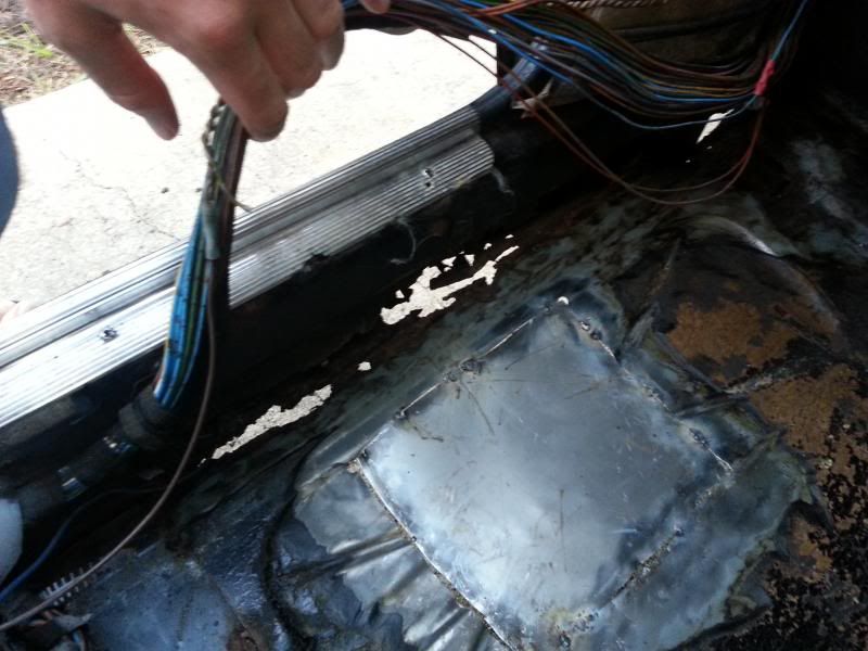

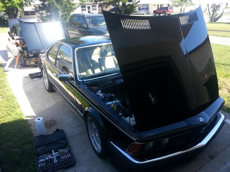

Did some quality wrenching yesterday with my friend Justin. We started out in the morning with adjusting the valves in my E24 and his E30. I've never done that before and I enjoyed it thoroughly. I found it very relaxing actually.
After that, I fixed a problem with one of the windshield wipers, then found the source of my constantly ticking blinker relay (weird problem with the turn signal switch, new (used) one on order), and finally rounded off the day by doing some welding.
The two front bolts that hold the driver's seat down have been ripped out of their mounting points since before I bought the car. I'm not quite sure how they got that way, but I have a theory. I think the one on closest to the driver's side of the car was a bit rusted out and eventually the metal around the area of the thing holding it in just failed in fatigue. The other front bolt, the one closest to the middle of the car, didn't show any signs of rust though and the metal was just torn out in the area surrounding the mounting point. I think some fatass must have just plopped into the seat one day after the one mounting point had already failed from fatigue or was just on the verge of failure, and the force of the lard-ass-plop just tore everything else out.
Since I bought the car, there has been one bolt that went all the way through the floor of the car holding the front of the seat down, no bolt for the mounting point closest to the middle, and two good rear mounts. I decided today was the day to tackle that since it's pretty easy access (I just pulled all the carpet out) and I wanted to practice my welding. I'll post some pictures in a bit, but the result was a success! I managed to get everything cut perfectly on the first try and all of the mounting bosses actually lined up perfectly too. Can't beat that for some first time chassis-related fabrication!
This is a warm up for floor pan and sill fixing
I know it's hard to see, but this is after welding new mounting points in. Wish I would have taken more detailed pictures, but it wasn't very complicated anyway.
Oh, and I finally confirmed that the car has a 373 limited slip diff. I then proceeded to test it out

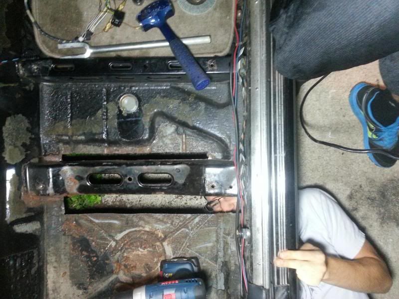

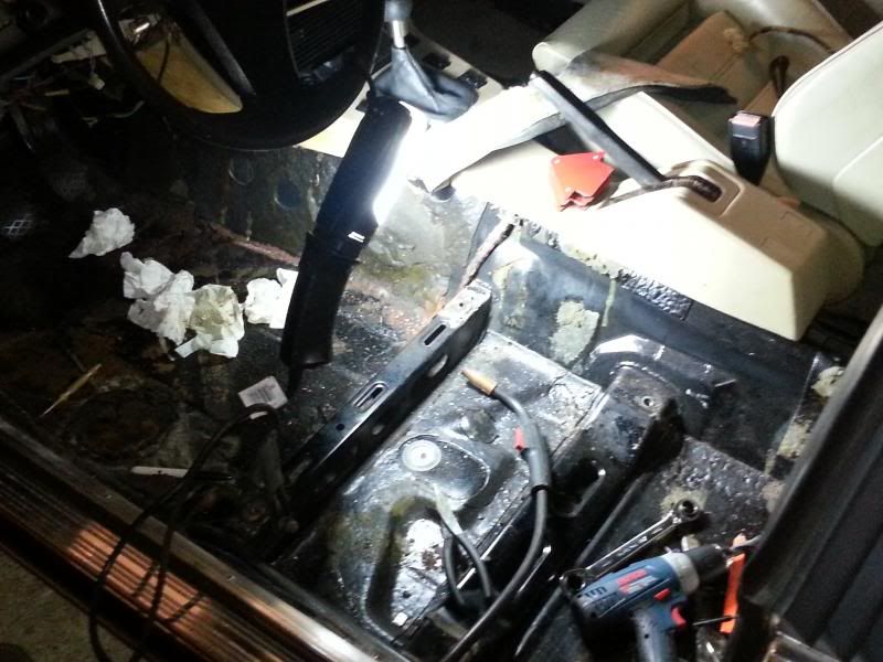

Started repairing the floor today. There is a LOT of work to be done, but it'll be satisfying when it is all fresh.
I started with the spot which was most visible and also easiest to get to. I wanted to get it out because in addition to a large hole, much of the area near(ish) the hole looked like this:
That damage runs pretty much all up and down the passenger seat bracket, so I cut all of the floor out from under it. The bracket/tube for the seat itself has some damage too and I had a little trouble deciding how to fix it. Should I repair the existing piece or just make my own tube frame thing for it? I think I've decided to repair what's there because I determined that it wouldn't take much effort to make the repair pieces required.
Here's a pic with the floor cut out. There is still more cutting to do, but this got 95% of the damage out.
More cutting when I have a little free time, then some quality time with a wire wheel on a grinder to strip undercoating, adhesive left over from the sound deadening inside, etc. Then it'll just be a matter of cut and paste. I'm not looking forward to trying to make the bends I need look nice with no real tools for that, but I'm sure I can come up with something.

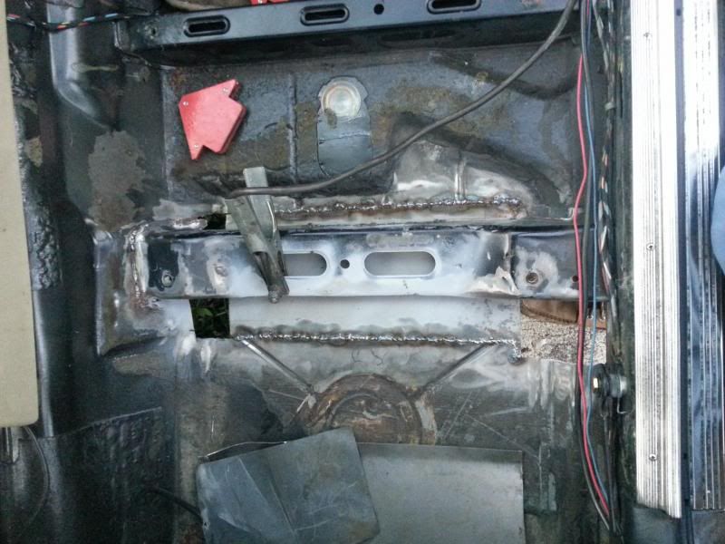

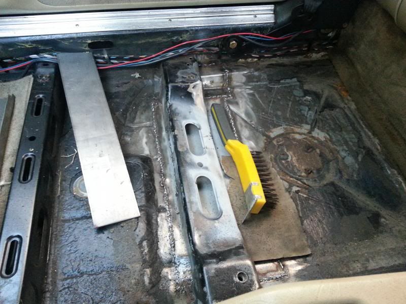

Time for an update!
I've made pretty good progress on the floor so far. I've managed to knock out one big area on the passenger side (behind the passenger front seat).

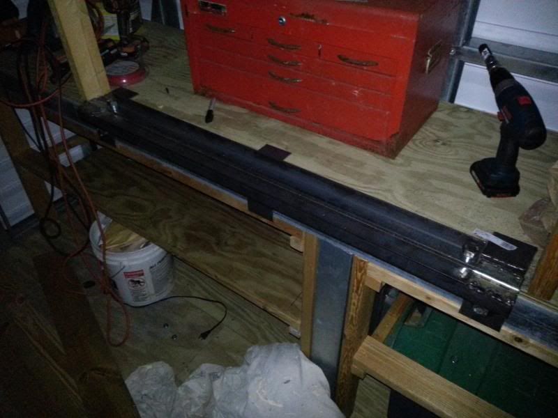

I did actually make my own brake. It was a pretty fun project, and I learned some things. The brake is pretty sweet, but I need to reinforce it for anything significantly thick. It would have been fine if I had made it half the length, but I made it with a 40" throat. It just needs a few choice structural additions, then I'm confident that it will make easy work with just about anything I want to put through it.
Here is a terrible picture of it.
I posted a picture of the area I cut out in the passenger floor a few posts back. Here is some midway progress.
Its amazing how much structural integrity even just that one piece added to the floor on that side of the car.
Here's a picture of the mostly final product. I am pretty proud of what I was able to get done. Its pretty hard to get pretty looking welds with metal this thin and a MIG, but I'm happy with the penetration and everything.

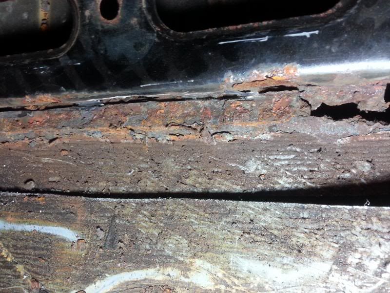

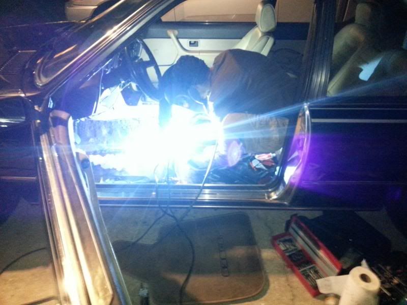

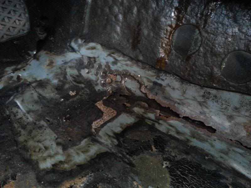

Here are some pictures of the damage on the driver's side after I removed the sound deadening material.
(trans/exhaust/driveshaft tunnel)
(door sill/floor)
As you can see, I began patching one area, but ran out of gas for the MIG. I tried using some flux core just because I've never tried it before, but by God... that stuff sucks! So now I'm trying to get some more gas and awaiting the arrival of POR-15 and some undercoating material. I'm planning to tackle the trans tunnel area next, then the sill area. Wish me luck! I'm enjoying the challenge so far
