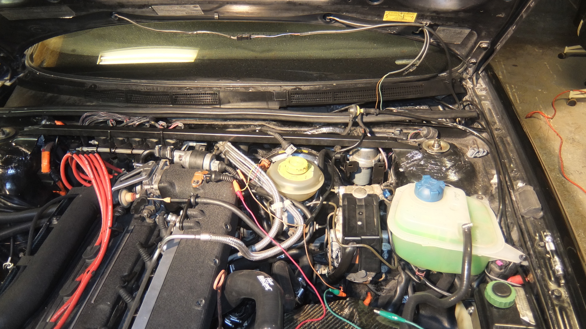

Still dealing with the vacuum booster leak (new is coming) but till i did a vacuum pump test setup.
¯\_(ツ)_/¯

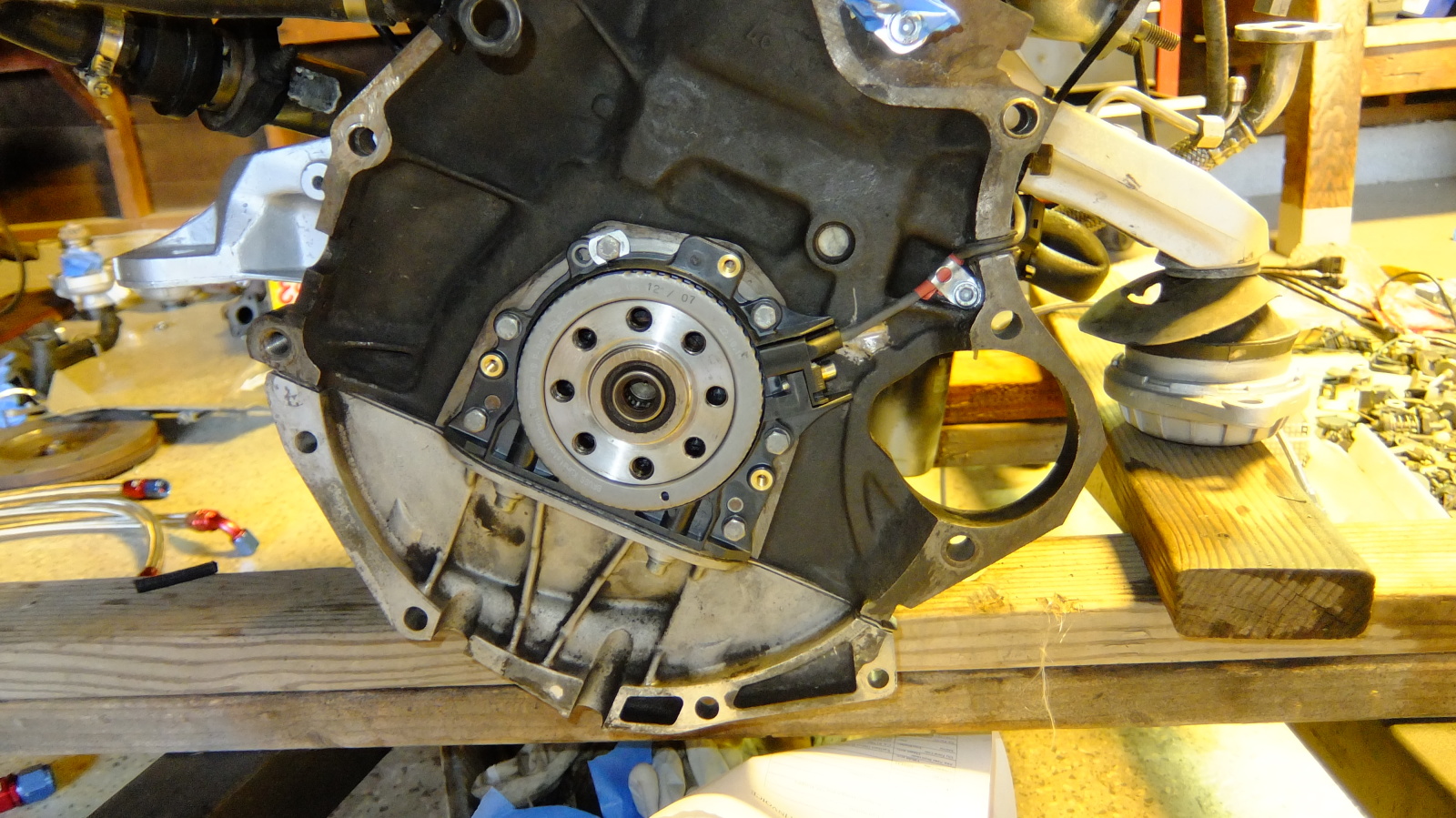

Got vems, but I got some error because the flywheel pin (consulted with Marc, thank you).
So my vems went thought a surgery and got converted to work with the rear crankshaft seal/sensor.

Right now, I have to pull my transmission or the engine/transmission combo. Since I do not have lift, only floor jacks, and got no extra help, i think i will pull both. I can install the crank-seal, drill a hole for the sensor wire, install the flywheel.

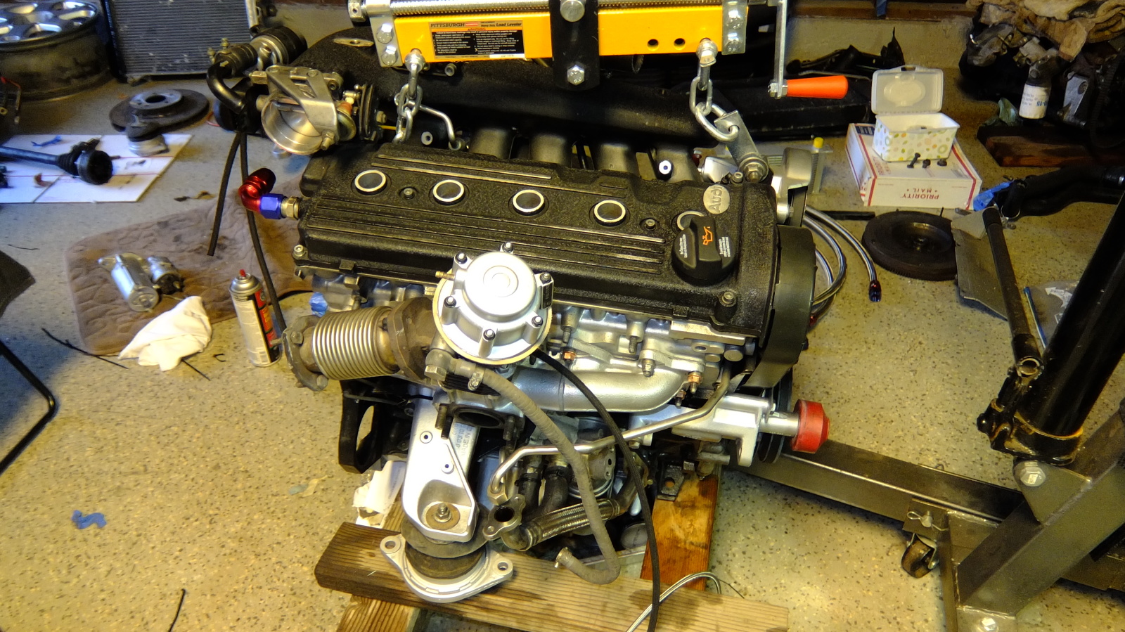

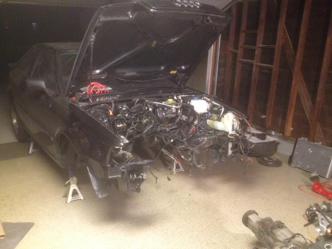

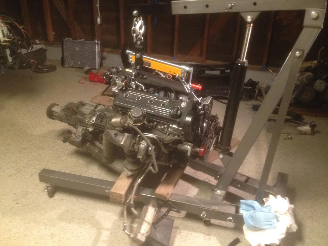

i pulled the engine out. now i can work on the exhaust/turbo swap and the crank seal/sensor
I have to really wrench on it, cos that guy, Dave he is really pushing it :D
unnamed (2).jpg (67.7 KiB) Viewed 39398 times

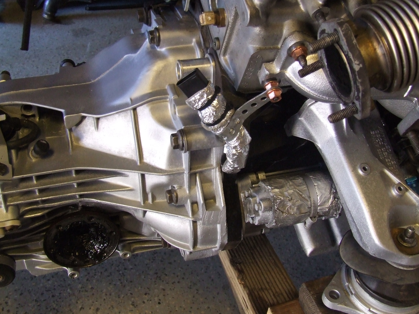

Made some progress:

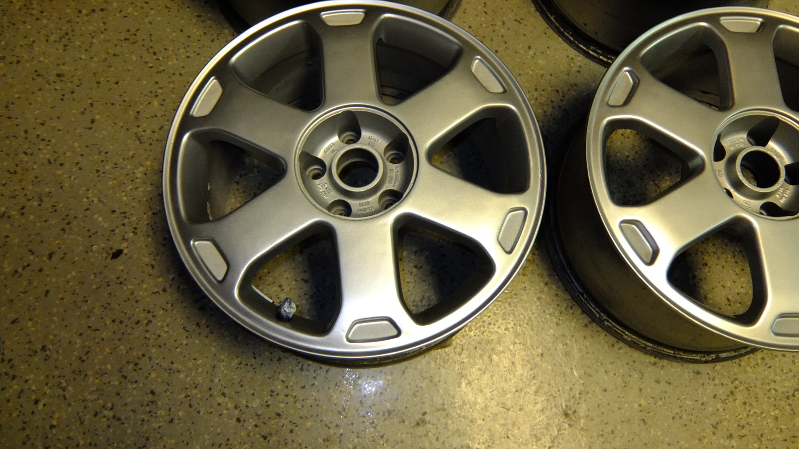

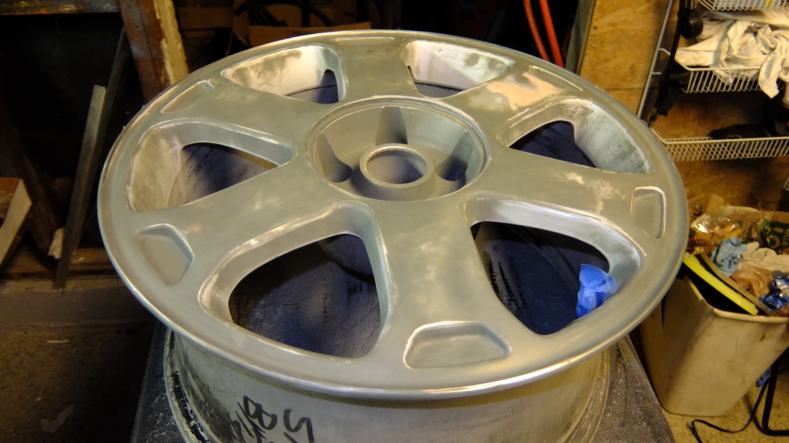

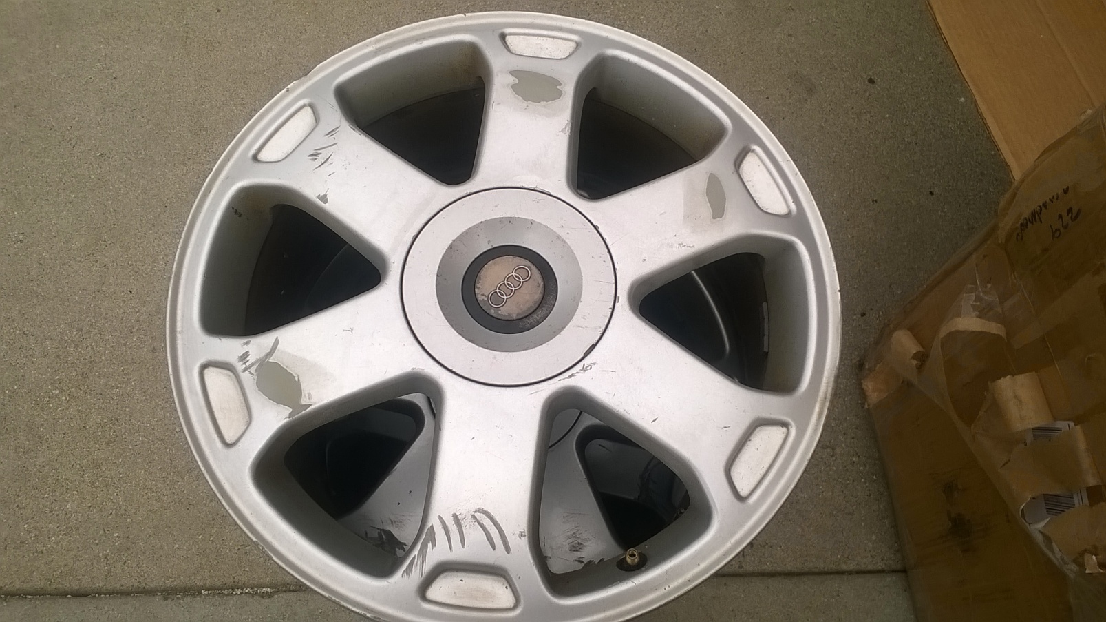

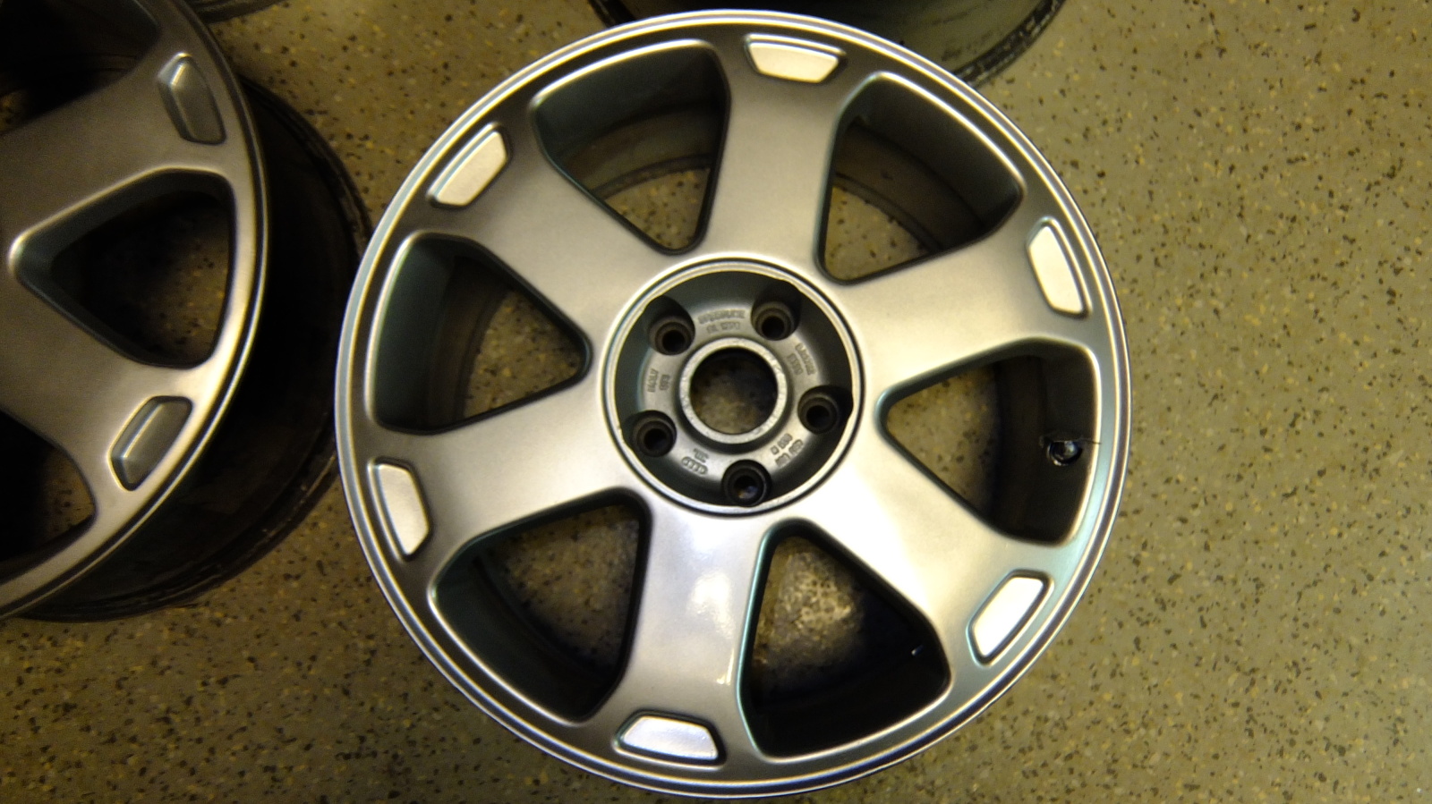

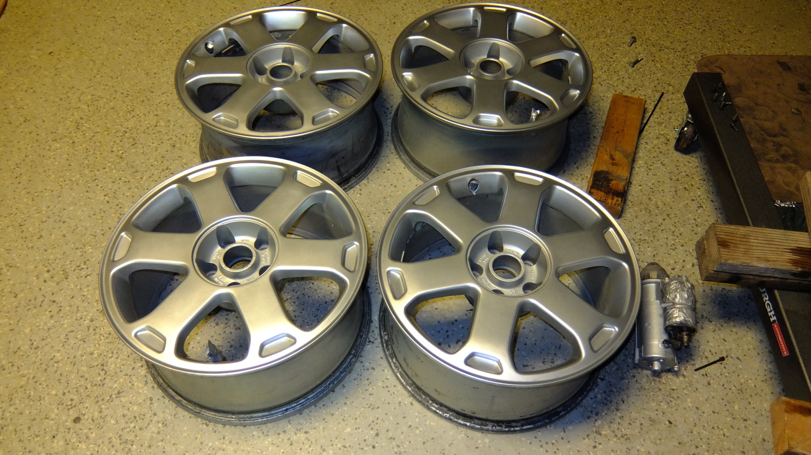

I got a pretty abused set of S6 avus wheels
i had a few hours, so i refinished them
¯\_(ツ)_/¯
project 2226
90quattrocoupe
Posts: 269
Location: Long Beach, CA.
Re: another S2 conversion
Post by 90quattrocoupe »
Wheels look good, Chris.

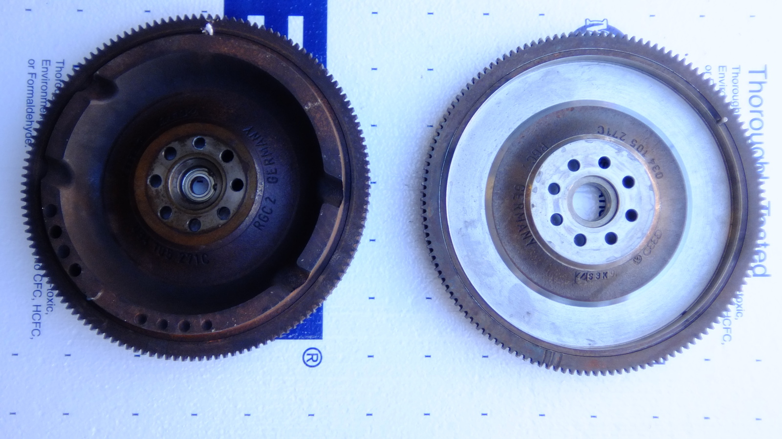

Looks like my flywheel and turbo housing will be done, so I can continue working on it. I hope it will be running by the end if this week.

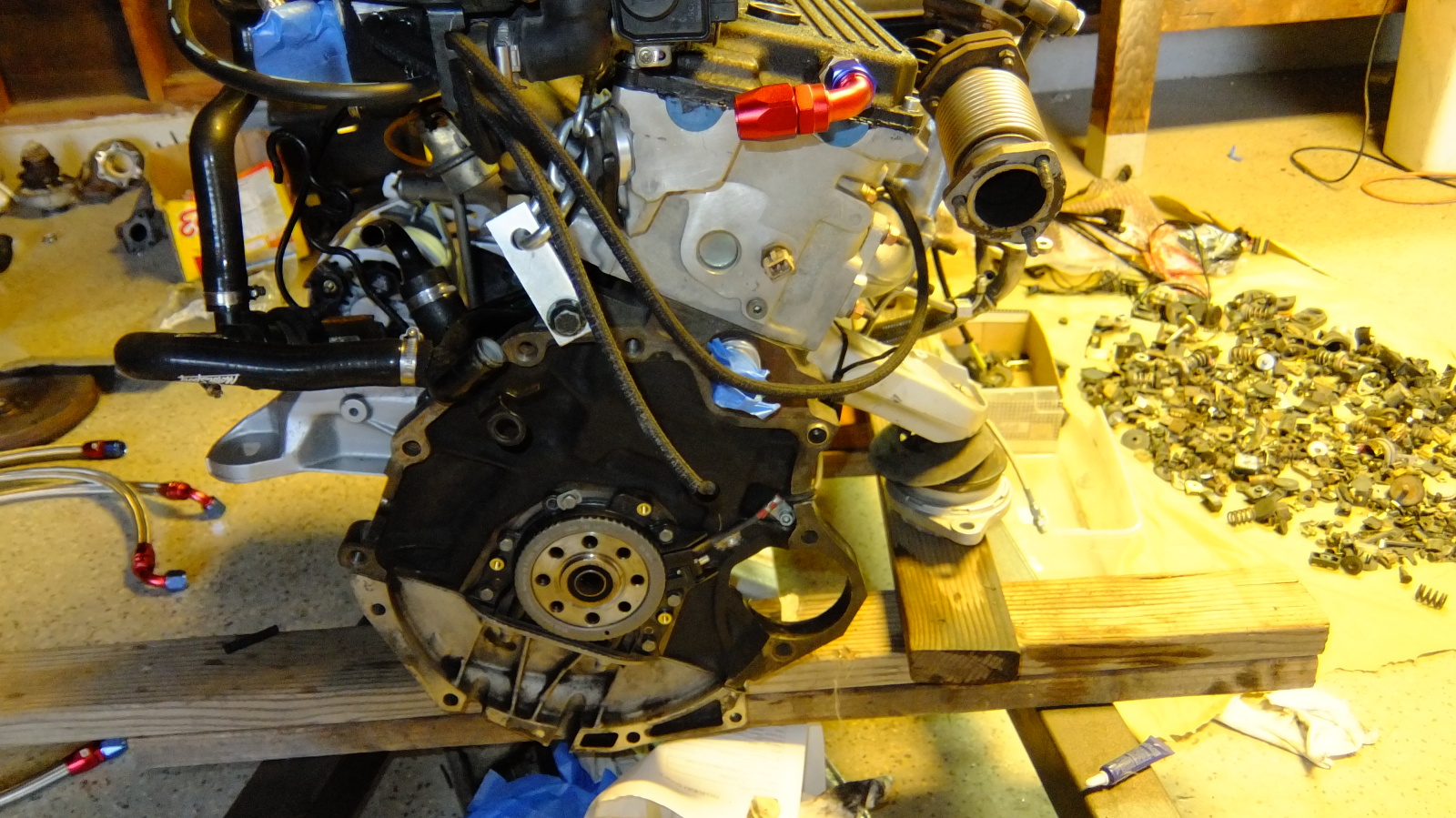

Posts: 2142
Now that's a crank trigger. Nice work.

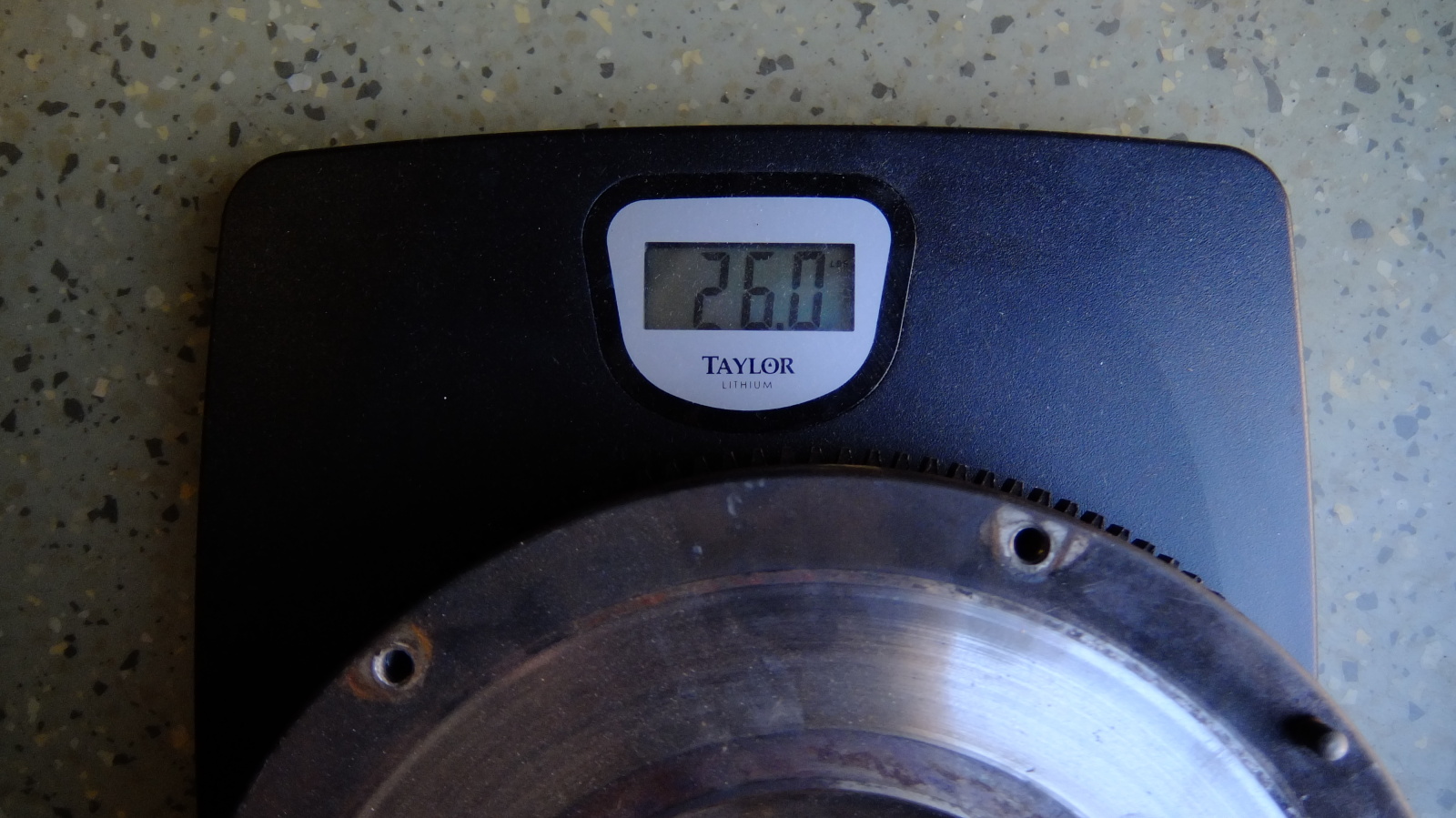

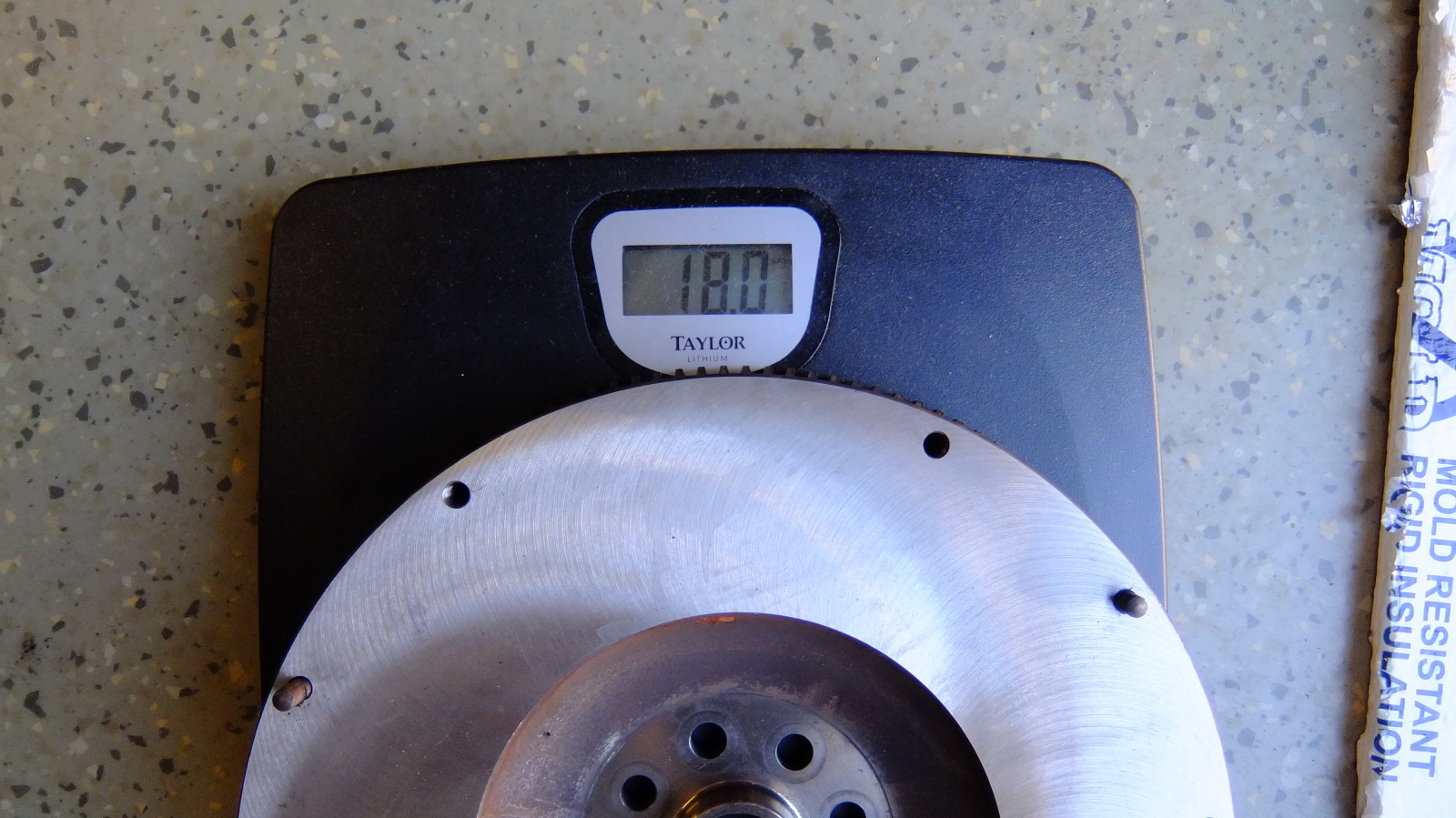

Thank you Jim!
Got the flywheel back, it lost 8 lbs.
Not the biggest diet ive ever seen, but healthy enough for my setup
Re-surfaced, balanced.

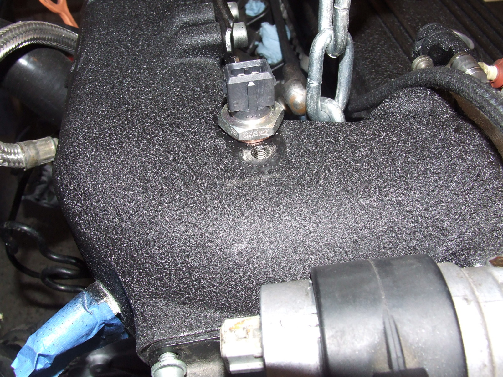

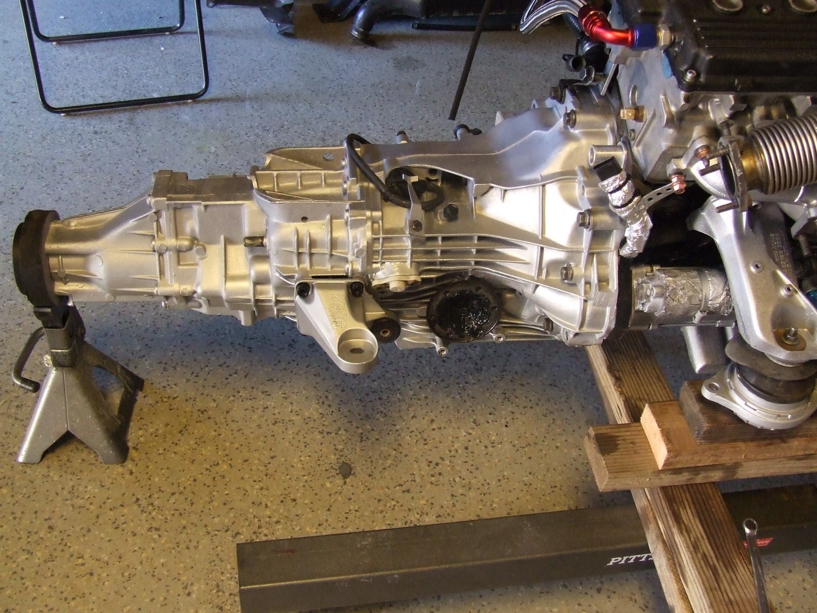

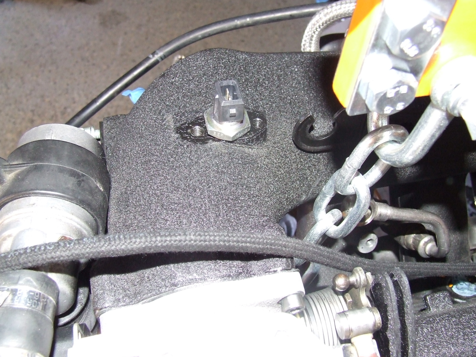

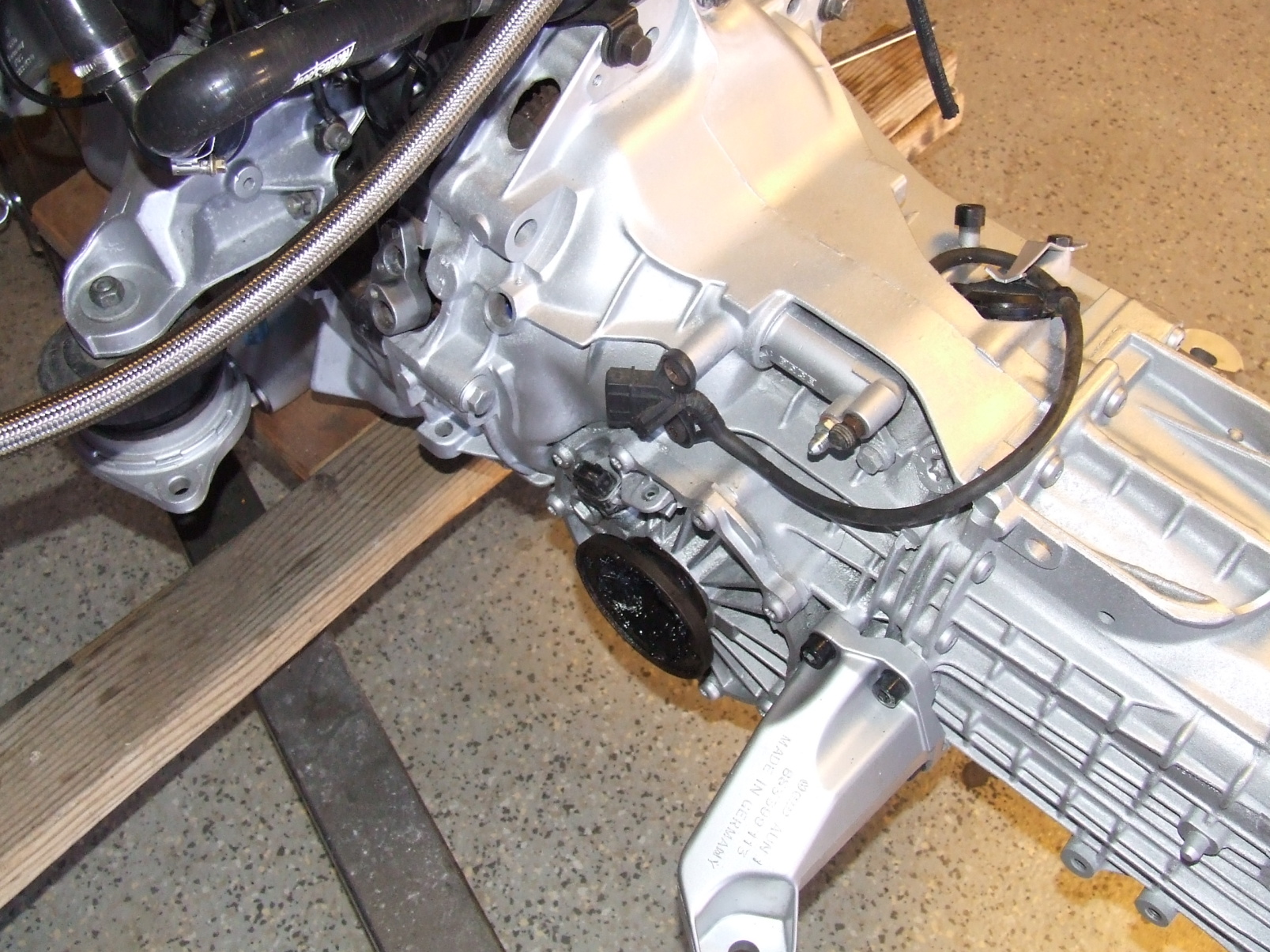

installed a new NTC IAT sensor, had to tap a tread
Cleaned and painted the tranny
Not much i could do....
¯\_(ツ)_/¯

I like the bracket for the crank sensor bracket. :D You might want to change the plastic zip tie out to stainless ones.

varia wrote:its a usa 1991 cq. the plate came with the taillight inner section
Cool, well you managed to get a 1991 'J' reg plate so it matches the year of build perfect! :-)
That's looking very spangily! How did you clean up the transmission? What product do you like to use?

Posts: 354
Location: Los Angeles
Post by varia »
I cleaned it with soft scrub + 3m scotch brite; rinsed it, then let dry.
I used VHT cast aluminum caliper paint, nice coverage and super fast dry time, not too sensitive for oil residue
¯\_(ツ)_/¯
project 2226
Einbilden
Posts: 149
Post by Einbilden »
Nice work , That tranny looks like it was cast yesterday.
Mike

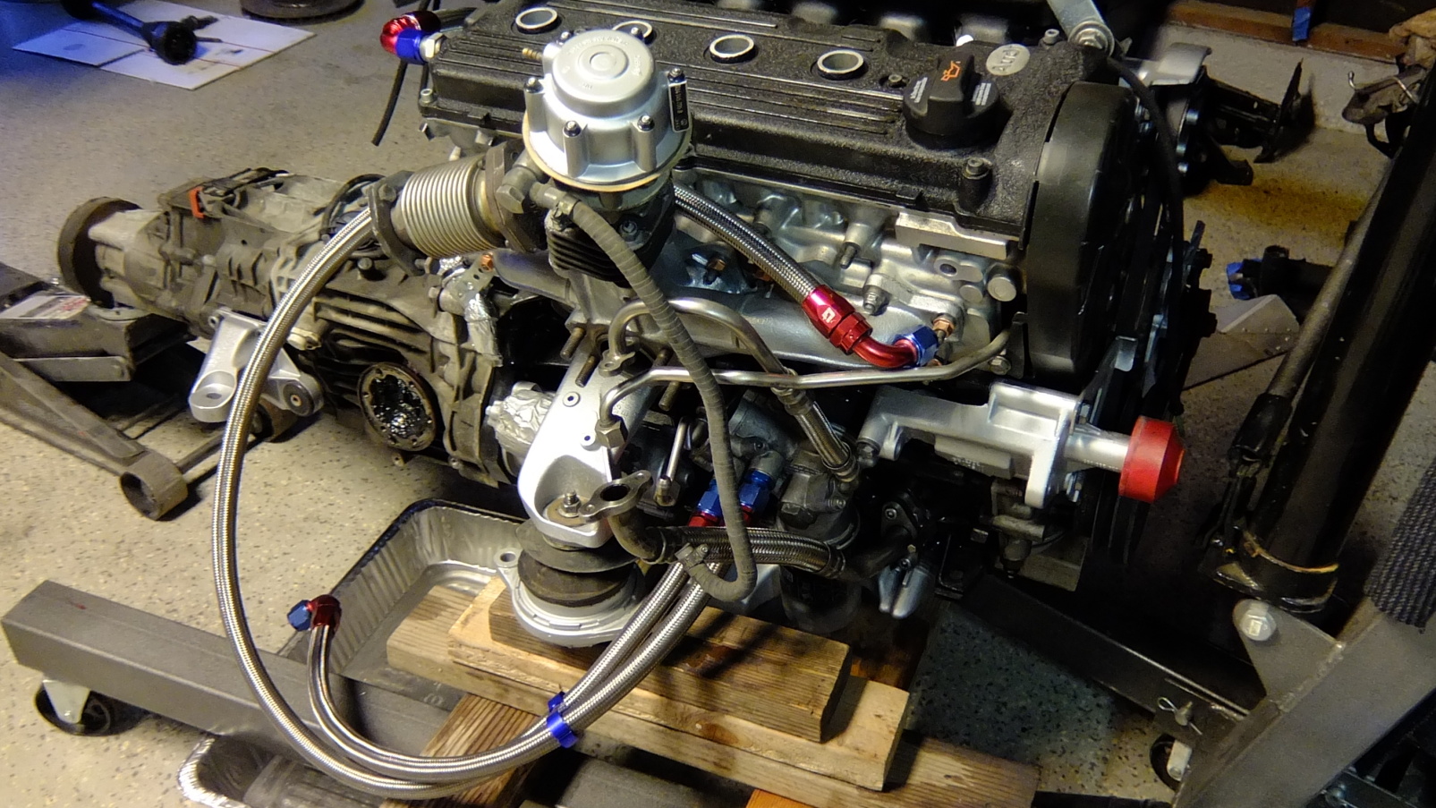

Post by varia »

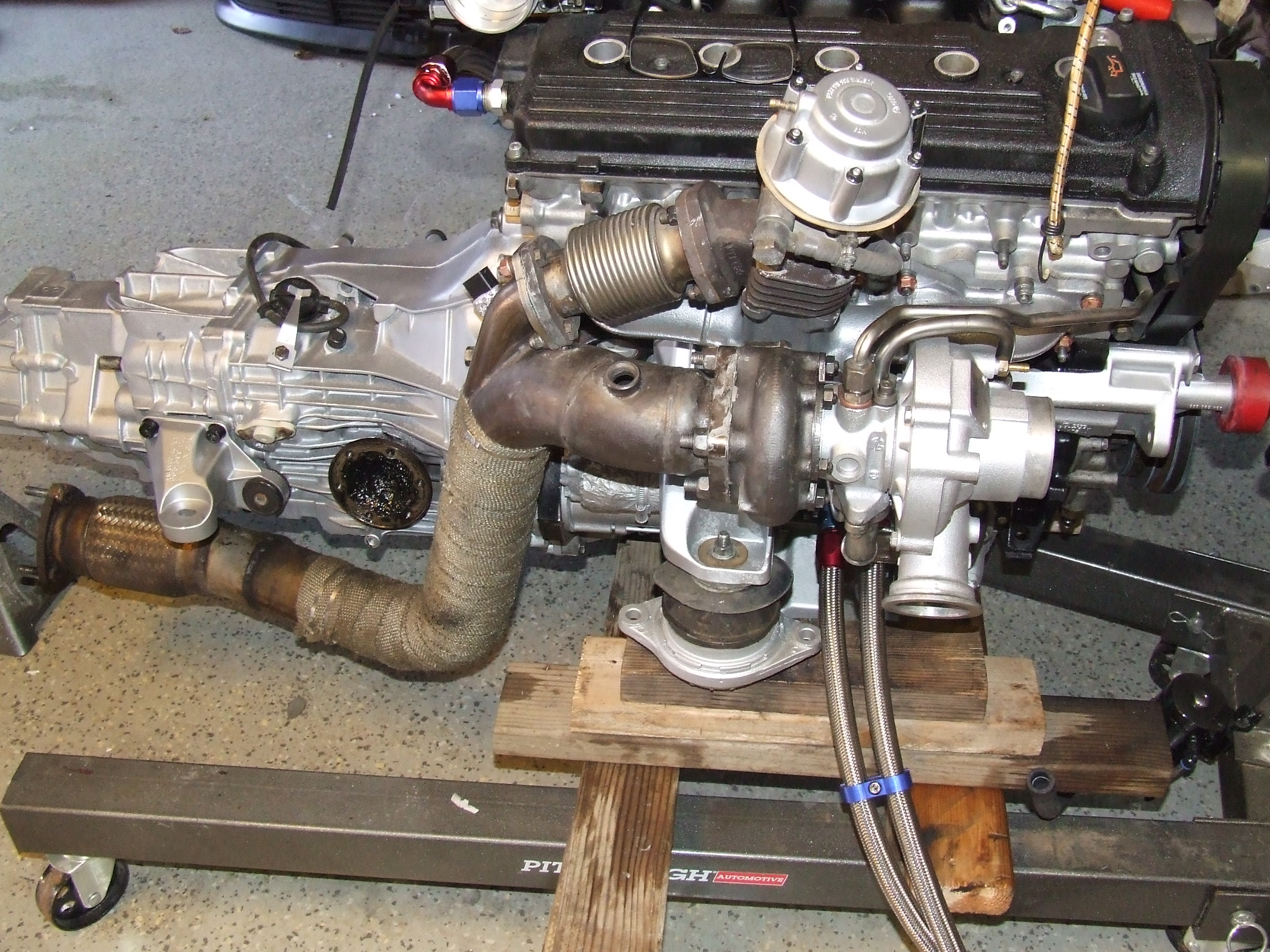

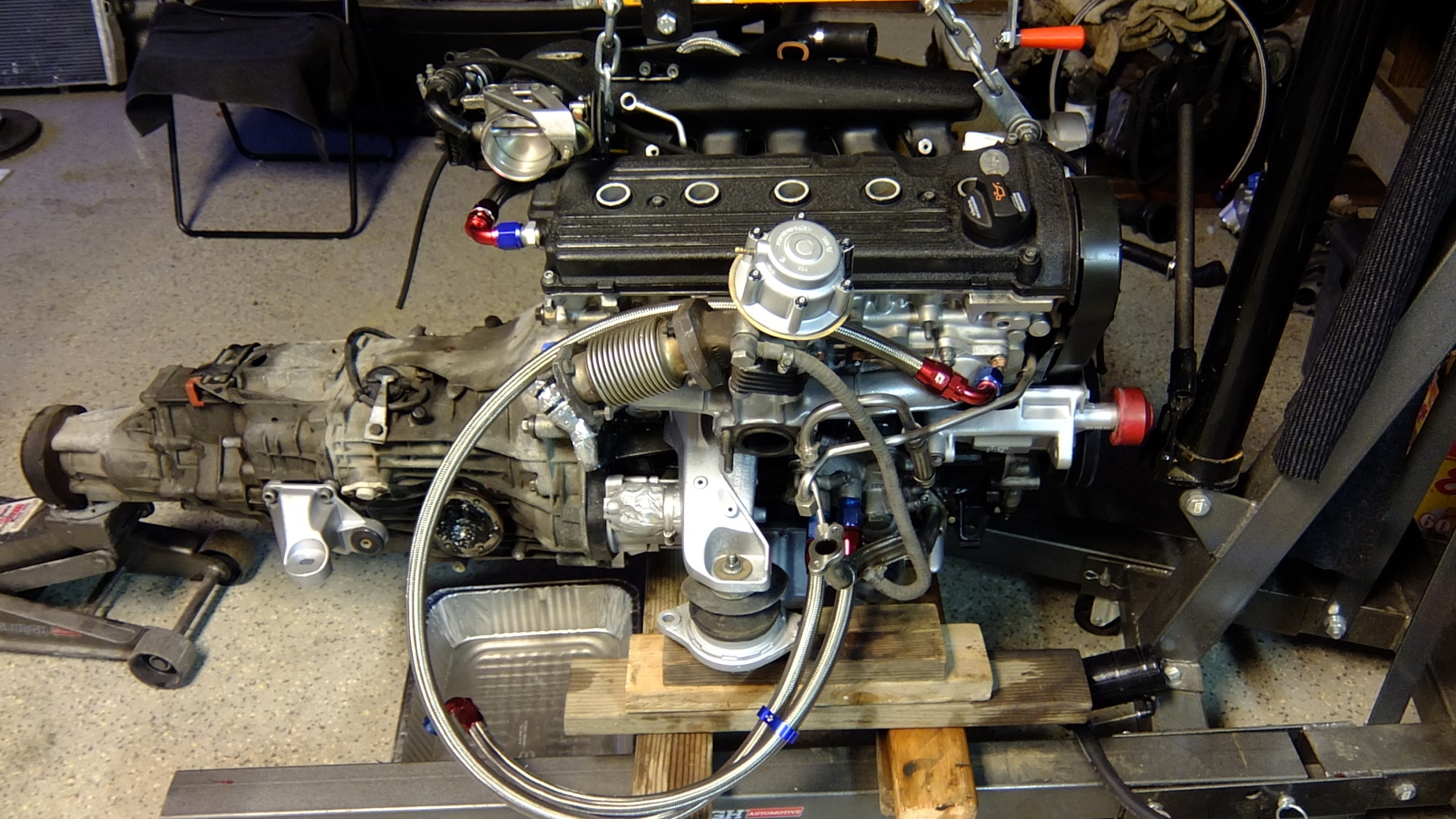

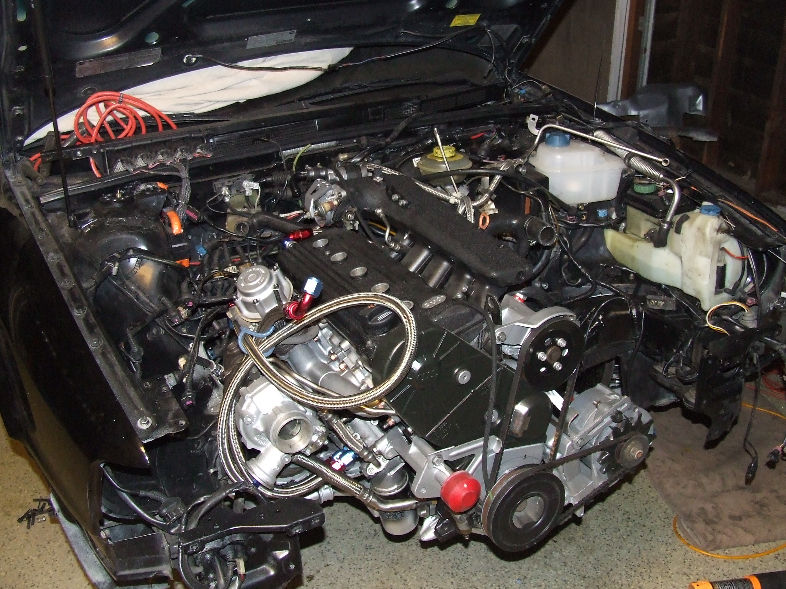

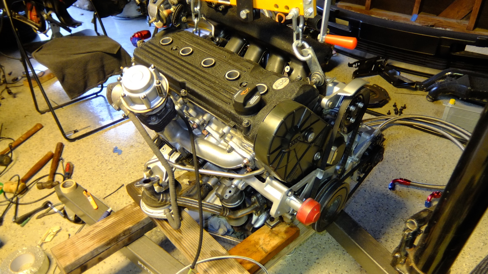

Turbo bolted on:
engine bolted on:
