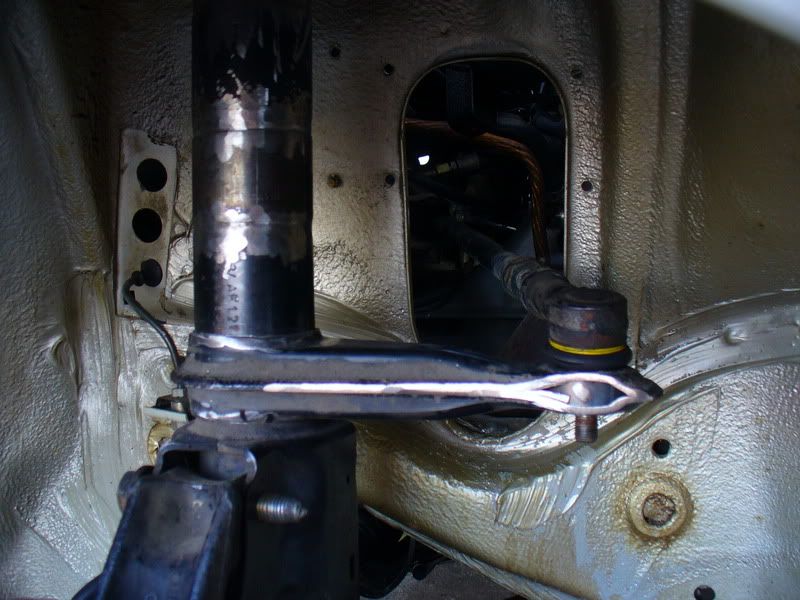

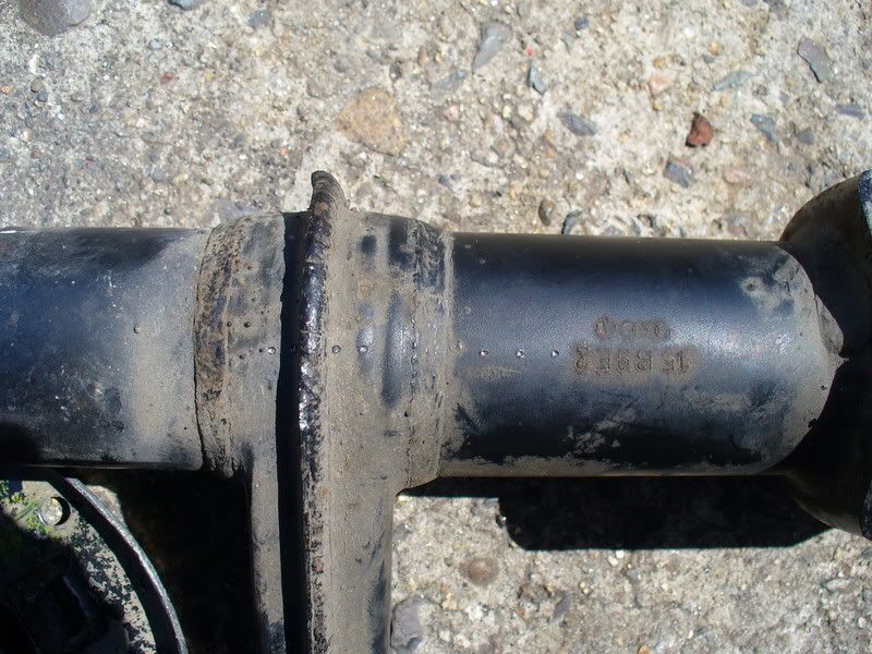

then i moved on to the front suspension. i need to finish modding the strut tubes so i can get my 235's in place.... can't live without those :P
started by removing the spring perches...

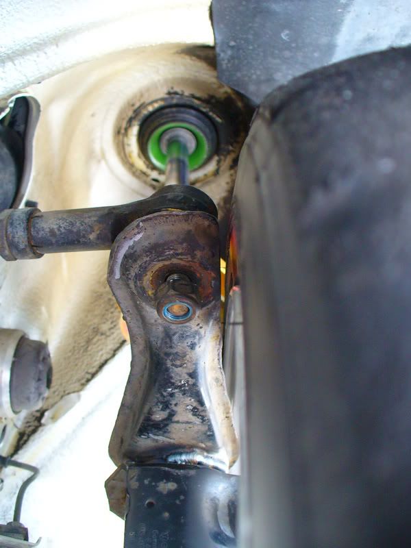

then carefully worked at getting the steering arms off and clearance ground at the tie rod end....
and then test fit them here. i flipped the arm so the tie rod now sits on top. this works in conjunction with the arm being slid all the way down the strut tube and the car being slightly lower to end up with the tie rod being almost flat at ride height.

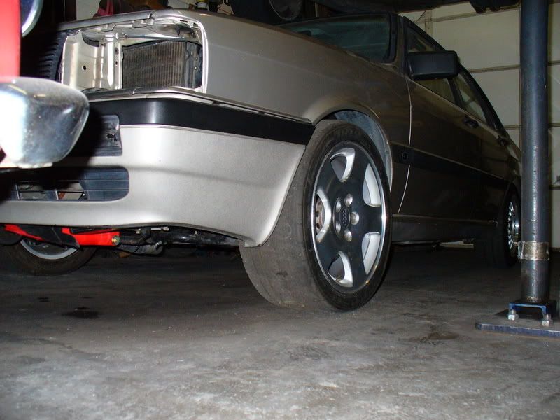

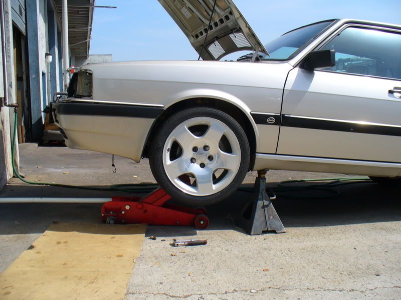

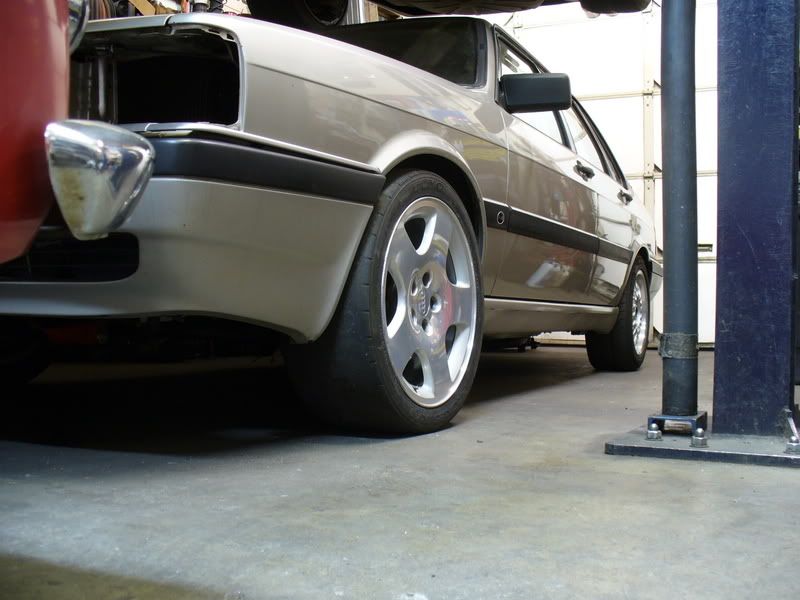

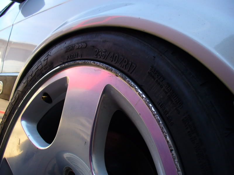

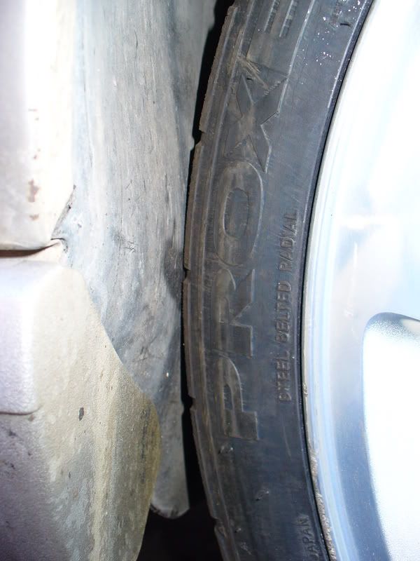

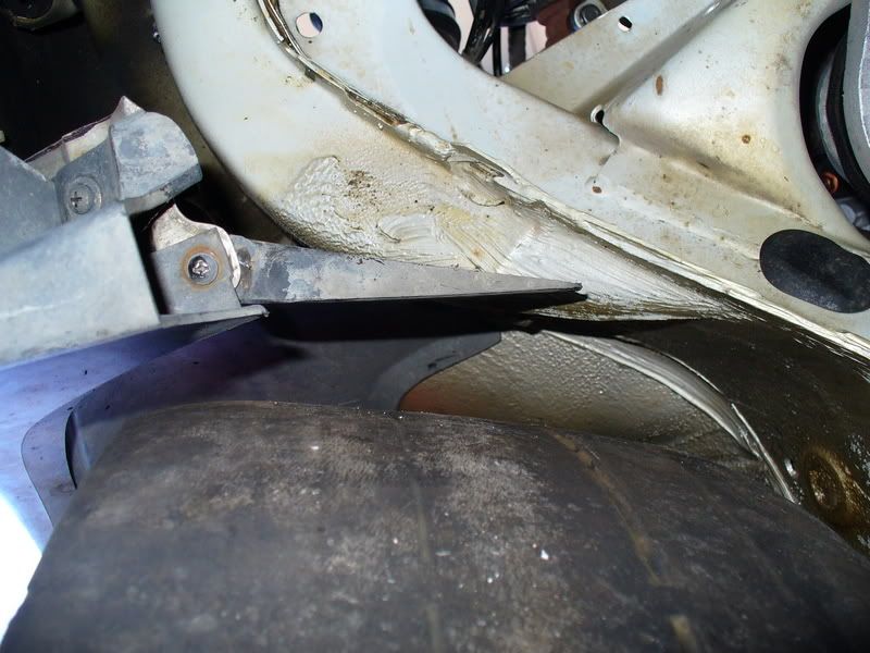

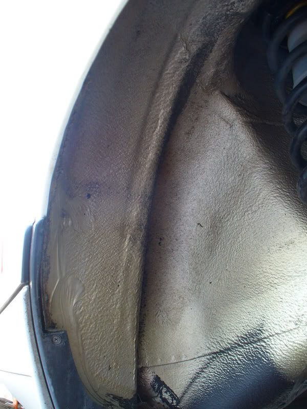

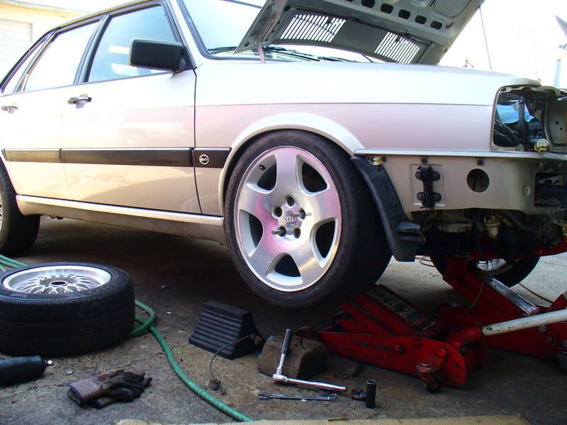

here's some more front fitment pics with the 235's...

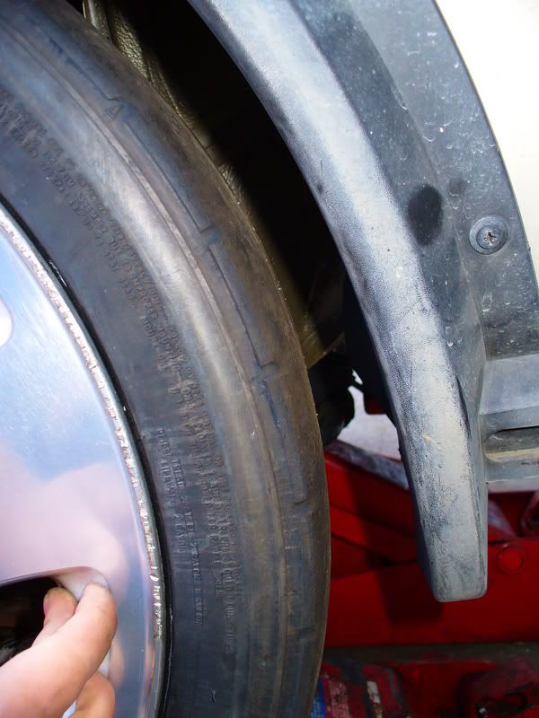

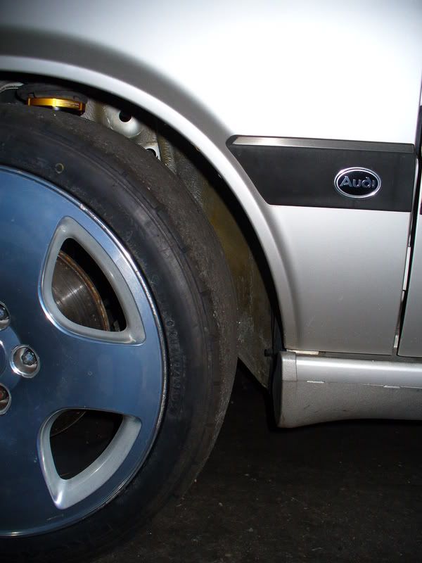

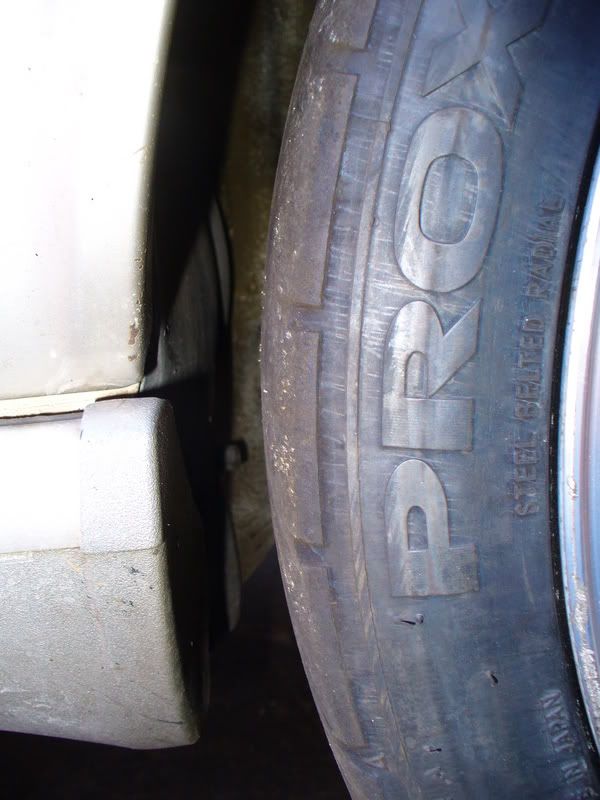

rear of the front wheel arch
it does touch here, but that's only because the plastic bulges. i'm going to lay the plastic down flat somehow

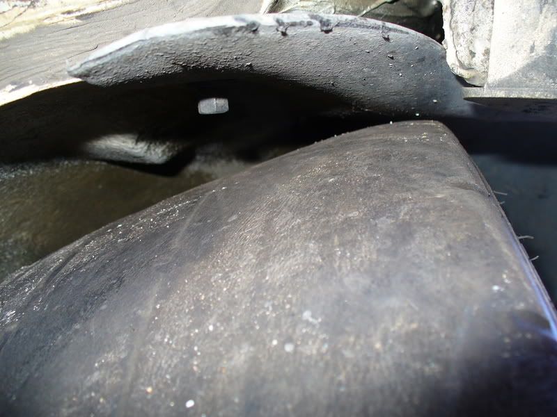

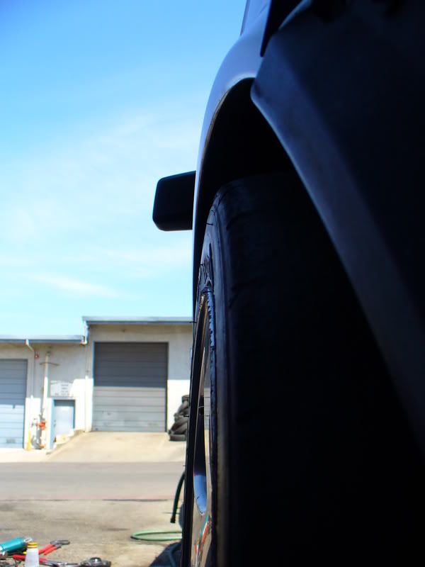

front of the front wheel arch..
plenty of clearance here!
max compression, just as tight here as my old 215's on the white car
it'll sit with about a 1-1.5" gap between the tire and the fender lip for practical purposes.

Those wheels look great on the car.

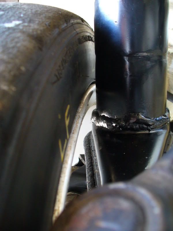

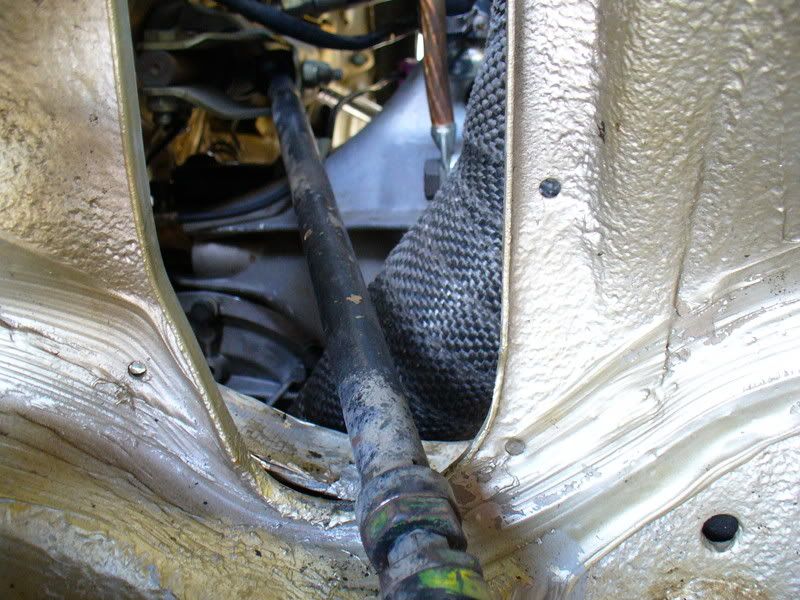

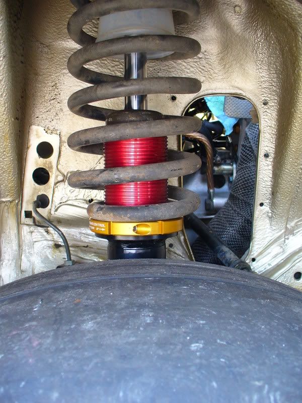

did you get any pics of clearance between those big tires and the modded control arms... :?

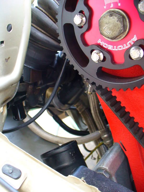

you do know the camshaft bolt is a stretch bolt right?

Wizard-of-OD wrote:you do know the camshaft bolt is a stretch bolt right?
Are you sure? I didn't think so, and I don't think I've seen a 10.9 stretch bolt.

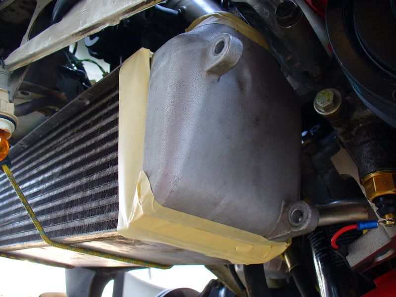

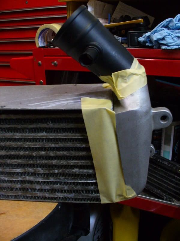

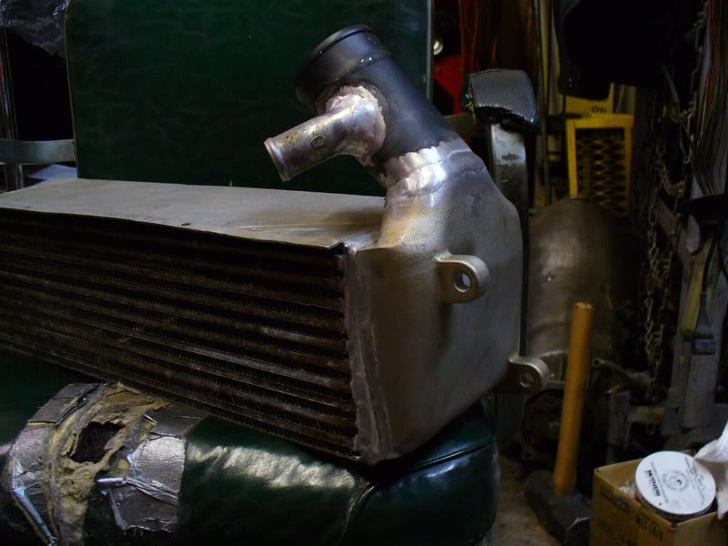

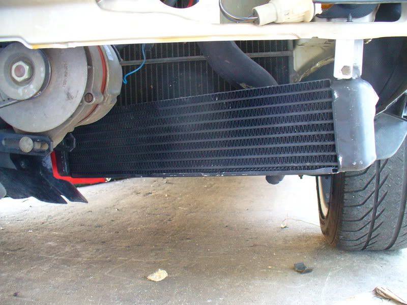

more progress today! first up, a couple pics of the end tank on the IC. it's not finish welded, but just incase someone wanted to get a better idea of the configuration.

doug, ask and ye shall recieve :)

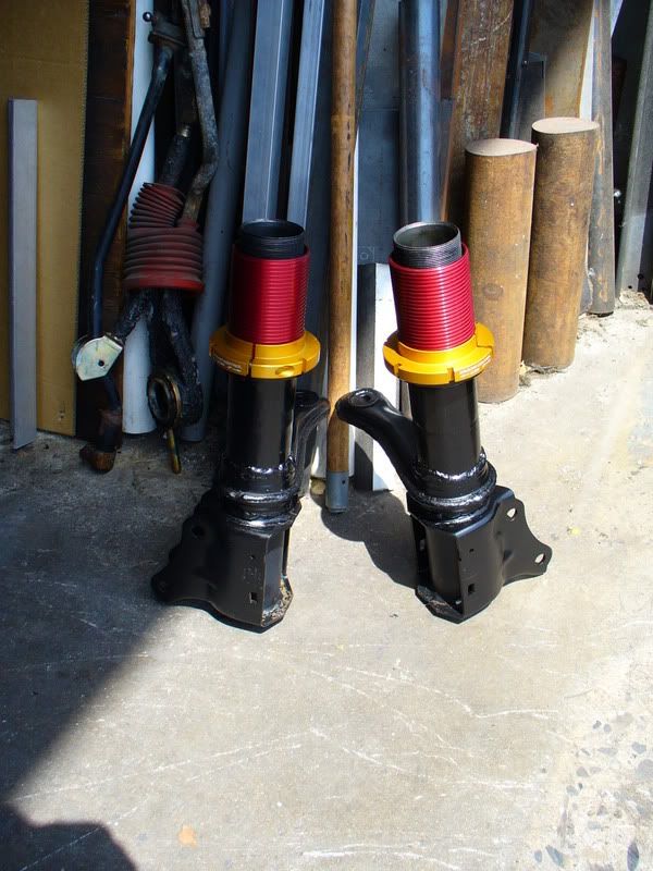

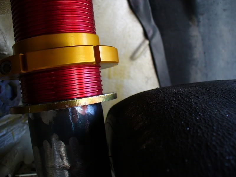

this one is pretty close, i had to remove the inner weight off the rim as it was just knicking the strut tube :P it's a game of mm's here
i ended up putting the upper face of the spring perch 4.25" down from the top to ensure proper tire clearance since it's now so close between the tire and strut
cleaned and painted the housings after the final welding
the spring now sits about 2" lower than it was on the stock spring perch, so before i cut the springs, i'm going to see where she sits and go from there. at this point, without cutting the spring, i can't lower it anymore.
hopefully i can achieve a ride height about here.....

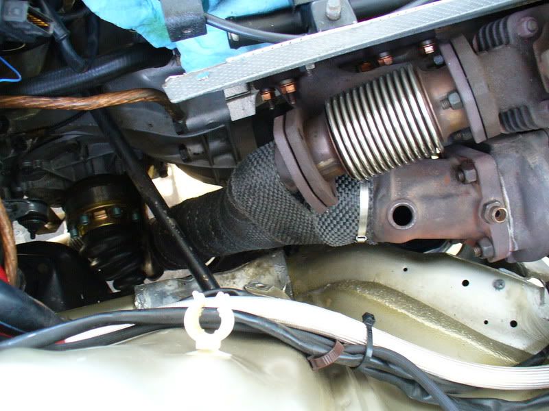

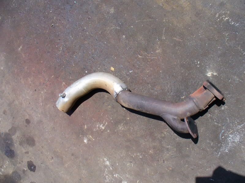

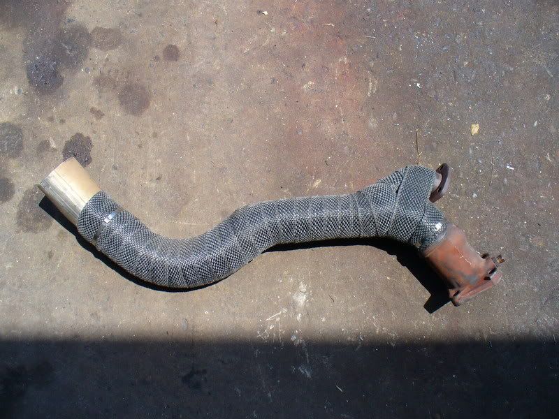

the other thing i got done was the downpipe. i used a 3" bend to get be down around the CV joint from the 200 downpipe section i used.
finished it off with some header wrap :)

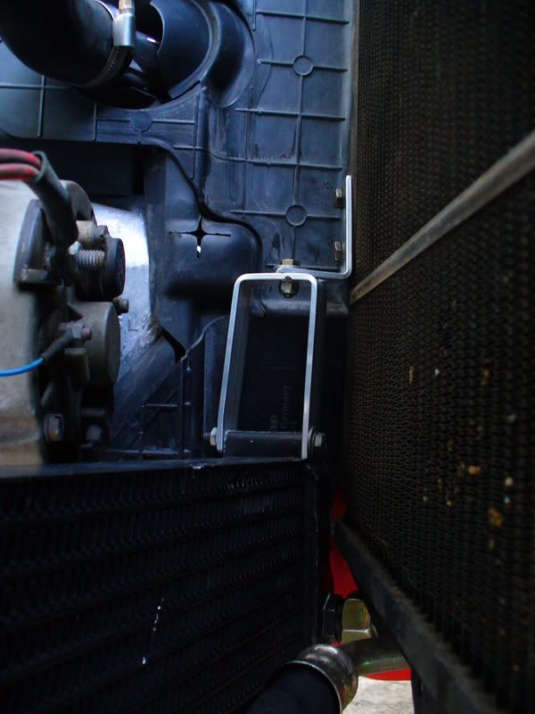

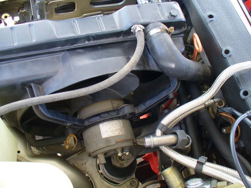

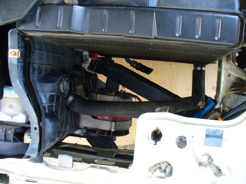

annd, i also got my RS2 fan shroud in with my 200 20v fan. still have to wire it up, but i'm saving that for when i have less difficult fabrication stuff to do.
Er, what? A 10.9 grade metric bolt can't be TTY. Otherwise it wouldn't be a 10.9. Material wise, a 10.9 is roughly equal to a Grade 8 fastener. You won't be putting a 130ksi on that bolt any time soon to make it yield.
no, i didn't :P did you?
Wizard-of-OD
Post by Wizard-of-OD »
Its a stretch bolt fergie...and it costs $1.

Longitudinal
Posts: 107
Post by Longitudinal »
newt wrote:Insert ETKA image
So, that makes the bolt not a stretch, right?

Because its a valid point.Whenever you do an engine rebuild (at least for the VW Inline-4's) you change the following:
* Im shaft bolt
* Camshaft bolt
* Crankshaft bolt
I had the same thinking as well a year ago then I was showed an engine where the camshaft bolt on a 1.8T was reused and it let go. (read camshaft,not crankshaft).It costs like $1 @ most from the dealer so why not change it and use the bolt for something else less important?

No, it's not. I won't repeat myself. Nate posted the factory manual section on it too. I always use some thread locking stuff on that bolt so it doesn't back out. This is not a 1.8t, or any other VW 4cyl. What you do for those doesn't necessarily translate to a 20v or 20v 5cyl. I have NEVER replaced the cam timing cog bolt. Including the one on the 5kq that was hit by a Jeep and broke the cog. Bolt was fine, so I reused it. That was like 4 years ago.

the intercooler aside from being stripped of it's paint and cleaned... is done 8)

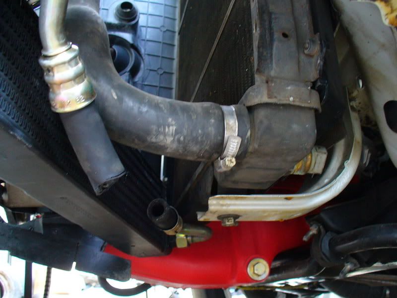

the oil cooler has been mounted, but i still need to run lines. i'll likely do those when i get the car back home as there's a fantastic hydraulic shop up here that i want to have make the lines.

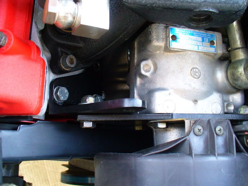

P/S pump bracket finalized...

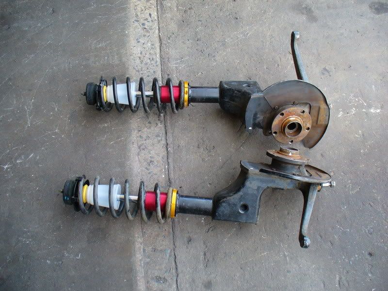

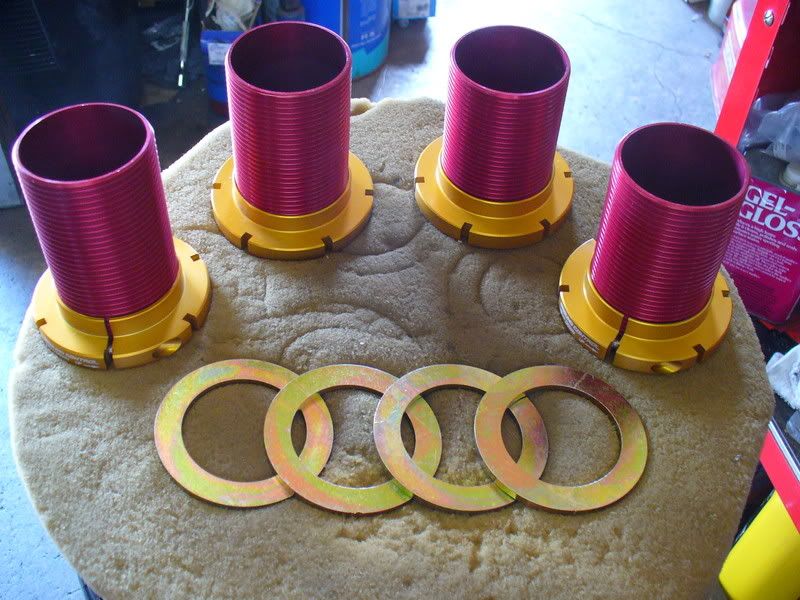

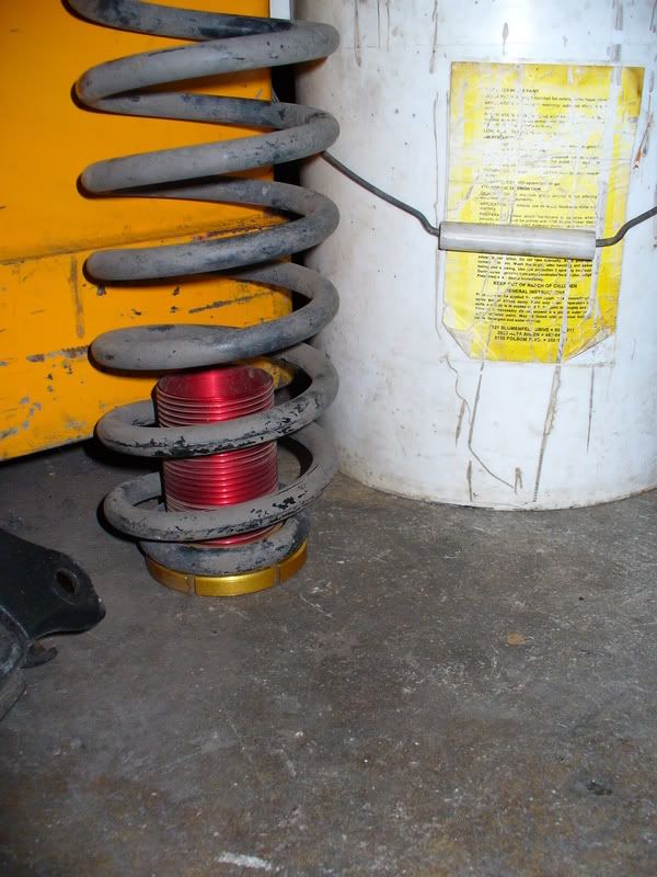

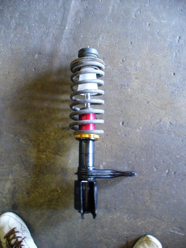

i got my adjustable coilover sleeves installed in the rear as well as the front. i didn't cut either front or rear so that i could see where it sat with just the perches sitting 2" lower than previously... but that didn't change things much :P

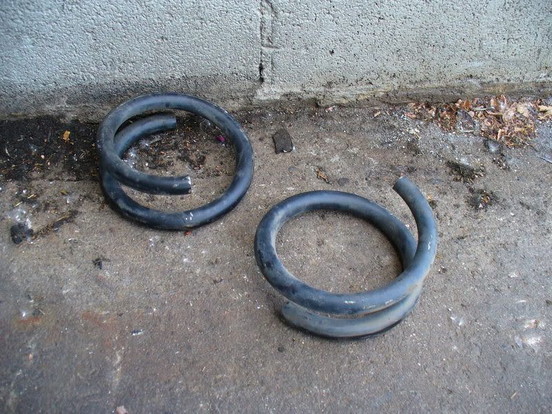

so off came 1.5 rings..
which after doing some spring rate calculations, will effectively raise the spring rates from 150ish lb/in.... to just over 200 lb/in. to accurately measure, we did a unloaded measurement of the spring sitting on the ground by itself, and then i put my 215lb's worth of hunky man on it and it compressed exactly 1"! nice! so now i have a car that sits like this 8)
i can still adjust them upwards since the collars are all the way down. also, the springs are_exactly_at the perfect length so that they aren't loose at full extension/droop of the strut cartridges travel.
i also thought it would be a good idea to make something to ensure the spring doesn't get unseated :)
rear struts completed...
also note that the oil cooler isn't hanging below the bumper :)

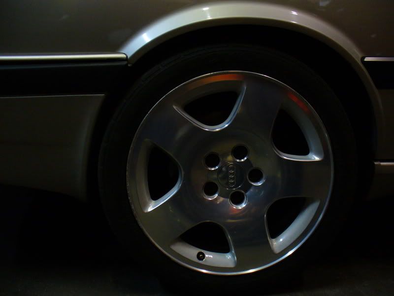

the last thing i did was toy with the front spindles.... one of the other guys here on MG (i can't remember his name, but he has the yellow URQ race car) said that swapping the spindles right to left and vise versa was worth 1.5 degrees of positive castor..... sooo i had to try it for myself :P turns out i got 2 degrees 8). the only issue now is.... the wheel sits too far forward and will cause major rubbing issues with the front plastics. no, i will not trim it because that will only help part of the issue. the tire will also hit the fender arch on hard bumps. so, the only options are... #A. tilt the top of the strut back to compensate and put the wheel back toward the center of the wheel well (which will also inherently increase my positive castor to a grand total of about 6 degrees). or #2. put it back and live with it the way it was sorta intended to be. i like the #A option, but it means figuring a way to move the strut tops back..... and i don't want to use camber plates because it's not going to be a full on track car that i want to make a ton of adjustments to. i'm looking at what it will take to create a new weld-in upper piece to hold the stock style upper strut mounts.
sorry for the dark first pic, but these give you an idea of how far forward it moves the wheels...

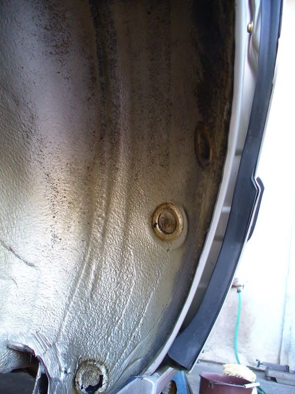

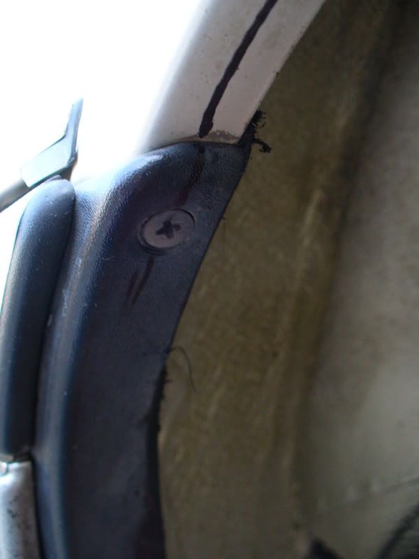

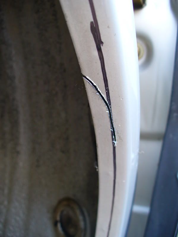

and the last thing for this update is the clearancing of the rear fender lips :D
i made tons of room and it turned out really nice.... wish i had done it this way on my alpine car.
i started of by drawing a line to follow...
then used the air hacksaw to start into my line...
i ended up just completely removing this screw..
then just trimmed it out all the way around..
