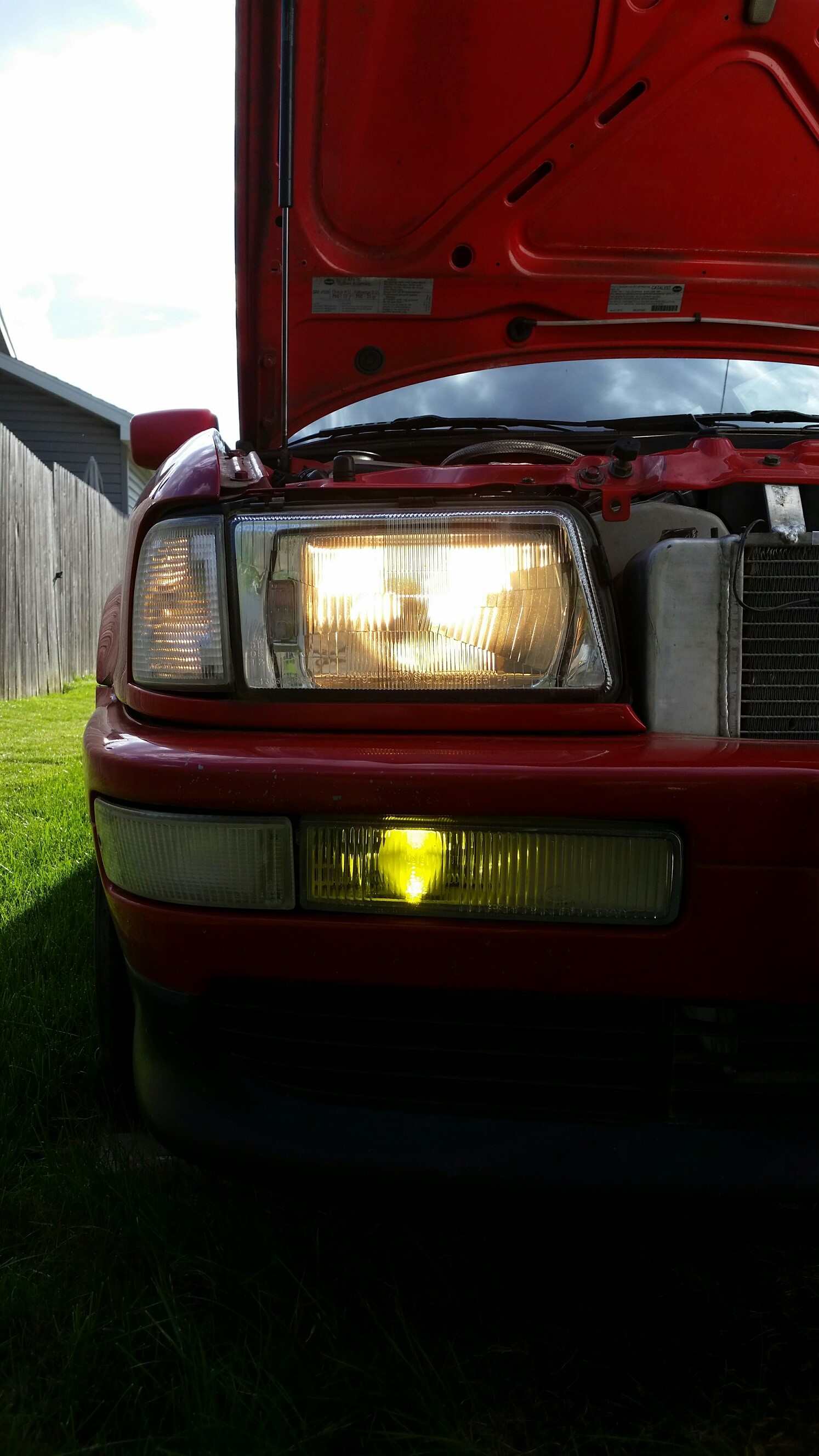

"As you wish!" (in honor of Cary Elwes and Robin Wright)

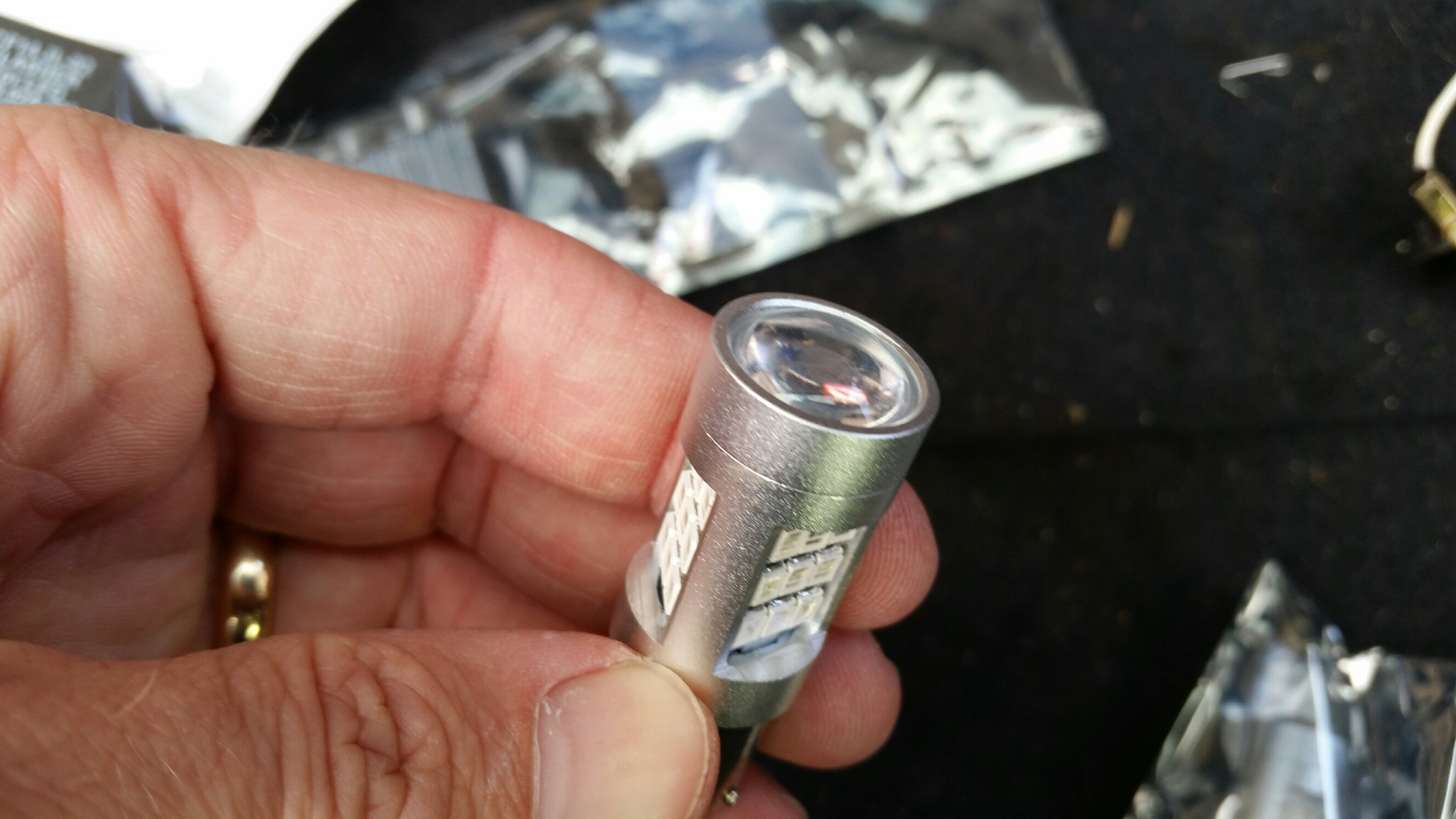

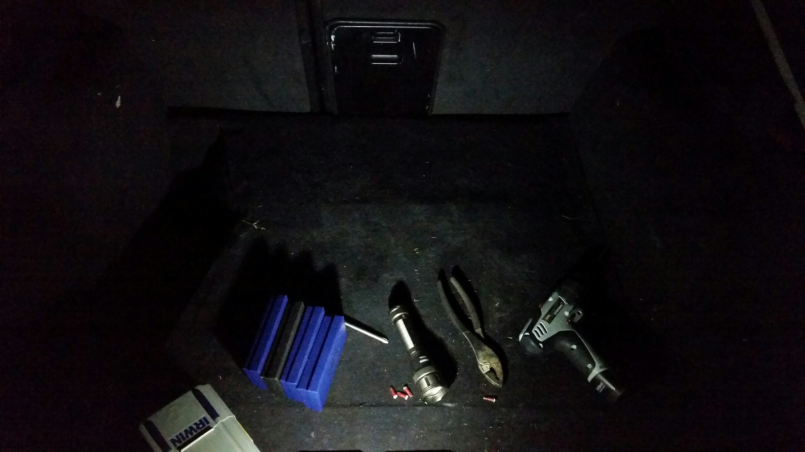

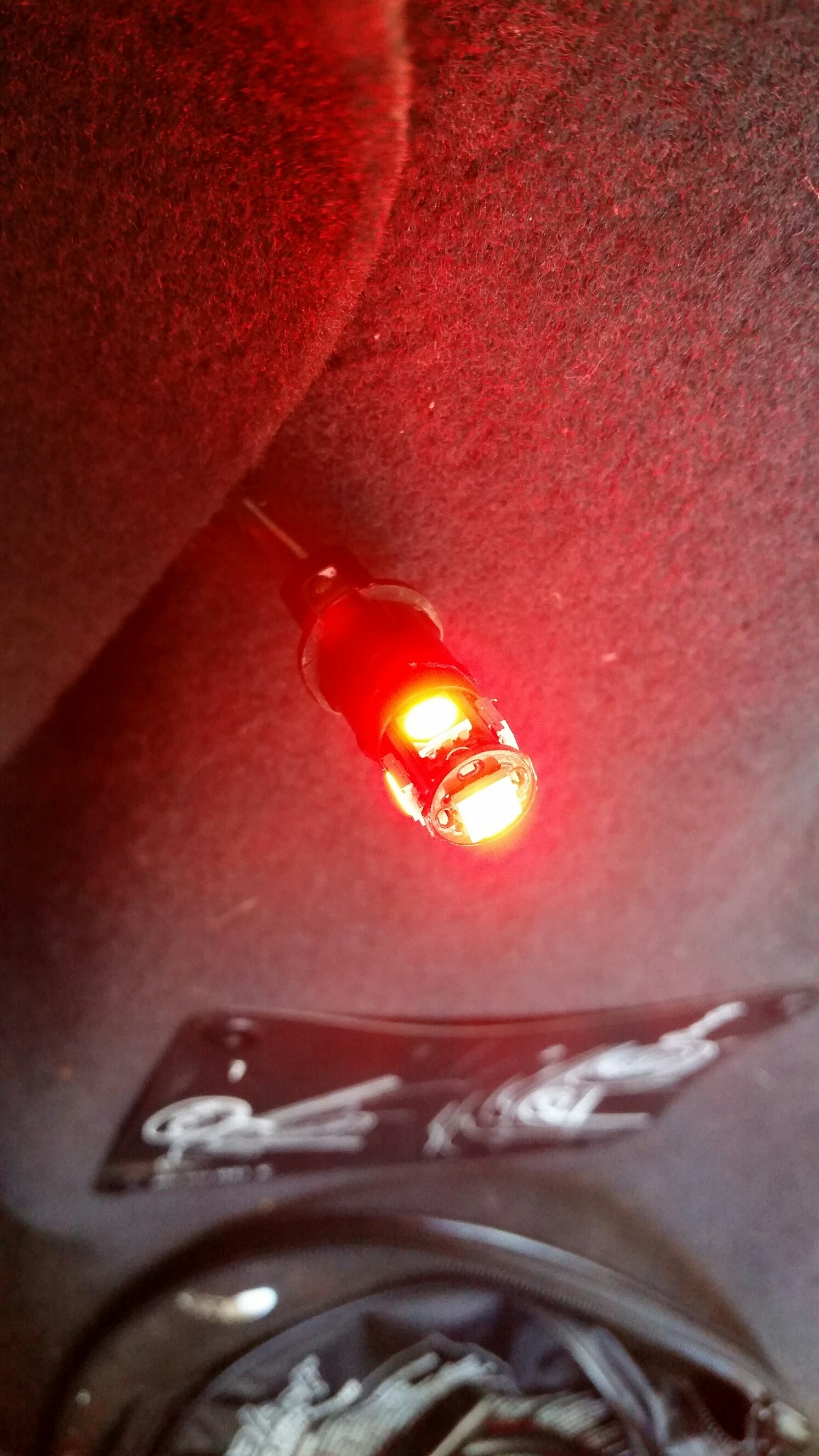

The fog lights are surprisingly bright for no voltage drivers, which with no drivers means they are also cheaper at around $20-25 for the pair versus around $60 for the H3's with voltage drivers. The headlamps are still the old USDOT units from a Cabrio with standard bulbs. They work fine, but I have been spoiled by the H1/H1 units in 00292 and the actually very good USDOT HID/adaptives in the Q7's.

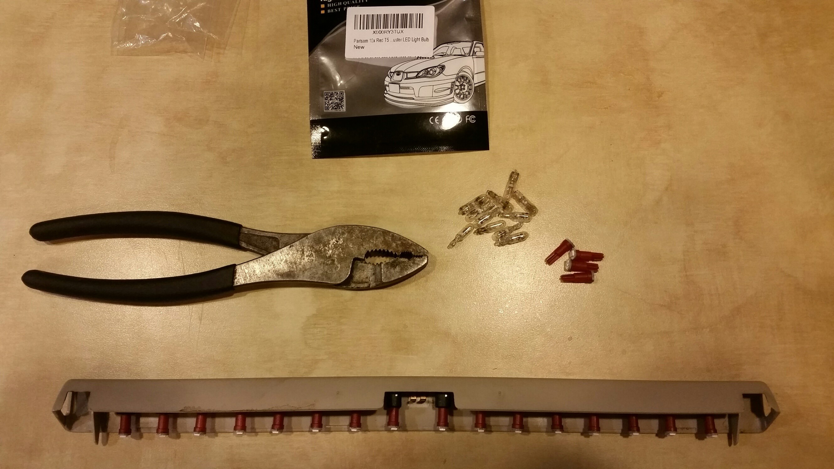

The CHMSL assembly needs the bulb holes drilled out for the LED's to fit through, and even then it took some time to get every LED lined up. The part that attaches to the glass actually just slides off and you can drill and fit off the car.

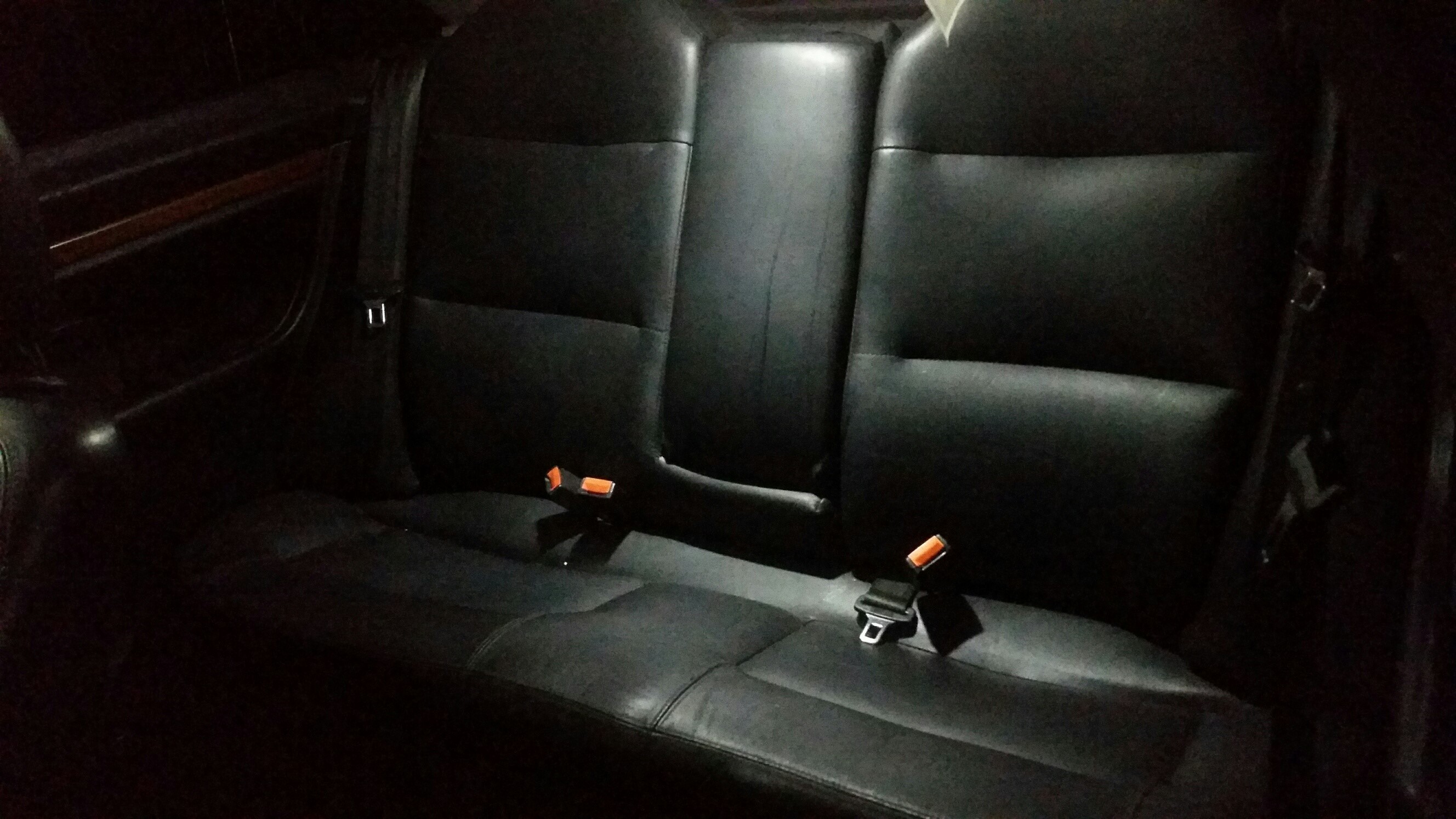

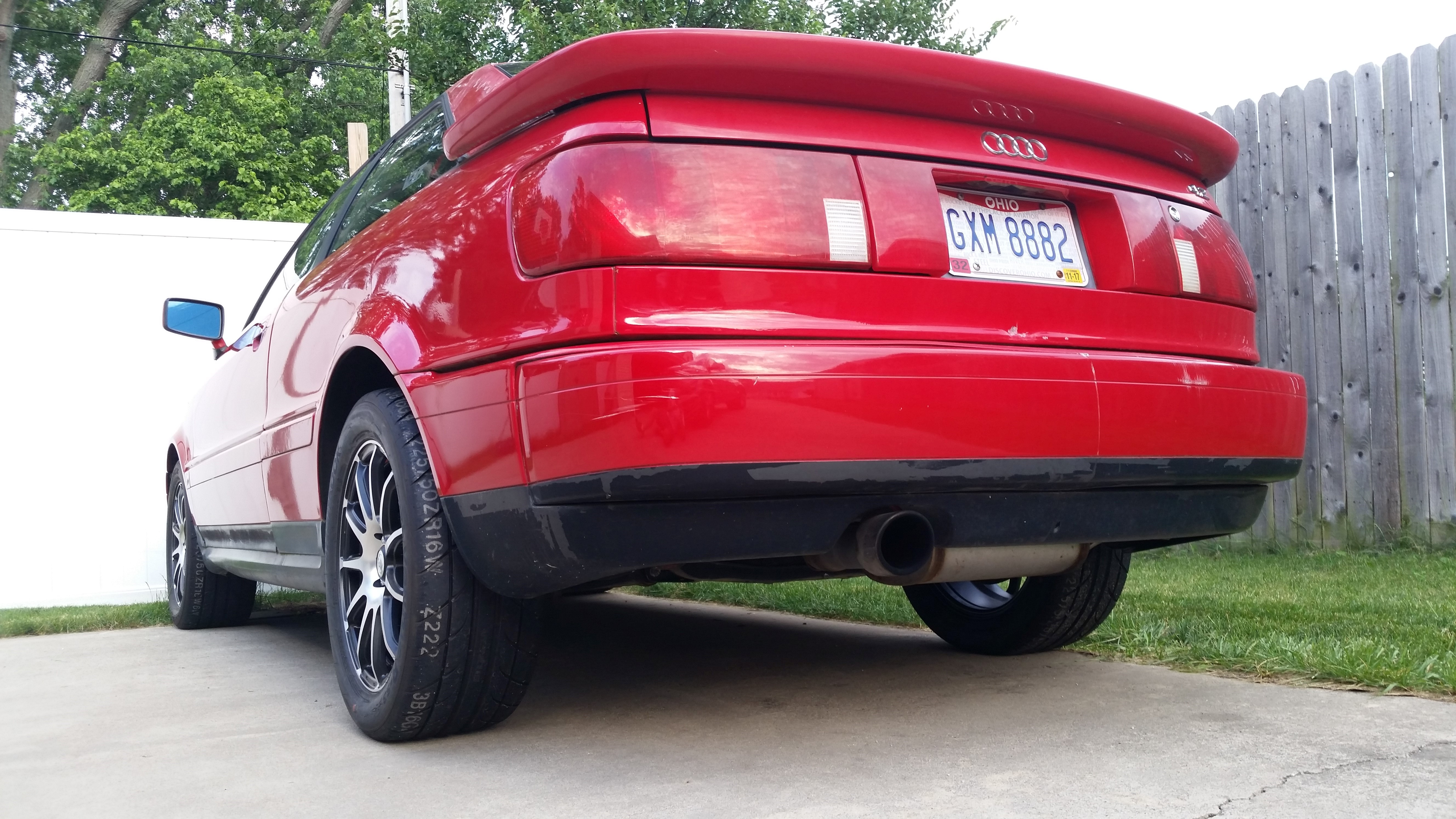

Moar pictars.
- 20170606_214603_1496800596549_resized.jpg (272.73 KiB) Viewed 109416 times
- 20170606_214546_1496800590928_resized.jpg (456.34 KiB) Viewed 109416 times
- 20170606_214514_1496800586684_resized.jpg (678.27 KiB) Viewed 109416 times
- 20170603_165554_1496800580680_resized.jpg (824.69 KiB) Viewed 109416 times
- 20170602_220940_1496800575529_resized.jpg (1.23 MiB) Viewed 109416 times

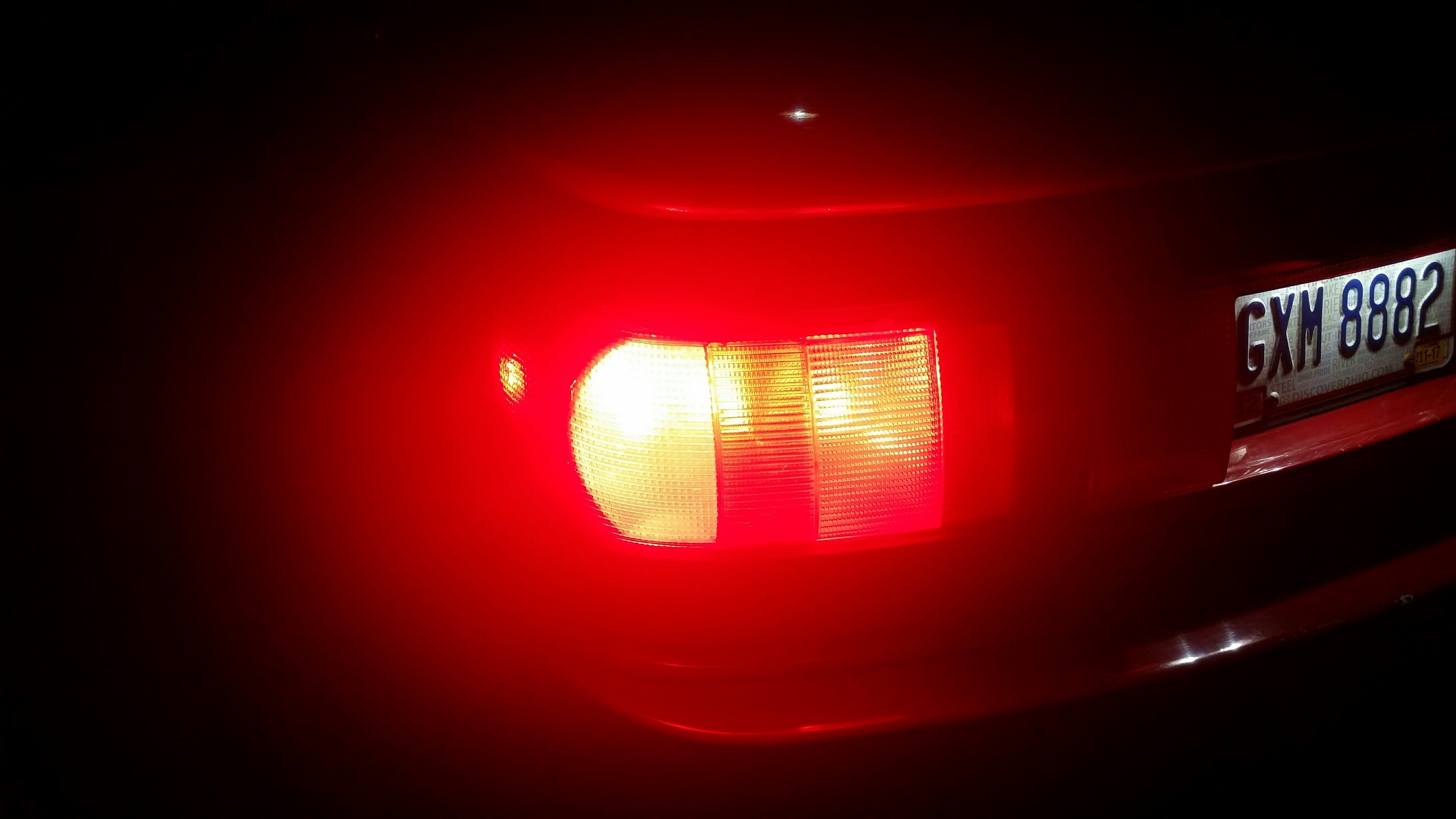

cuatrokoop
- Posts: 271
- Location: Findlay, OH
Re: Eric's V8 CQ
even moar.

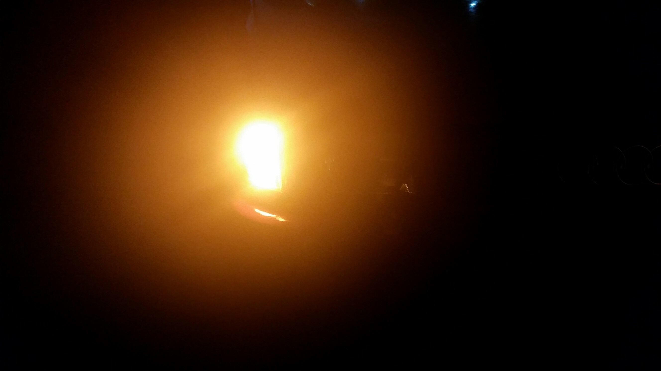

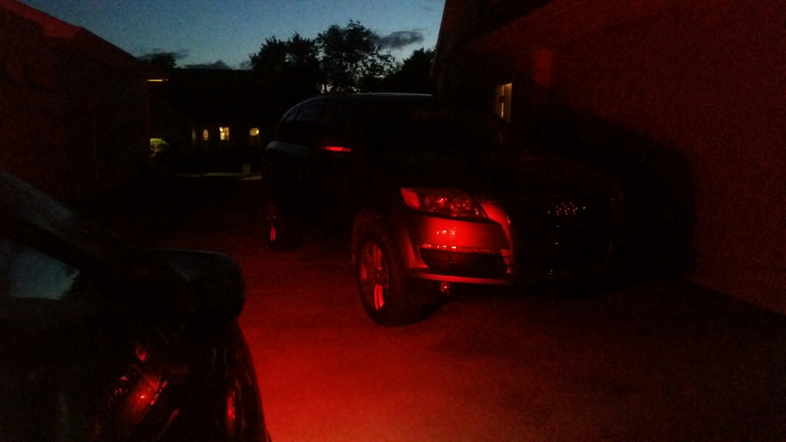

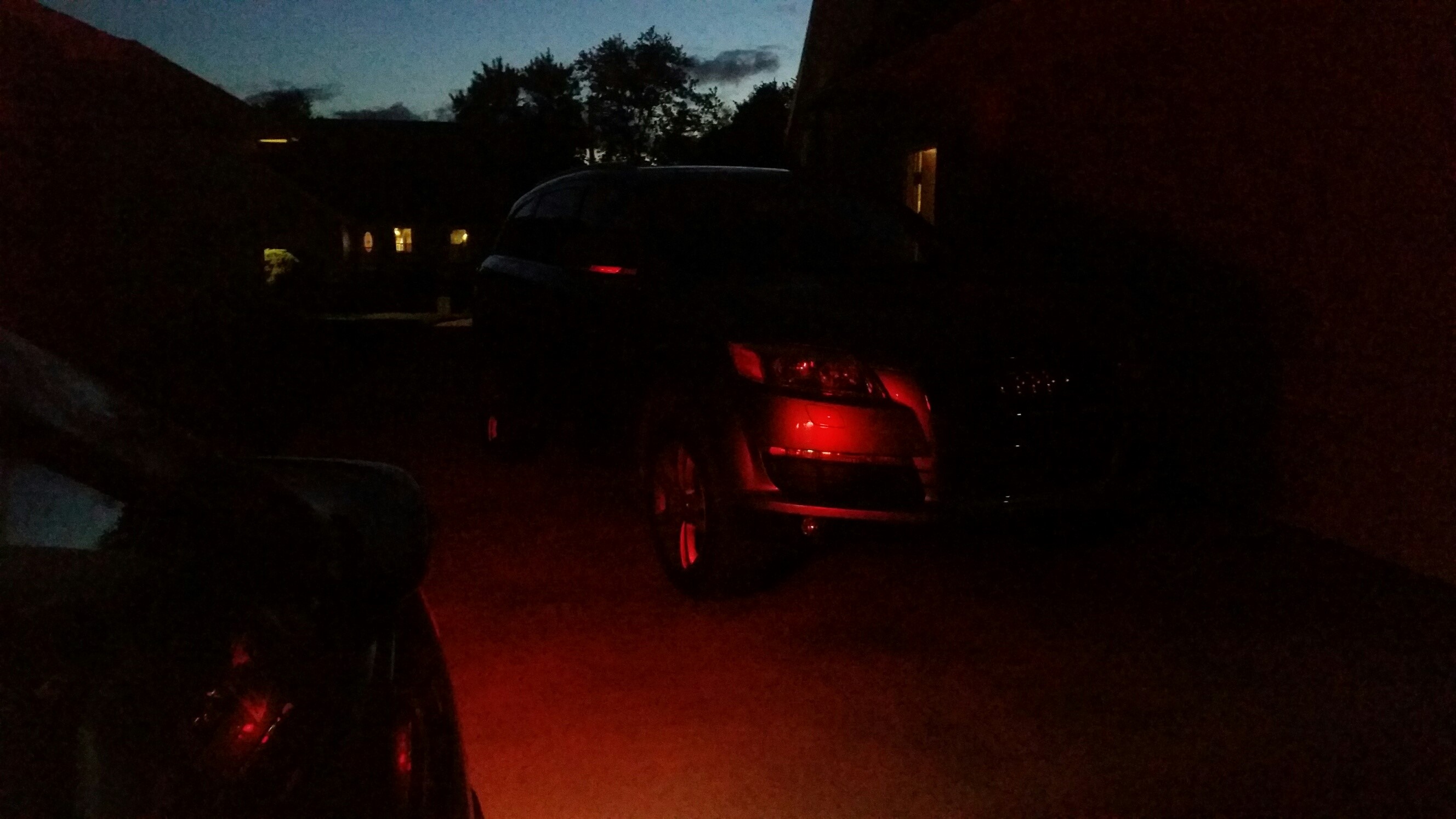

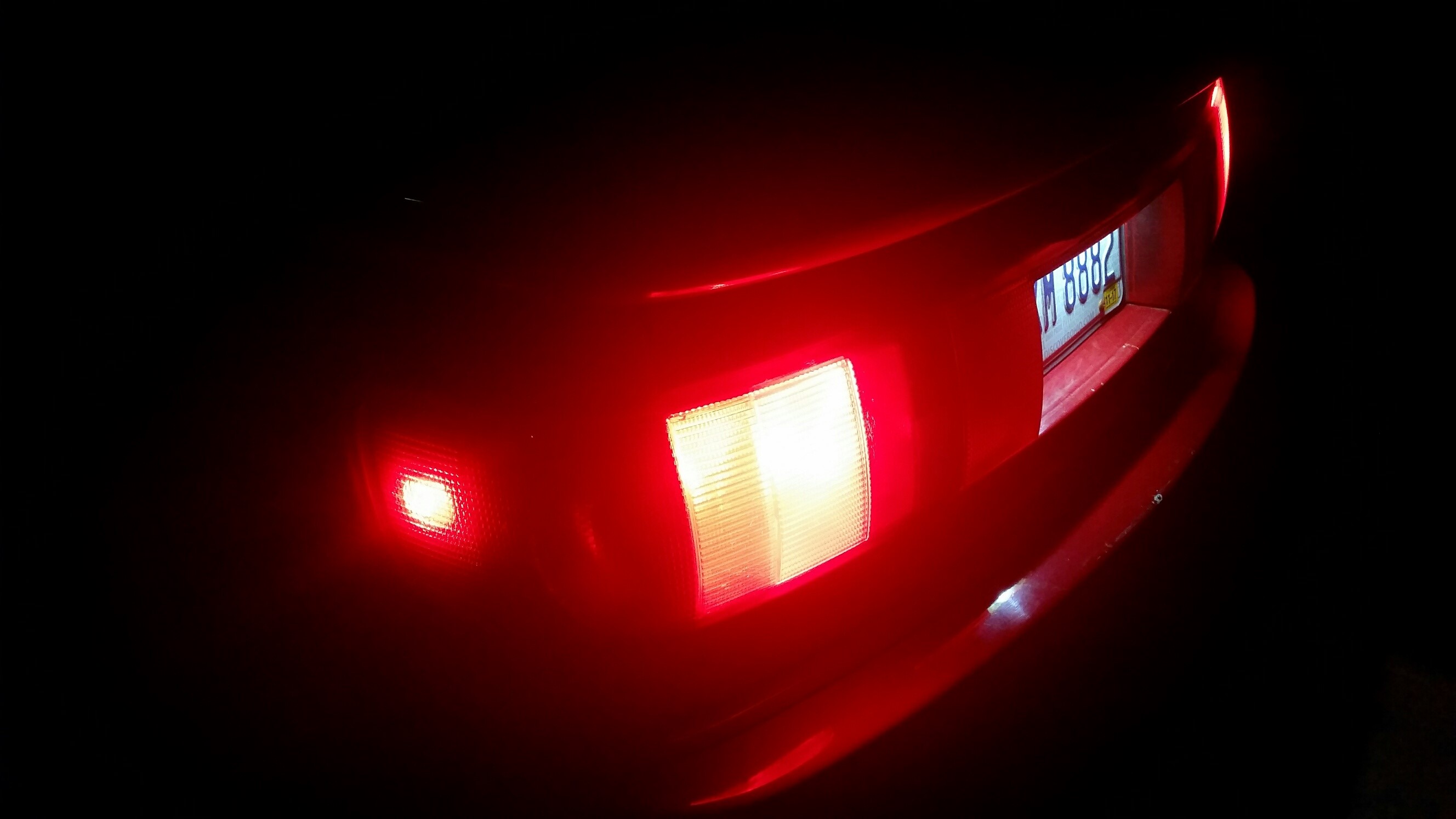

- running and brake lights
- 20170606_214857_1496800606693_resized.jpg (506.54 KiB) Viewed 109413 times
- running lights
- 20170606_214853_1496800605063_resized.jpg (464.02 KiB) Viewed 109413 times
- turn signal
- 20170606_214814_1496800603789_resized.jpg (272.23 KiB) Viewed 109413 times
- running lights
- 20170606_214626_1496800593225_resized.jpg (200.4 KiB) Viewed 109413 times

last ones
- 20170606_214711_1496800600199_resized.jpg (382.16 KiB) Viewed 109410 times
- 20170606_214701_1496800598327_resized.jpg (372.74 KiB) Viewed 109410 times

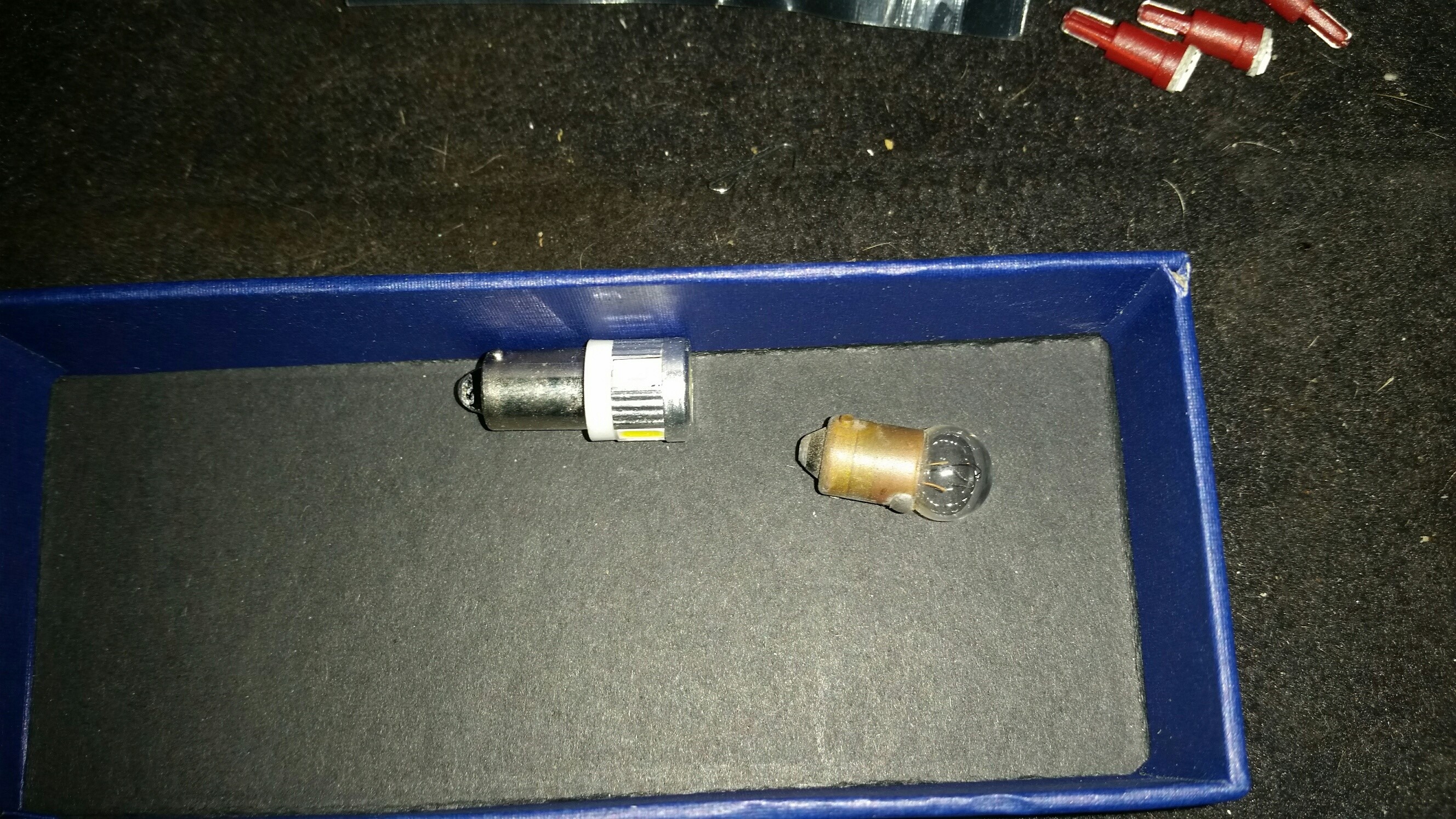

All sourced from Amazon, quantities shown. Packages came in 2x, 5x and 10x depending on the piece. Prices were $5 to $50, again depending on the piece. If you can just buy what is on my list in those quantities (you can't, you will end up with extras), you will spend $150+. But really, you'll spend more like $200 to get everything.
2x 1156 red - turn - Zhol 2835 SMD
2x 67/1156 red - running - Zhol 2835 SMD
2x 1157 red - turning/brake - Luyed 3014 SMD
16x T5 wedge red - CHMSL - Partsam 2721 - Bought 20, had three bad out of the bag! I need to contact them to get replacements.
2x 53 - license plate (must be very short!) - Zhol 5630 SMD
2x 194 red wedge - corner marker - Yorkim 5th generation 5050 SMD
2x 1157 amber - running/turn - efoxcity 3014 SMD
2x H4 white - head lamp - Nineo 7200lm total, COB, 6000K
2x H3 yellow - fog lamp - Calais 1200lm, COB
2x festoon white - back seat dome, cargo area - Cutequeen 5730 SMD
2x 53/57/BA9 white - front seat map lights (and back seat map lights if equipped) - Luyed 3014 SMD
2x 194 wedge white - city lights (not hooked up yet, need a 4-pin headlamp plug) - Cutequeen 3528 SMD
1x CF14 / EP35 flasher - iJDMTOY

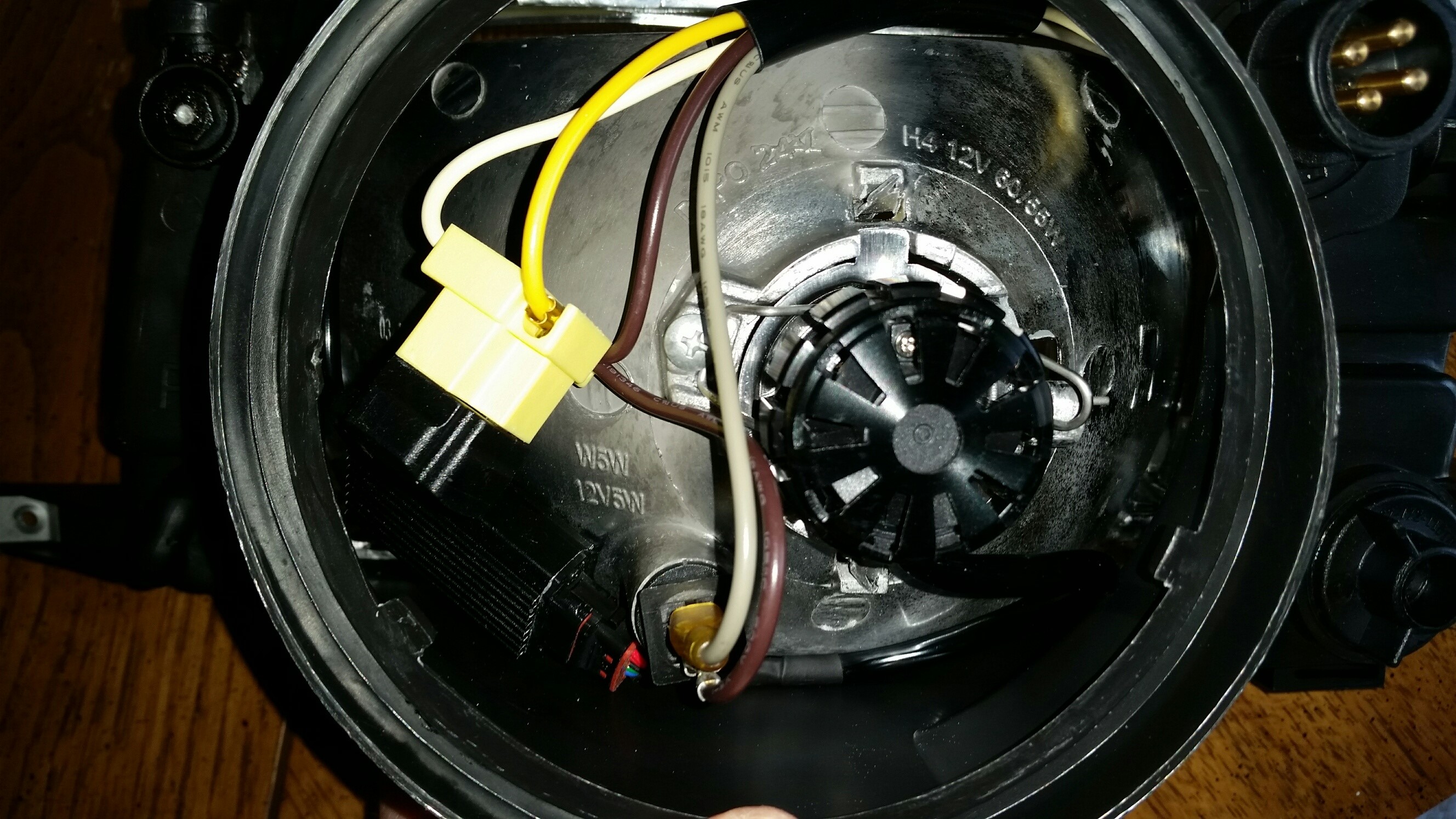

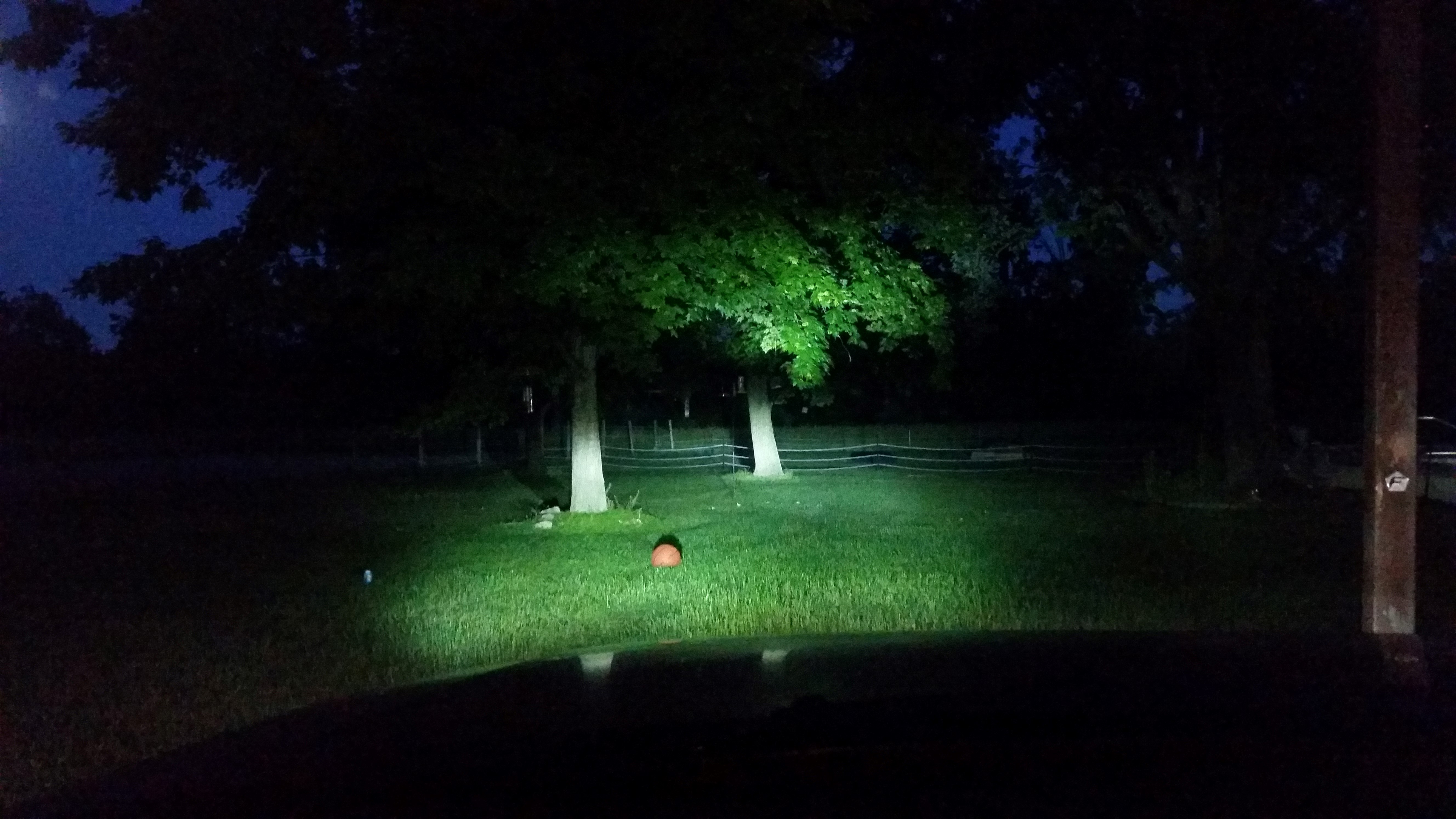

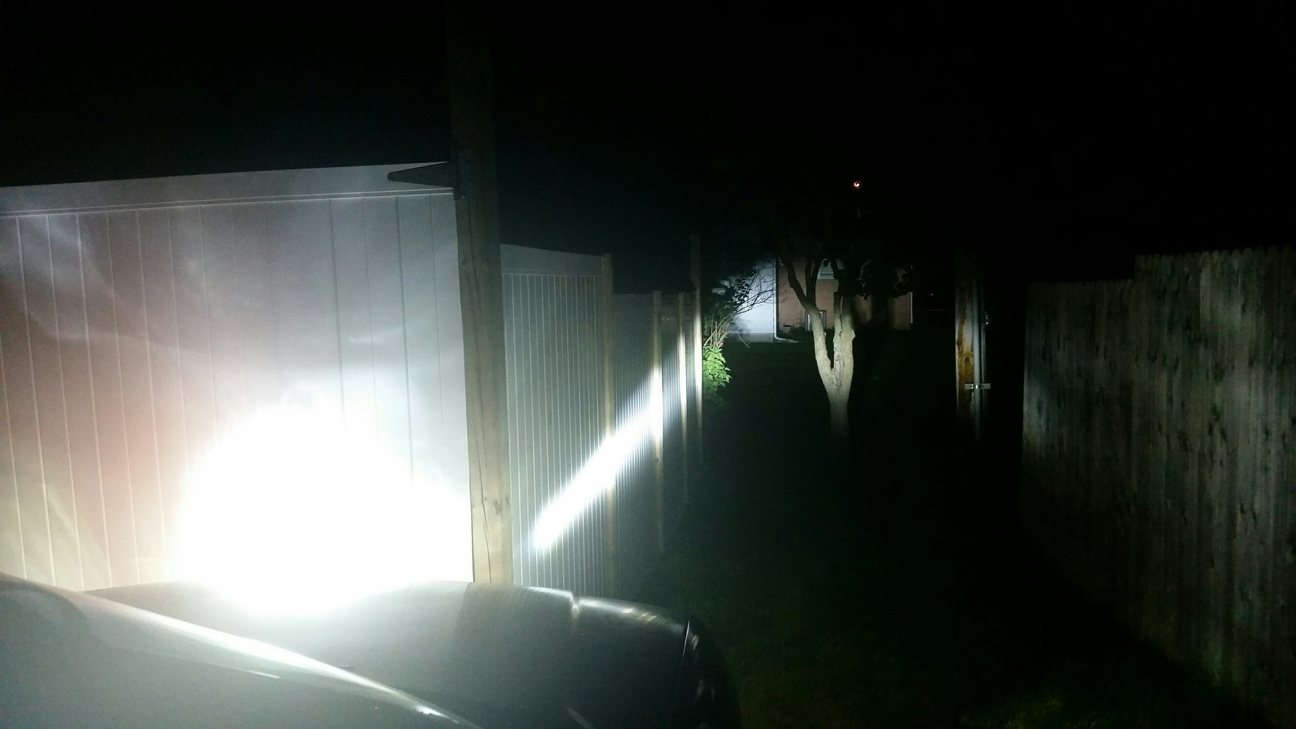

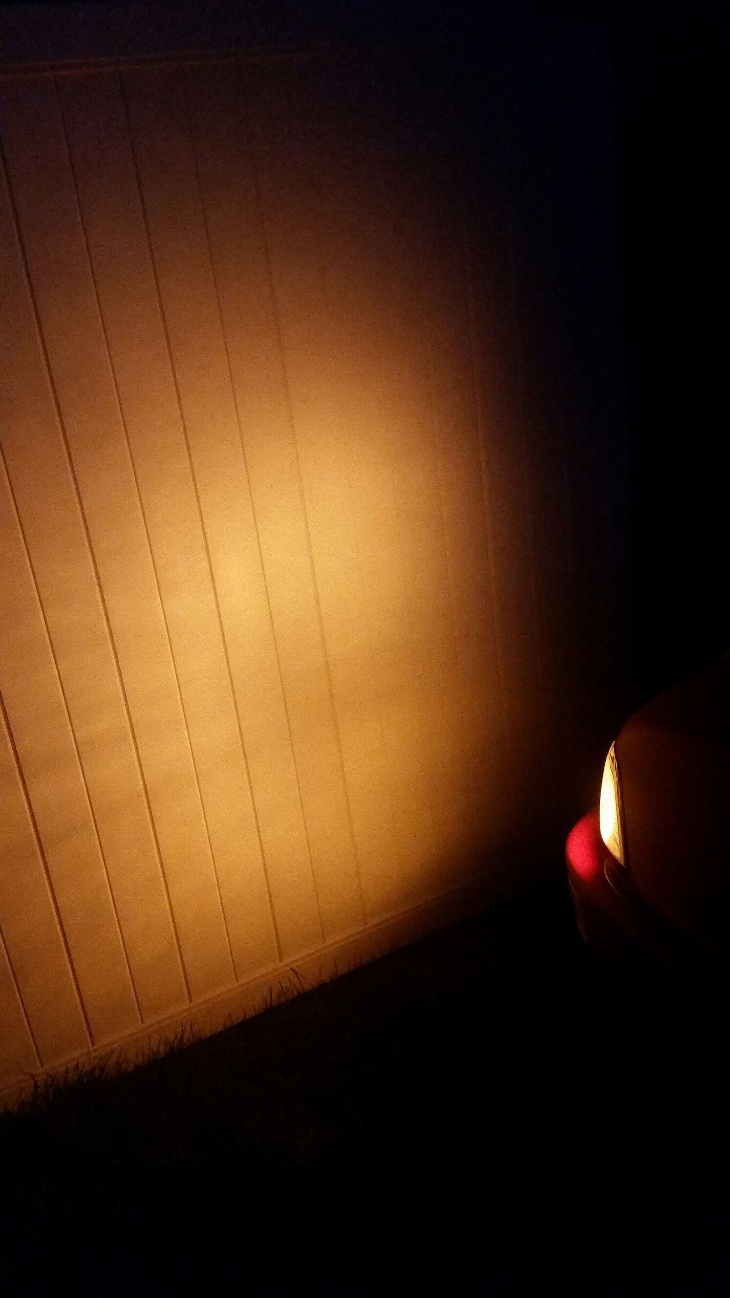

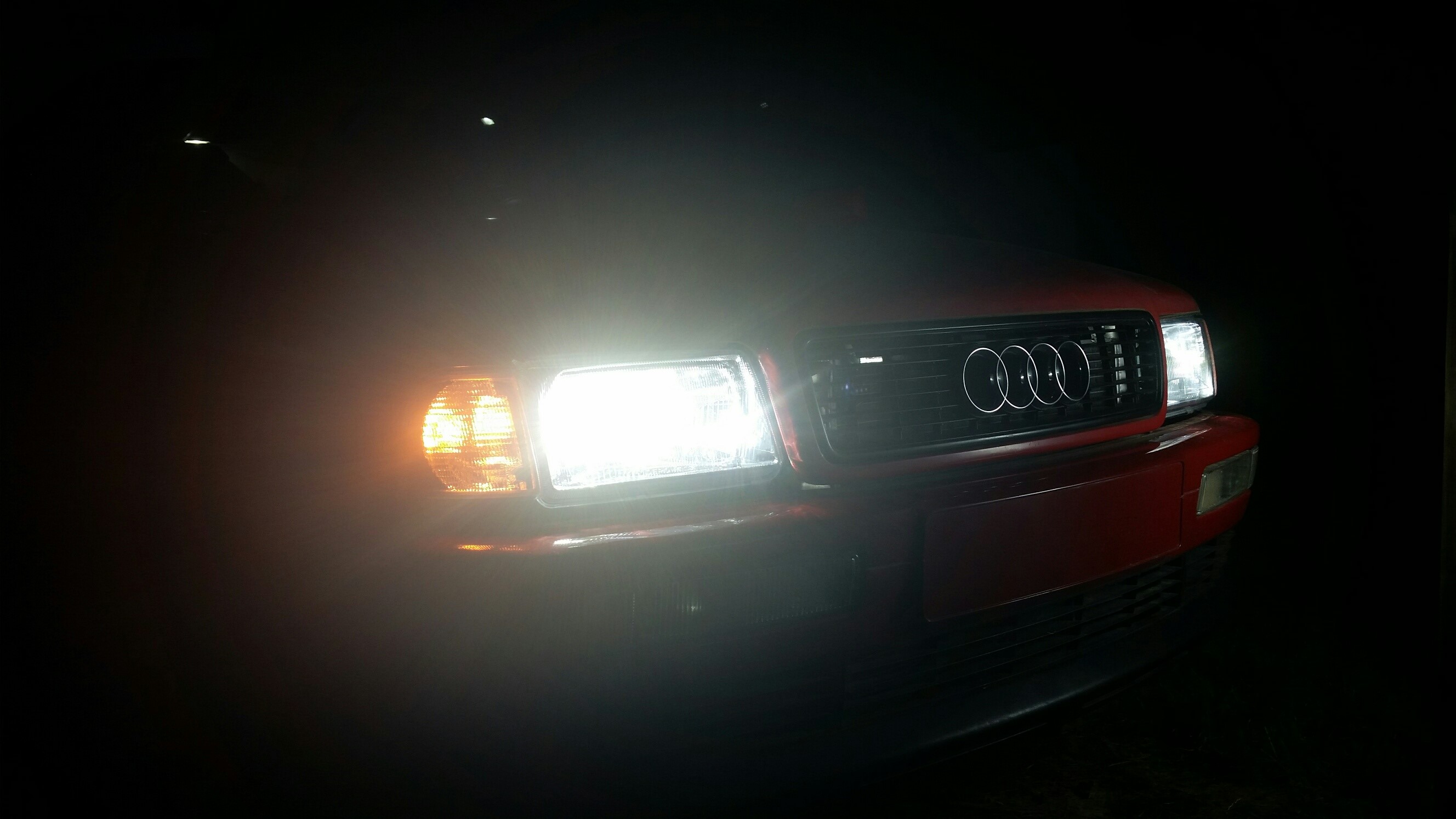

Okay, I've only driven at night once since doing the headlamps. Amp/voltage seems fine now even with all the lights on, fan(s) on and PS pump running, even at idle. The interior is very nicely lit with the front map lights and rear single dome light, super nice.
But...The LED's have an odd pattern. Dead spot, you can see the dim area part way up the tree. Also, these throw a LOT of light in the low beam position, but seemingly lots less in high. I also can't get these headlamps to aim worth a darn. I turned the adjusters a lot and didn't get much movement. Makes me think I should have just sucked it up and mod'd my H1/H1 projectors to fit around the radiator. But, I'd probably spend a lot more time, and possibly even more money, finding a LED unit that has a more continuous output, instead of chips in only certain areas.
I felt increasingly nervous driving on the old 205/60-15 tires, so I put my set of brand new old stock Hankook autocross tires on (stored inside, still stickered), which are on some Konig black/machined wheels. I don't remember 225/50-16's rubbing anywhere, but it's been a lot of years since I ran them on a stock suspension (and then only for a short while until the suspension was all replaced) so we'll see. I also almost forgot how slippery dot-r rubber is when cold on a cold street. About did a doughnut in my cul-de-sac in 2nd gear, at 1200rpm, with 40% throttle. LOL torque.
Also, when looking at the car from the side, it appears that the front subframe is shifted aft, and the rear subframe is shifted forward. I'll have to measure the wheelbase to confirm.
- 20170620_200439.jpg (2.6 MiB) Viewed 108518 times
- Odd pattern
- 20170608_214149.jpg (2.05 MiB) Viewed 108518 times
