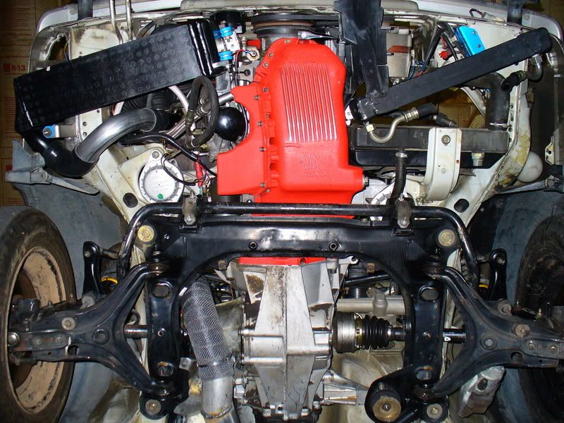

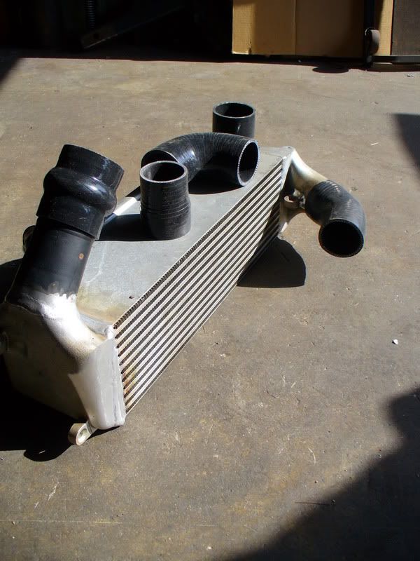

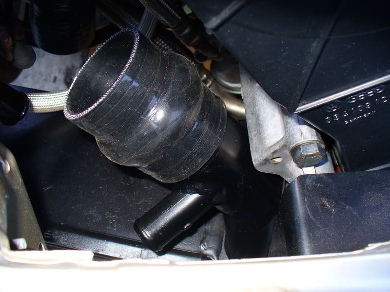

another update. it's intercooling time 8)

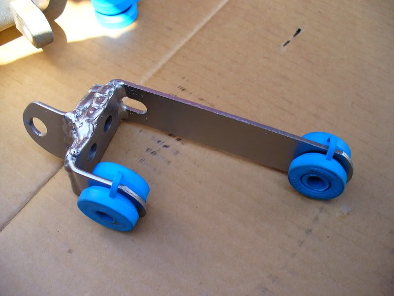

mm, silicone

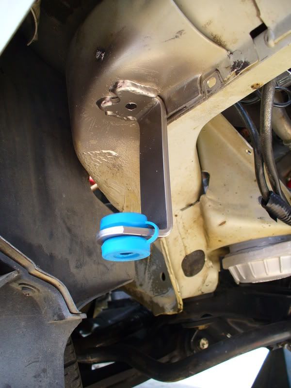

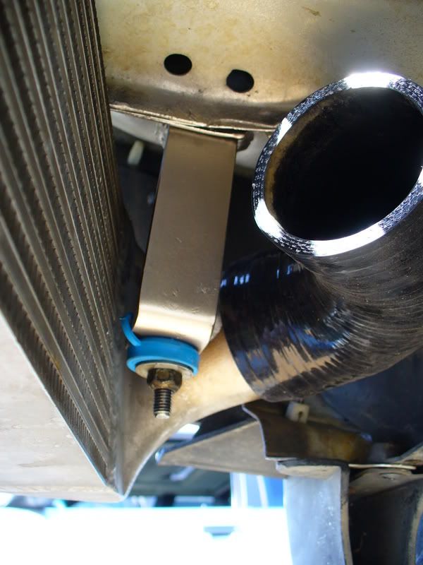

brackets to hold the IC in place...
mounts in action

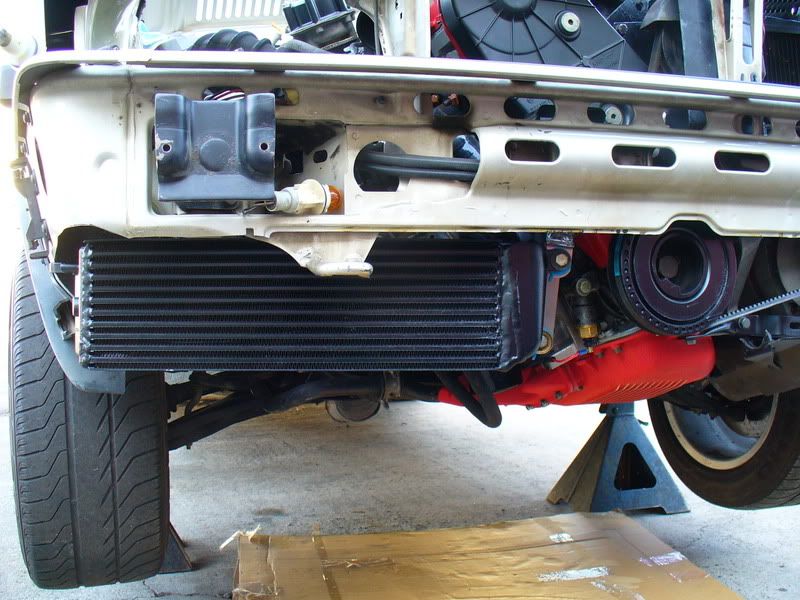

i cleaned the IC by dunking it in the chem dip to get the 2 layers of factory porsche paint off. some kind of green primer, and then the silver paint. you can't have an IC in porsche without it looking pretty

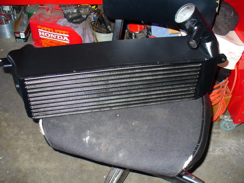

after it was all cleaned, i put a few light coats of black paint on it to make it subtle
man, it hangs in there nice!

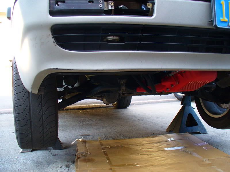

it's still a tight squeeze though
don't even know it's there

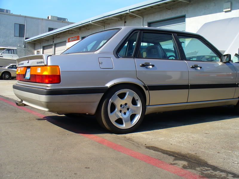

i'm really happy with the new ride height
mm, silicone
mounts in action

Matt wrote:ARe you going to cut out the plastic in that corner grill so there is some airflow or are you just going to leave it? :wink:
brilliant!

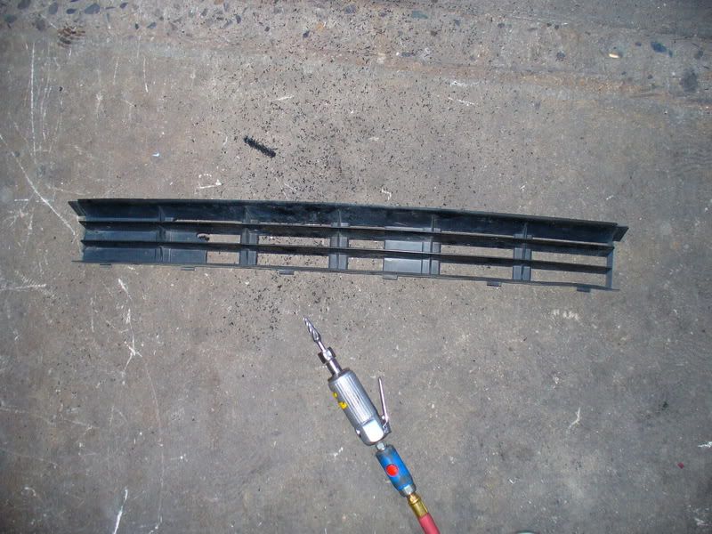

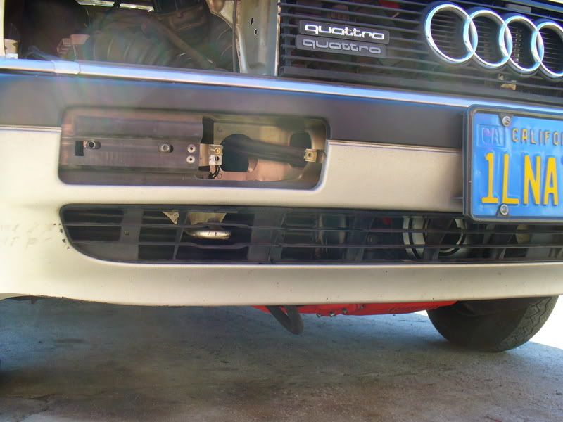

of course i'm going to trim the grilles out. i'm also going to duct the IC so the air can't escape going through it.Jim- go for it! you might have a hard time fitting the A6 fat 5's on the back of your car though with the stock 90 fender lips. these rims are from an A8 and have are an ET48... not ET35 like the A6 4.2.

okie dokie! i finished up cutting out the grille area's for airflow to the IC, but i still need to build some ducting to it so the air can't escape around it. it'll be much more effective that way.

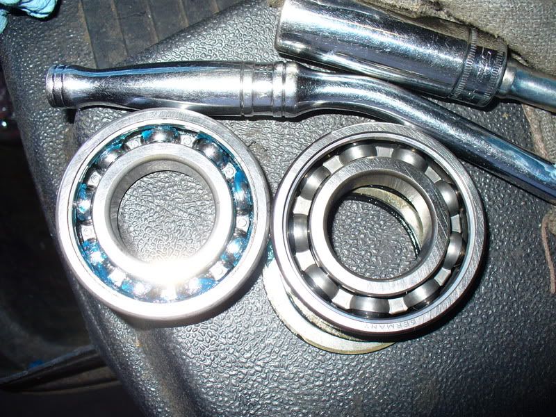

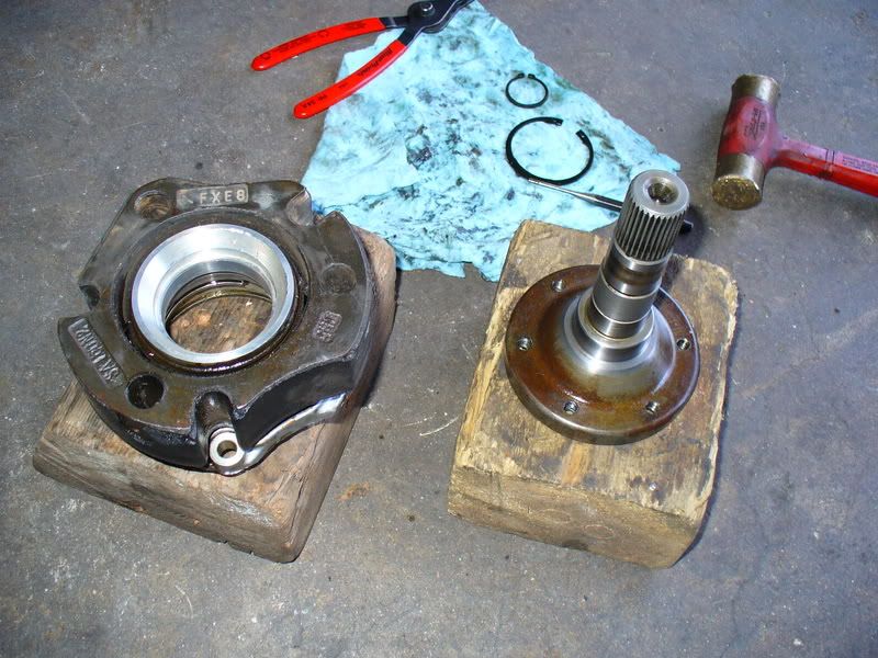

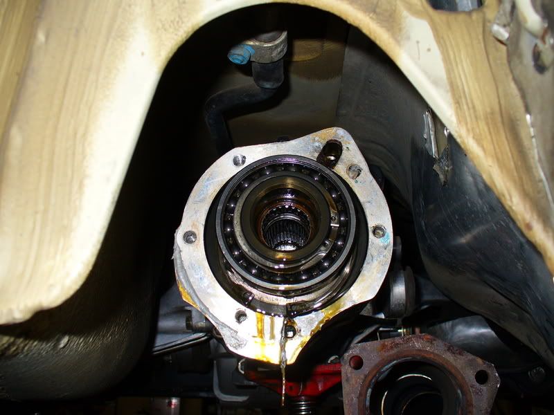

another thing i had to do was replace the rear output shaft seal on the trans as it was leaking just sitting still
. that stupid little seal is almost $40 too! when i pulled the housing off, i was spinning it in my hand and noticed it was rather grindy... :bashtard: soo i ended up replacing the tailshaft bearing and all was good then.

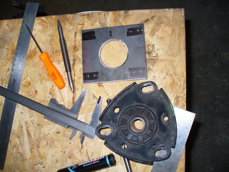

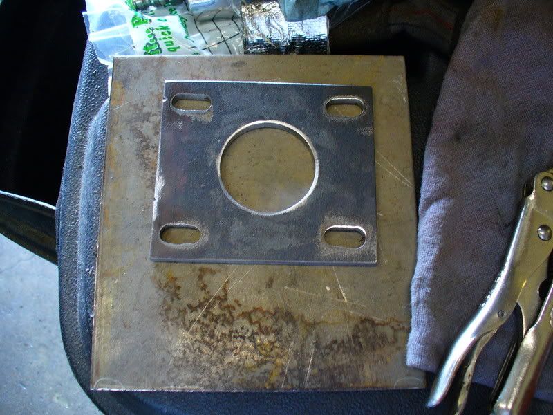

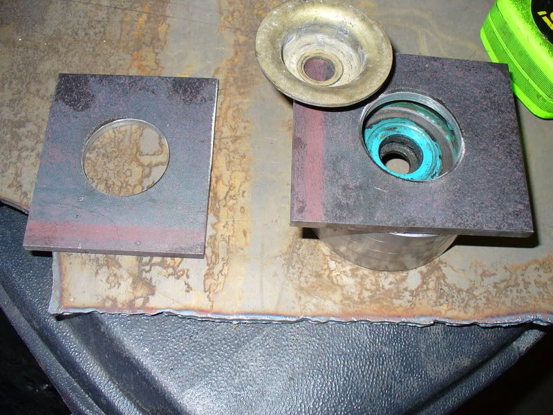

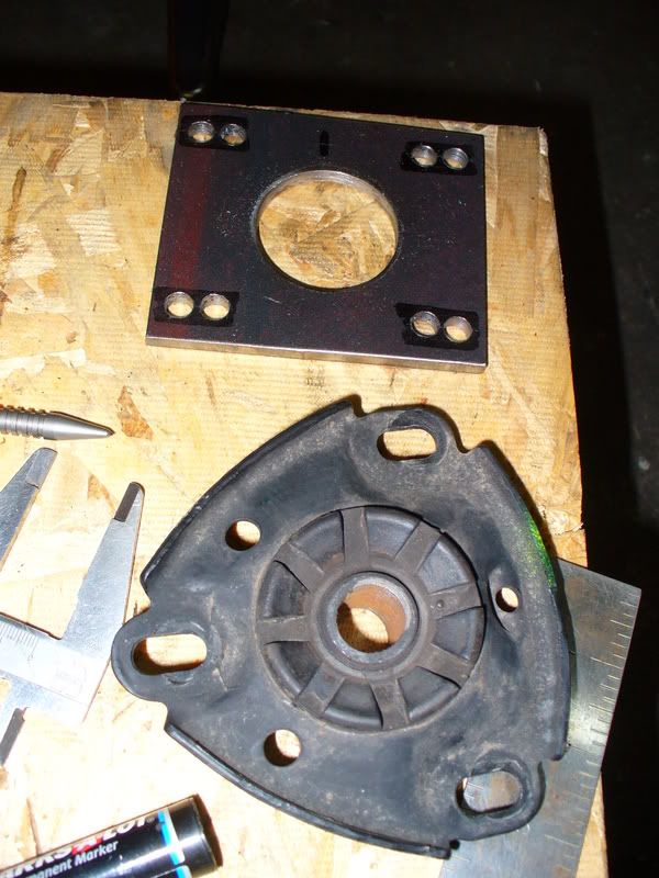

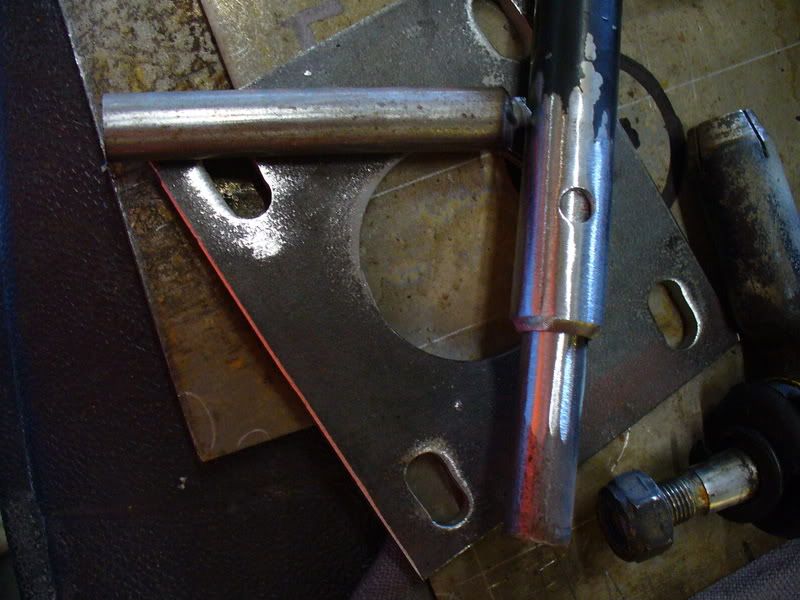

i also was thinking of making an adjustable upper strut mount so i could relocate the top of the strut rearward to compensate for the wheel moving forward with the spindle swap... but instead of rushing it this week, i think i'll stick everything back to stock for a short while and build a much nicer setup. you might ask why build one when i could go buy something... well, that's because i would like to used the stock style upper strut mount with my mance mount savers. plus it's cheaper to make the stuff out of steel than to pay for CNC'd billet steel stuff
here's what i made so far...

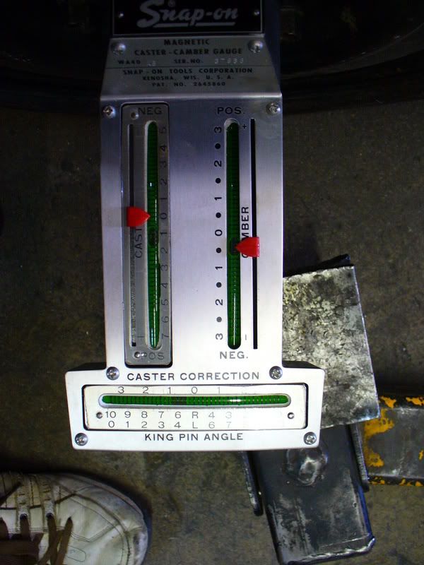

my dad still has some of his equipment from his racing days.. so i checked some of my current settings 8)
my car has 1 degree of castor, which is the top end of the factory spec... otherwise zero degrees is normal
. i hope to end up with about 5-7 degrees once i'm done with my strut mods.
the other thing i had to do was shorten the tierods from the steering rack because of the relocating of the steering arms on the struts being moved inward... and with max inward adjustment, i still had probably 3/4" of toe out
so i just cut the arms, made an insert, drilled some holes for plug welds and then had them TIG welded. i cut about 1.5" out of each side... and i think it was a bit much as i'm now at the other end of the spectrum
almost max outward adjustment and the wheels are just barely even with each other.

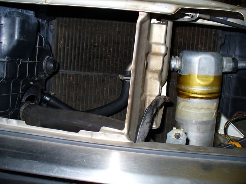

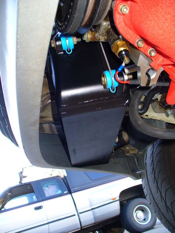

one other thing i've been trying to figure out is where to put my crankcase breather container. over the weekend jeff (larryflint) stopped by with his 3.6 v8 powered 4kq and his new cage for me to check out, and he suggested putting my breather tank in front of the radiator... which as it turns out, is a great idea
thanks jeff
. i hope to end up with about 5-7 degrees once i'm done with my strut mods.the other thing i had to do was shorten the tierods from the steering rack because of the relocating of the steering arms on the struts being moved inward... and with max inward adjustment, i still had probably 3/4" of toe out
thanks jeff

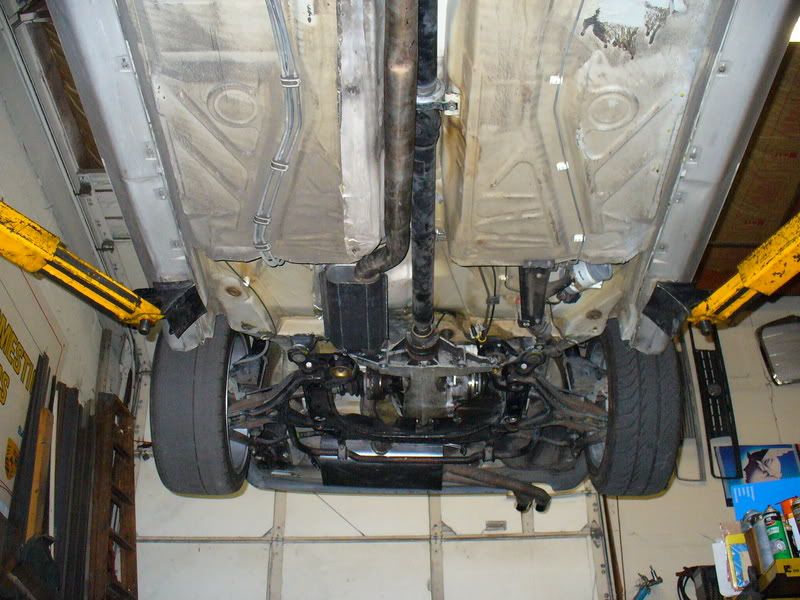

not a lot of guys would just whip up a set of adjustable camber/caster plates because they can (because they can't)
now that LarryFlynt has a roll cage he can drive with all 4 wheels in the air :woowoo:
