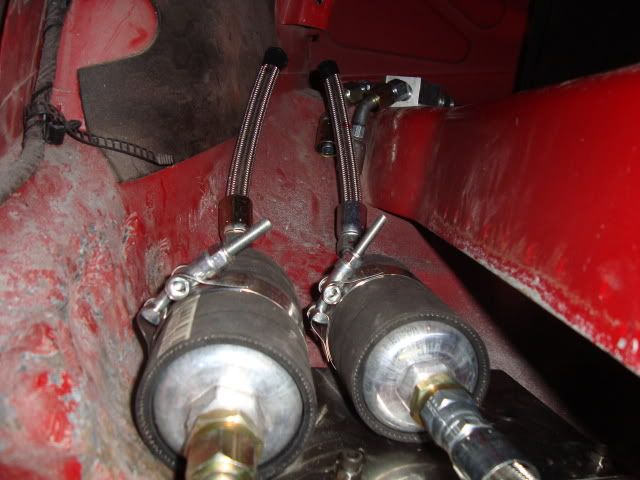

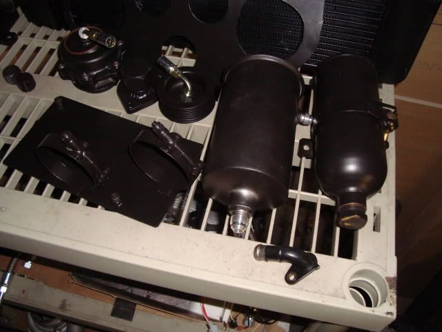

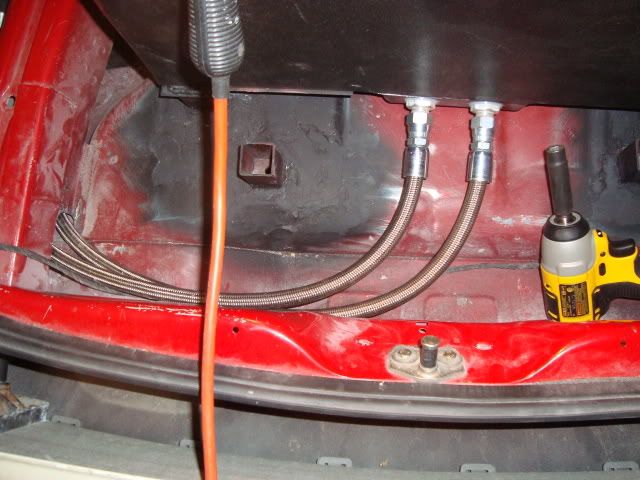

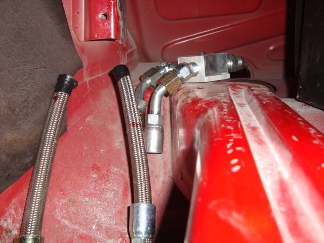

so, i decided that i didnt like the way that i was going to do my fuel system, i set it all up a few months back, so i re-did it.
first, i decided that i wanted to mount the pumps to a plate using tbolt clamps and mount that plate to the floor, so it was solid and easy to put together and take apart. also, wanted to have the pumps below the sump. so had my buddy make me a plate with two tbolt clamps welded onto it, theyre not welded TO the plate, they have a strap going over them so that they can be adjusted angle wise. had him weld bolts to the plate and then drilled holes to mount it to the floor. add some rubber hose around the outside of the 044 pumps to cut down on vibration a bit and thats that.

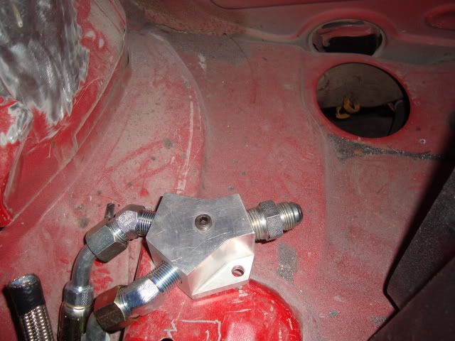

-8 to the pumps, -8 out to the Y-block, and -8 all the way up to the rail, ss braided the entire way. i had a piece of solid ss tube to run under the car, but then thats two more fittings that need to be bought and its just as easy to run braided the entire way.

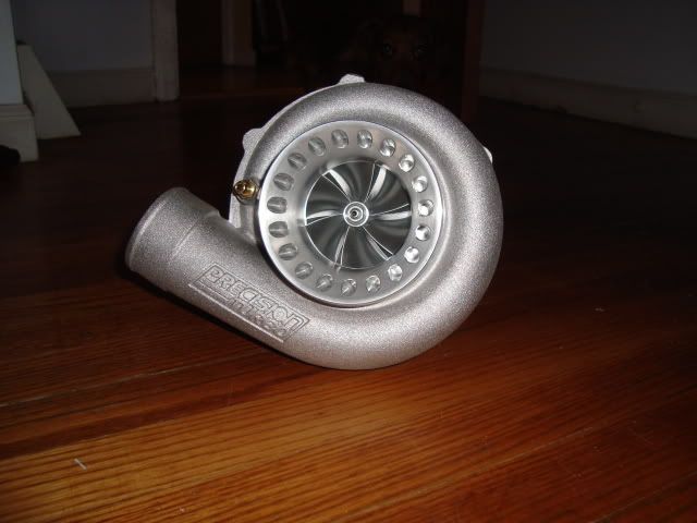

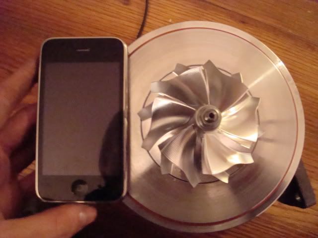

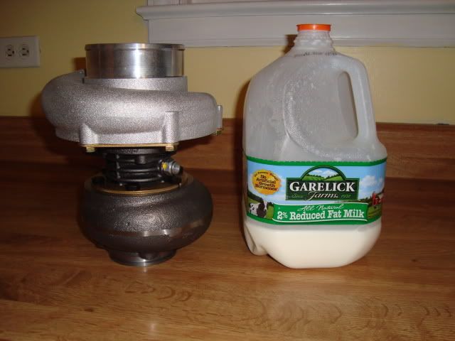

so, i got my turbo today....thanks to clay@CTSturbo for the hookup this thing.
specs.
.70 a/r compressor housing
billet compressor wheel
ceramic ball bearing
.82 a/r exhaust housing
three inch v-band outlet
i dont want to say what type of power this will make for me, all i will say is that it will be alot, lol.
death 4kqt
Post by death 4kqt »
good god!
O2VW1.8T
Post by O2VW1.8T »
Thats sick, that turbo should make plenty of HP.

Frank the quattro tank
Post by Frank the quattro tank »
That milk looks old :wtf: . Nice looking turbo!

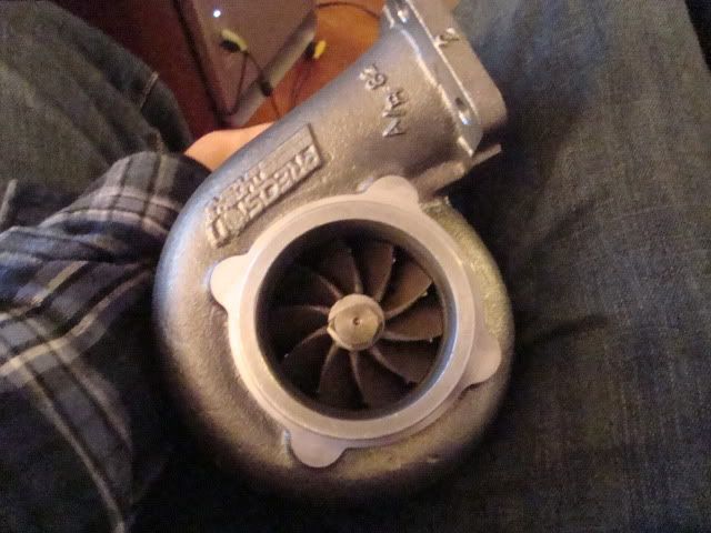

Post by glibobbo21 »
why isnt it tapped for a dp, or have a vband?
Justin517
Post by Justin517 »
looks like a v-band to me. :?
Zerb
Posts: 858
Post by Zerb »
vband casted into the exhaust housing.
.... that is sexy....
Posts: 659
oh i only saw the straight on shot lol..whoops

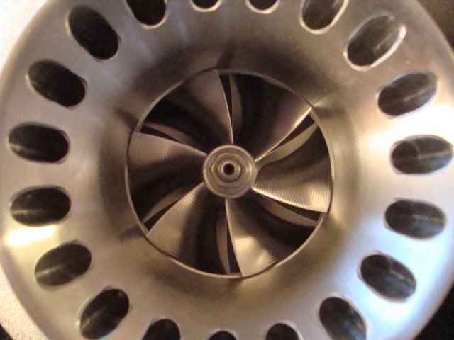

Zerb
Posts: 858
Post by Zerb »

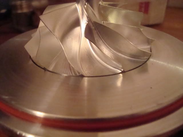

two more, just cause its that tits...
RSCoupe
Posts: 217
Post by RSCoupe »
That impeller wheel is :drool: !!

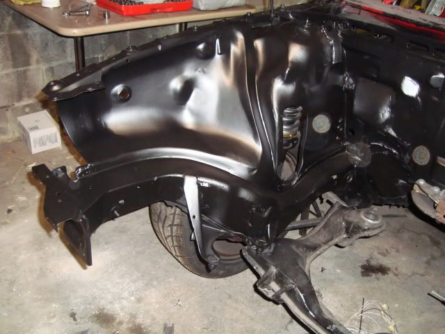

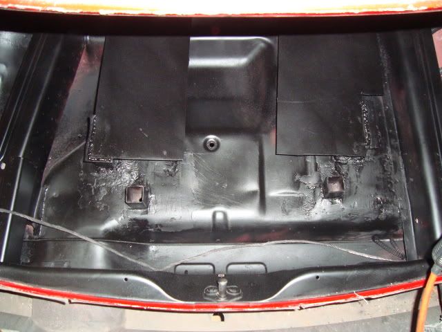

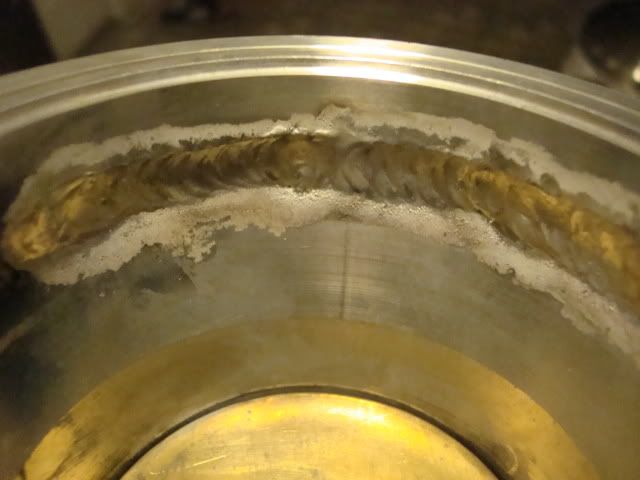

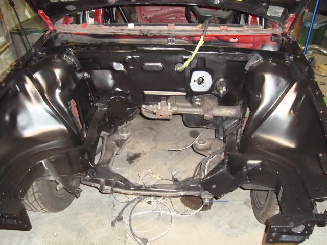

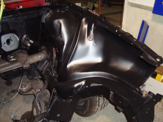

ok, so painted the bay today, started in the trunk as well. also got alotta stuff powdercoated. head will be here assembled tuesday, then i can put the long block together. paint and assemble. :woowoo:
bay/trunk
powdercoated pile

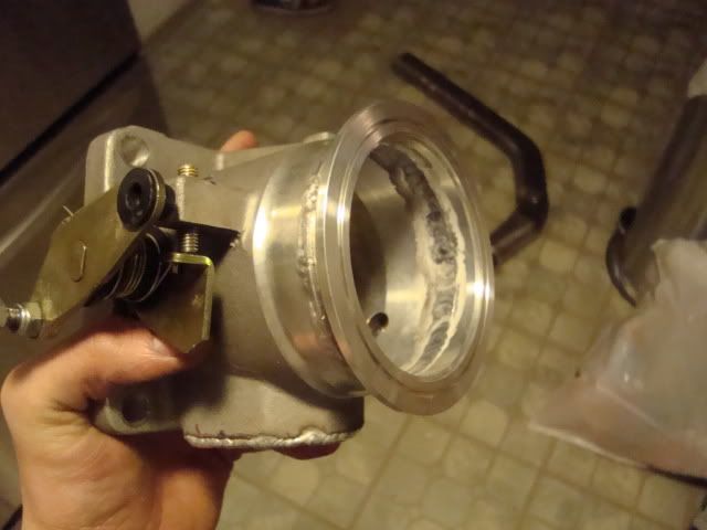

3 inch vband on the throttle body
