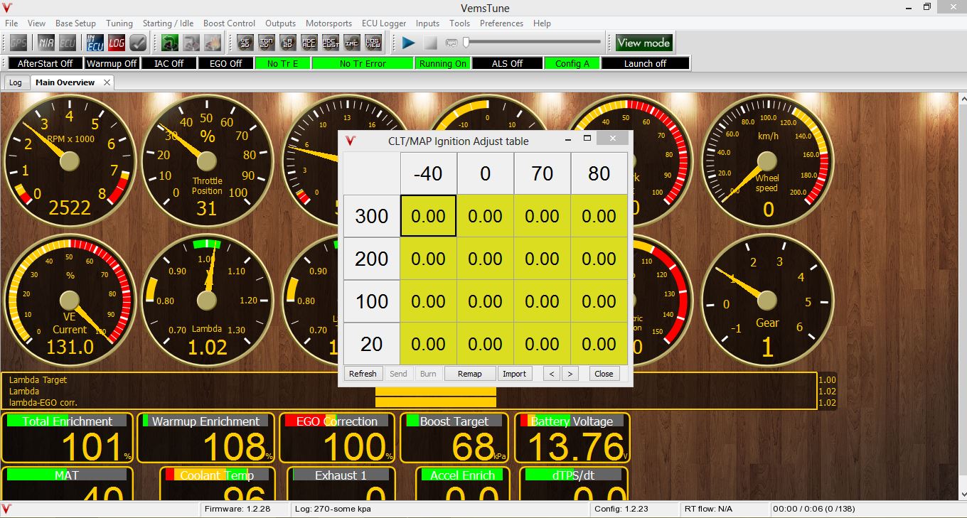

Any time, happy to help! I just looked at your CLT table and it is all zeros, so that probably isn't the reason you're seeing power loss.88a5tq wrote:Thanks a ton Chris. Truth is I'd be barely anywhere with this standalone without your educated assistance. Anyone who can't admit that is a dick lol. I absolutely didn't know about the coolant facet of timingReady to learn!

Also, good that you have a 1.8t IAT sensor. Do you know if it's calibrated properly?
Oh boy. All I did was start using the new OEM 1.8T table values as per Marc

OK, you should be good then if you got them from Marc.88a5tq wrote:Oh boy. All I did was start using the new OEM 1.8T table values as per Marc

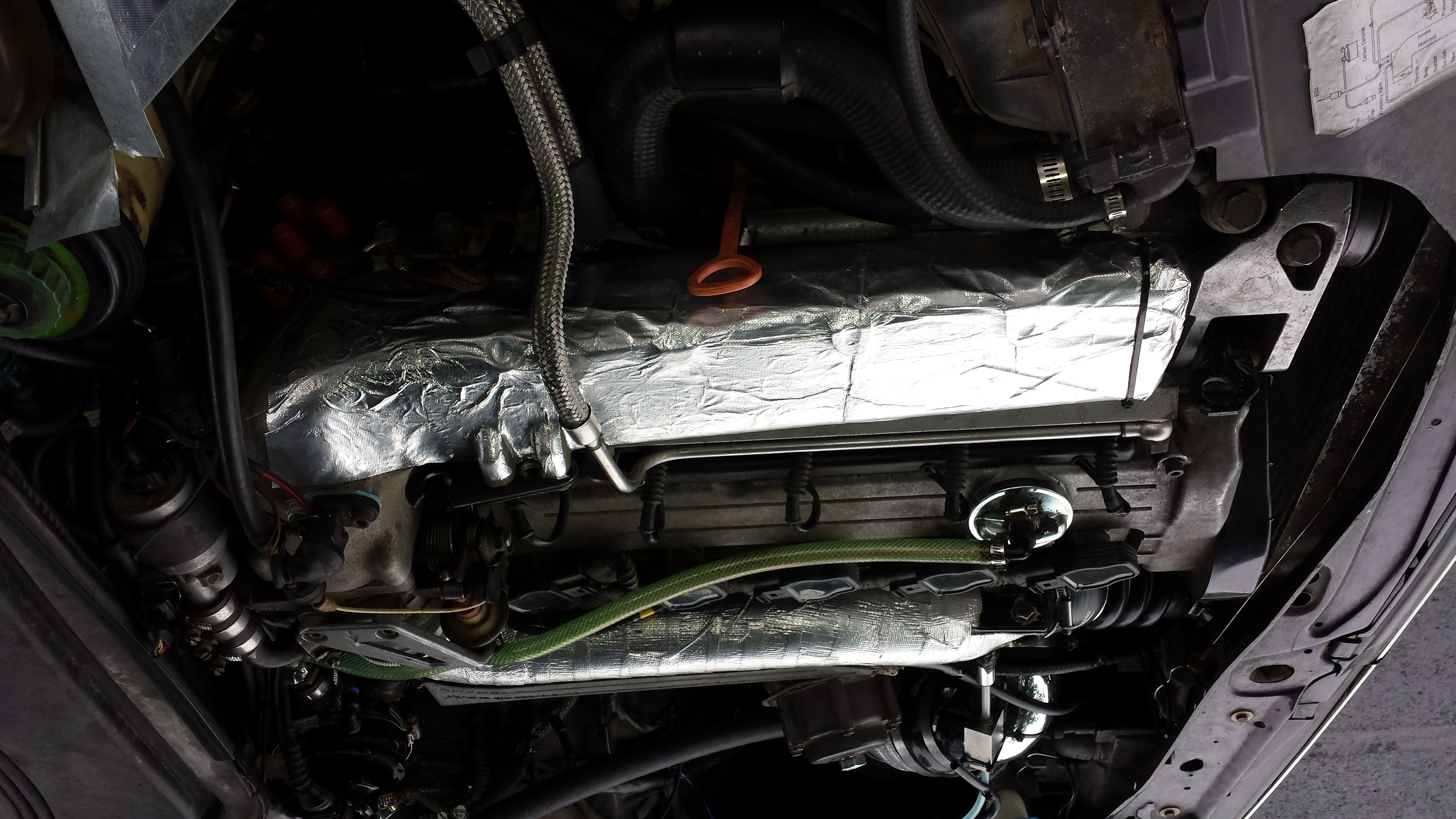

I bought a sheet of DEI reflect a-cool silver to put over the hottest area of the cyl #1-3 IM areas. In the winter I had frost (from w/m) on cylinder 5 of it by the IAT sensor lol. Always made me smile when opening the hood. The DEI isn't insulated but only reflective in nature which I believe us the best approach for the manifold. Still waiting for my free 034 BPV seals that shipped 8 days ago

I went partial retard on the IM after work. Enjoy a laugh
Should block radiant heat from the coolant manifold. I think I should've used the same material when I wrapped the pre-throttle body pipe as well. *not a show car*

I like that actually. I'd be curious about the thermal properties of that material. Do they advertise any values for heat transfer properties?
Coolant gauge reading is staying below half range. I think the IM was acting as a huge heat sink. I'll check that out chris!
So far WOW. Gonna redo the other pipe too
Nice! If you really want to get serious with it you could get a phenolic spacer too. It really does help keep the IM cool.
Withstands 400 f direct and 2000 F radiant. The gold tape can do 850 direct. Was considering putting it on the turbo cold side heat shield I put in 2 days ago until I saw the 400 direct part lol. It says need virtually no clearance. Sounds good. I thought about that chris but it didn't seem in my budget when I did the HG. And now I don't feel like taking it back off lol

No I suppose youre right about the 400 F. The housing has maybe a 1/4 inch between it and the header which has exhaust wrap somewhat "draped" over/on it. I was posting off the package of the 2nd one I bought outside of advance auto here since that was the extent of the info. Was just on the website and theres no further info there either. Dead end. The gold tape is WAY more expensive so Im skipping that. Im very pleased with the results especially since a 12" x 24" sheet was $22. The tape I used on the charge air pipe has a fiberglass layer underneath which may or may not be useful since the w/m nozzle is at the very beginning after the IC. Maybe its holding the cooling effect of the solution within the pipe or maybe its keeping the hot turbo air from cooling further via convection? Whatever
