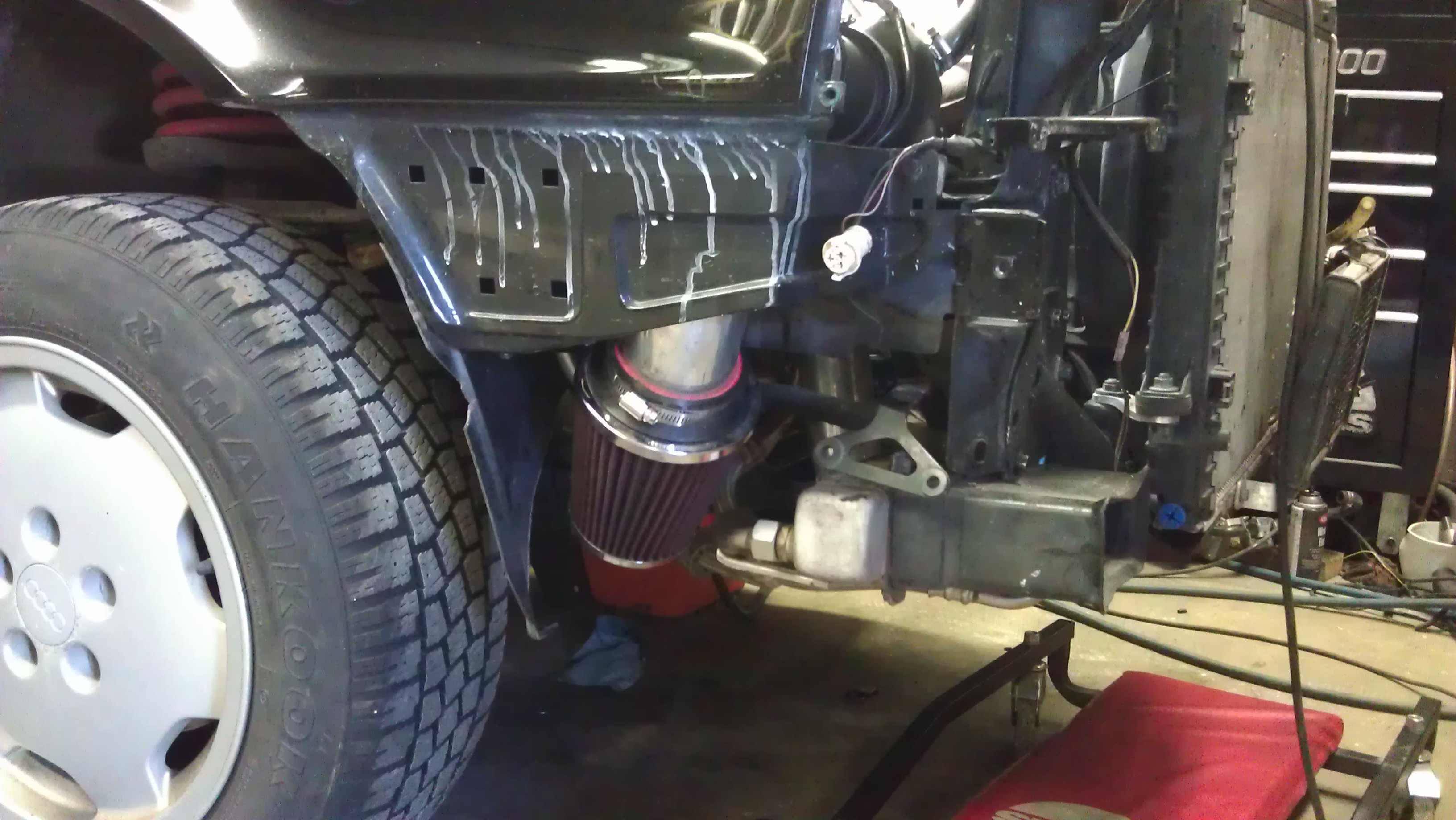

Moar progress today. I was able to get the 3" cobra head fitted to where it will eventually rest with an AEM Dry filter (the Spectre was going to hang down too far). Also pulled out the coolant lines to the heater core and back to the block. I need to retrofit something to hook up the after run pump. Also rerouted some of the wiring to try and clean it up. There's no easy way about it so I'm just going to do the best I can and leave it be.
Pics because fun!

Air filter setup looks familiar for sure! The pipe between the cobra head and filter on mine is curved to gain more room. Don't go through any puddles with that setup!

Well I did get the idea from a car very very similar to your's. . . just different wheels ;)

Mailman brought me a new AEM 3" dry filter too. I'm going to try and find a 45 degree 3" inlet but if not will just try to use the little stainless piece I already have.

Air filter routed:
