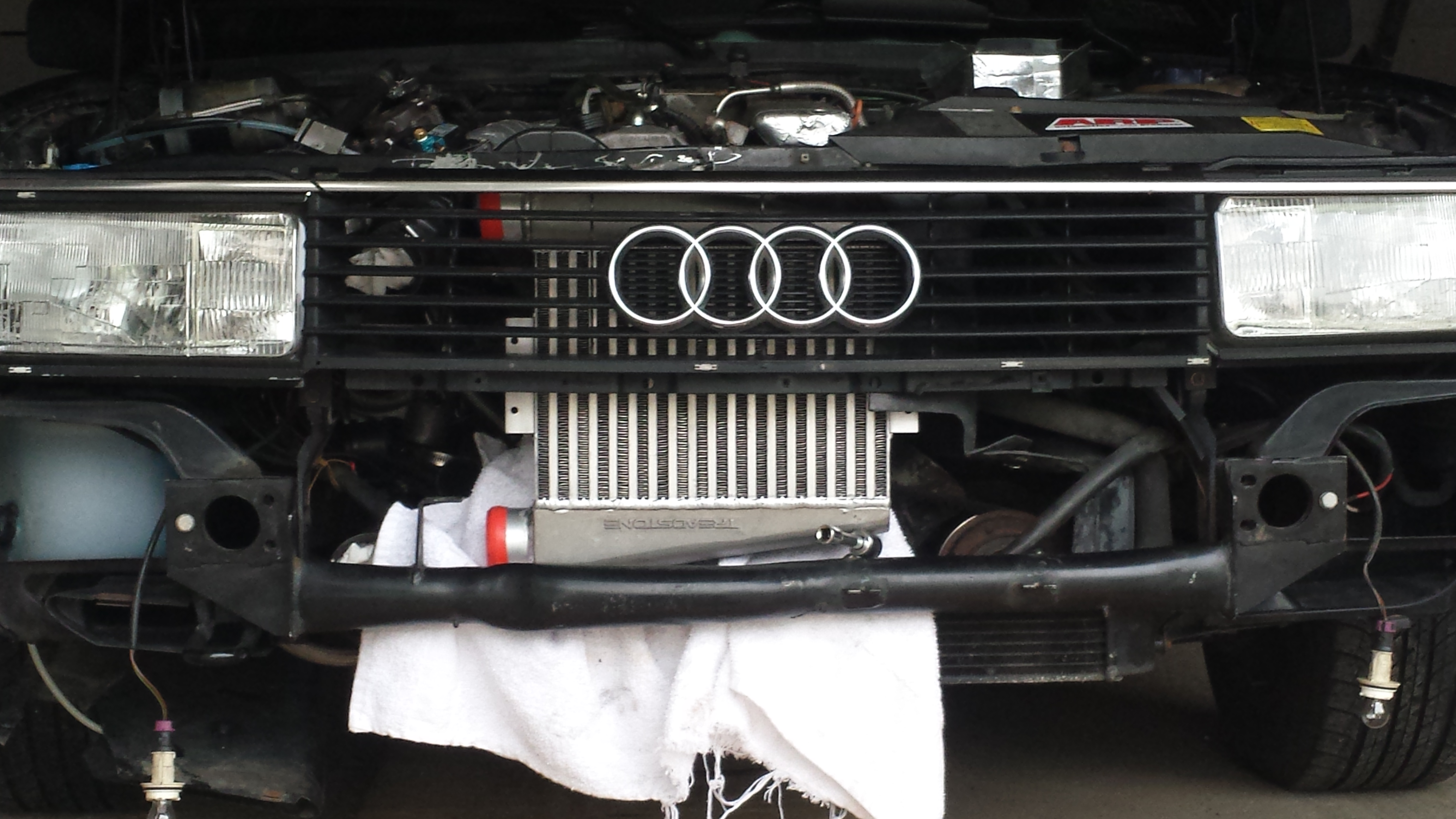

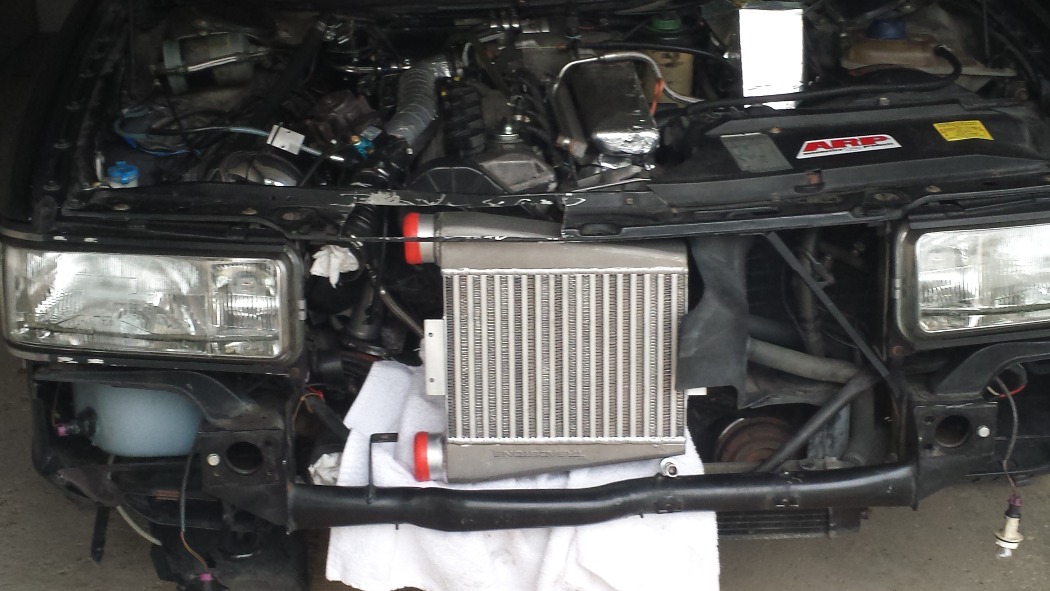

It's not bad tho. Had to cut off the snub mount lol. I need to rethink the snub mount in general and left some meat on it so I can still anchor it somehow. Been trimming extraneous shit off the OE crossmember and I'm just gonna flip it upside down and reuse it
How well will it work for me to use my large hole saw set to cut 4 holes in the bumper to expose more of the core? This bumper looks like dick already with the 4 new dents in it from the guy at country fair who also assaulted me. MAY AZ WELL CUT HER MICK!

Definitely cut the bumper if you don't care about it.
What did you have to modify? You should only have to flip the crossmember around to get it to fit. My much wider core only required that, although I've never run a snub mount on that car. It's not needed.
I actually have a very perfect 87 5000 bumper skin in storage

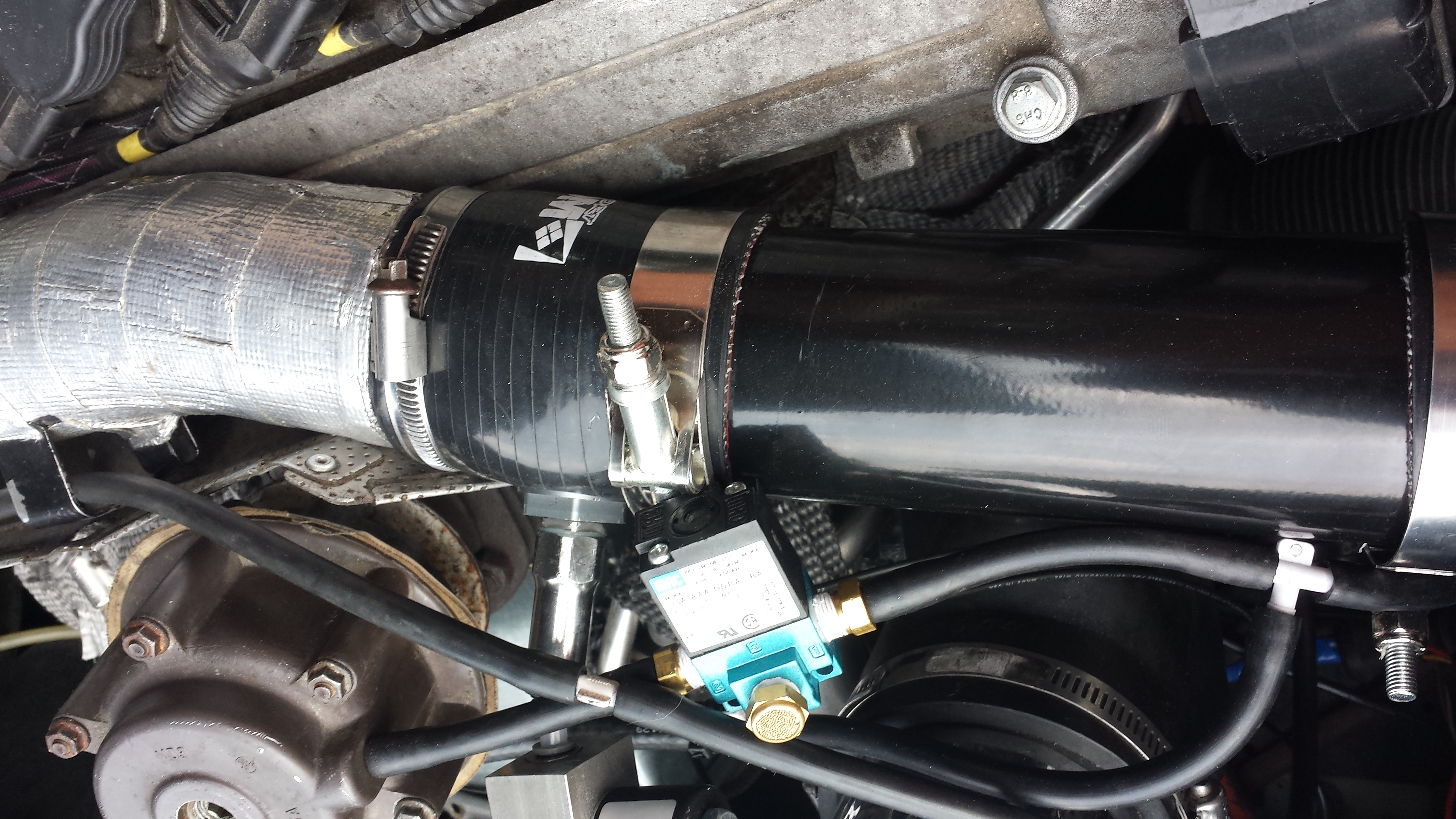

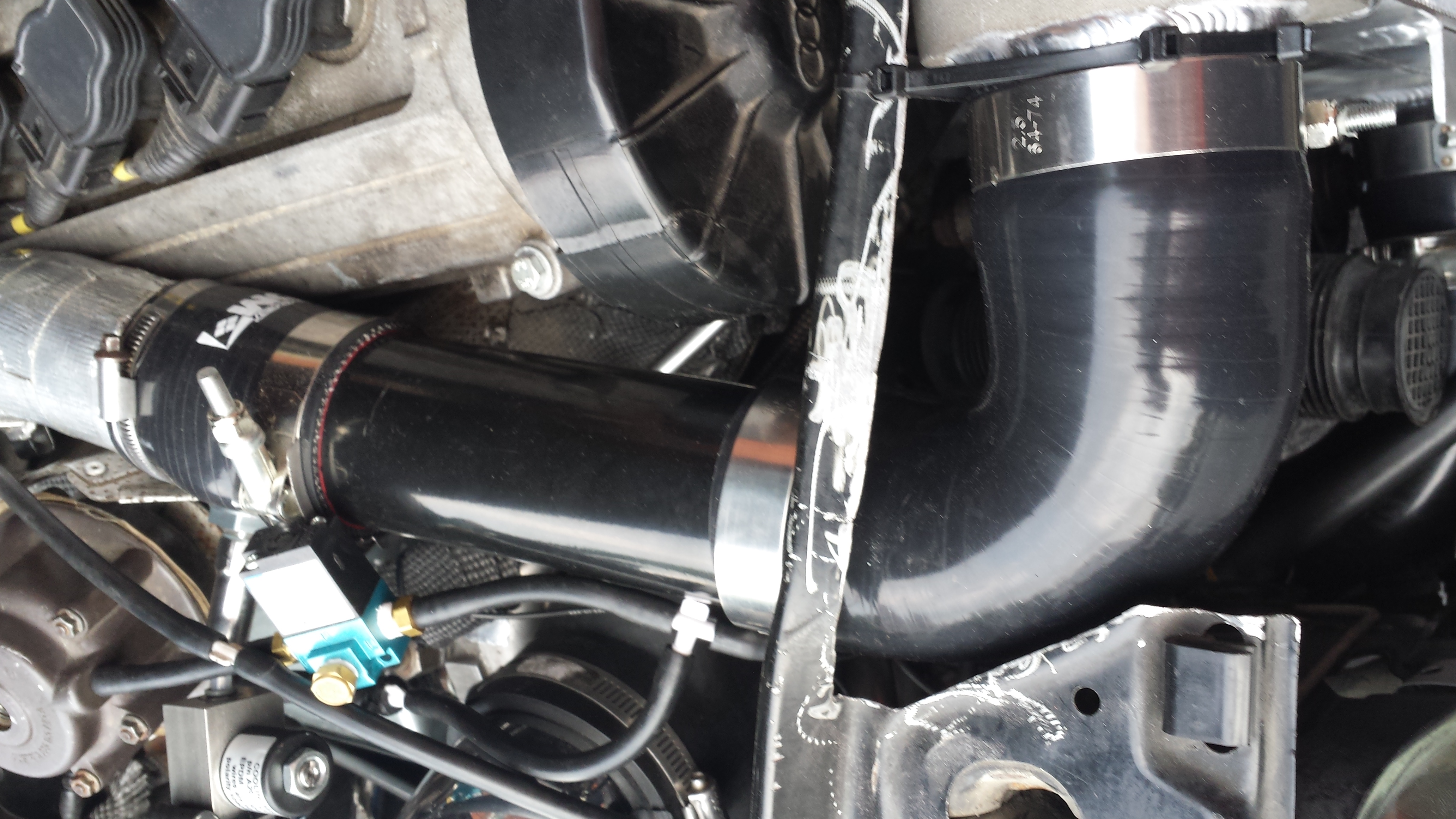

I cut off the snub mount bracket for cleanliness and the wide end tanks made it so I had to cut away part of the cross piece that the hood release stuff mounts too. In the previous shots, the IC is actually a couple inches lower that it will be in the end
I'm pretty sure my core is the same height as yours because its a 9" core with probably the same height end tanks... It fits, but BARELY. Then again, yours gets to it's full height in a different location than mine does. Mine is at full height by the hood latch.
Oh very nice. Not so lucky here lol. These entanks have broad shoulders haha. I received the meth nozzle bung and the sh#tty IC piping kit. They say JDM all over Bahaha! I'll just scratch it off with my nails. I guess it's not the other ebay place I asked about. They didn't have it in black tho.. my one 2.5 to 2" elbow for the IC inlet got delayed an hour away tho :(

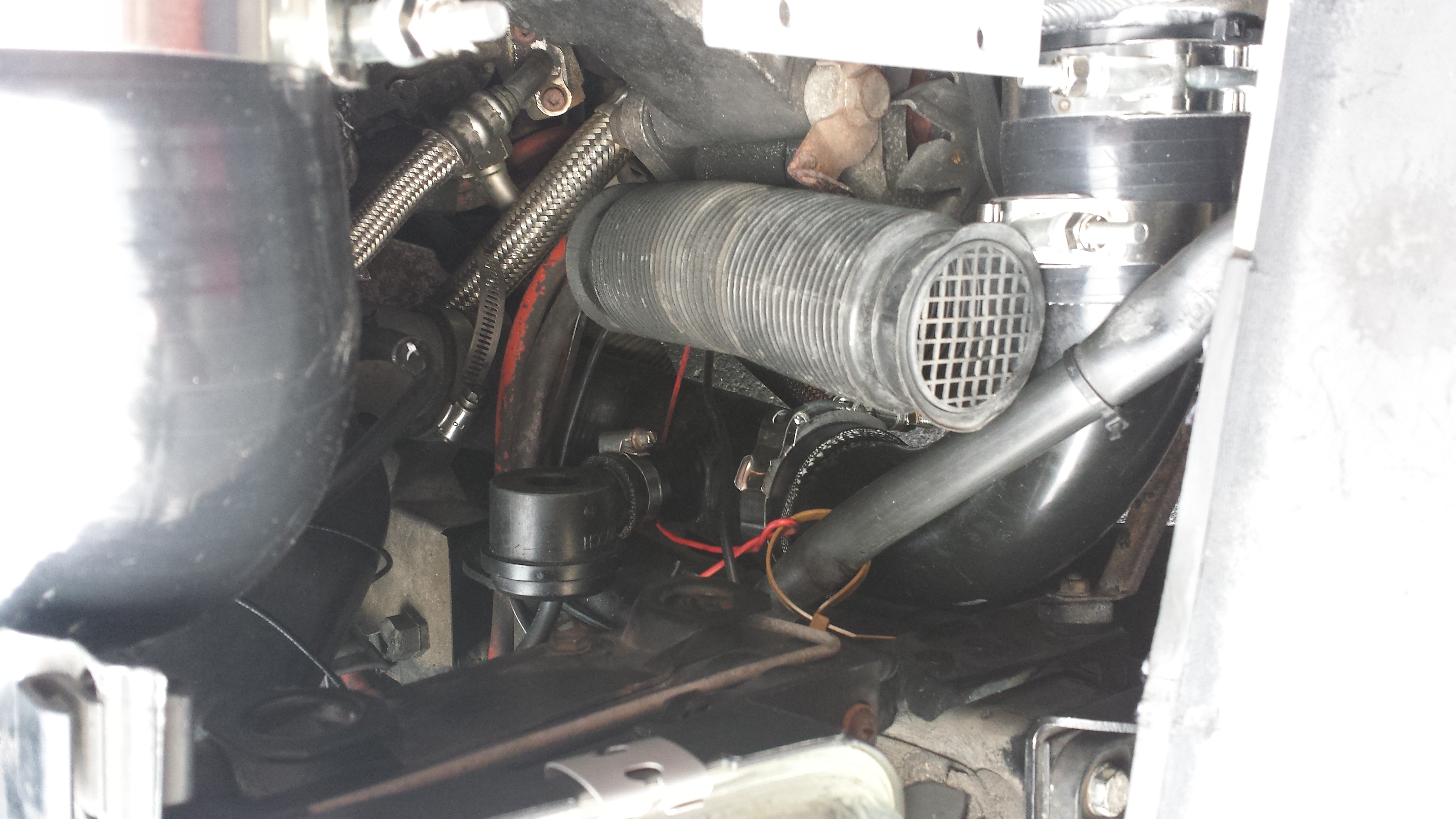

It's in and plumbed. I drove 3 blocks away to park and get food. Drove home and felt the bottom end tank that's basically touching the aux rad. It was heating up from the rad for sure. Admit defeat or forget about it lol? I'm sure the very few if any that are looking at this are saying "always something!"
Wait. What?
Aux rad?
Dude... get rid of that ish. Pronto!
Aux rad?
I never thought about that on mine. I wouldn't worry too much about it but I kept mine because I lived in FL at the time. Not really needed up north I guess.
Ha ya. It gets pretty hot here in erie too sometimes too. Lately tho it hasn't been above 80 f

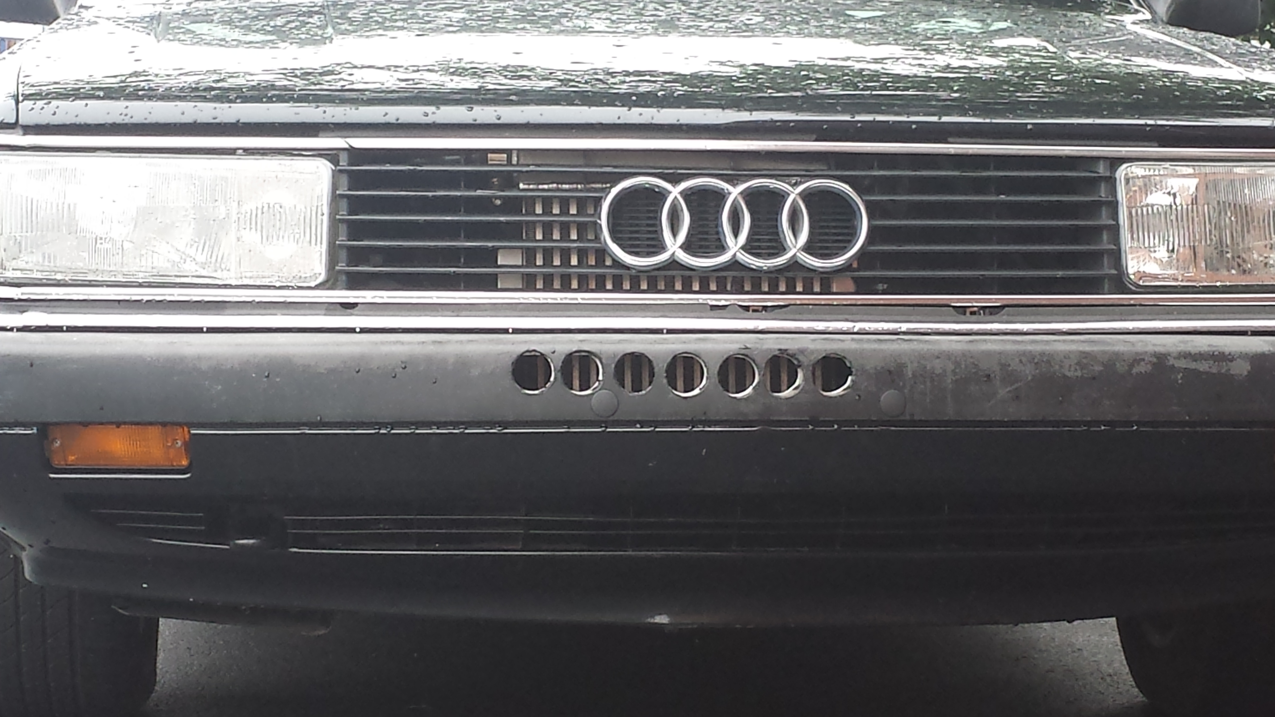

Turned out incredibly stealth ( well except for the giant holes in the bumper). Nice and cool to the touch in 85 F weather
