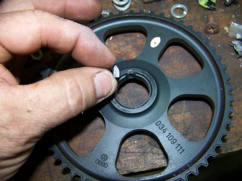

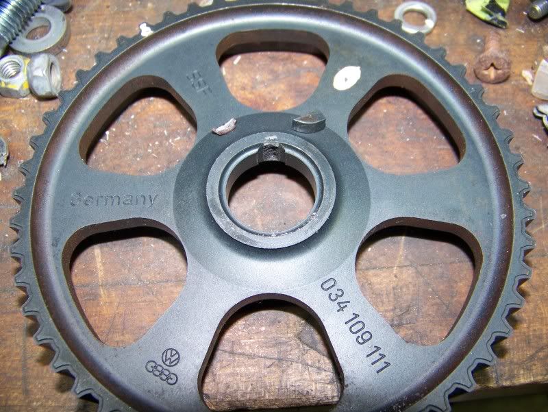

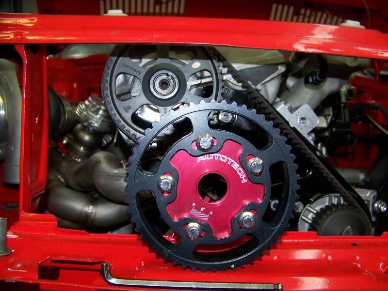

So not a lot of time to work so consequently, not a lot of update. I did however dodge a bullet. A few weeks back I bought an adjustable cam gear from Cary (Nuugen) and as I get closer to installing the aux radiator and pretty much blocking access to the timing belt, I've kept thinking I ought to change the OEM gear out for this new adjustable. I finely made myself do it this afternoon before work.
New gear
As I work the old gear off, I hear something drop and upon inspection I find the key is broken off. Now I've heard all the horror stories about bent valves and crappy cam gear keys, but I have never had it happen to me. This gear looked to be good when I installed it on the engine stand, but obviously somewhere between installation and torquing the damper/crank gear, it broke off. Maybe it was cracked when I installed it, I really don't know. What I do know is that I'm glad I didn't get all the way back together and try to start it that way.
New gear installed

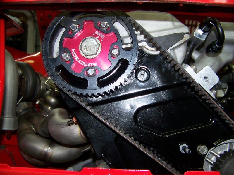

Does the cover fit over these adjustables without rubbing? I seem to remember some problems encountered by others.
I might want to go gambling out on the town with luck like that. :wink: :D
Re: Her Mars Red 83 Urq ...plan change..tube header
Spoooky... On the other hand, the picture of that header in the last picture is :drool: :drool: :drool:
So is that where my cam gear went?
and that is EXACTLY why I bought the same cam gear and put it on mine just a few weeks ago.

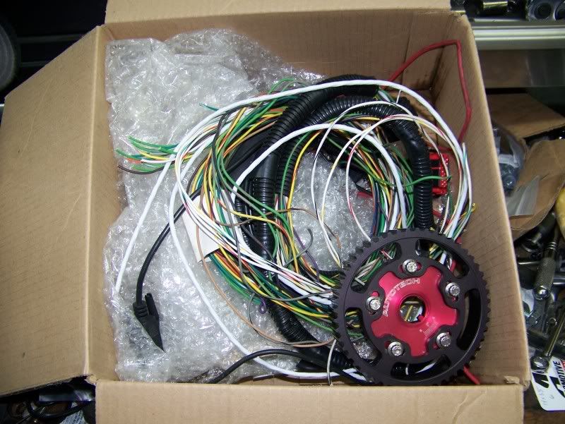

Reread my post Hank. :D
Yours was bought from Aaron, but on a different note isn't that a good looking header shown in the last picture?

and IIRC/FWIW, for my lowly 4cyl with the CAT cam gear, i had to drill a hole in the cover for the bolt head.... it rubbed.
quattro87
Posts: 1000
Post by quattro87 »
Good to know that you didn't die Aaron. I was wondering. :-) You did indeed make the cam gear pass off at the Las Vegas motor speedway and I even had them both on the shelf for awhile, but took the one you sold Hank up to Salt Lake last weekend and can't find it now. When I was unloading stuff that I had brought up, I asked Hank if he was going to sell the gear to Sean or not and if so I wouldn't bother getting it out of the trunk. It never left the trunk, but somehow isn't there when I went to look for it the other night when Sean was over. Go figure? I probably put it somewhere so that I wouldn't forget it and now can't remember where that place is!!
It looks like to me that if anything rubs on the new gear it would be the adjustment lock down bolts. They stick out about 3/8" past the face of the gear. I felt like something was hitting, but I didn't have time to really look before it was time to go to work. I'm glad that the project is coming together well enough for you to break radio silence. :lol: Thanks for the kind words.

Solved the case of the missing cam gear!! It was hiding in the IIc box with the harness wiring. I can't say that I remember putting it in the box while up in Salt lake, but there it was. I'll put it somewhere safe until you are ready for it Sean, or until I build the stroker for His Urq and need it. :D

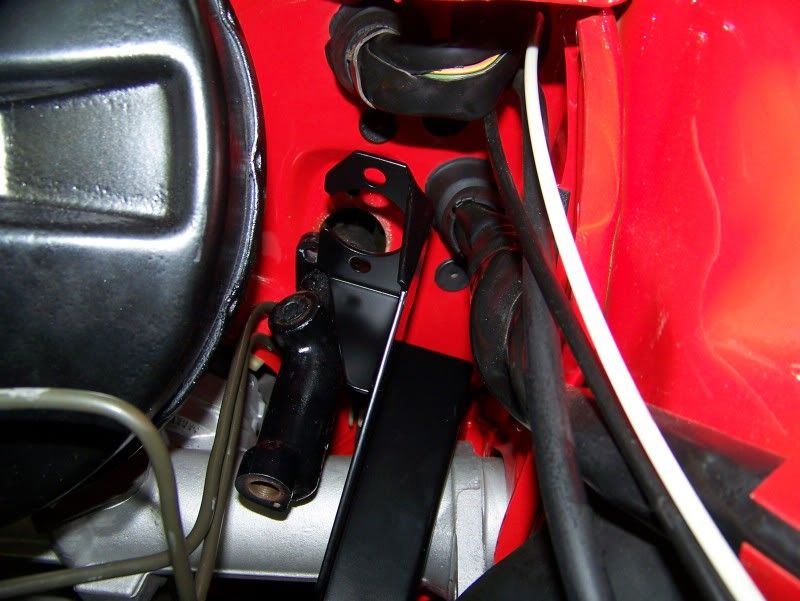

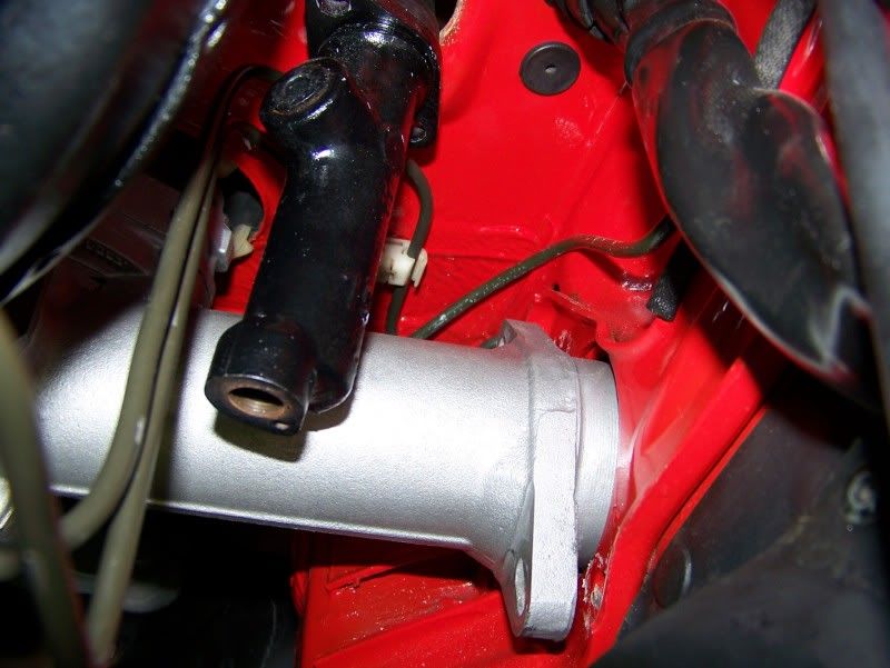

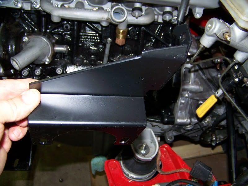

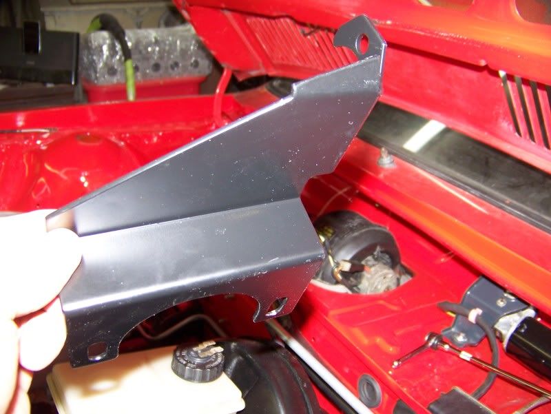

I couldn't stand to not do something however and since it was only 9pm and my master clutch firewall brace had arrived from 034 I decided that I would make an attempt to install it. It would have been so much easier with the engine out and installed with the rack and M/C. The instructions say the it can be squeezed in without braking lines, but they obviously hadn't considered my new paint. I ended up pulling the brake M/C off of the vacuum assist along with all the lines and proportioning valve so that I could get access. I even had to crawl back under the dash and disconnect the pedal so that I could pull the clutch M/C all the way out. The two bolts in the fender well holding the rack in place also had to be removed to be able to slide the rack enough to sandwich the brace in between. It was a PITA, but looks to be much stiffer.
The brace oriented in the direction of install. The 034 link http://www.034motorsport.com/advanced_s ... 97&x=0&y=0
The rack slid over enough to get the brace sandwiched in between.
Trying to get it installed without pulling the clutch M/C. Wasn't happening.

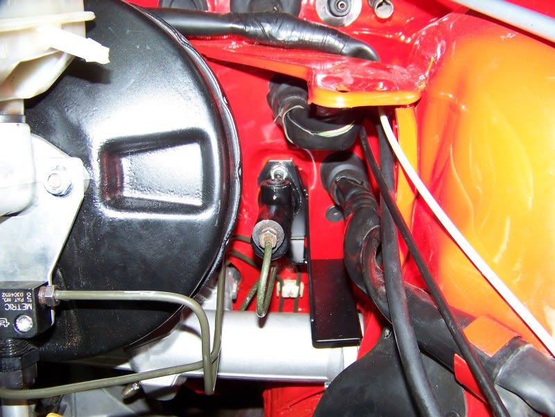

Installed
I got the brake M/C square profile o-ring installed also while everything was apart. Got alot done, just not on the car. Now if I could only go to sleep so that I can go to work at 5am tomorrow morning. It's hard going from nights to days.

I totally agree, that fire wall brace, while worth it in the end is a total PITA.
Quattro v1.0
Posts: 405
Re: Her Mars Red 83 Urq ...Clutch firewall brace installed
Post by Quattro v1.0 »
It looks like the brace had been redesigned from the original, actually simpler design - maybe not to install though
ralleyquattro
Posts: 858
Post by ralleyquattro »
This is the original brace made by Jack Dean. 034 is selling them now, not sure who makes them.
The original factory 20V brace actually installs on the inside of the car and braces from the pedal cluster.
I installed it on my '84. The PITA with factory design is that you have to take the pedal cluster out and drill/tap a hole in the clutch pivot shaft. But if I can do it on my garage floor, then anyone can.
HTH
