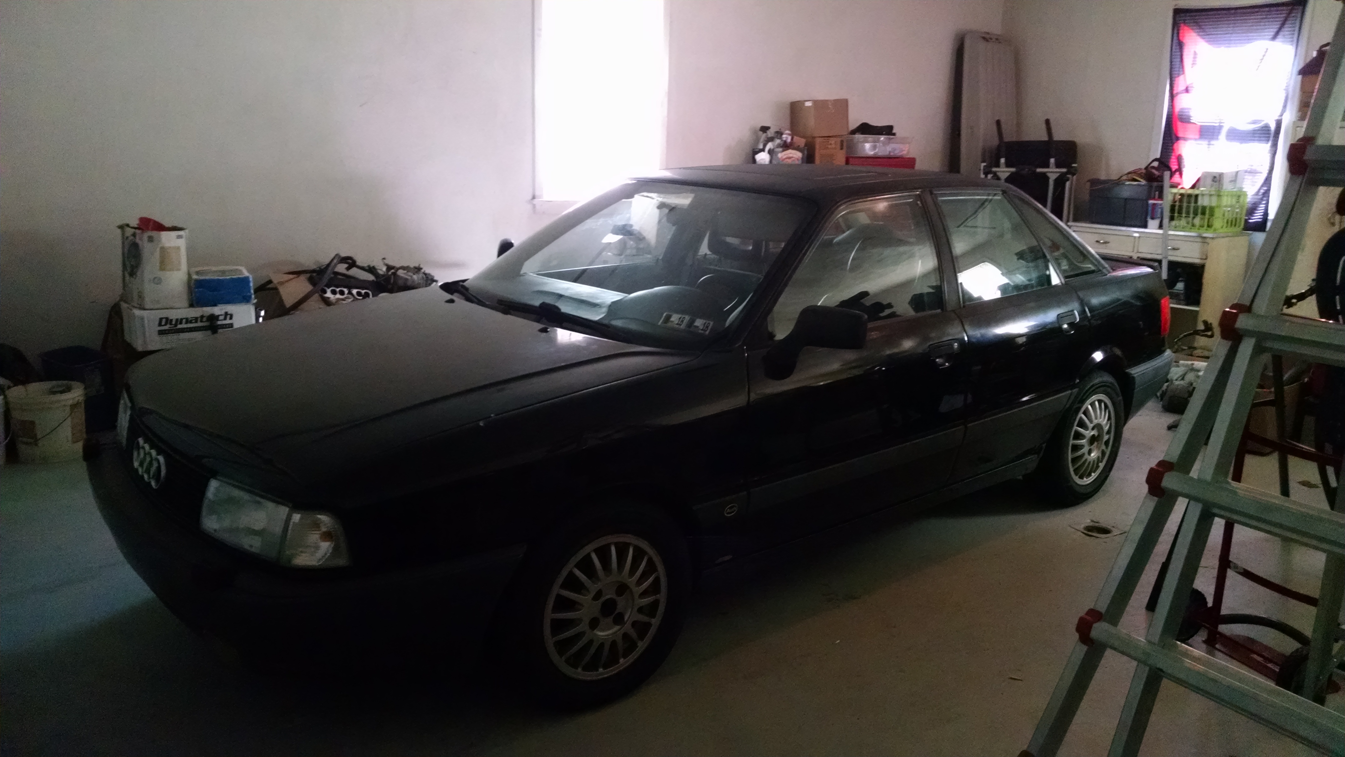

Well today I had a car show up in my new garage... An 87 80q... What should I do with it?
Re: 20vt B3 (The Bandit)
Nice!! Body and paint look to be in good shape.
Which engine?
Since I already have a hot rod in the Cq, I intend to make my 80q into a winter beater/commuter car that will challenge and surprise some modern sports cars. For less than $5k, total. With the amount of spare parts I've accumulated over the years (AANs, 01Es, etc) it shouldn't be too difficult to pull off! Finding the time will be the biggest challenge, lol.

The low light pic does it a lot of justice. It's pretty straight, but has definitely had a respray at some point. The interior was swapped from a 90, so it has grey leather now. The engine is the standard NG from the year, so it has the less desirable cam, and slightly less power. It also is quite low on compression, or so I am told. It might be an easy fix, or it might be a swap candidate. I have access to a complete 7A engine, harness and ECU, so who knows...
The funny part is, I bought it off a friend, so it has a bunch of my old parts on it... Exhaust, shifter, clear corners, and some others... I got it plenty cheap, so keep or part out is what I need to decide. Oh, it has new tires and H&R springs too haha.
Keep it for now, rob some parts for the Bandit as you want/need and deal with it later when the right proposition materializes.

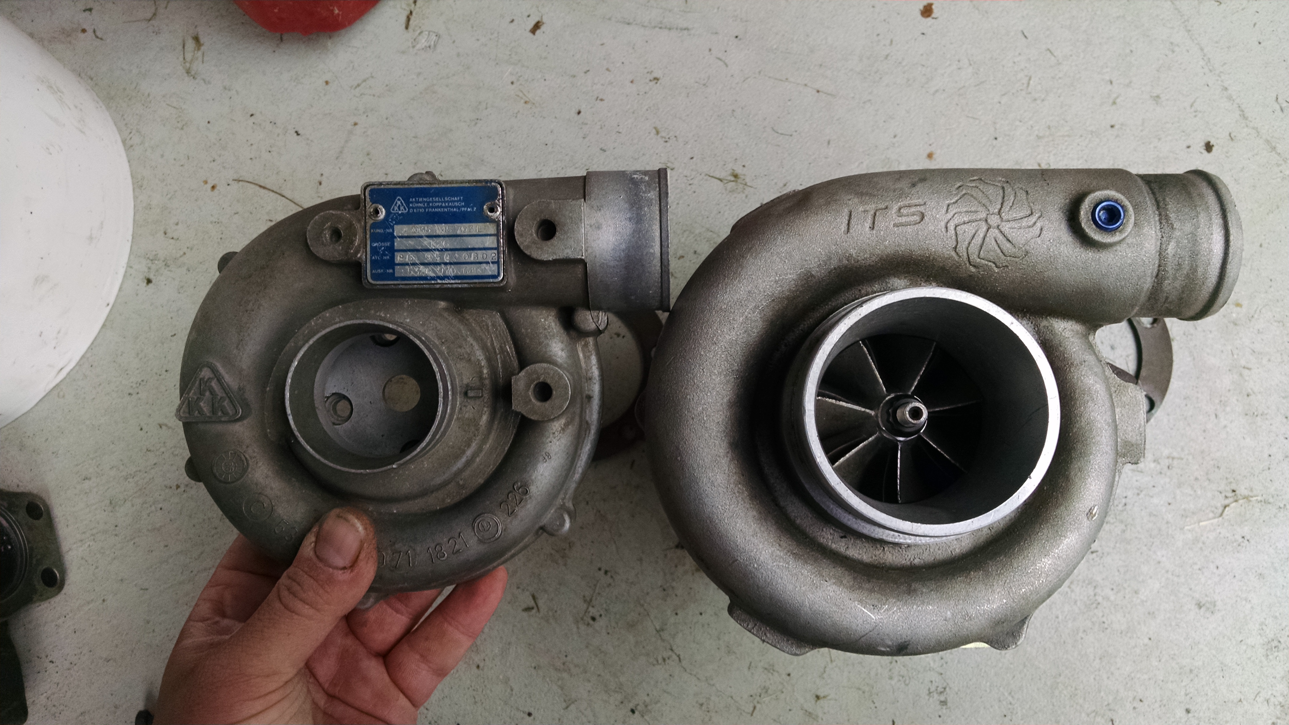

I did it again... I have another turbo on the way. This time I will be putting it in! Anyways, it was listed as a Porsche upgrade, but the seller wasn't interested in giving any details. The only thing in the description was "excellent condition". It has obviously been heats cycled many times, as the turbine houseing appears "peeled". That's ok though, I'll get it cleaned up and checked out. I can't find much in the brand though, ITS comes up as a turbo rebuilder in the UK. Anyone have any idea? I'm thinking To4 based.

As for the mystery turbo, I'll have to spec it out, and figure out what turbo it is when it gets here on Monday. I figure I'm ringing out this K24 to 20psi+, so need something different to go more. :drive:

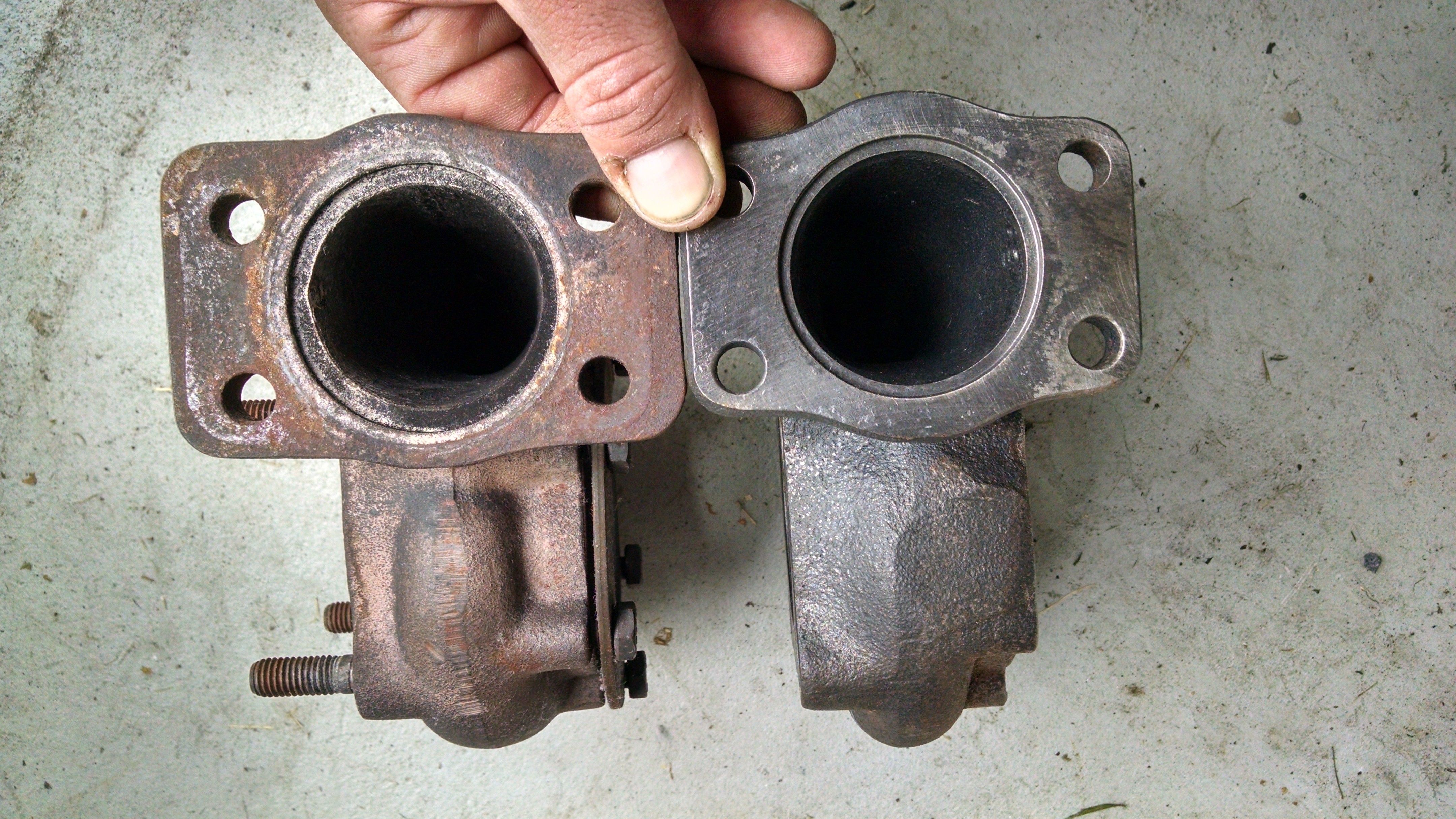

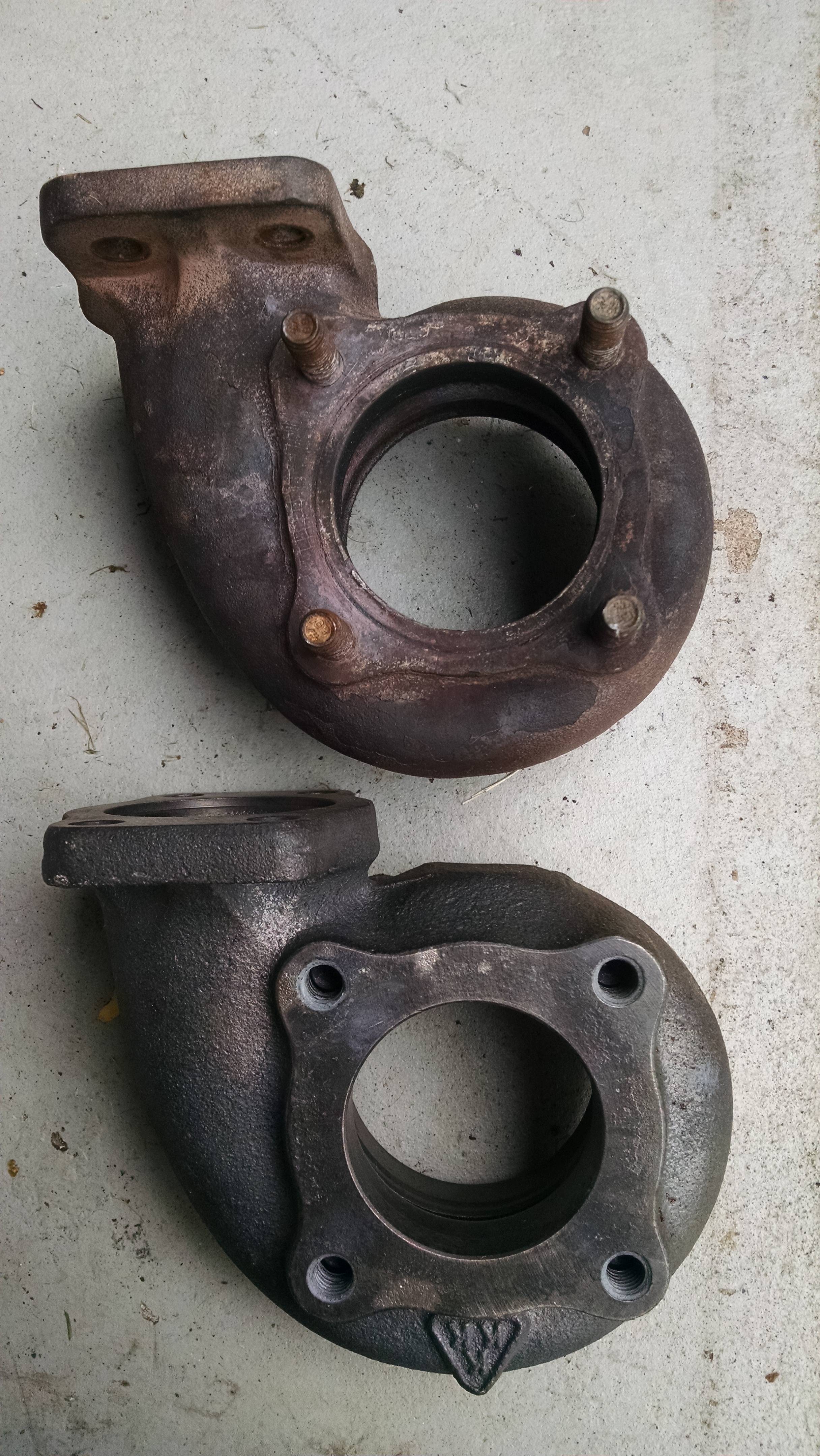

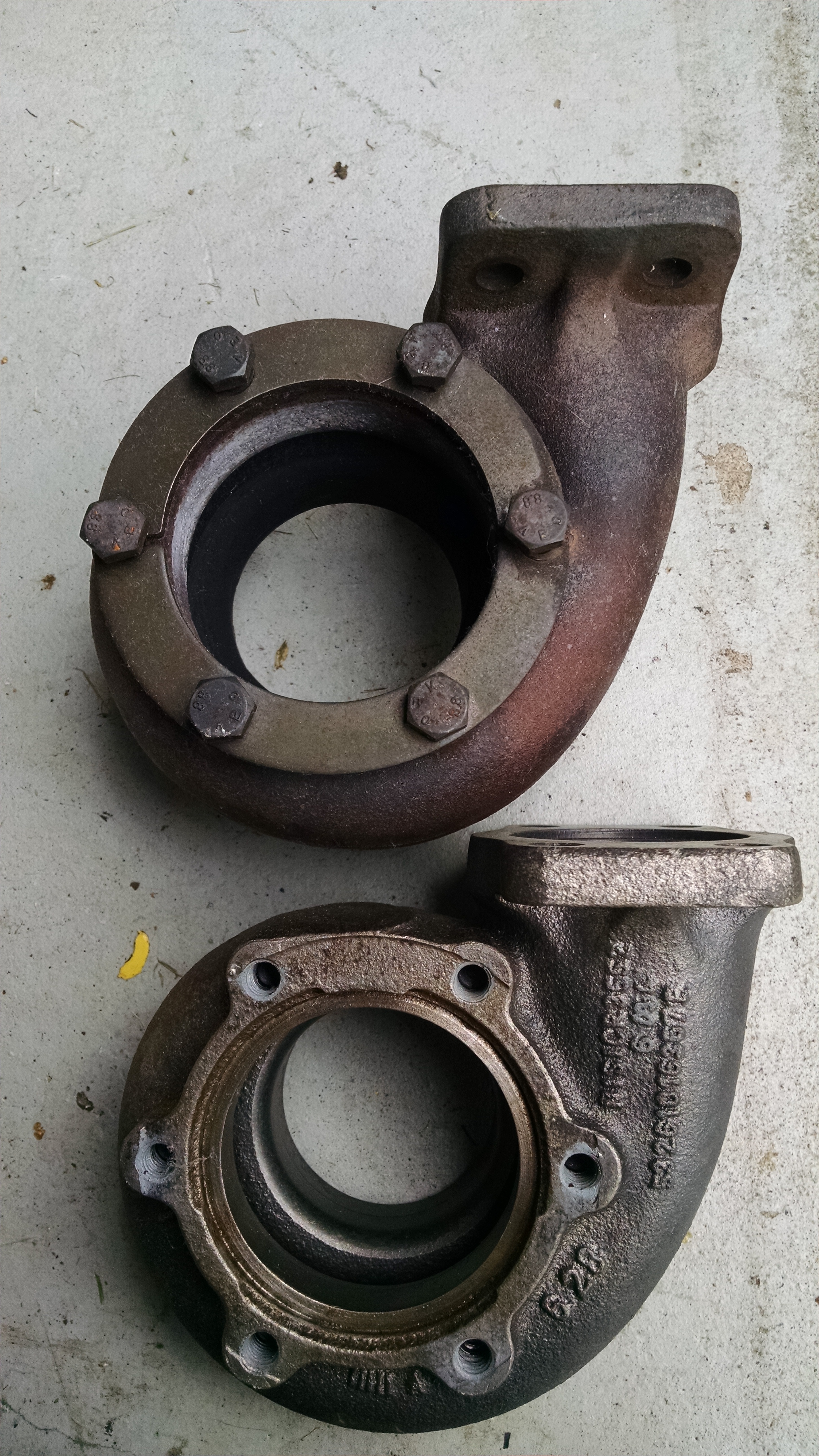

I decided to take some comparison pics of a K26 Vs the new turbo. The exhaust housing is an Audi K26 #6 housing, and I think the compressor housing is from a Porsche K26/6.

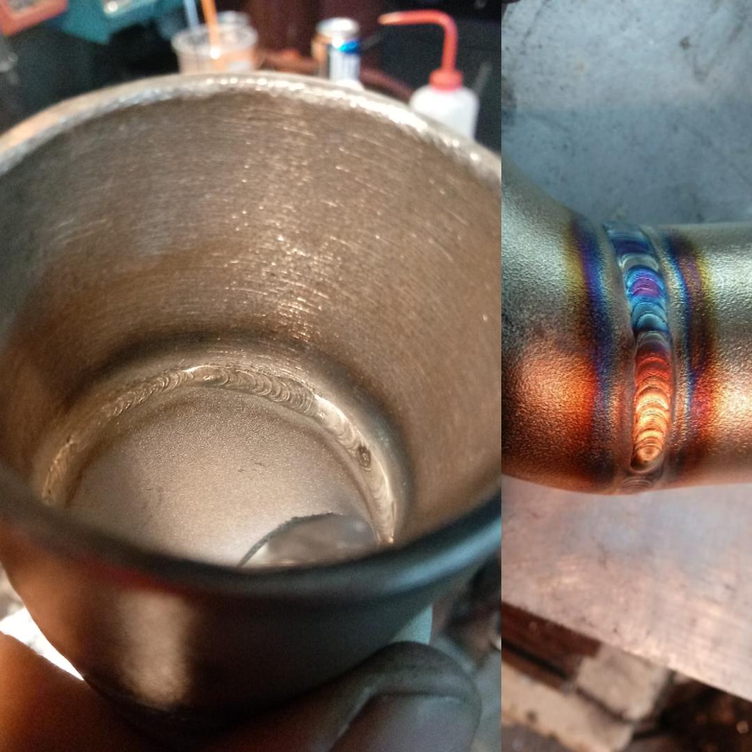

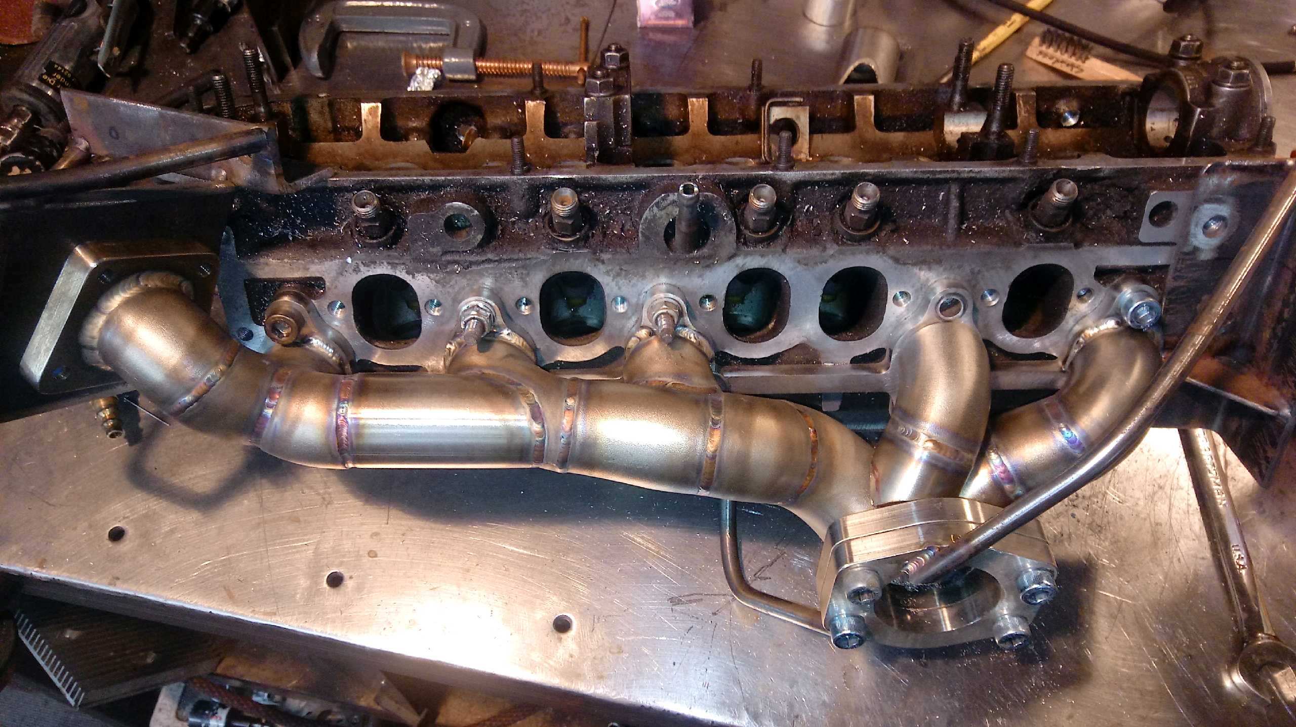

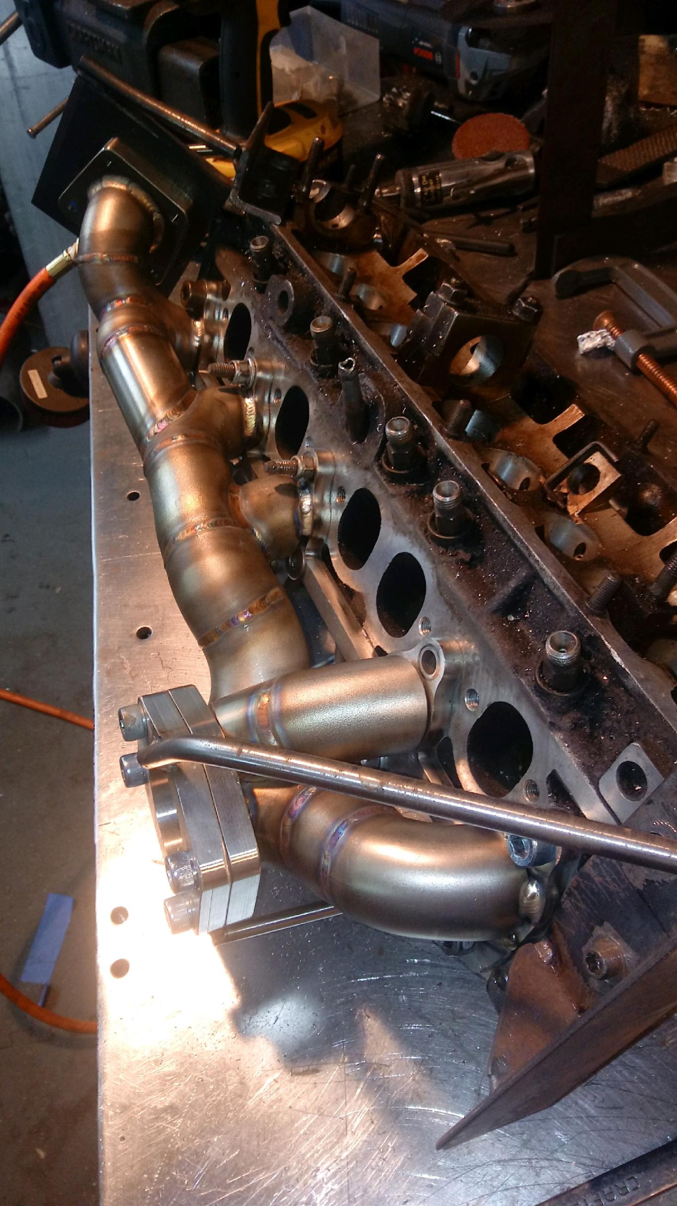

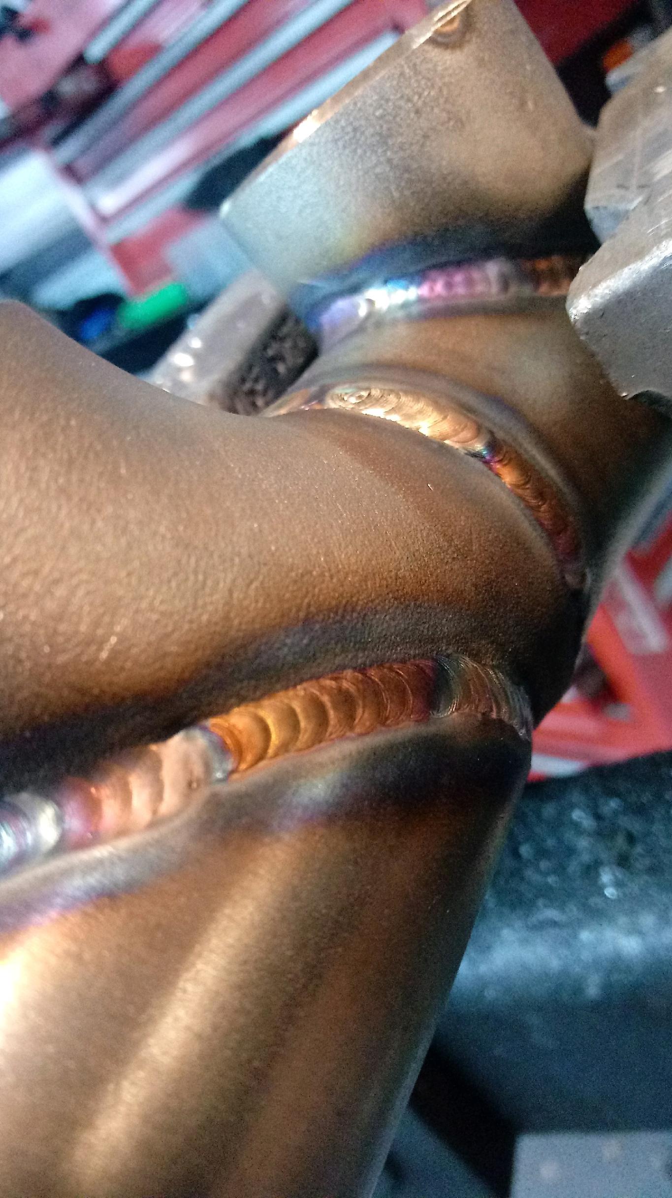

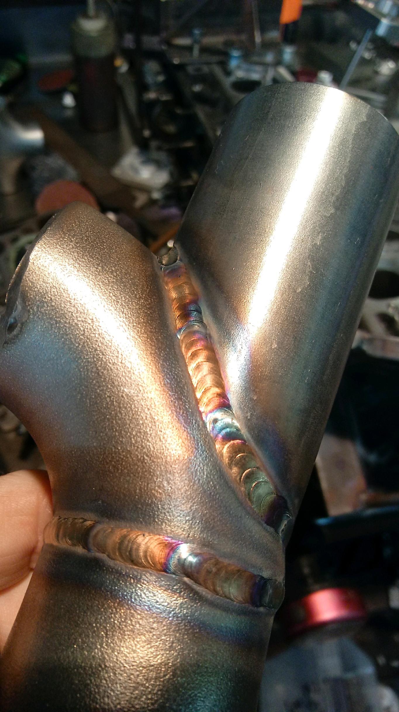

Well, I can finally let this one out the bag. About a month ago, I had a lengthy discussion with Tim about making a higher flowing, factory placement manifold. Over the past couple weeks, I've been getting some pretty neat pictures of his progress. It almost done now, just one last tube to make for the wastegate. Figure at this point, I can start sharing some of these pics. Tell me what you guys think.

I think that looks fantastic. A real nice and tidy package. Also curious as to where you got the wastegate flange or if it was made. I can't find one state side for the manifold I'm building.
Tim made some 304ss ones for the manifolds he was making.

Dang that’s going to be awesome . Not many tube header 20v’s around
