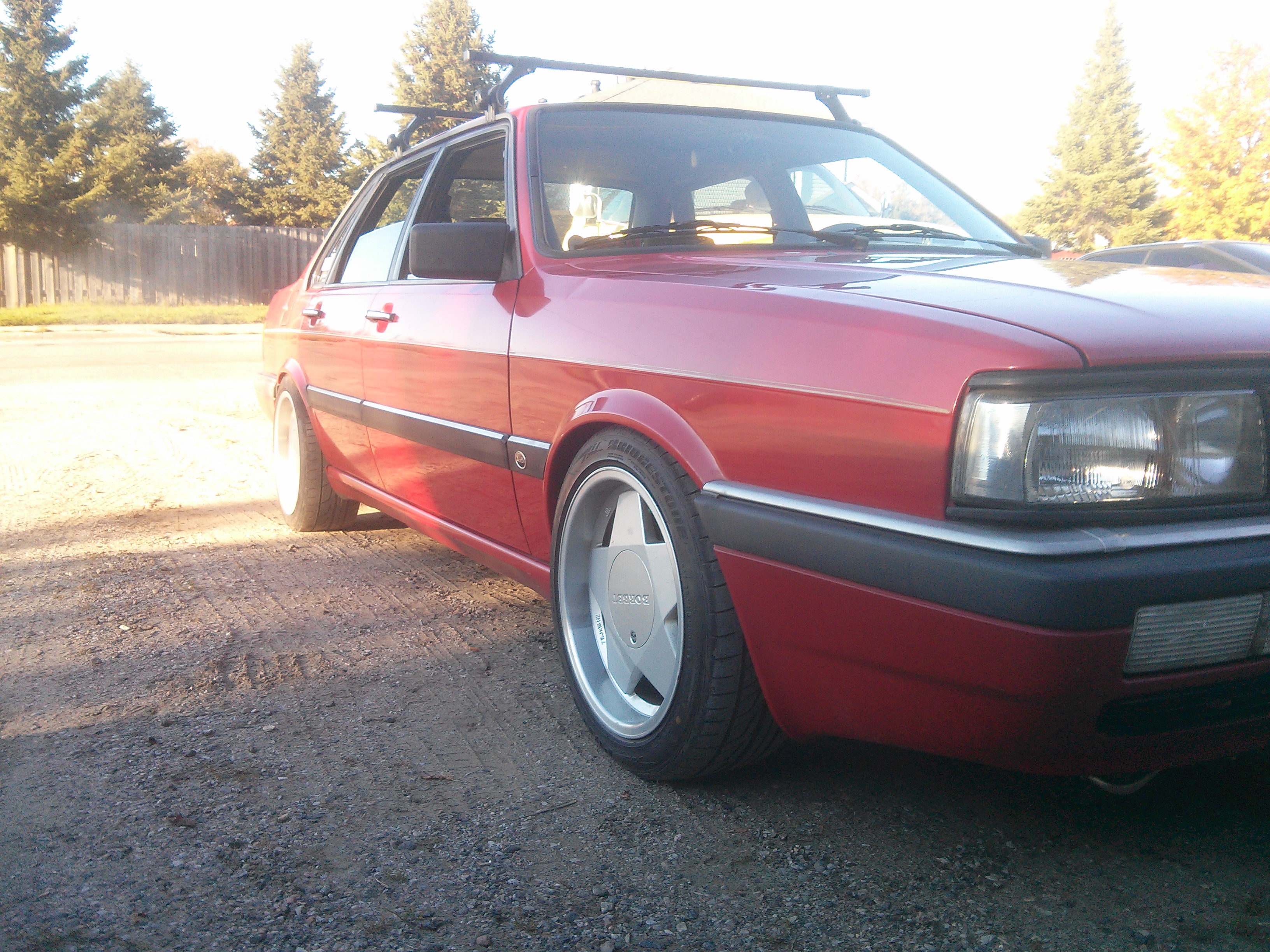

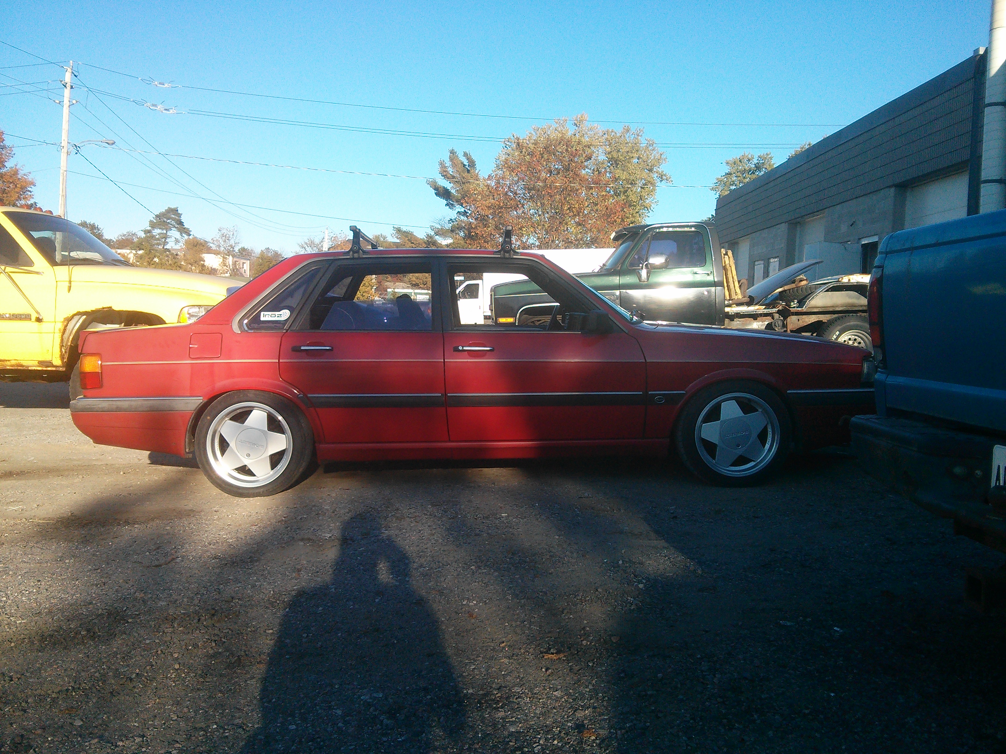

Rolled the fenders today with Andrew (okay, andrew did the rolling, I did the grunt work). no rub! even over big bumps

Looks fantastic man!

Definitely looks very nice!

absolutely love the car dude the type A's couldn't look better on your car - hopefully you resist the urge to keep turning things up

What a nice car... but DAMN do I hate those wheels...lol

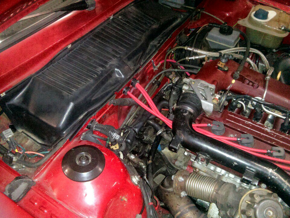

So I put my ignition under the rain tray. Really cleans it up back there and gets the coils away from the heat. I know it didn't look like it in the pic, but it's way better! Also hooked the speedo back up and figured out that I need a new alternator. Replaced the voltage regulator and it didn't do much of anything so I'll be putting a new alt in tomorrow or Monday since I have to dd this car a little more (cam for TDI was wrong one... good day today)

I really think that the coils being under the rain tray away from the heat helps a lot. I also moved the coil ground from a chassis and engine ground in one to just a chassis ground. And the new plug wires from Marc and better/cleaner routing. The trigger drop appears to be totally gone. So whatever did it, I am happy. Siiiiiiick yo
