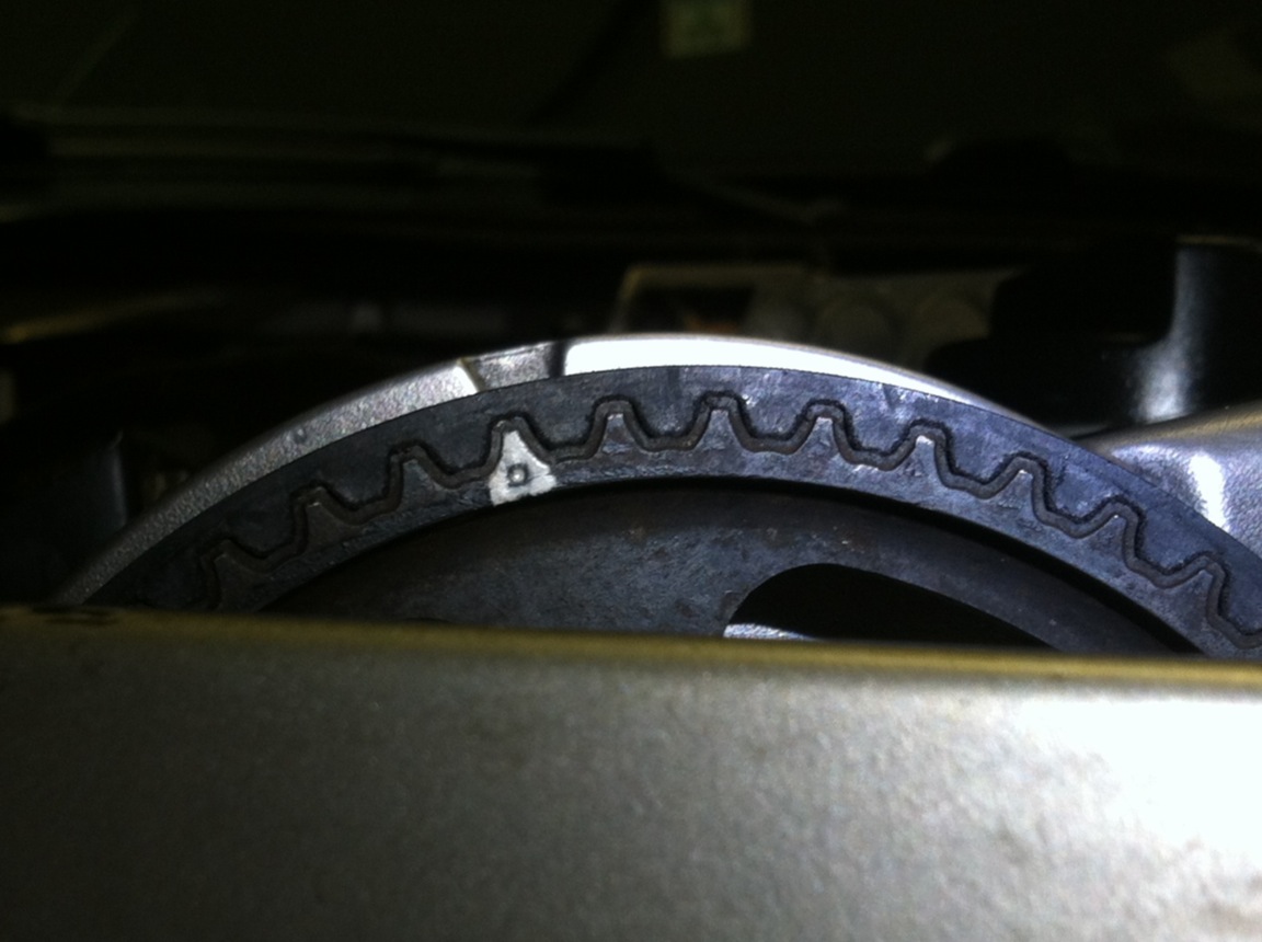

Whoa! That's app is pretty nifty! I'll give it a shot if I can catch a ride out to the car. I put a new Contitech belt (054 109 119A) on cause the old one had oil on it. I also have a Tommi's billet crank gear from EFI Ex, which I noticed has the teeth slightly offset to my factory cog.
The thing is, I had some trouble getting the timing lined up right when I put it all together. It seemed a half-tooth off. Either I set it forward a tooth and the idler side had waaaaaay too little tension in order to keep the timing right, or move it back a tooth and the tension is pretty high and cam timing slightly retarded. I opted for the second one, and got the cam timing as close as I could, and the tension not unreasonably high, but I wonder if that might be causing this.

All speculation welcome and appreciated! :) I gave it some revs but, if anything, it got louder. After pulling the timing belt cover, I let it run and it took 5 minutes to come up this time. I stuck my stethoscope on the water pump and it was pretty quiet. But on the back timing cover near the idler, it was very distinct! I'm 95% sure that's what's making the noise. Just need to find out why.
Berserker wrote:I'd hate to see a wrecked engine due to bent valves.
You and me both! Haven't driven much farther than in/out of the garage because I'm worried I might cause expensive damage. If anything, my belt has too much tension. It's the only way I can keep it close to in-time, and the cams are still a hair retarded. I verified the new t-belt is the same part number as the old, so I'm not sure what's going on there.
Here's a terrifying thought: Is it possible that the t-belt is "bridging" across the crank cog? What I mean is that the tension from both the water pump and idler keep the belt from slipping on either side of the cog, but the bottom is not in contact with the belt. That would effectively make my timing belt a tooth shorter, which would explain why the belt is so hard to slip on even with the water pump as loose as it allows.

Nope! It's quite tight on both sides. In fact, I turned the engine backwards until it turned the cams before tensioning the water pump side. Even then, this the absolute best I can get @ flywheel TDC:
But if I jump it forward a tooth and want to keep it in time, the water pump wouldn't be moved at all and the idler side would be flapping in the wind.

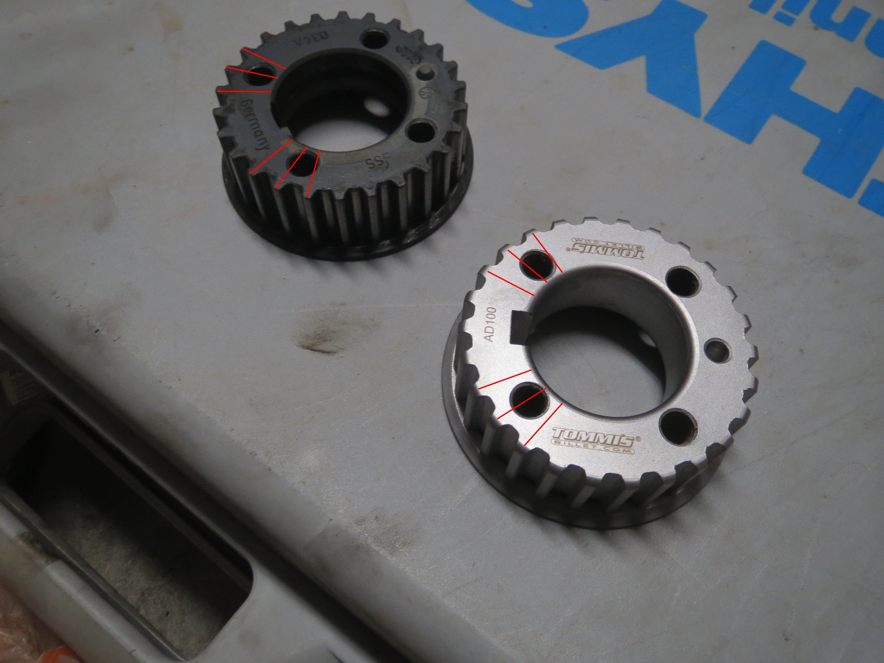

- Crank cog (replaced with this one)
- Associated hardware
My only other idea is that the new cog is slightly offset from the factory one (which it is; I noticed when it didn't line up with the imprint on the pulley), but it's not by much:
In any case, I really appreciate you guys helping out through the beers and all! Despite not knowing what to fix, it's nice not knowing together. :beer:
Re: Kevin's 200 20v + B5
Hmm, if the crank cog was offset a bit, I think that actually would/could make the tension all out of wack... That may very well be your problem. I'd probably put a brand new stock one on there.

The sintered OEM crank cog is prone to fracturing with use of impact tools. You should be fine to run it, if need be. Just look for hairline fractures, especially in the bolt holes/threads and at the keyway.
You should be fine... however, the fact that the Tommis one (possibly) isn't working for you gives me pause. How many other people have them (myself included) and have had no issues? Are we talking install error, manufacturing defect, bad luck? Definitely weird.
If the indexing of the teeth is not the same on the two gears, then there is most definitely a problem. An adjustable cam gear may alleviate that though eh?
Anyway, the stock cogs are not an issue when installed properly and replaced with new each time they are removed. It's when you want to reuse the cog that having a hardened one is important.

It's a CNC piece, so I'd think it's close to impossible to have it produced inconsistently - at least without being noticed, and I can't see how I'd be the only one to have issues.
I considered an adjustable cam gear, but that seems a bit like masking some issue in the system, rather than fixing it. Happy to get one for other reasons, though. :)
This weekend, I'm hoping that reinstalling the old parts one-by-one will reveal what confounding variable is causing my timing issue (and hope that the over-tensioned belt was all that caused the noise, or that the cause will be otherwise revealed).
