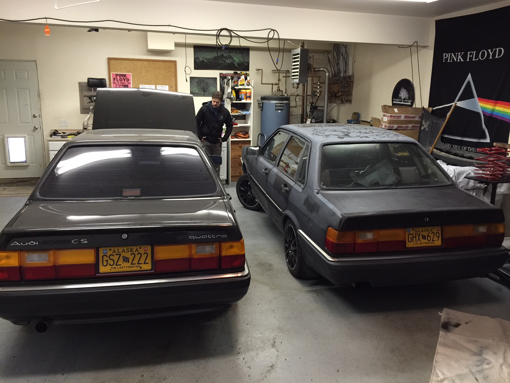

Making progress on the 3b conversion on my buddies quattro

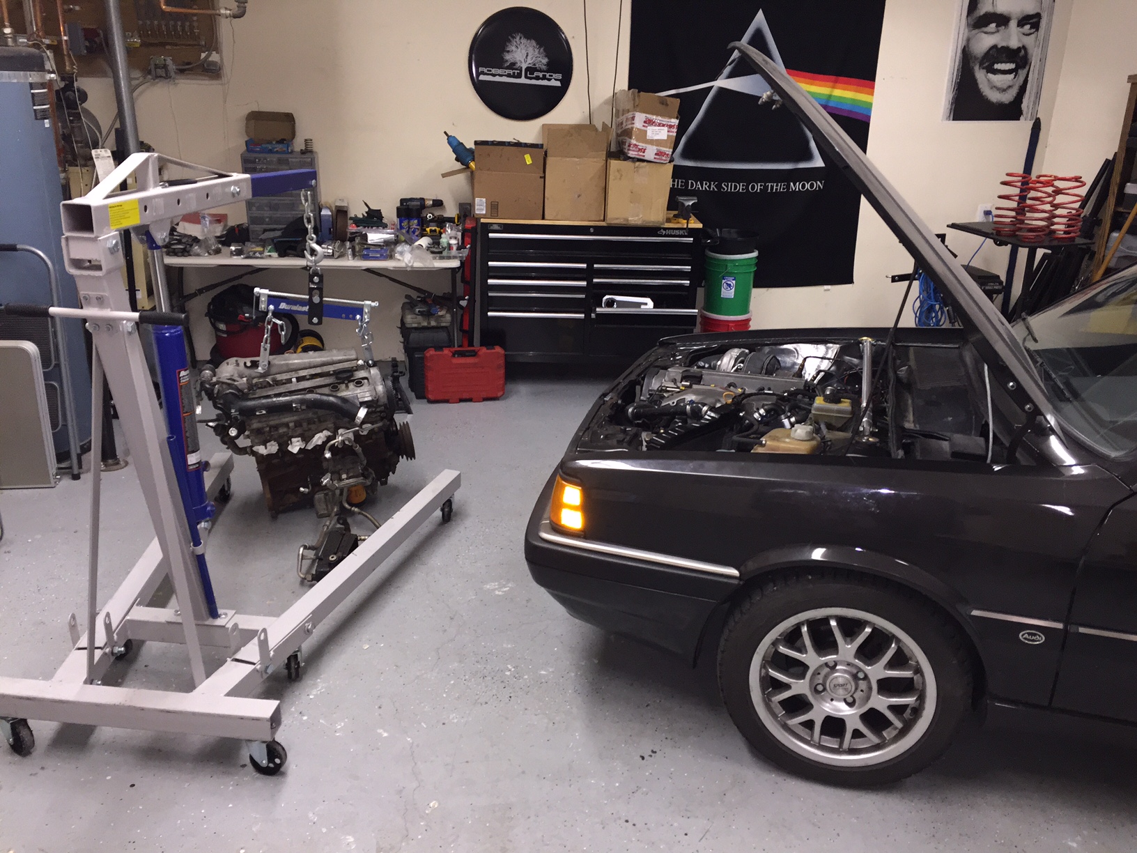

Apprently since my last post I have gotten some stuff done.
3b swapped a 4K we brought back to life just prior to the owner junking it.
Swapped out the old grey cloth with some Quattro script we found in another car about to be junked as well....
Then we swapped the motor and did a Gt3071/RS2 EM/IROZ Exhaust ect... swap on my brothers S6 avant. The motor that was in it was done. Heavy scaring on #5 cylinder and pretty much all valves in the head were loose to the touch with major surface damage in all the domes.

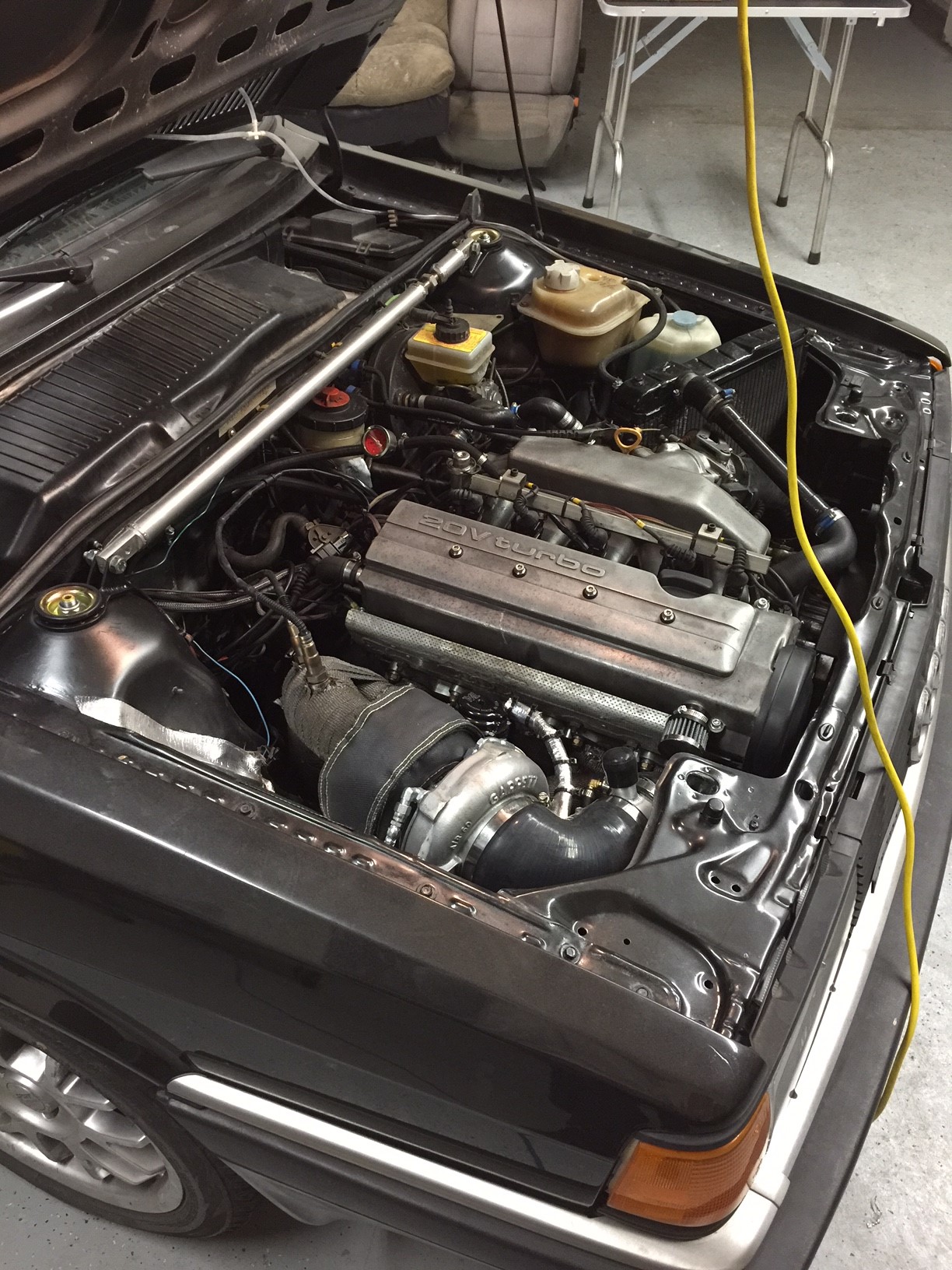

Re: Audi S4000 - Alaska
Then I got up with Marc Swanson and had him write me a tune for a GTX 3071 on my S4000 while I pulled the 11c out and installed the Motronic.
I also added a much needed oil cooler and a much larger radiator.
Of course there were tons of hiccups from clutch/flywheel order fuck ups to a bad ECU but everything was eventually worked out.
And while I was doing all that with my car I came across a beautiful white 4K with that lovely Quattro script. I had to buy it.
This will have an AAN with 3b plumbing.
