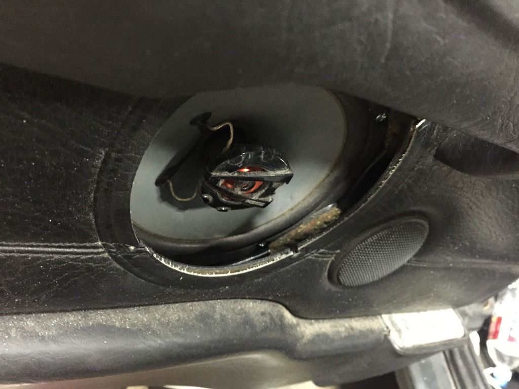

Yeah, mounted where it is I had room behind the speaker and about an inch between the speaker and the door card. It would have to be shallow but you could definitely do it. Make me a pair too... Haha

Hard to see, but if you didn't use a two way and used a woofer and a tweeter you'd have quite a bit of space. And these are fairly deep speakers.

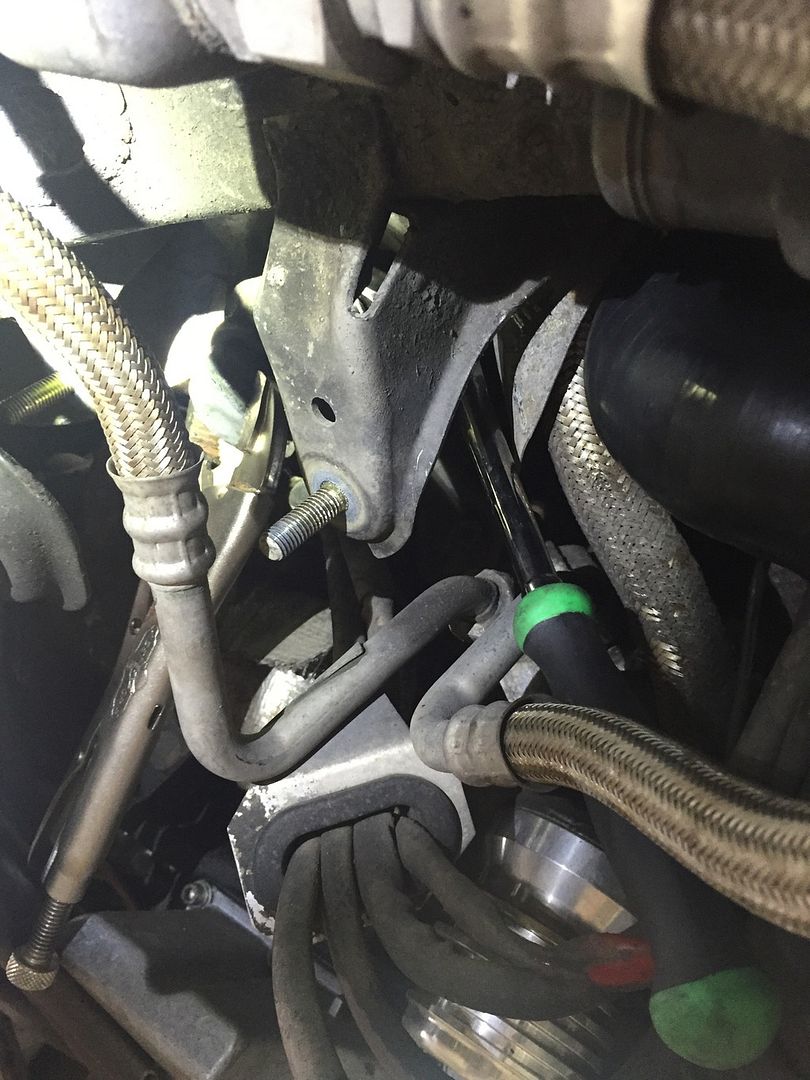

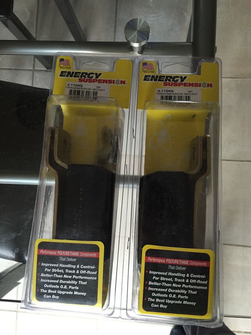

Small update, thank god for flex head ratchets...
These mustang mounts fit so well, whoever discovered them is awesome.
Unfortunately I'm still getting a bit of a clunk, I'm picking up a cat back exhaust that should help the exhaust/driveshaft clearance issue I'm having. Other than that the last driveline mount that isn't upgraded is the snub mount and the driveshaft carrier. I'm starting to suspect the carrier, but we'll see.

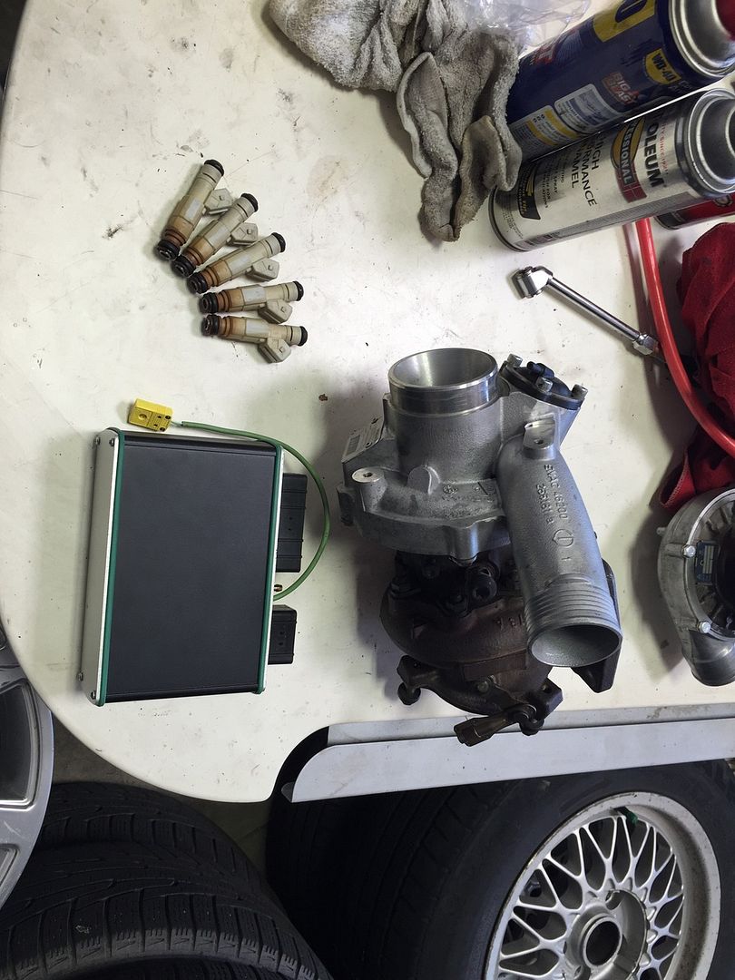

I have rs2 replica injectors, going to steal the VEMS from my 90 for the time being, and just need to get this housing back and get the turbo balanced. Just have to order connectors from efiexpress to build an econoseal --> motronic jumper harness.
Since I have to balance the k24/7400 anyways I'm seriously debating a drop in billet wheel from ARD, they're pretty affordable and supposed to net 20-30 horsepower on the Volvo, I imagine id see similar or better gains on my car with the VEMS. Hmmm...

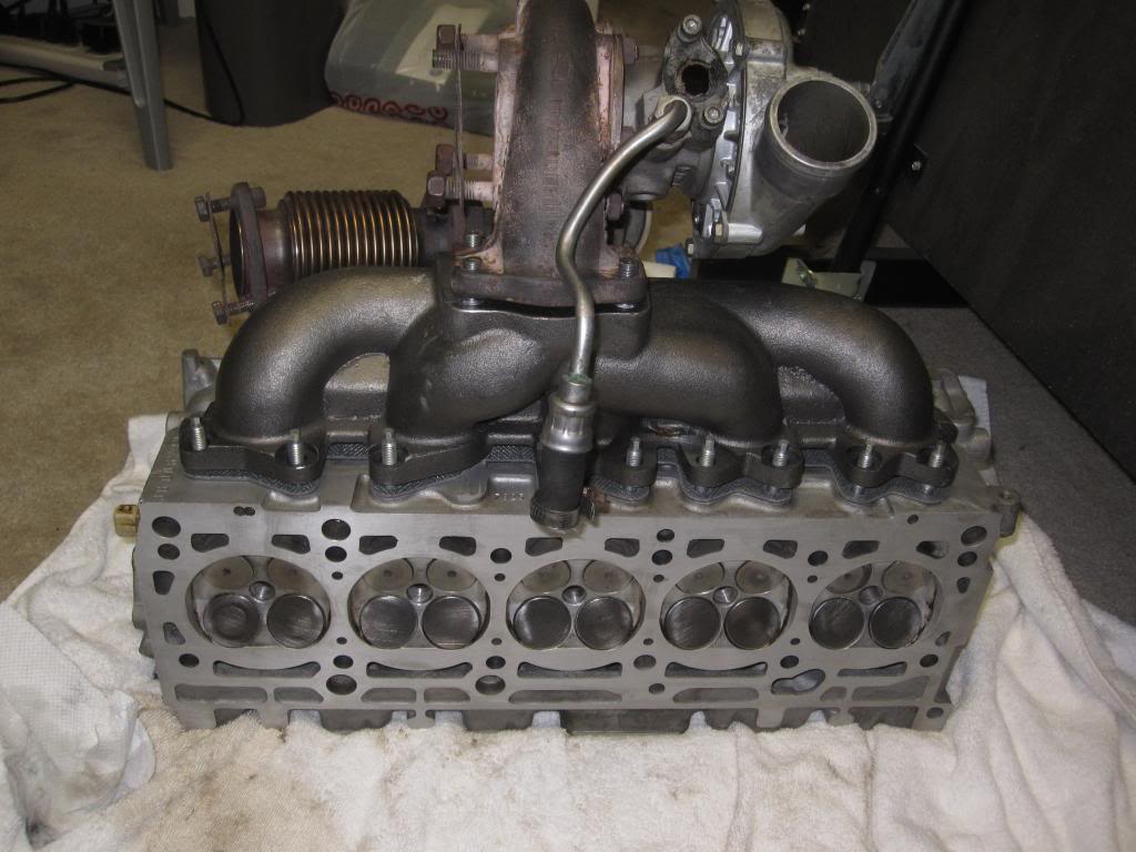

Alright guys, dilemma... I've about expended my budget on this turbo upgrade, have a little bit of slack to work with. Should I run a good stock mani or pick up an ebay rs2 replica and clean it up?
Re: Eli's 200 20v Avant, it's about damn time
By memory, the OEM manifold is good to around 350-400 bhp. In that case, I'd say run it as is for now and save for a quality upgrade.
If I'm wrong, I'm sure someone will correct me.

Post by Aktapod »
For what it's worth, I bought an eBay manifold that was recommended to me on MG. It's held up pretty well for the 20k miles I've put on it so far, and the casting looks decent (didn't have to clean up much).
For the pricing, it was no question for the peace of mind I got that cylinders 1 and 5 won't run hotter, but when the time comes, I will spring for a high quality manifold. I can find you the seller if you're interested.

Another option is a re-welded eBay tube header. I wish there was something between eBay crap and a $900+ upgrade. I could maybe swing 3-400 but an IMS or real Wagner manifold is out of the question unfortunately.

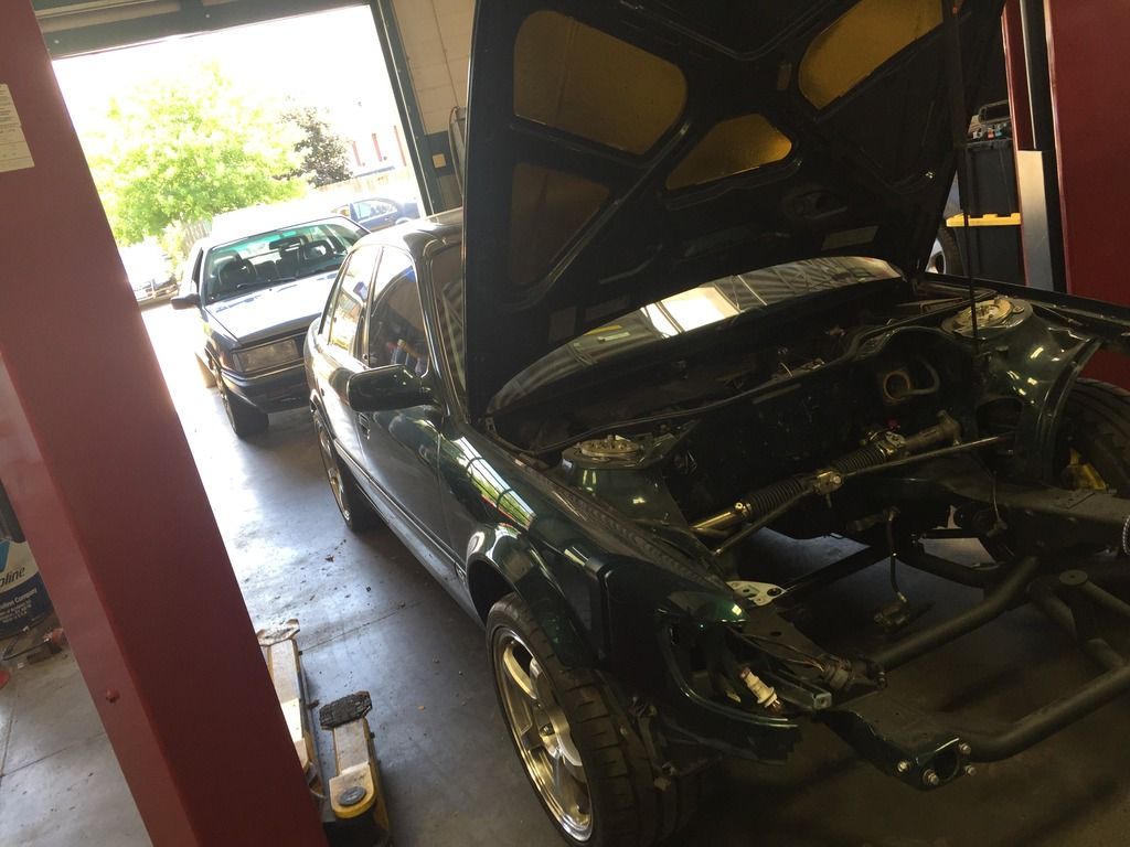

I have my work cut out for me this weekend. Just need to cut some things out...

Well I think I'll be sticking with the stock manifold till it becomes a restriction. I'll take a look inside and see if there's anything I can do to clean it up, but looking at the numbers I'm not even sure the RS2 copy is worth it flow wise.

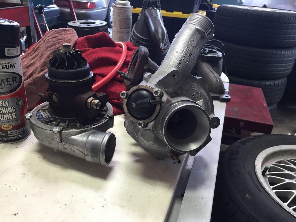

All I'm doing now is waiting on my turbine housing, connector kit from Marc, and trying to decide what to do about my compressor wheel.
The wheel in the turbo is damaged, and I have a replacement wheel for it, so I'll need to swap it and send it out to get balanced. The issue is since I have to balance it anyways do I drop $180 for a drop in billet wheel? Supposedly good for 32-37 horses on the Volvos, if I could get 30-40 more horsepower for that amount of money I'd be pretty happy. But then also the factory volvo setup has been shown to make 300-320 whp, do I even want to try to push more on stock rods?

Post by paradox11235 »
Well I just put my exhaust on and I was looking for my clunk. The driveshaft carrier is ok but the u joint has a little play in it, but then I noticed the rotational play in the driveshaft, and the clunking inside the diff... So now I gotta find a diff and driveshaft or find time to drive to my parts car and pull it in the parking lot
