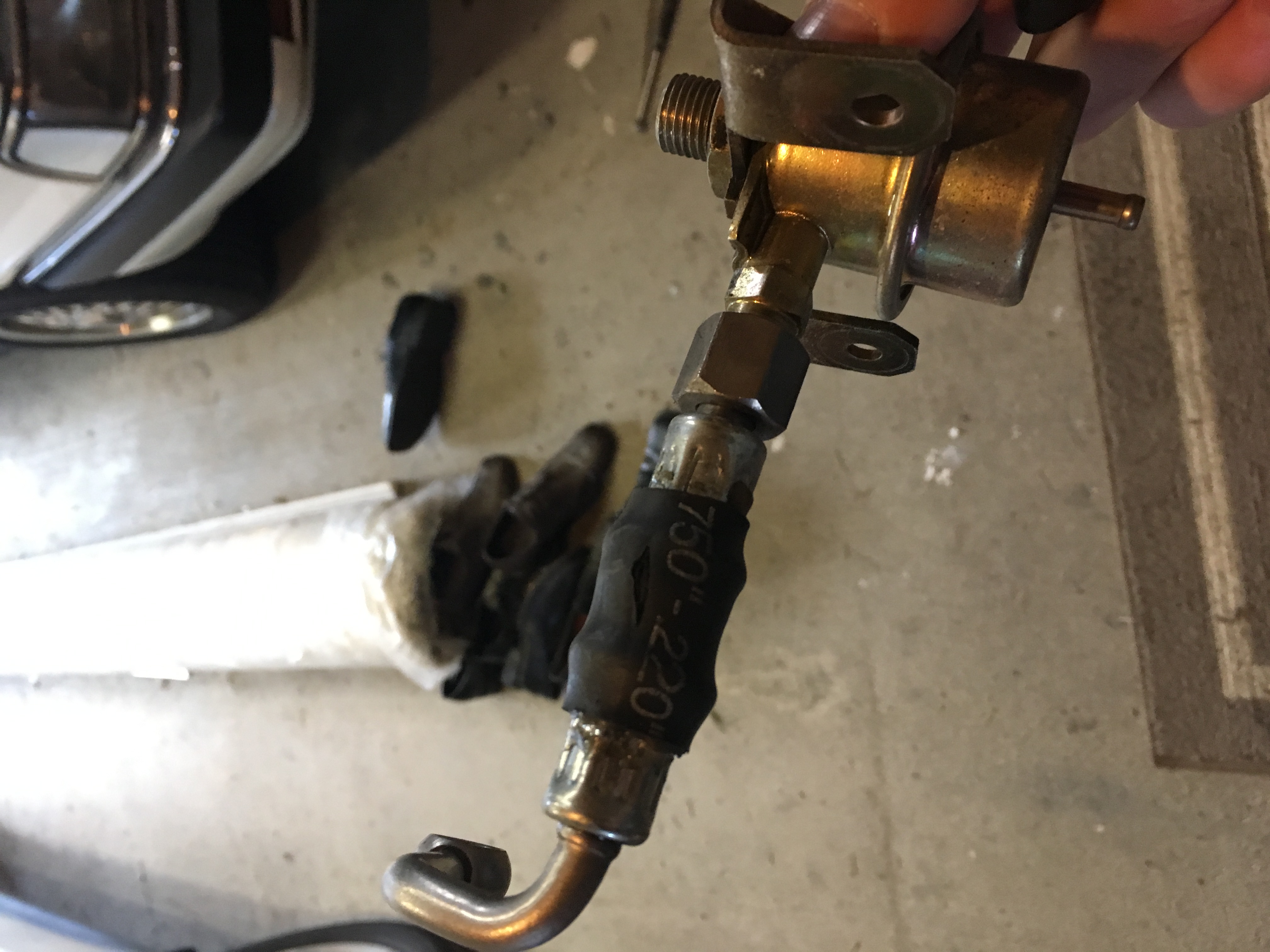

So went out to get dinner last night, and tried to start the car in the garage to let her warm up.
Crank Crank Crank, barely starts and runs for 5 secs before the smell of gasoline fills my nostrils.
I pop the hood and discovered this. Looks to me like a jimmy rig?
Does anyone have a part number for this line? I am going to buy a new FPR just for good measure.
