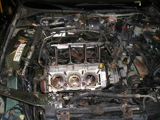

Yeah, I was pretty worried that I'd have trouble with the heads but they popped right off. No trouble at all!
I have the new head gaskets and valve seals on order to show up by the weekend.
I believe I found the issue - a broken valve stem seal on one of the intake valves for Cyl #4:

Those are cast iron liners correct? Although they are probably pretty well stuck I would still recommend some hold downs like this:
Jeep ebay and 164 Verde 011.jpg (67.1 KiB) Viewed 63907 times
Good Luck!
Jeff

Yeah - I had the same thought and put some on there last night!
