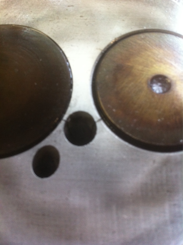

Don't feel bad my block is still at the machine shop, dropped it off in April. Plus I cleaned up my head yesterday and found this.
All four are cracked...:(

bummer man! is that the motor that was in your mk2 all modded up?
sometimes cracks are ok if they are small, is this a common tdi thing?
scubagli
Posts: 604
Location: leeds ny
Re: Lowest HP swap ever: TDI into 90q
Post by scubagli »
It was, it happens sometimes. I had an injector leaking compression last year gave it a turn and it stopped. I have a couple of people that may be able to help me out. With all the $ I'm spending I don't want to risk it. Probably build another head and fix this one later on. They cracked in the last 5k after I did the head gasket. Weird...hope you resolve the clutch problem.
