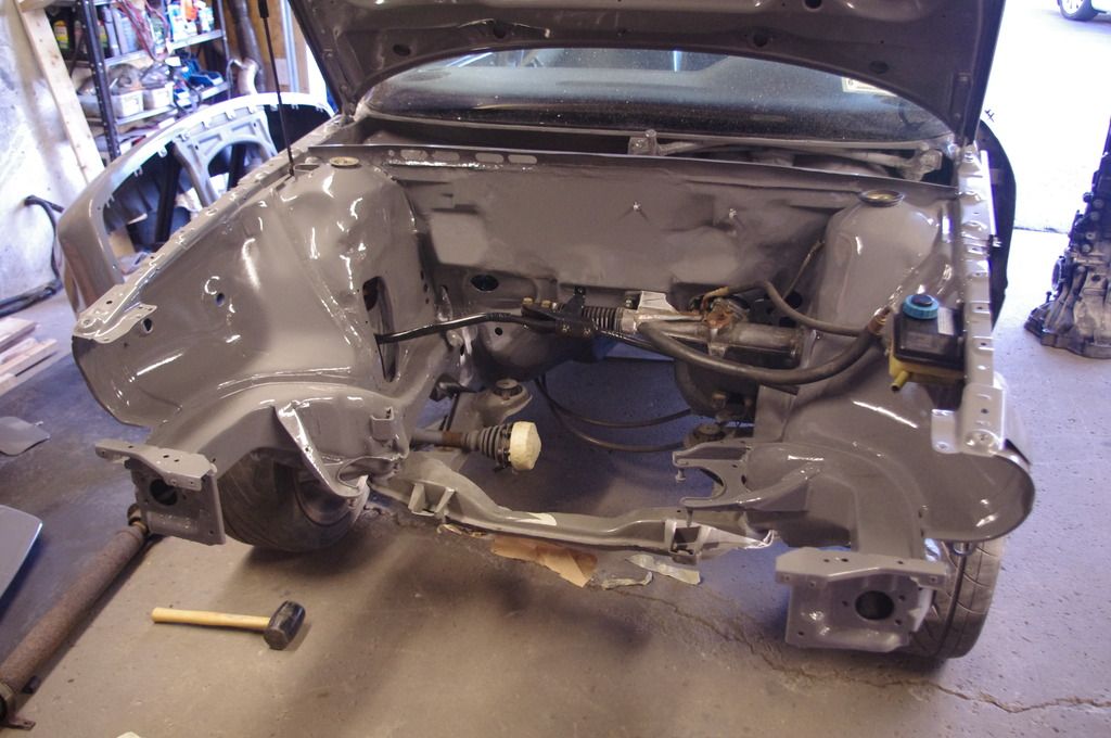

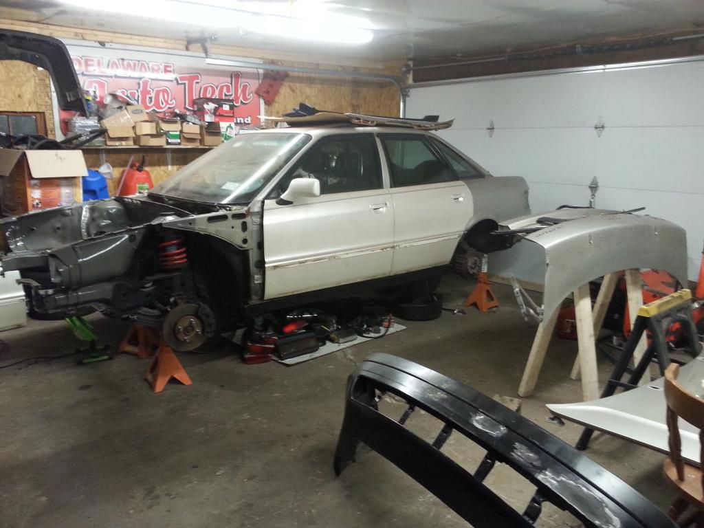

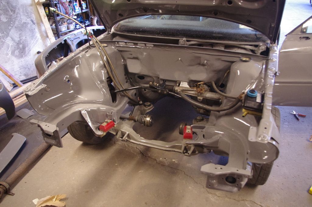

I was able to get everything pulled off the car. Seals, body panels, motor, trans and everything. Why am I doing this you ask, well I made the decision to paint the car, so it will be parked for... a while.....
Got the 'new' doors on and turns out B3 and B4 doors are identical, except for the moldings, which I will not be running anyway.

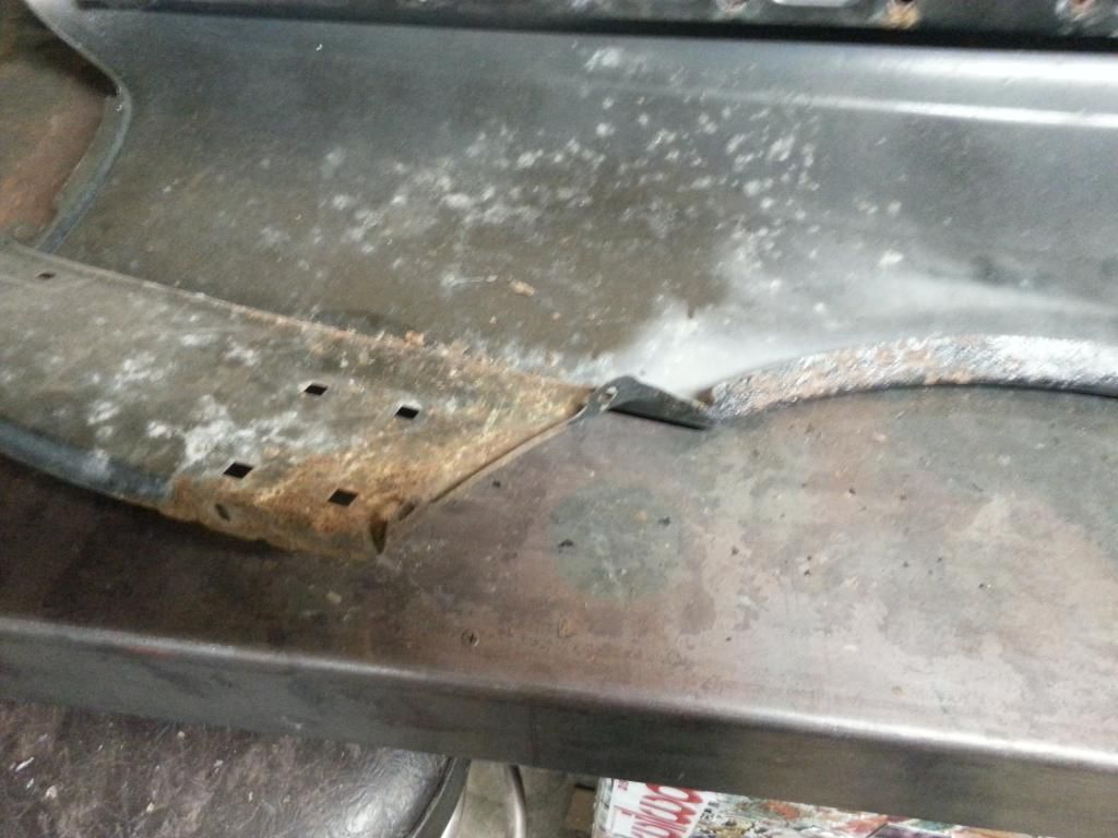

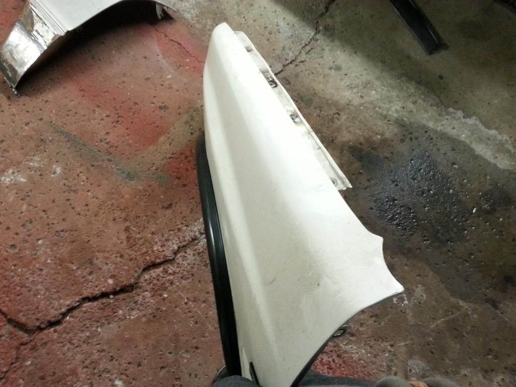

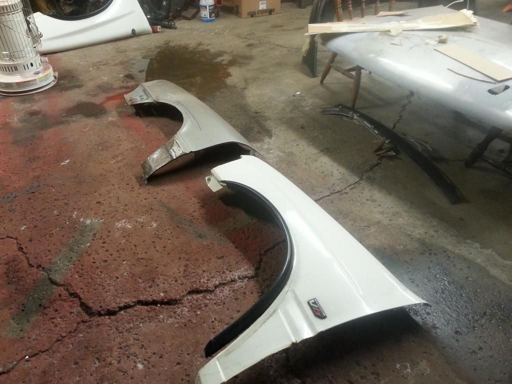

I'm super pumped on that because these doors are CLEAN. I have a decent amount of rust to take care of on the fenders and trunk, so any panel that won't need extensive work is much appreciated. Thankfully the car itself is very rust free. Here's one fender:

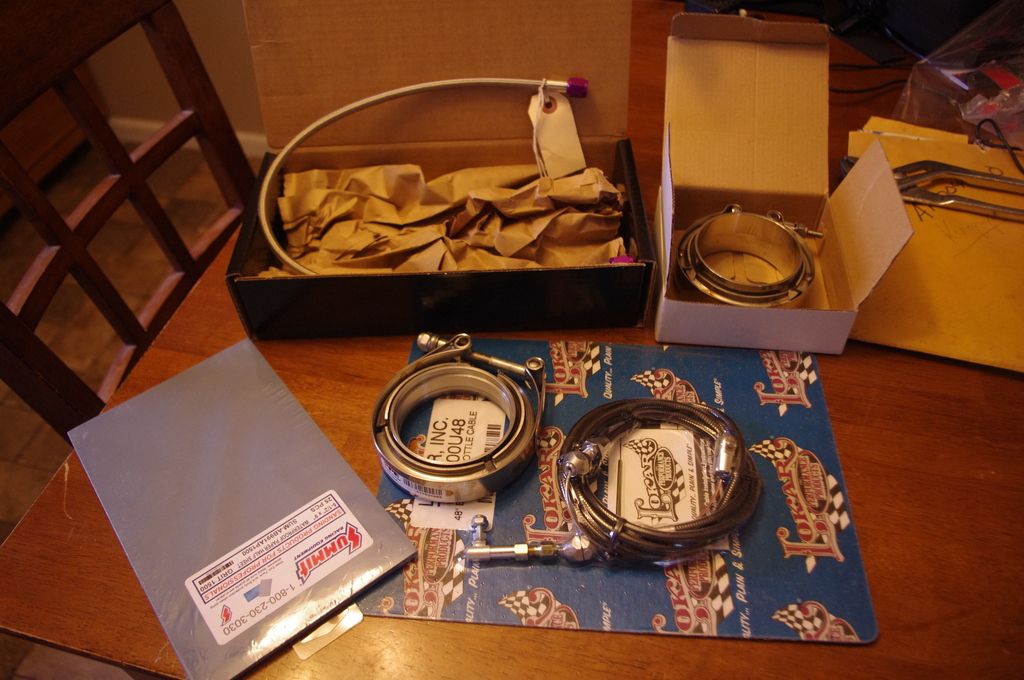

I also have some crazy ideas brewing, picked these guys up:

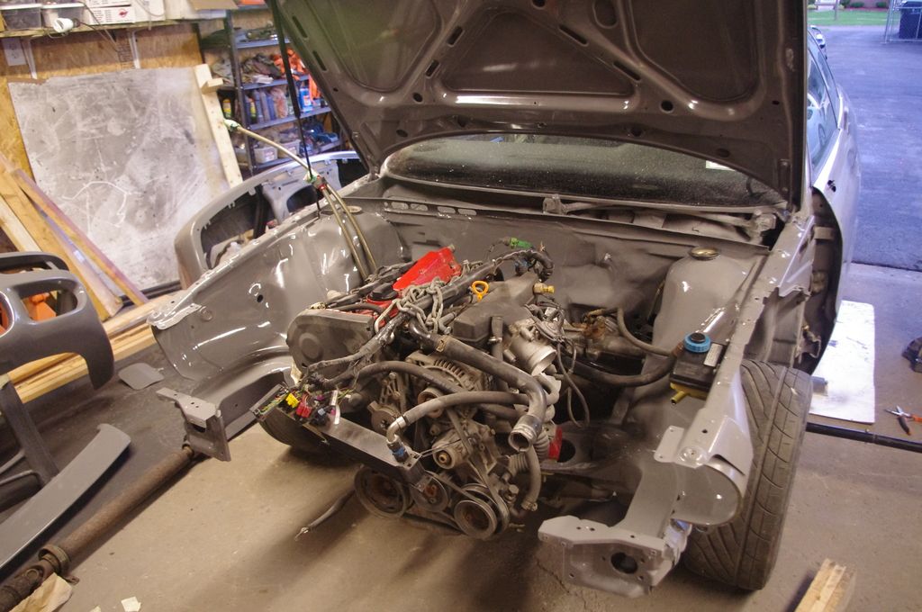

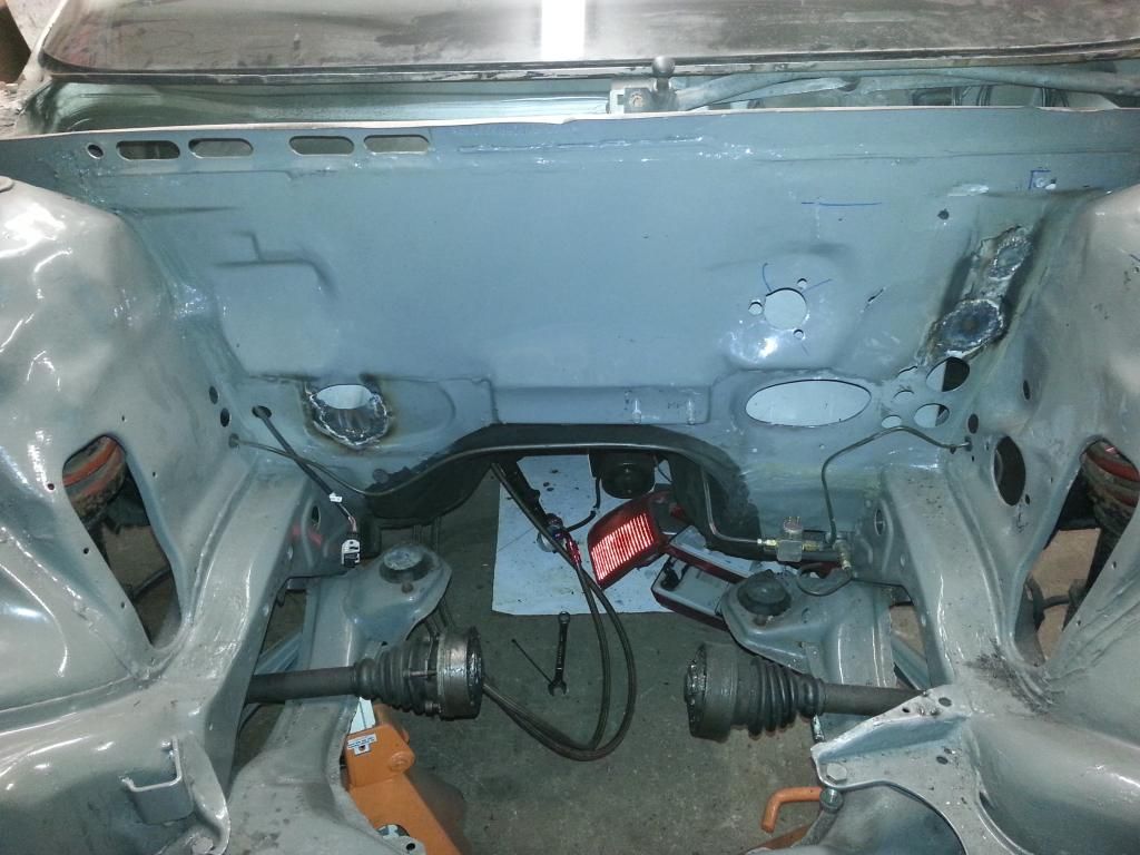

Also cleaned up the engine harness a bit by removing the O2 sensors and a few other things I will never use. Just makes everything cleaner in the bay. Speaking of which I have been doing some welding in there. Last year I didn't want to close up any holes that I thought I might use in the future, turns out I only need a couple so I can clean up that firewall even more. Still have to weld up the spot with the X on it.

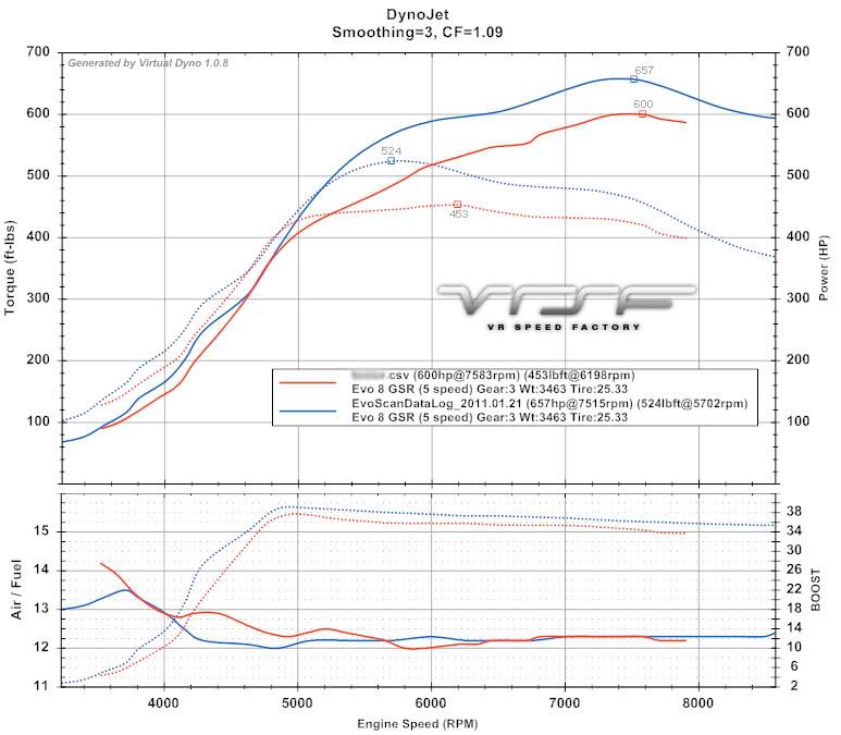

And lastly, my old turbo needed a rebuild so I sent it out to Comp, had it completely rebuilt and sold it with 0 miles on it. I picked up a 35R that is pretty hurt to upgrade to an HTA86. :) Should spool faster than my old turbo and make significantly more power if I want to push it. For example, stock head evo, 2.0 bottom end, on corn.
Granted he had some big cams and evo heads even stock with greatly outflow my port matched AEB, but I don't expect make that kind of power. I do expect to spool slightly faster because of my cams, which translates to tranmission shattering torque. So, thats why I just picked up a built 01E my friend Mike built a few years ago. :D

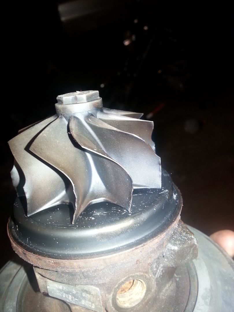

I took apar the 35R in preparation of shipping it out and found that the turbine wheel was trashed too. :(
Thinking Holset now. I'm sick of spending money on turbos and just having them go to shit. If I buy a Holset for $200 in working order, I don't think I can lose. :D

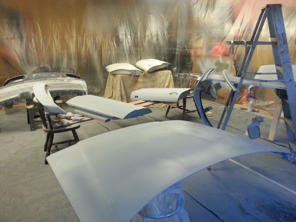

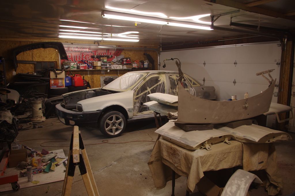

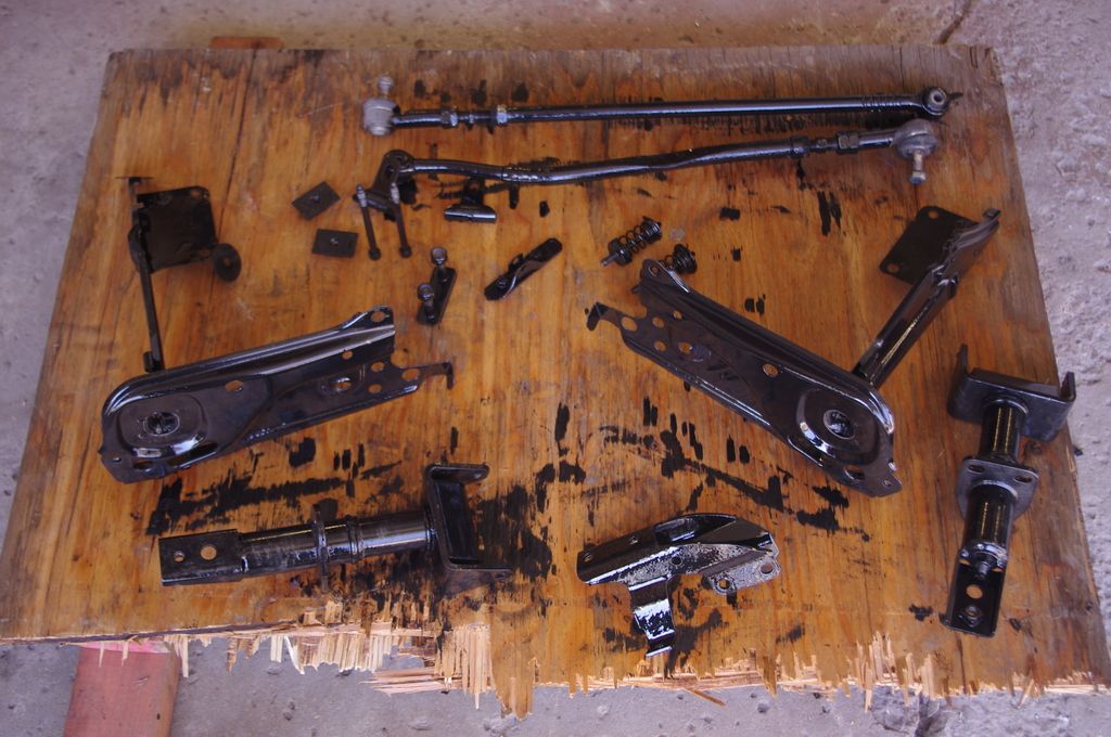

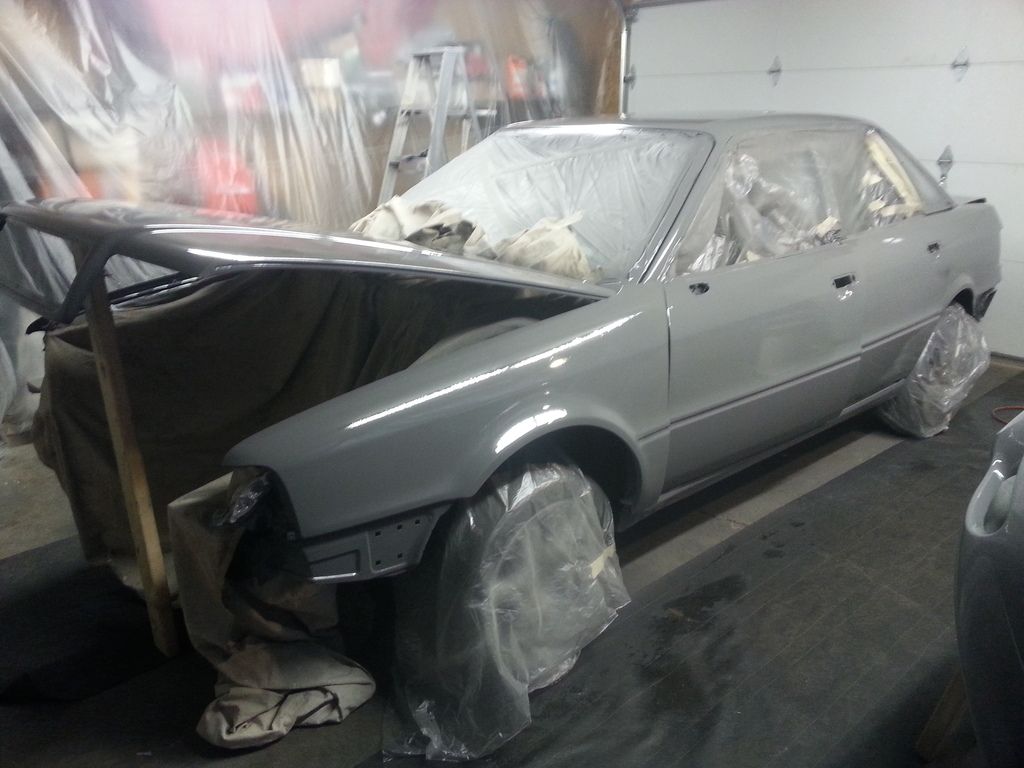

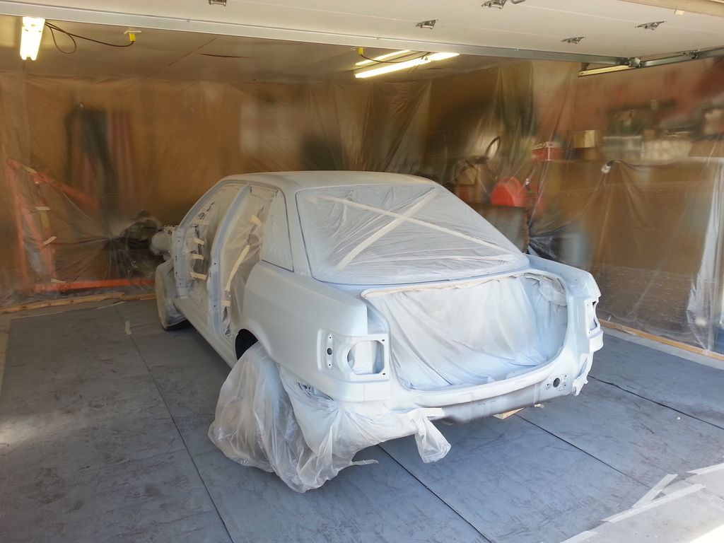

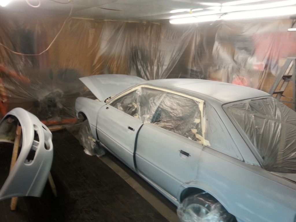

I've been busy. Sandblasted and POR15d all this crap. Also gave it a coat of clear.

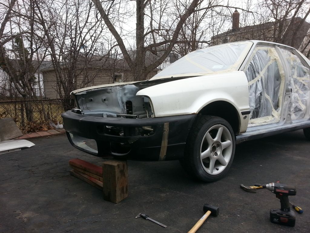

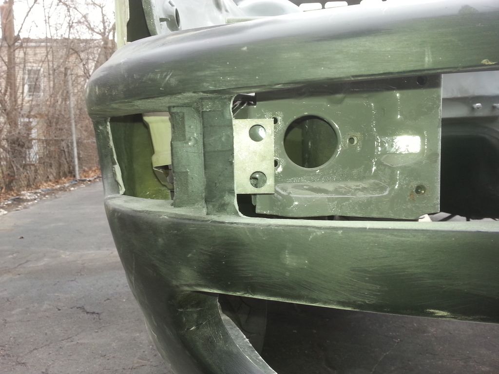

Picked up and RS2 front, B4 fenders and a B4 hood.
Fitment was perfect, as expected for a knock off.
Made some adapters:
Lots more sanding, welding, filling, sanding, priming etc.
Spraying the jambs.
Ready to spray:
Finished after a very long day:
I still have to wetsand the whole car then buff. I'm almost there!

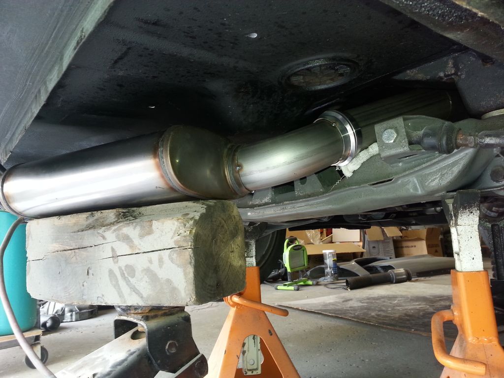

Tacked up the hard section of the exhaust:

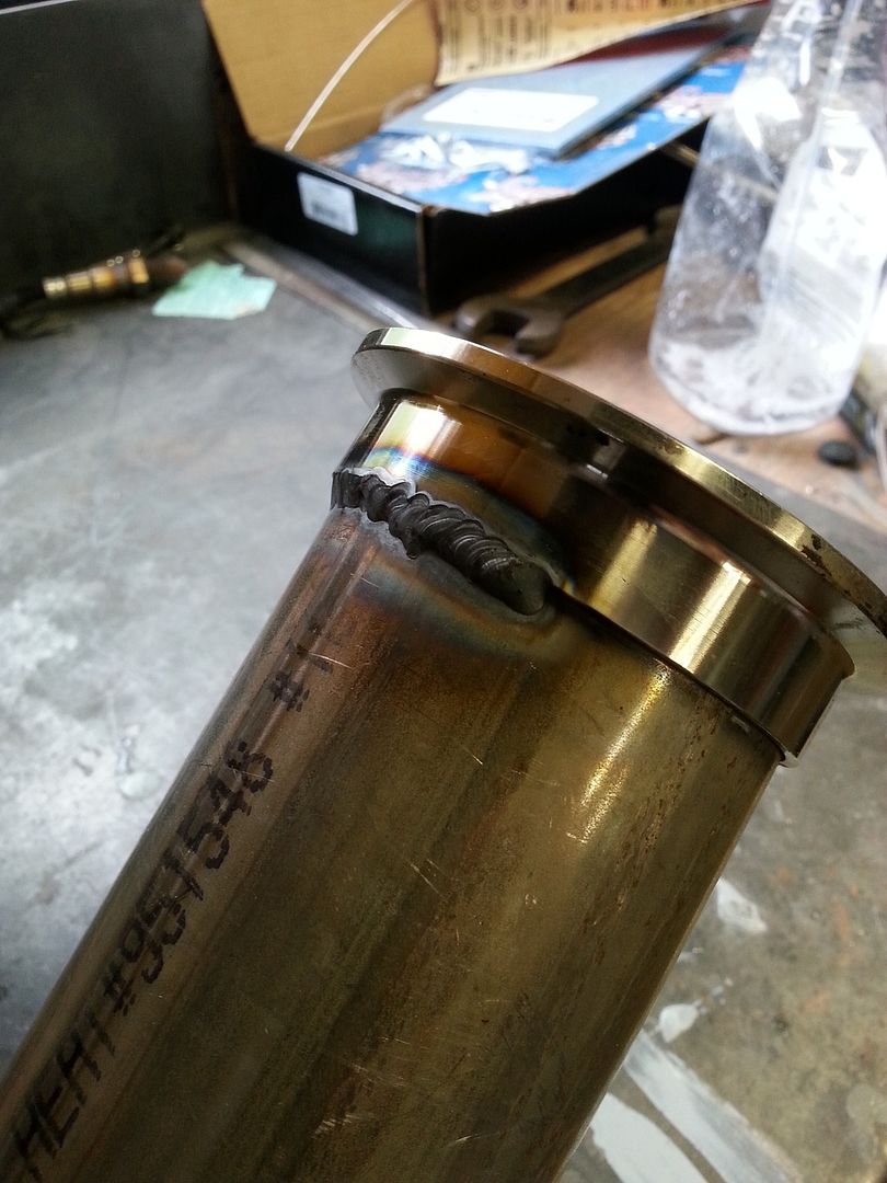

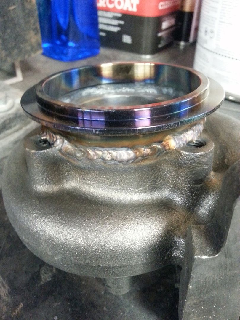

Welded a vband flange to my new turbine housing:

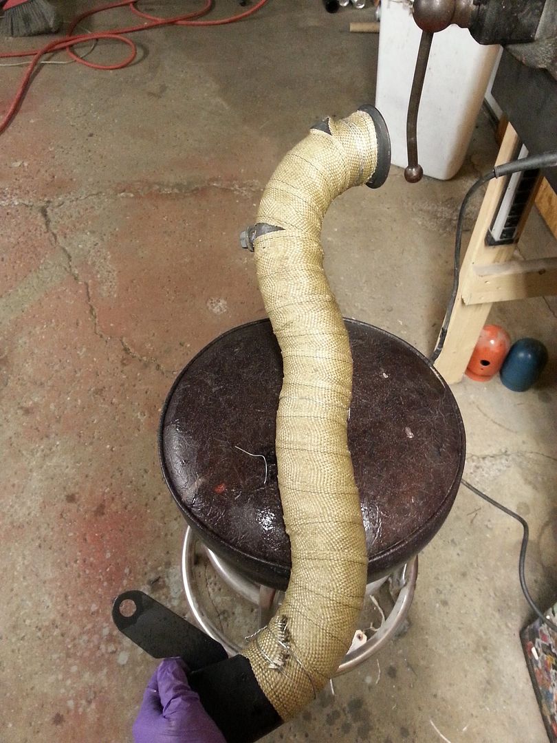

Fixed up the DP to fit well with the new mid pipe and turbo:
Tacked up the rest of the exhaust:
Welds were okay, but I didn't have a back purge setup handy :/
Finished product:

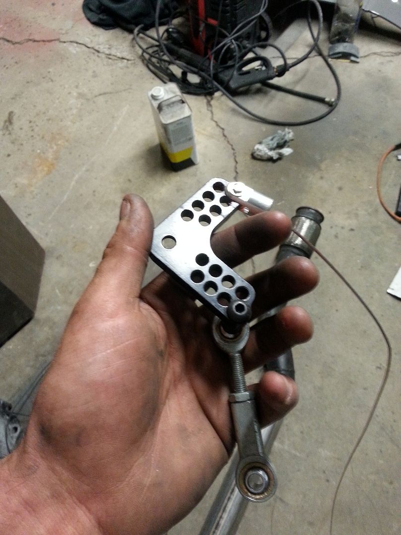

Bought a throttle cable, and the connection at the pedal cluster is much more functional than before.

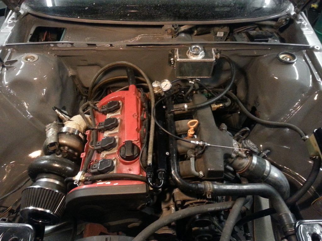

I'm not sure whats gotten into me but I've been working a lot on finishing work.Typically when I get close to driving the car, I get very excited and end up kind of throwing the remaining parts on and running it.
This time it will be different....

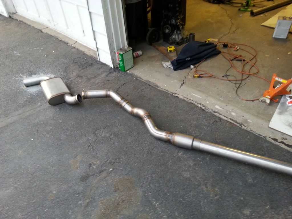

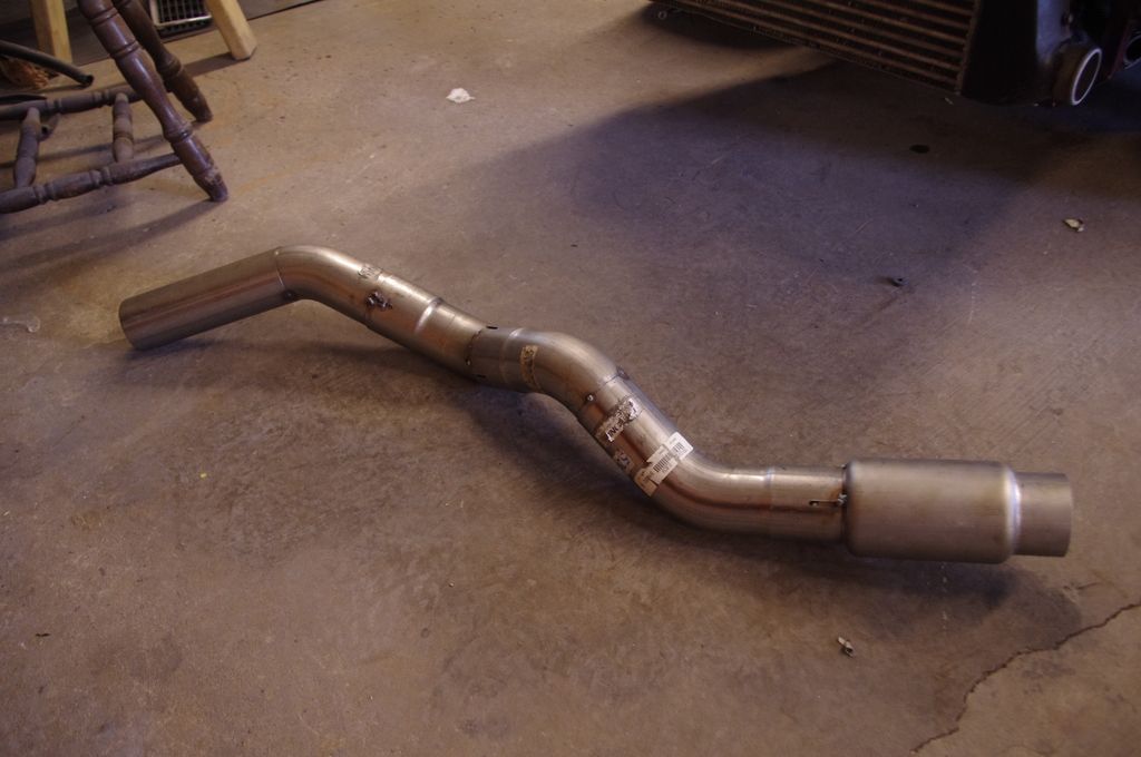

Got the exhaust finished, hangers and all. I used some thick walled ss tubing and borrowed a tubing bender from work. Worked like a charm.
Also with Eddies help got the fenders fitted pretty well.
The trunk lid, lights and lock were also re-installed. With some fresh seals I might add.

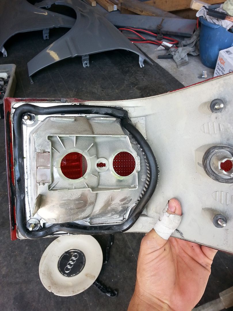

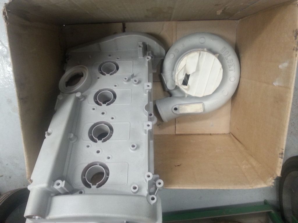

I decided that this wasn't going to cut it

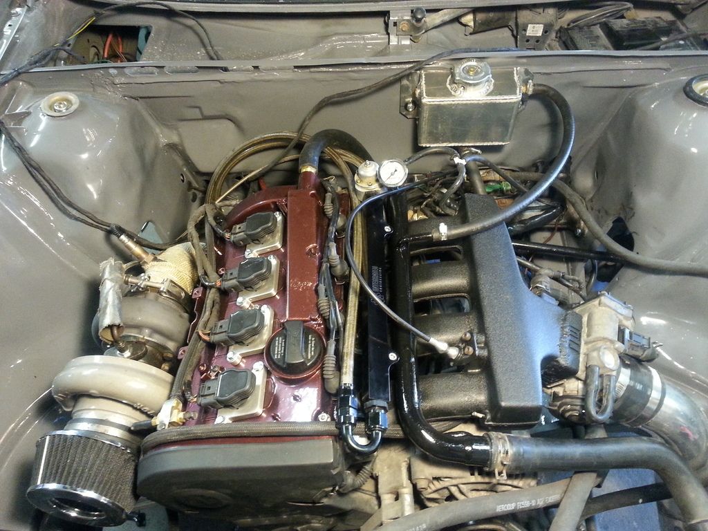

So I sandblasted some parts
And yanked the barb out of the valve cover and tapped it for a 1/2" NPT in case I want to run an AN line from this eventually.

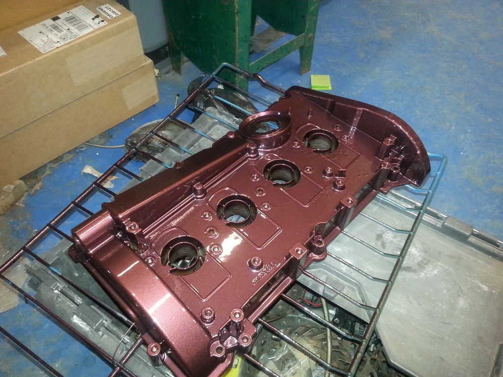

And with lil nicky's help powder coated it to match the rad support I made earlier.
Also clearcoated the compressor cover and Nick was kind enough to 'diy' ceramic coat my turbine housing!

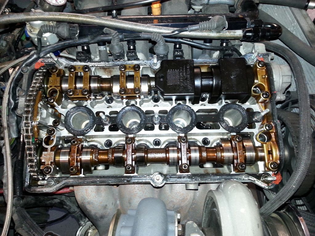

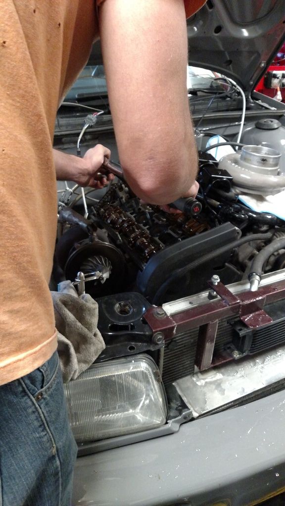

Peaked under the valve cover and found that my frequent oil changes (because I had no idea how to tune MS3) has cleaned up my head nicely! haha

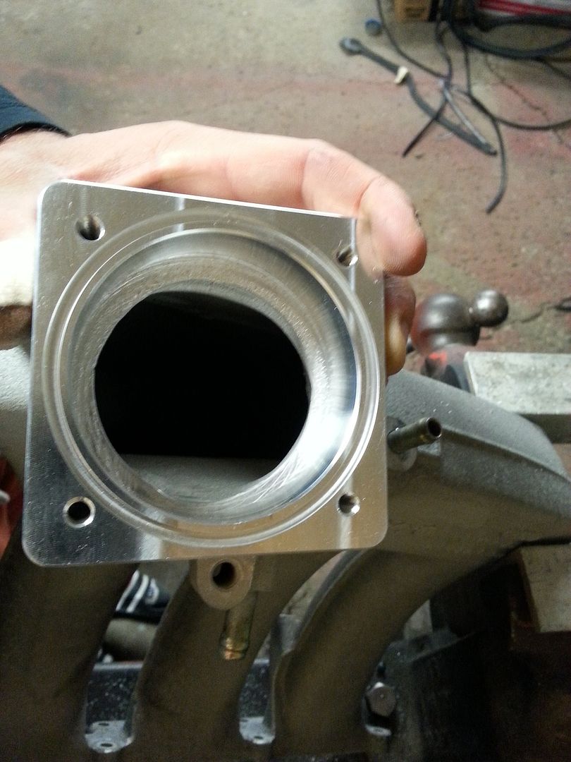

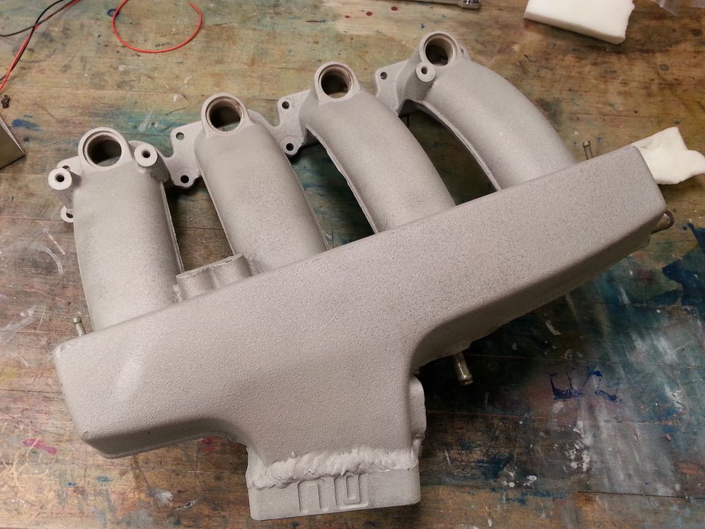

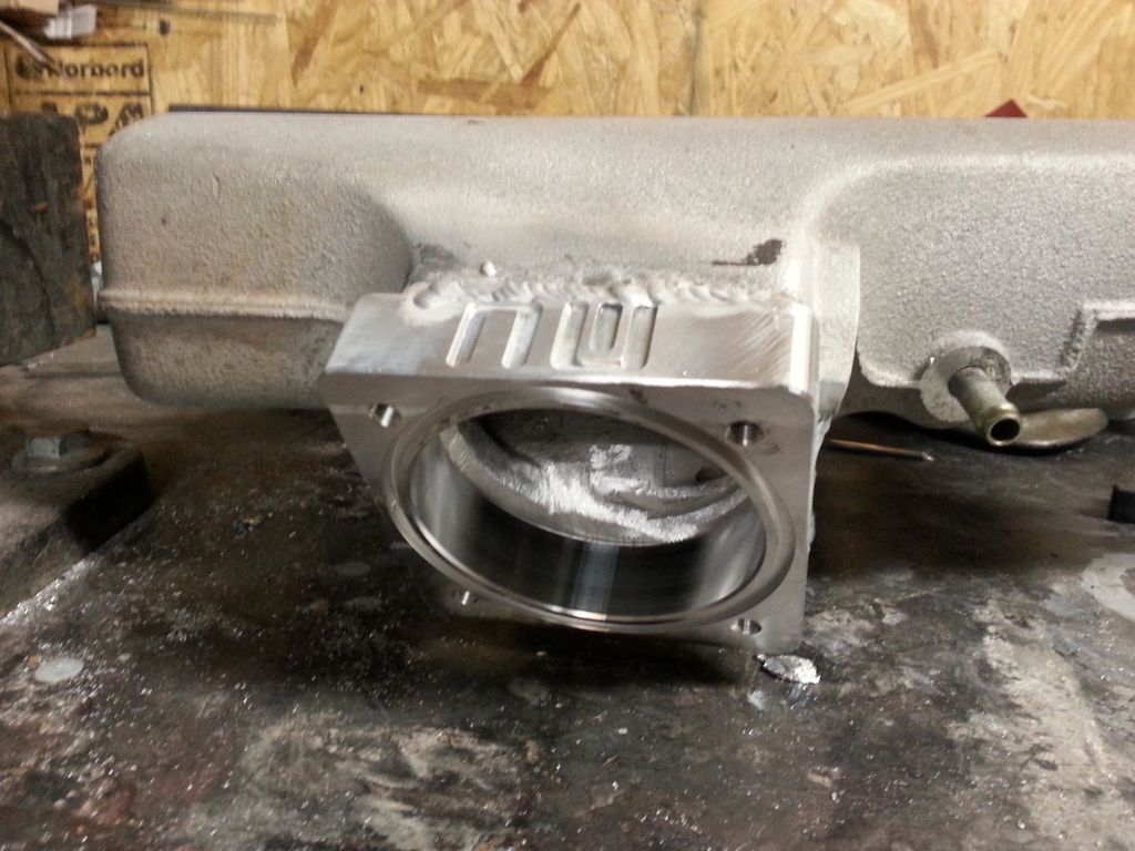

I bought a flange that will fit the bigger VR6 tb I am running. Before I had an adapter, but I think it was leaking and it looked like crap.
I tried taking a before picture to show the restriction, but I had already started taking material away. At the end of the day I was probably able to increase the diameter of the port by 3/8 of an inch. Doesn't sound like too much but its about a 33% increase in area!
The cast manifold was too terrible to weld, but definitely wasn't perfect.
Sand blasted.
And boom
Looks better in person, my cell shot doesn't do it justice.

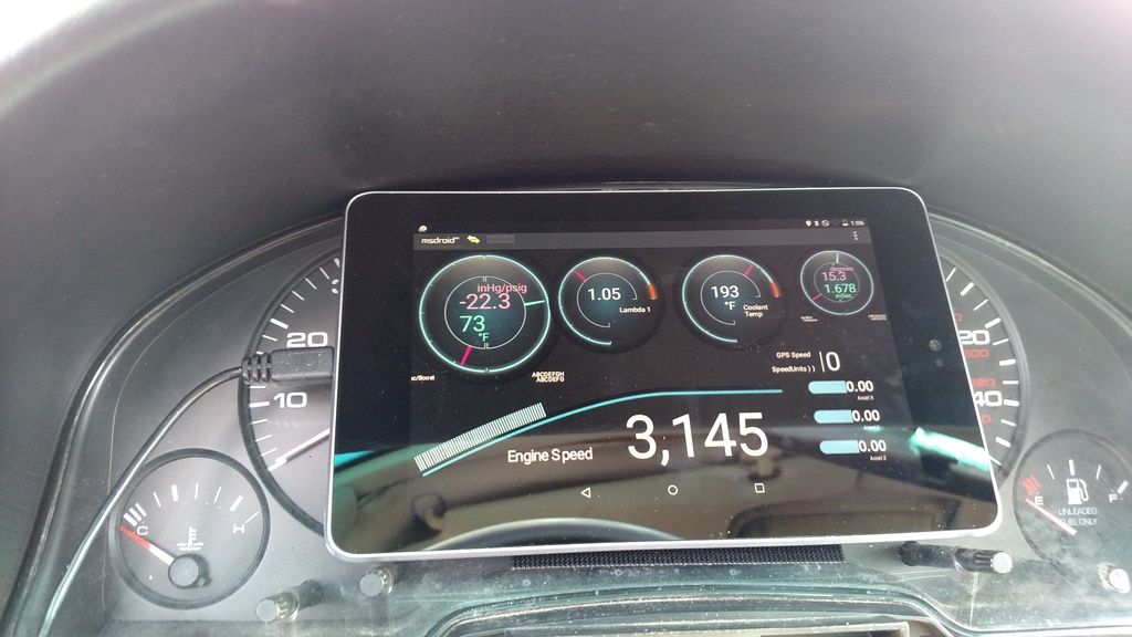

Got a temporary display working, still having issues with my factory cluster mating to the megasquirt.
