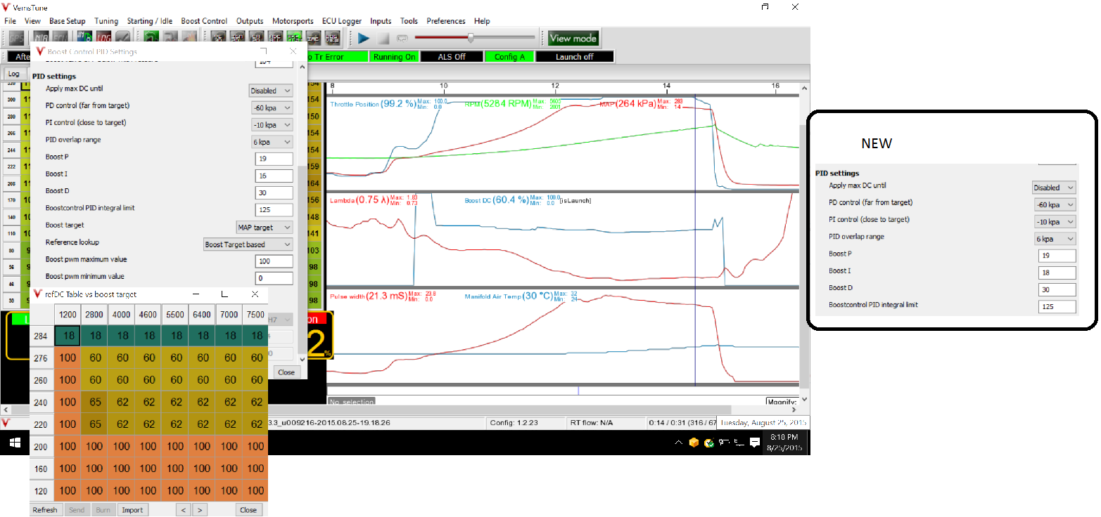

I have been slamming into boost cut all day! Chris called it. Of course I disabled "100% until" altogether. Probably something to do with this.
It's because of your refDC table. The values you have during boost onset are too high. 75% DC is OK at high RPM because the turbo is falling off up top, but at low RPM it's way too much (the turbo wants to boost it's balls off at that point).

Yep I just continue the 60% trend down further to mid range. Logs don't lie. ~80% was where I was pealing my face off the wheel ;)

Unbelievable. It took me this long to figure out how to fix my boost control in 20 minutes hahahah! Based on this pull below, I made changes to PID values which I included to the right again. I have had D at 30 for ever since I can remember but basically, as per your suggestion many moons ago, I was set to zero and P was adjusted up or down based on whether I was hitting boost cut. When I got within 3 kPa of my target, I was increased for fixing the errors. Whew! You'll also notice that 100% until setting is still off. :guns: :guns: :guns:

I'm quite impressed with the sampling speed. It must be pretty damn often for the system to be able to react while I'm still in first gear. Yeah and I'm not exactly hyped about that 0.75 lambda during the run. I went looking for my paper with the w/m mixture equation I figured out so that I could calculate the exact amount of water to pour into the reservoir to achieve a meth mix of 25%. Its gone :wah: , likely happened during my move 2 years ago. I may just pour the rest of the 1/2 gallon of water I have sitting here and see.
Also my idle has been overly rich ever since I dropped it from 1000 to 850 RPM as an experiment. A fleeting vibration was the result and I don't particularly like it that low anymore. Got too used to the higher idle after all this tuning.
Did I miss the issue with 100% until? Your refDC table is doing the same thing for everything under 200 kpa.

It's cheating. Chris says haha. He mentoned the choppy nature of the DC table and that it needed revamped since it, combined with my minute PID, were not helping with boost "control." I may turn it back on to see how spool is effected.
Actually I think I just was using everything wrong and I needed to go back to basics. My ref DC table was too precise and my PID values were too small to be allowed to control anything. Now that my table is improved and the PID is actually effective, I could probably try toying with that 100% until parameter again. Will revisit tomorrow.

lol yeah... There is no issue with having the 100% until on if you're using it correctly, but like you said, it is a good idea to get back to basics and get the boost control working properly without that. Then apply that setting as the icing on the cake if needed.
Ed is right that you were already doing the 100% until thing with your refDC table lol. The other issue is that you can't really tell if your PID has any authority over anything when you have these other settings going on. The idea is to get away from bandaids like "100% until" and the refDC table in general if possible. It looks like it isn't really trying to do a whole lot still (the PID values). Anyway, I'm sure you'll get it figured out. You're on the right track now.
Let me put it this way. If tuned properly, the PID control system will ask for 100% duty cycle while the turbo is trying to spool up. There would be no need for 100% until.

That last part was pretty helpful. I was never sure it would make that decision itself.

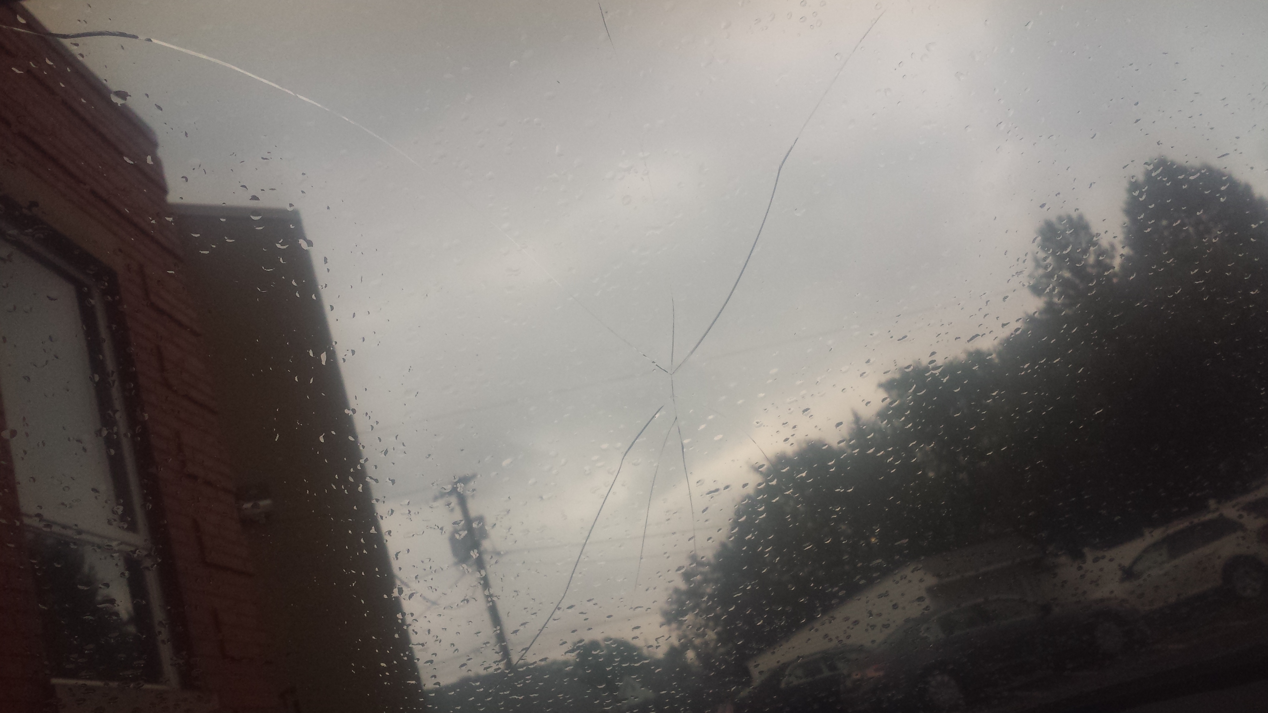

So I cracked my windshield while trying to muscle the MFing 034 shifter in..

:bangshead: Oh god dammit! :bangshead: :mad: :mad:
$200 deductible. Filed and appointment for Friday morning. F### me I'm stupid when I'm in the zone
Um... How did you break the windshield trying to change out the shifter?

I'll give you 3 different options. Hint - it's not always the most detailed scenario:
A) I meant to :D
B) I was laying on the roof kicking my feet while trying to reach the shifter inside through both front windows. It was at that point where you have to figure out how to get the lowest, spring-loaded, round part of the shifter back into its socket. You don't WANT to take the long way but fear you might NEED to in the end but you've convinced yourself you have a shot anyway. Suddenly, and without warning, it cracks before my foot even hits the glass again.. !!!
C) same as B above except I was in the front of the car with one foot inside each foot well and I'm applying my entire body weight to the shift knob. That's not cutting it so I brace myself against what feels like the roof. And, like giving birth, I push with all I've got... right into the windshield and the sound of it cracking makes me die inside. Cursing commences.

Lol you're crazy. That windshield thing is very common with BMW owners because the shift knobs are push-on rather than thread-on. I don't know who the hell decides to make a push on shifter. Thread-on is so much better!
