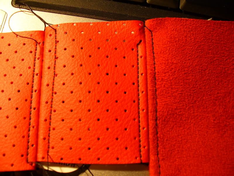

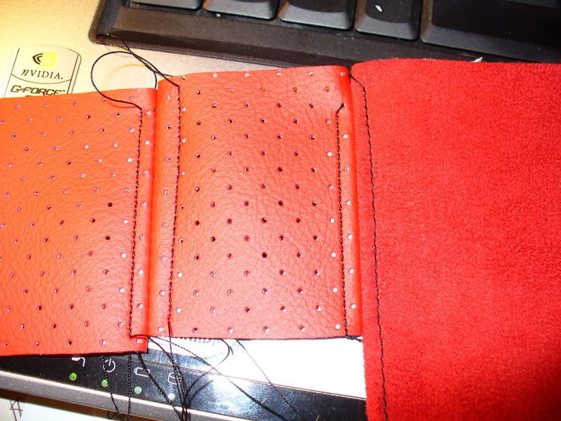

WOOT! when i got home today i had some materials waiting for me :D so i did some playing around...
not all the seams will be like that as some of the bolsters and panels on the recaro seats are separated by a gap, but the perforated red and the alcantara are nice! i gotta figure out how to get some black in the mix though i think.

Derek, i know a thing or two about sewing.
heres a quick tip, use chalk to make straight stitch lines.
best part is that it cleans up easy.

oldsklaudidub wrote:Derek, i know a thing or two about sewing.
thanks for the tip Corey, but i've already sewn a few things before ;) this was just a test on the sample pieces that i had been sent, so free handing it was all good 8)

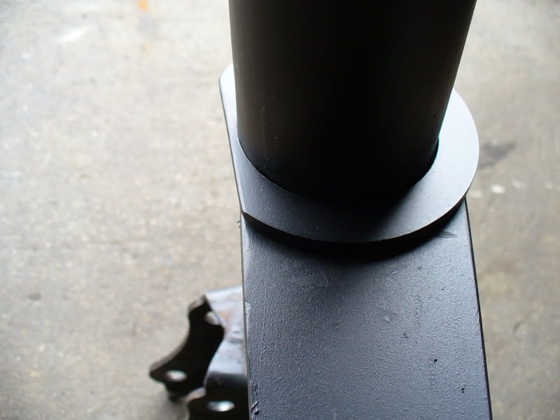

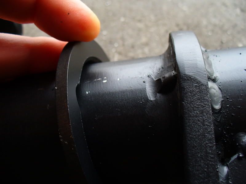

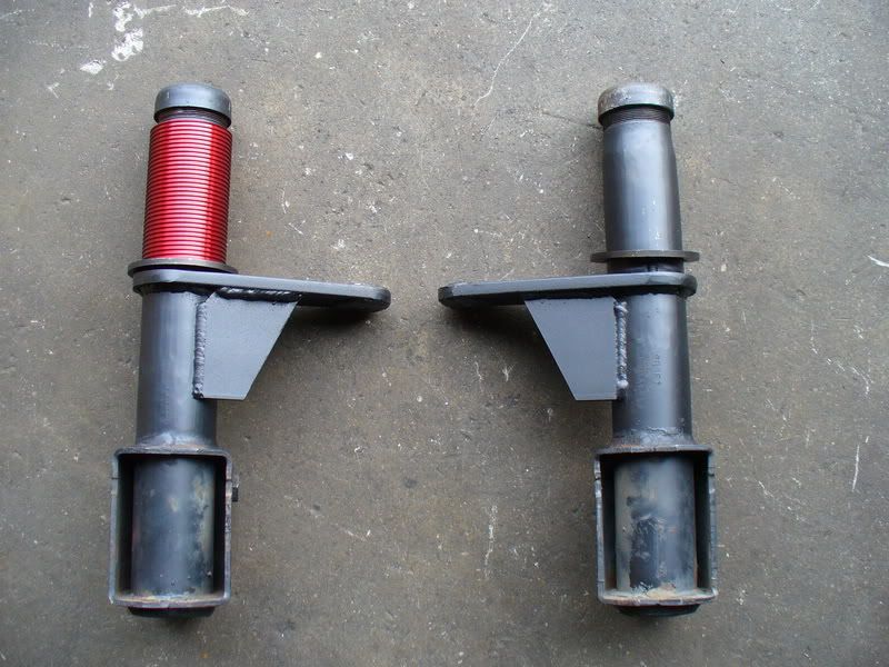

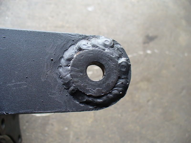

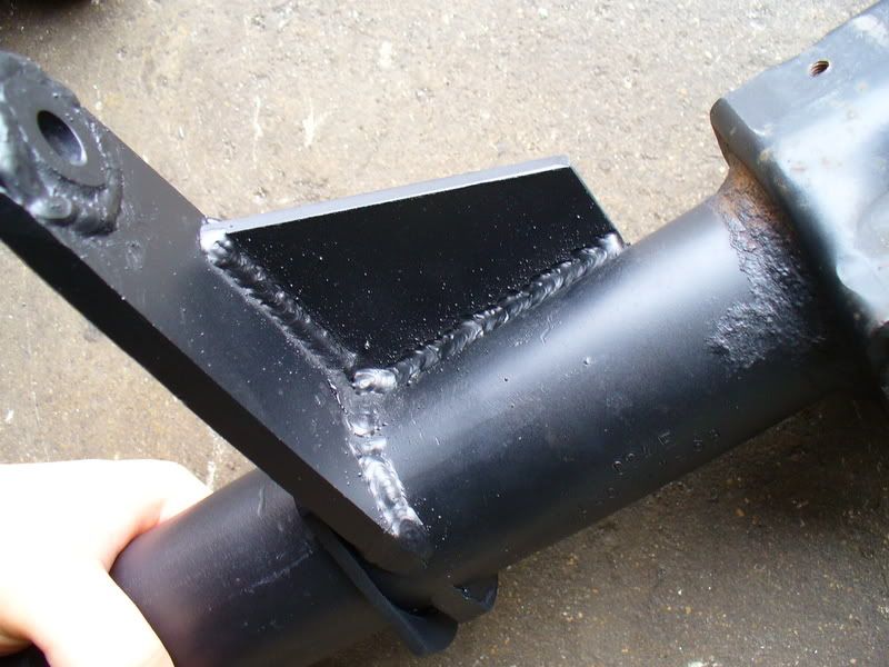

back in CA for the week and finished up the front struts yesterday...
i cut the spring seats flush with the steering arms for clearance as well...
and to make sure that the ring stays in place i put a tack weld in the back, and ground a notch in the ring to make sure it stays there.
they're melted in there guud. i accidentally got one installed the wrong way and had to spend a while carefully grinding the edges back and then put it in the vice and went at it with a hammer and punch... got it though!
i'm excited to put these in and see how well they work 8) i need to make a bar for locking the steering at the exact center of it's range so that i can adjust each steering arm length perfectly. i'm thinking about installing a steering damper as well since i have the brackets and what not from a 90q.

Clouse
Post by Clouse »
How did you get the original spring perches off and have such nice and smooth strut tubes? I remember being pretty damn careful with my grinder smoothing out the original welds, but man your's looks like there never was original spring perches.
3bAudios
Post by 3bAudios »
radiant heat im assuming for the floor......boy that would be nice.....
derracuda
Post by derracuda »
#1. grinding carefully... if you hold the grinding wheel parallel with the tube, you can sort of guarantee not digging into the tube much.
#B. i did dig into the tub a couple times :P i just zapped it with the welder and then ground them smooth.
if i had a lathe or something i could probably machine them off real nicely, but i've built everything by hand here.

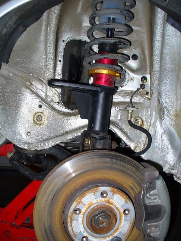

Post by derracuda »
i got the new struts in place... and boy do they feel great!! turn in is nice, and there comes a certain point when they seem to turn more than the input, but that's on a fairly tight corner where it's wanted, but normal turns it feels fine. i can take a 90 degree 15mph corner at 25mph with my hands at 9&3 on the steering wheel and not take them off for a second grab to stay in my lane. i'm_very_glad i did this... so far :P
it's also nice not to have the bump steer anymore since i put the steering arm height back where they belong.
