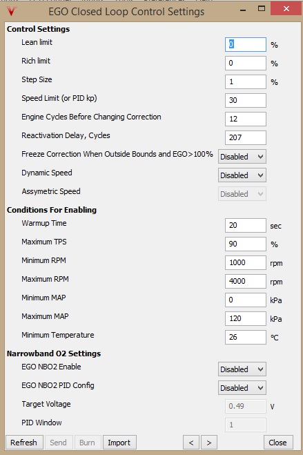

Yep, so it's shutting off over 120kpa and 4000rpm.
Re: Rubi - Not Really Feeling Right ATM...
It's completely off. 0% rich and lean corrections.
That's not necessarily bad at all. It prevents things like exhaust leaks and bad sensors from leading you down the garden path. Which is what I had been wondering about.
