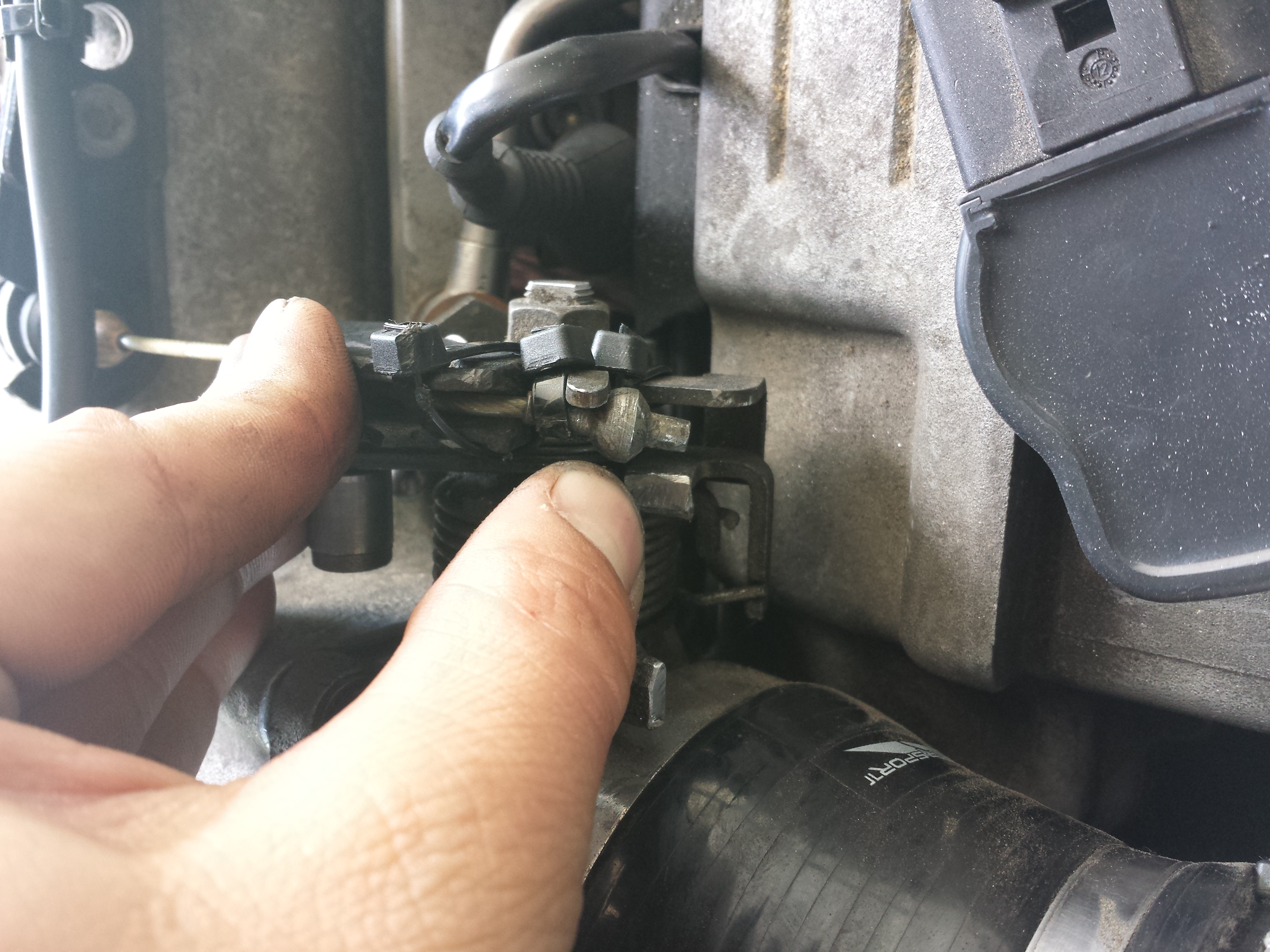

Okay since not many of you may have deleted your IAC valve on the 3b, I figured this would be interesting. I was getting a bit of a drop-off feeling in power up top and the inability to hit my target boost since removing it. I looked at my logs and saw my tps was only hitting 98 max. I adjusted it and it was a little better after seeing 99%. I decided to take like .001 off of the surface shown below and now I'm hitting 100% again.
This occurred after adjusting the throttle open slightly at rest to raise the idle with the IAC valve gone. It was apparently enough to make seeing 100% physically impossible so I had to get creative...
- Shiny surface right under my thumb nail
- 14427715693901733480483.jpg (3.76 MiB) Viewed 24650 times
It shouldn't matter if it's not exaxtly 100%... You can just adjust it in VEMS anyway lol

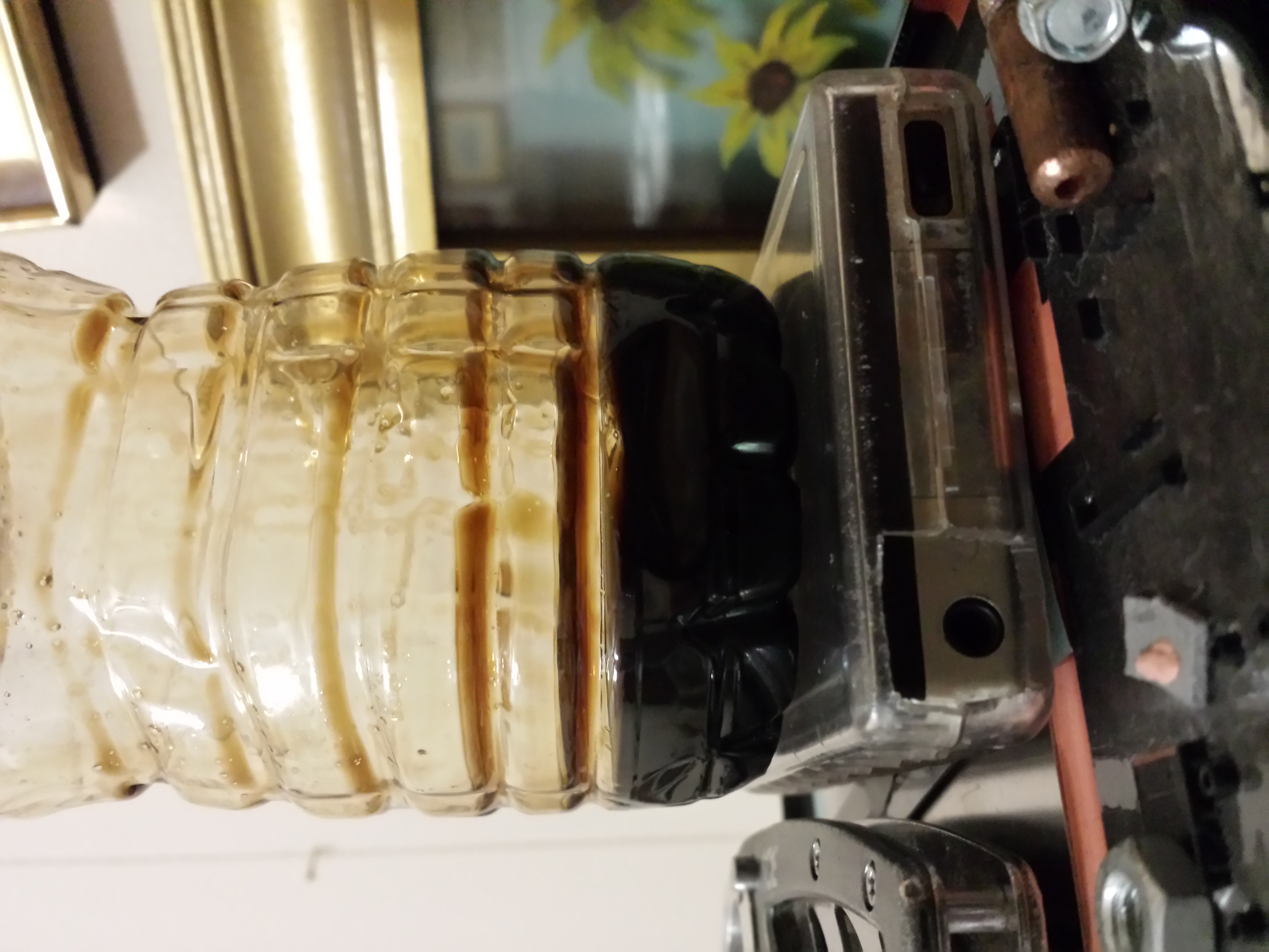

I just checked my catch can vac tube off the intake and I put my finger in it to plug it while revving the motor in neutral (of course lol). I got ZERO vacuum off of it. I need a better place to tap into besides right before the huge k&n.
What prompted me to test the vacuum was I cleaned the CC with brake cleaner and left it vented. Then when I saw steam coming from there with the hood closed I began to panic
because I wasn't sure if it was exhaust or steam which was likely exaggerated by my hard pull right before that and using w/m all the time. When I put it back on the intake tap point I checked vac. IVE always suspected it wasn't doing shit there!
Have you ever done a comp. test? That's a lot of blow by to fill that can.
I agree. I could swear I did the test on 3 separate occasions. I remember once when I bought the car (below zero out and no oil in cyls., all between 170 and 215 psi) and again before blowing the HG. I thought I'd done it again since the head came off but the last time the numbers were between 160 and 180 IIRC. Seemed "stellar" to me at the time
I don't think I want to know what the #s are right now hah. I haven't had anything bad happen since those tests besides the HG going out. I use great oil and it's never looked bad on the dipstick. I even started using a magnetic drain plug. Even talking about it being a problem is making me sick.
Isn't it true that the rings could stand to benefit from a higher vacuum on the crank? Better seal and such? I really need to get that worked out.

This is how much oil was in the CC tonight after 2 days and heavy abuse in 1st through 3rd gears.
