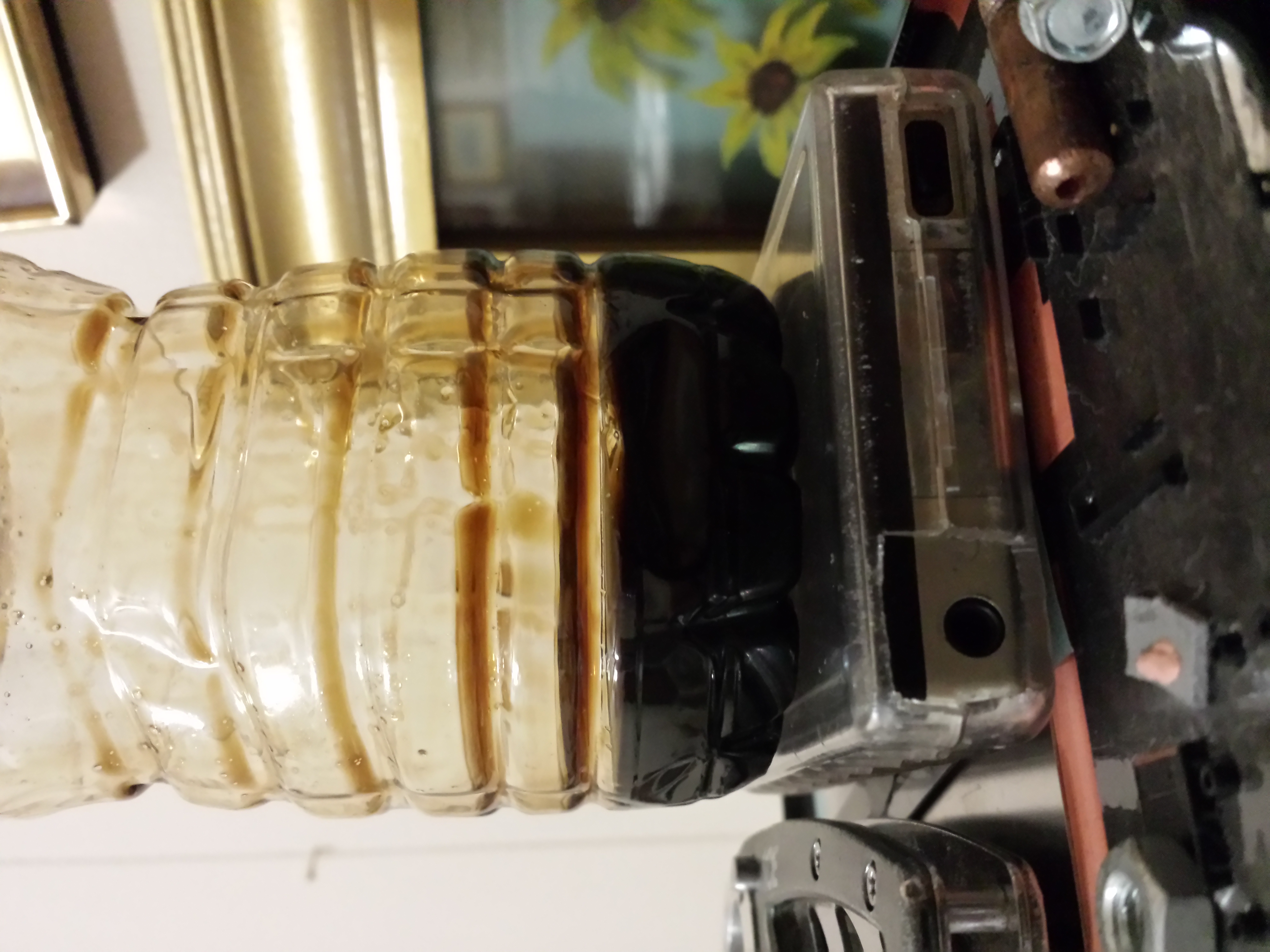

by 88a5tq
This is how much oil was in the CC tonight after 2 days and heavy abuse in 1st through 3rd gears.
Typical 16.9 FL oz water bottle
Things I've noticed:
First gear usually pulls quite hard all the way through.
Seems better when coolant temp is down to the 1/4 mark.
Low MAT seems to improve the issue.
Rpm's below 5k pull really well. Good power.
All low power symptoms occur above ~5500 rpm I believe and in 3rd gear IIRC.
Is this the rings? I will do a compression test on my birthday :rofl: so results Sunday night.
ALSO, I don't notice smoke of any color under acceleration behind me and once in a while on a cold start the exhaust is slightly white as if the new effing valve stem seals are leaking. It goes away within 15 seconds of driving though.
