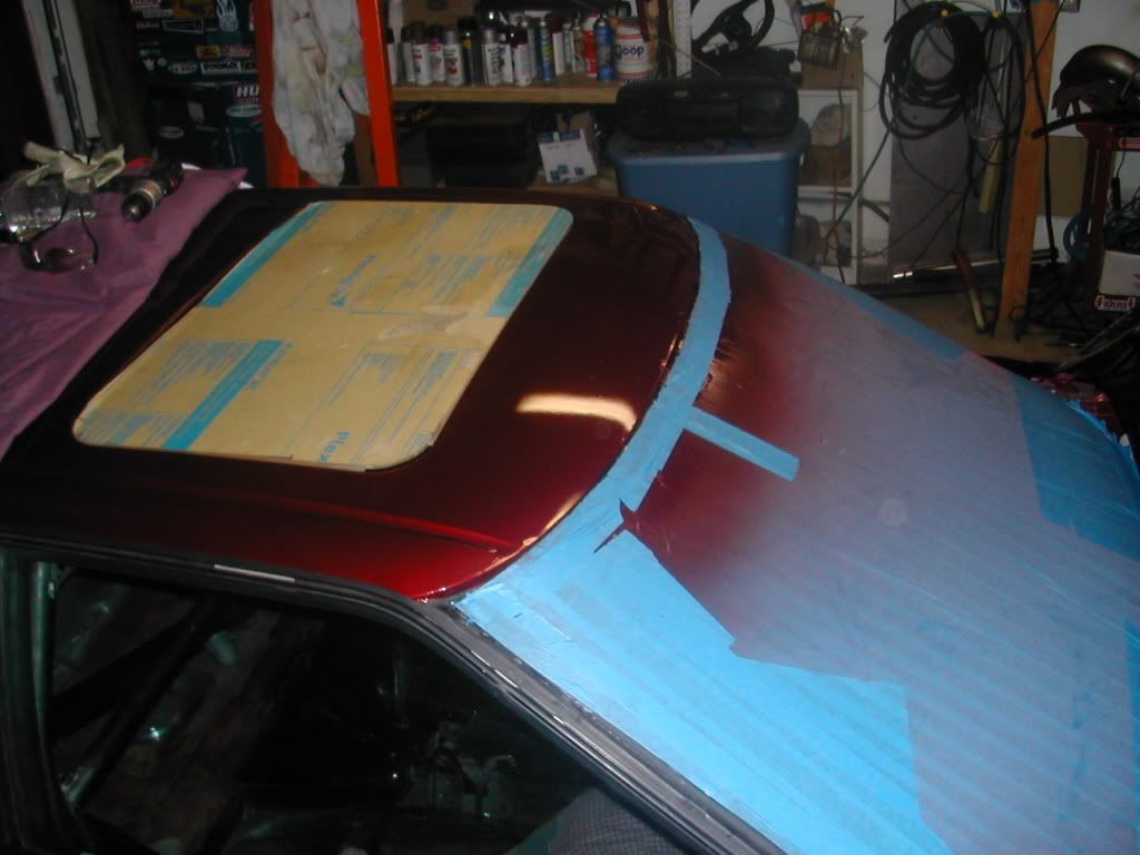

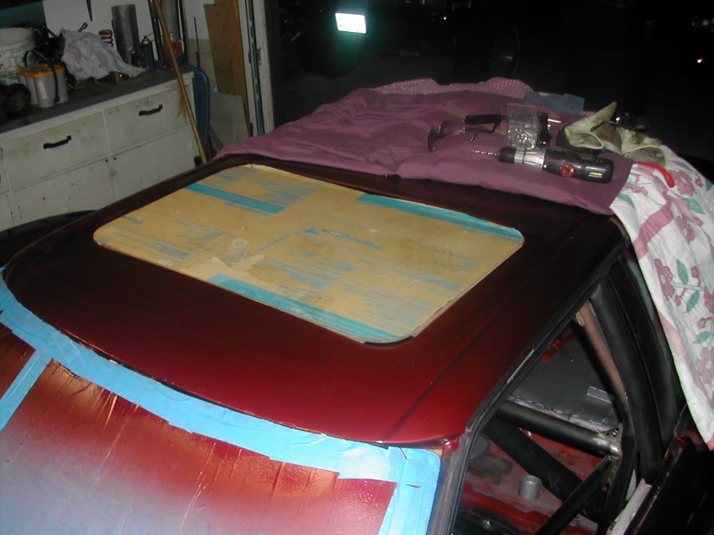

made sunroof panel today, and 3/4 framed it in. i need one more piece of aluminum angle, and then i need to pre-camber the rear arch so it sits flush. the front was easy. the back has no real lip to attach to so i need to span the sides....
not a problem, just need material.
Lexan is 1/4" thick, more leftover stuff. gonna shoot it the body color from the inside before i final install it
i think black would be hot in the sun anyways.

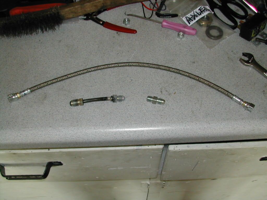

and i spent a good deal of time researching brake line fittings. i am ditching the stock hydraulic clutch line, in favor of SS braided line. i will give up that info with part numbers and line length when i figure it all out. but that should give a little firmness to the clutch pedal at least.
Oh good! I'm very interested in this, as I couldn't find -04AN adapters to go to the metric threads at the master and slave. :-)speeding-g60 wrote:...and i spent a good deal of time researching brake line fittings. i am ditching the stock hydraulic clutch line, in favor of SS braided line. i will give up that info with part numbers and line length when i figure it all out. but that should give a little firmness to the clutch pedal at least.

I just finished doing the master cyl to slave cyl hose. The fittings are 12x1mm, but very deep. I started with off the shelf adapters, but found they did not work perfect because of the depth. I made it work by bottoming out the adapter on a crush washer and will post pics in my thread later. If I was to redo it, I would take the factory line out and have new fittings brazed on like above. This is how I did my power steering and it works great.zerb wrote:right. that little guy on the right there, they make those for brake line stuffs. but all ive seen is them in 10mm thread, and i think the clutch cylinders seem to have a larger thread, which means we'd have to make somethings.

ok so i spoke with the guy on the phone, and this is what i need he said. and i will make it a DIY when i validate this to make sure it works.
here is the skinny, and the exact part numbers i ordered.
i ordered 4 fittings (2 cars) and 3 lines, to make sure i got the right ones. i measured roughly 18 inches, so i got 18, 20, 22. for $10 each i cant go wrong. he also recommends i go -3AN as it will provide faster response and more line pressure.
306-03-M12S -3 TO 12MM X 1.00 - STEEL (CONCAVE SEAT) $3.50 X 4
610418 -4 FEMALE STRAIGHT TO STRAIGHT 18 4 $9.80 X 1
610420 -4 FEMALE STRAIGHT TO STRAIGHT 20 4 $10.40 X 1
610422 -4 FEMALE STRAIGHT TO STRAIGHT 22 4 $11.30 X 1
