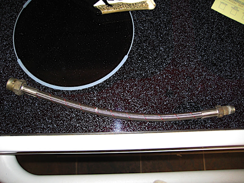

is there a pedal firmness difference?
Jretal
honestly, not that i noticed... but my old one was tired, and doing this cost less than a new OEM hose, so it was a no-brainer
that being said, I'm also only running a 7a pressure plate w/ a spec 2 clutch disc, so I dont' really have a crazy strong/stiff clutch setup that would cause as much resistance as a full on race clutch.

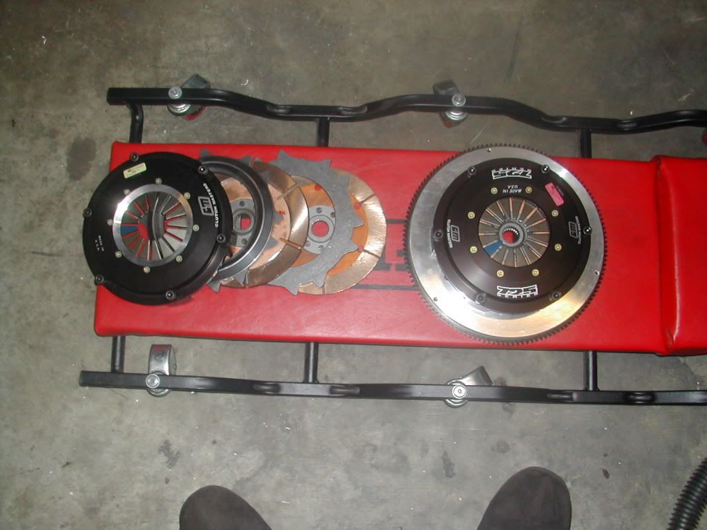

oh yeah, and the second Twin-Disc clutch arrived today. so yes, now i have two high-dollar clutch setups! looks like i truly just commited to the rabbits new drivetrain being the spare quattro setup LOL.

thought i might add, that FULL CLUTCH KIT had a ship weight of 20 pounds. that is FW, PP, both discs, both plates, and the TOB and alignment tool.
thats not very much....
Brian (friend on other sites) loves the shit out of it, i sorta talked him into it. he says he can chirp thru 5th gear with ease, it is really a grabby clutch and not at all too harsh for street driving....
