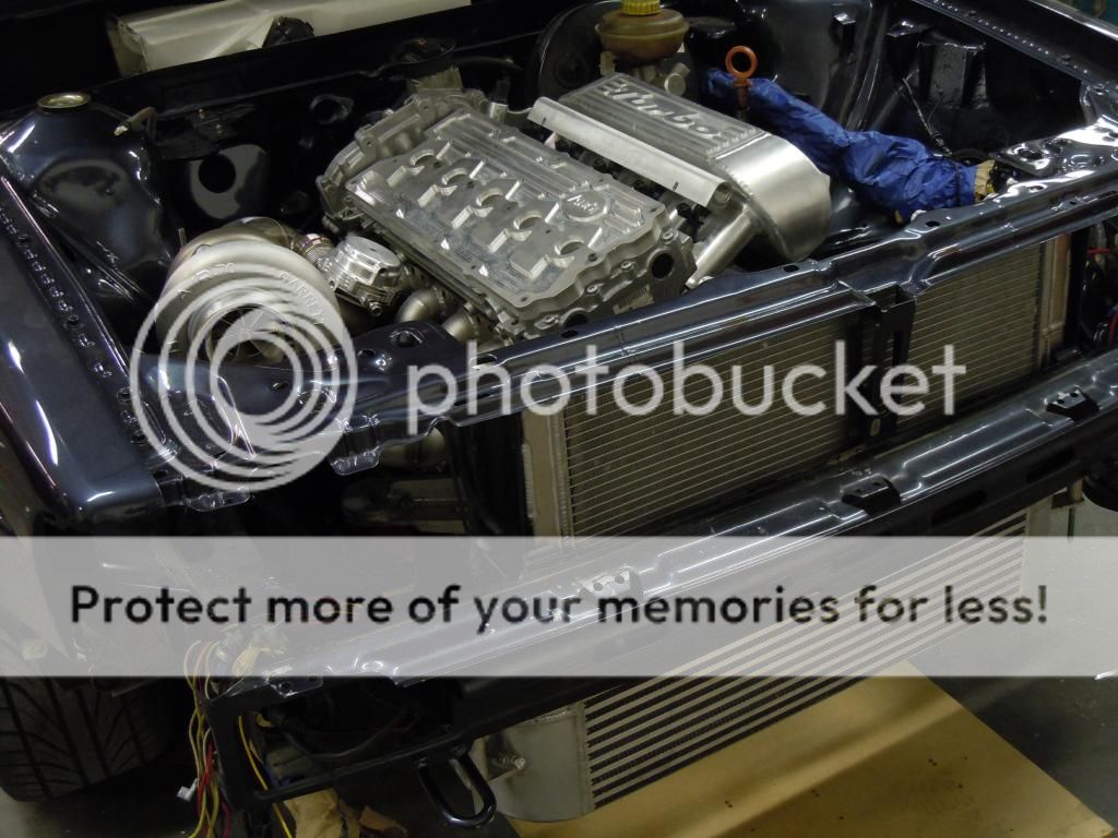

I took the BLUE Pill. Engine bay painted

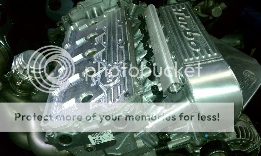

Hank wrote:What do you mean Ed?
We played aorund with the conical taper on the dual plenum, but it doesn't lend itself to a front mount radiator or vac brake setup. A side entry is a better shot, and will be a smoother transition into the main plenum while giving all cylinders a better shot at smooth air.
Yep, those are good reasons.
Re: I took the BLUE Pill. Engine bay painted

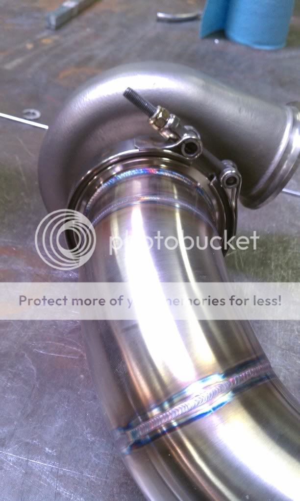

Thanks Dave.. It is really nice cutting parts out on the CNC router table, as parts come off ready to weld without any clean up. Very nice fit up and that is 90% of being a good welder.

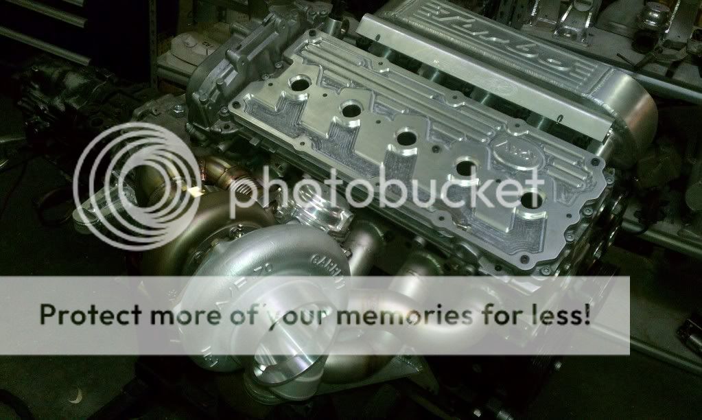

Getting closer. Injectors in, rail in, intake 95% done, header/downpipe pretty much done, real motor torn apart ready to build up with pistons/rods.. This guy is going to see BBQ!! Come one come all

That is a 4" core. Could have done 4.5" pretty easily. Core support is 100% untouched
