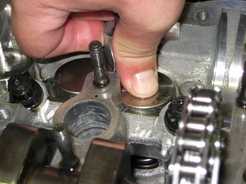

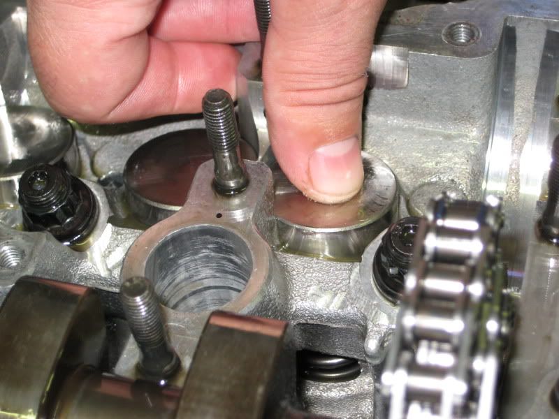

Yes Myke. It is a reasonable question. Thing is, at idle, it is not as bad as 3k... I abuse the motor a bit and get it to put out hte usual lifter symphony. I think a couple of them are just bum lifters at this point. Either that or 034 casted a spell on my motor knowing I promised myself I would put a new cam gear on it next time the head came off!

I had 2 or 3 bad out of my initial 20 (also lightweight). Replaced them and everything was fine.ShavedQuattro wrote:...I used a head with 700 miles on the rebuild including lightweight lifters. There seems to be a huge clamor of clank coming from that area. Has anybody had them be bad nearly out of the bag? I am stumped. I will probably swap them out for my old lifters to see if that solves it...

WHAT?!! Is this a common occurance with the LW vag lifters?RSCoupe wrote:I had 2 or 3 bad out of my initial 20 (also lightweight). Replaced them and everything was fine.ShavedQuattro wrote:...I used a head with 700 miles on the rebuild including lightweight lifters. There seems to be a huge clamor of clank coming from that area. Has anybody had them be bad nearly out of the bag? I am stumped. I will probably swap them out for my old lifters to see if that solves it...
Mine took forever to quite down. BTW, I hate you and your E85.ShavedQuattro wrote:Lifter tick has actually gone down quite a bit. I think there are a couple of them that are faulty. I'll probably order some and tear it down to fine the bad ones..
