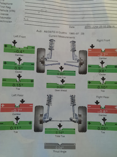

ringbearer wrote:I had my car on the same hunter rack for my alignment too. Post a pic of your printout.

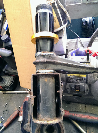

DE80q wrote:Looking good, glad to see those rings I made finally get used.
mushasho wrote:DE80q wrote:Looking good, glad to see those rings I made finally get used.
They fit like a glove... soo perfect... In retrospect I really didn't mind grind all those welds... I think anyone that can find a spare set of housings should go ahead and give it a go...
You should make a batch and list them as a member product.
