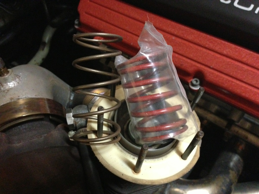

-Install 2.2 bar WG spring

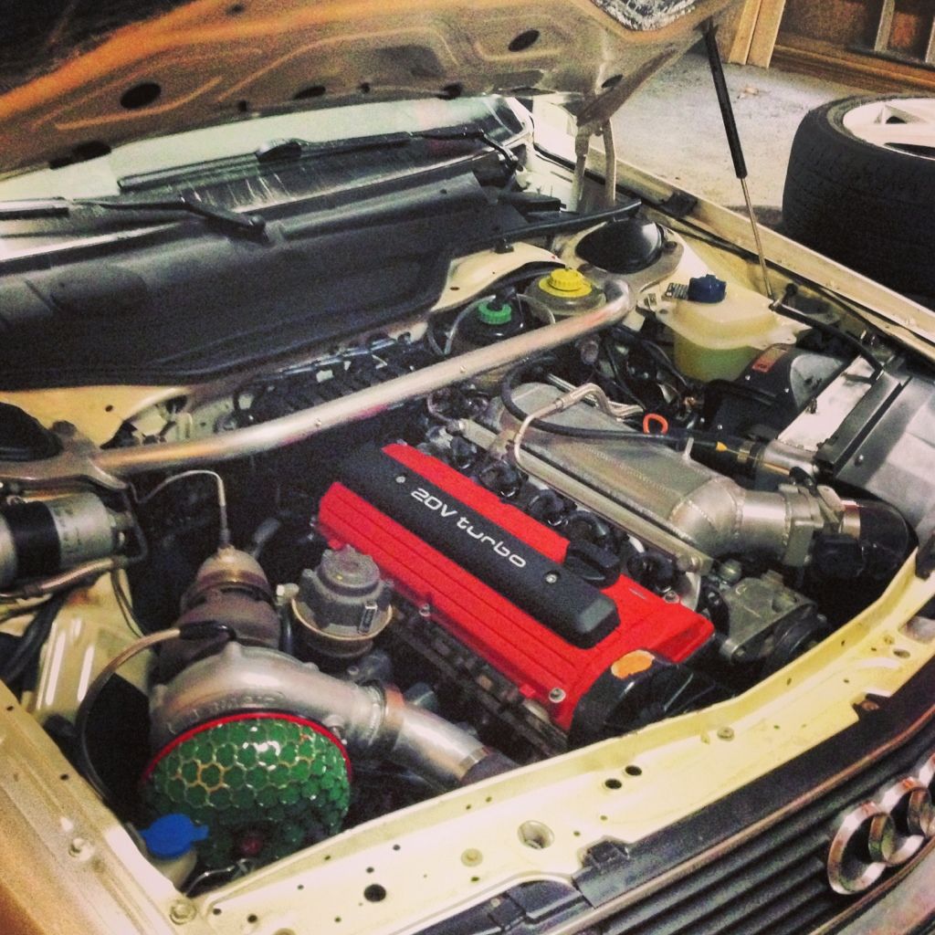

They bay looks great, Casey!

Car looks awesome Casey, that really is a gorgeous engine bay! Sent you a PM, just go grab that cluster from my place, as Nick can attest, you gotta badger me a little bit sometimes if you want something, take it fo free

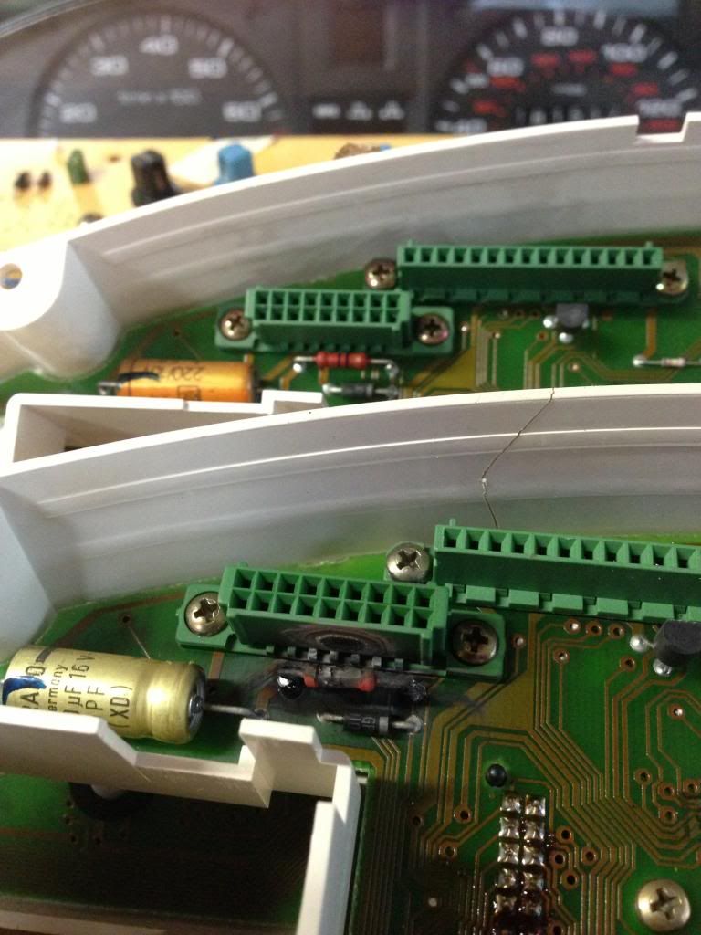

This weekend I knocked a bunch of stuff off the list. Changed out some vacuum hose, repaired the reference line to the boost gauge, fixed a coolant leak, replaced the steering rack, pulled the driveshaft (going to have it balanced, I hope that finally fixes it), rebuilt the clutch master and slave, and picked up the cluster and repaired my burned out parts! Thanks to vt10vt!

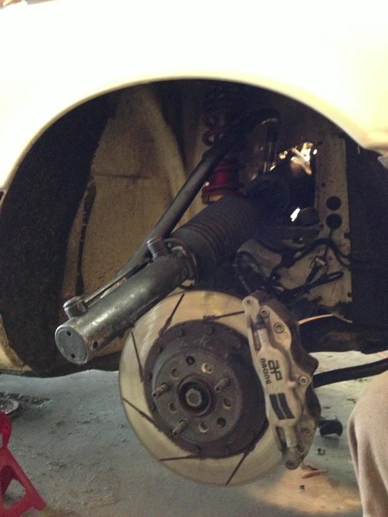

Pulling the old rack out - not as bad as I thought it was going to be.

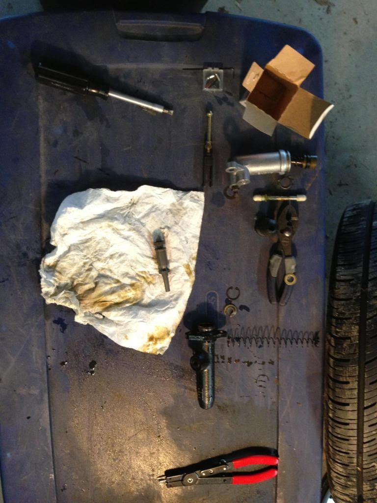

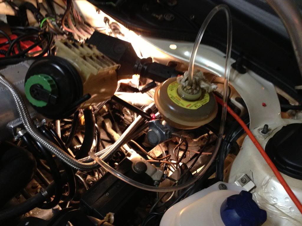

Rebuilding the clutch master and slave
Then used a self replenishing bleeding system after I had flushed it :thumbsup:

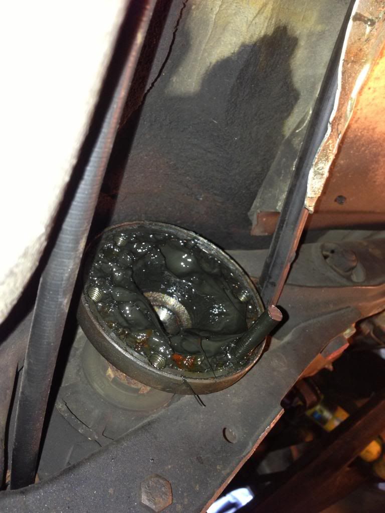

Pulled the drive shaft out and of course the 12th bolt stripped, so I made it go away with a cutoff wheel..

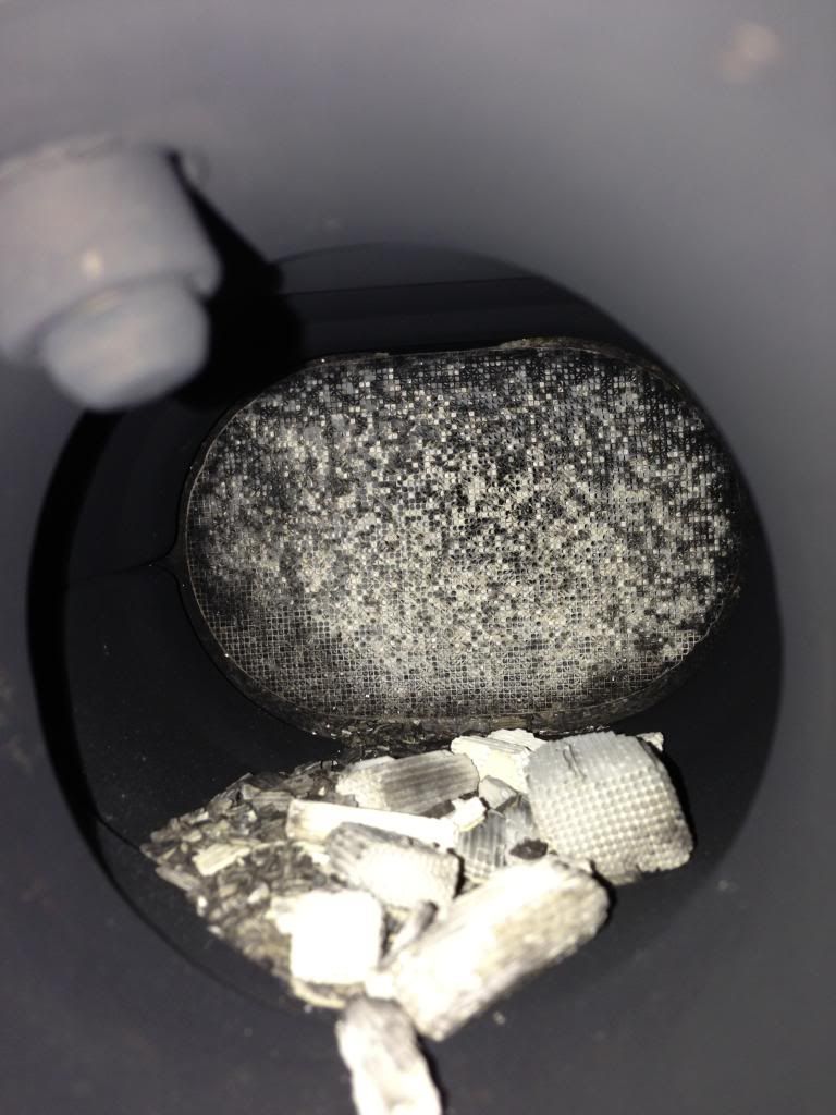

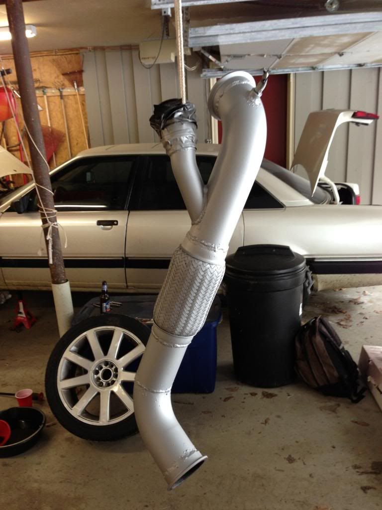

I moved the exhaust a little later and was happy to see part of the catalyst fall out... So it's now gutted (pumped to hear 3" straight back with 1 rear muffler :drive: )
And decided to hit the down pipe with a fresh coat of paint
Repaired the cluster - burned pieces in the foreground

Can't get the driveshaft balanced locally because they don't have the ability to set it on a jig with CV's on either end of it. Guess I have to do it the fun way and keep clocking the driveshaft until the vibration goes away.. I'm going to be really good at installing and removing the driveshaft and exhaust.
Re: Casey's 200 20v: Carlisle and dyno prep
LOL you made the same mistake I did on my 530i. I forgot to mark it once and now there is a vibration and nowhere will balance it for me. I thought about doing it the hard way like you said, but then I thought I'd rather just deal with the slight vibration. Not such a big deal in a 350k mile car compared to a nicely refreshed 200 like yours. It is splined right? Won't it take a LOT of tries to get it right? lol
What's even worse is that I bought the car that way so it has always rattled me haha
It is splined and if I remember correctly its a pretty coarse spline so I won't have to try too many times I hope
