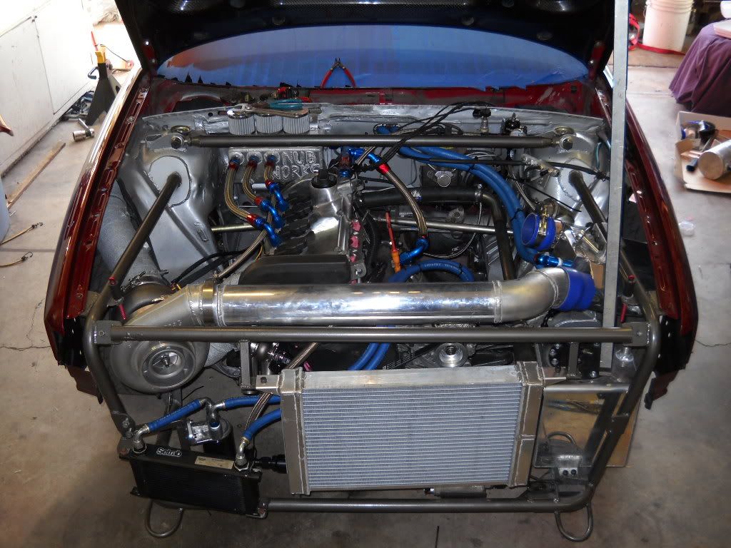

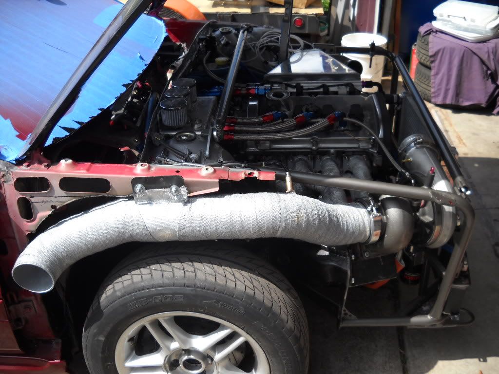

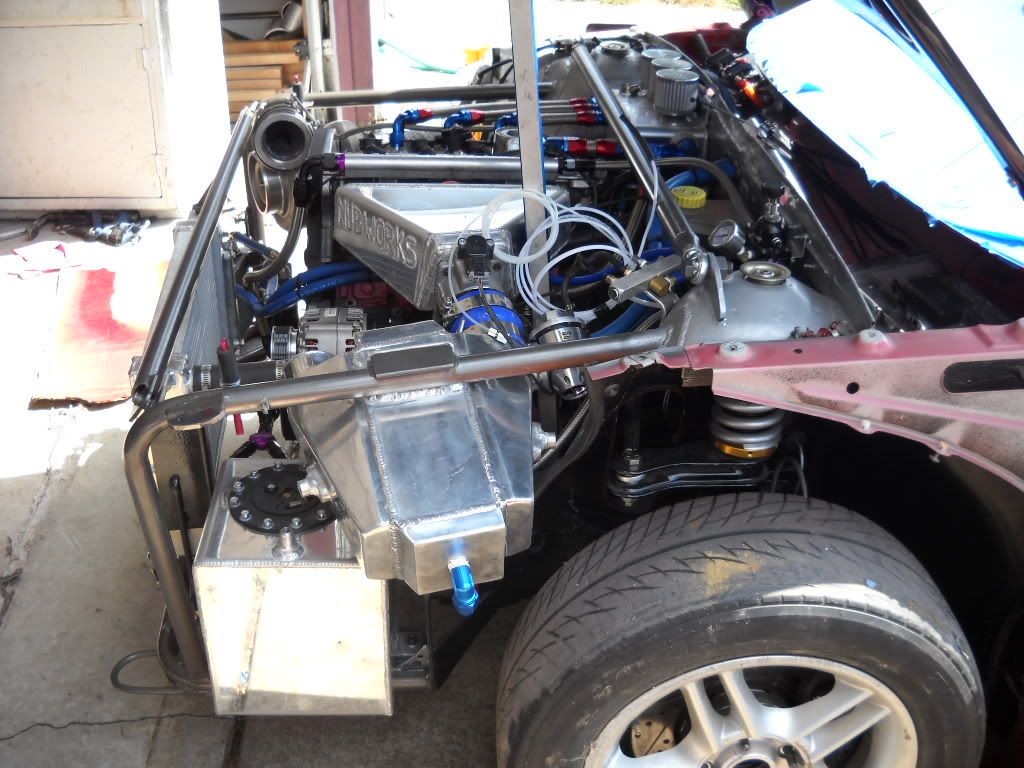

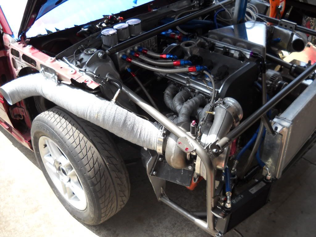

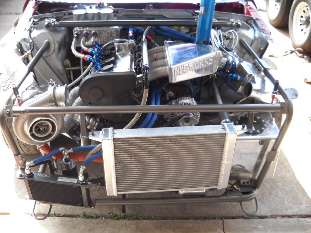

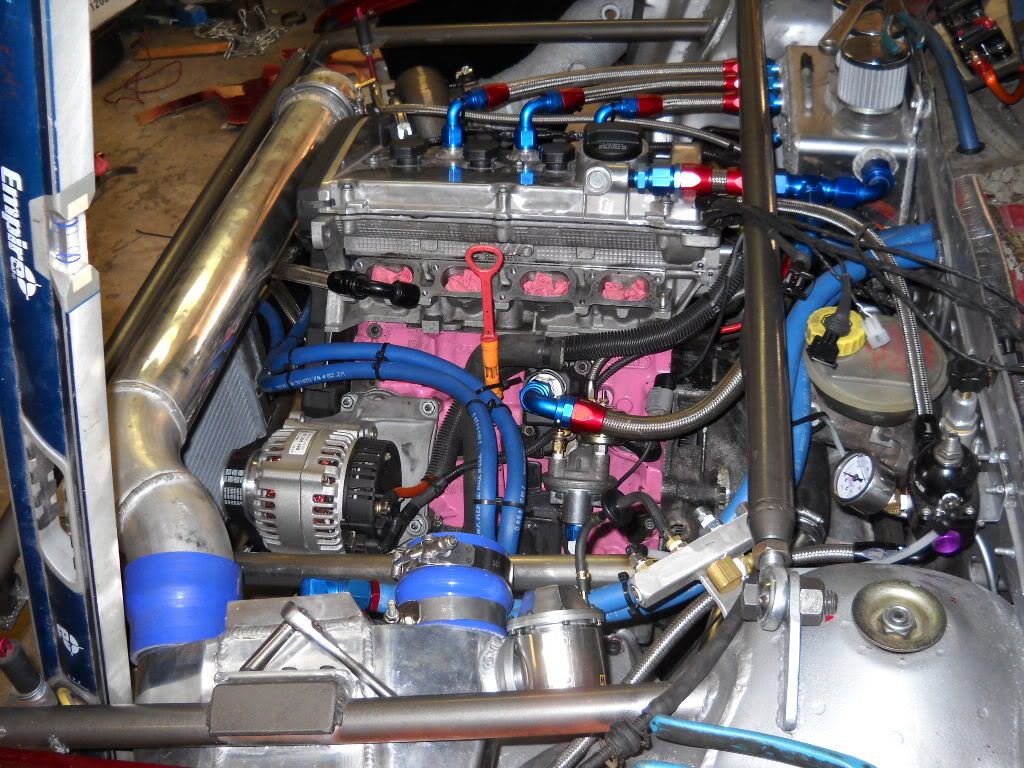

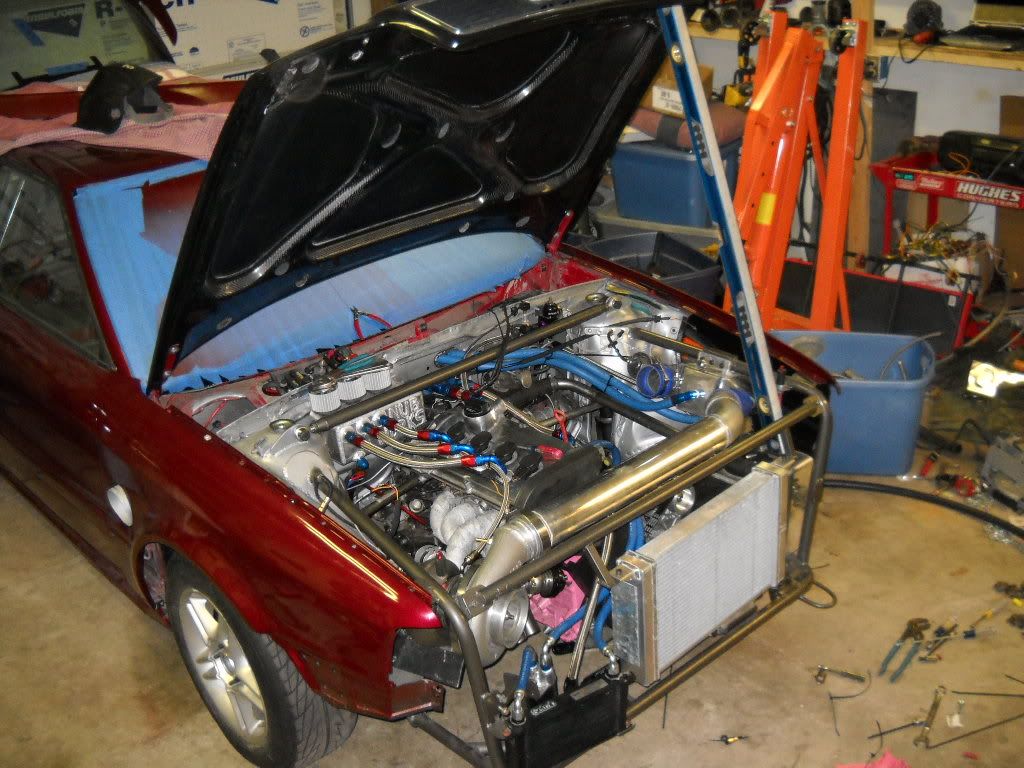

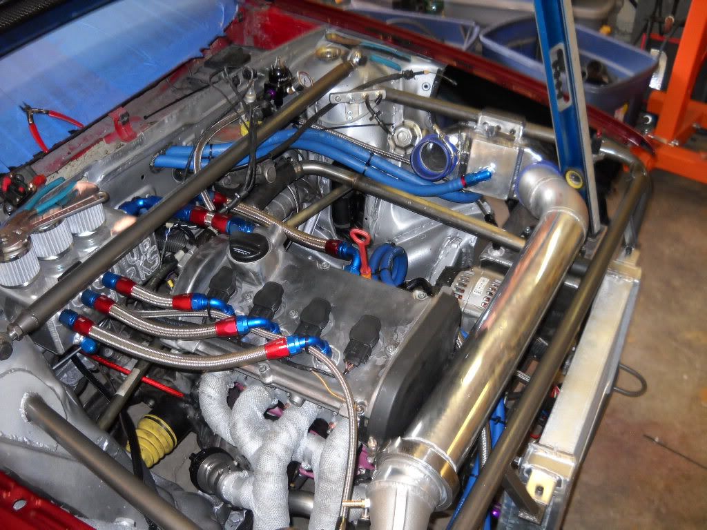

speeding-g60 wrote:NEEDED FOR RACE DAY
driver side door bar needs made. DONE
fill trans. drain and fill rear diff. anytime
install sunroof panel after rear brace installed. DONE
final mount seat and seat back brace. DONE
install harness. DONE
cooling lines need finished. WORKING
run and terminate the sender units for engine monitoring stuff. DONE
finish plumbing oil cooler lines. DONE
figure out plumbing on the dual WG's. ADHD think while working LOL
gotta mount the radiator overflow can, and plumb it in. working
gotta take it to get aligned once i am done dicking with the suspension this week after it is running. and a weigh in will commence that same time WOOHOO!!!!
Needed, but not necessarily for the big first day![]()
figure out brake lights maybe. thats low priority though.
wire in the driver window switch.
still have yet to think about limiting the front end.
remake the WG dump tubes with SS flex tube for that.
need to finish welding closed all the unused holes on the firewall.
