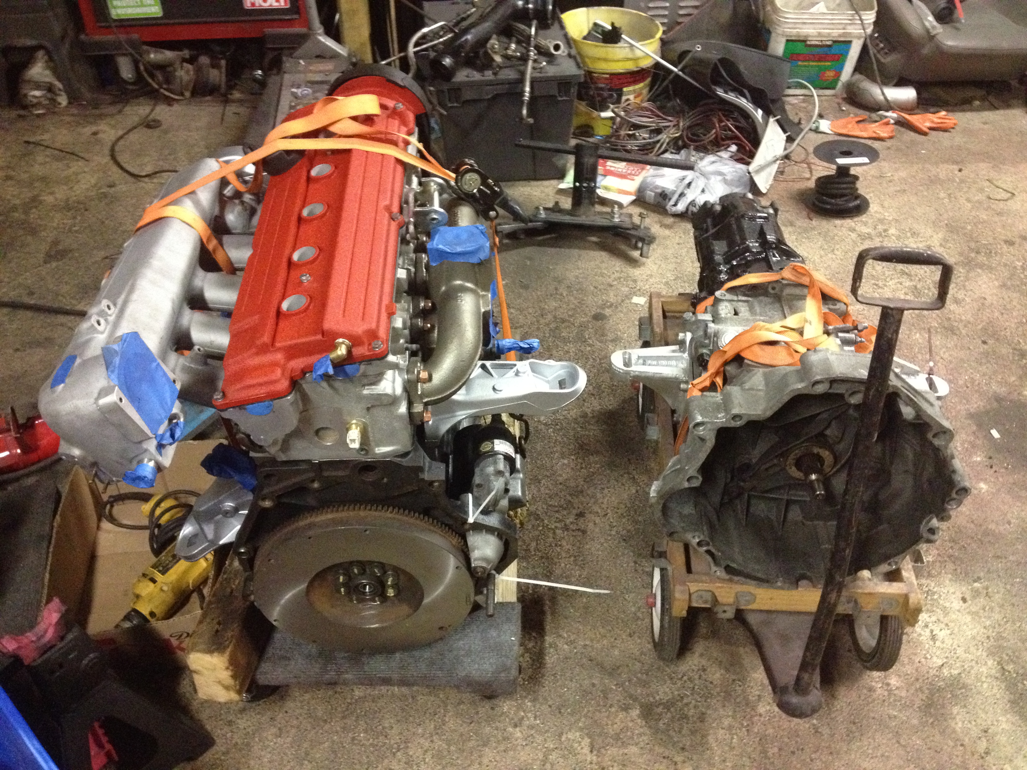

- 3b motor
- Stock pistons
- Scat rods,
- Coated bearings
- Brass distributor gear upgrade
- Phenolic spacer
- GT 3071r turbo anti-surge inlet, 3" V-Band outlet
- Fully rebuild head
- Individual coils conversion
- Replaced all coolant hoses
- Fully rebuild head with new valves (Intake / exhaust), new guides, lifters
- ARP Studs
- No AC
- all gaskets, seals replaced
- hardened timing belt cog gear
- timing belt kit , tensioner, water pump

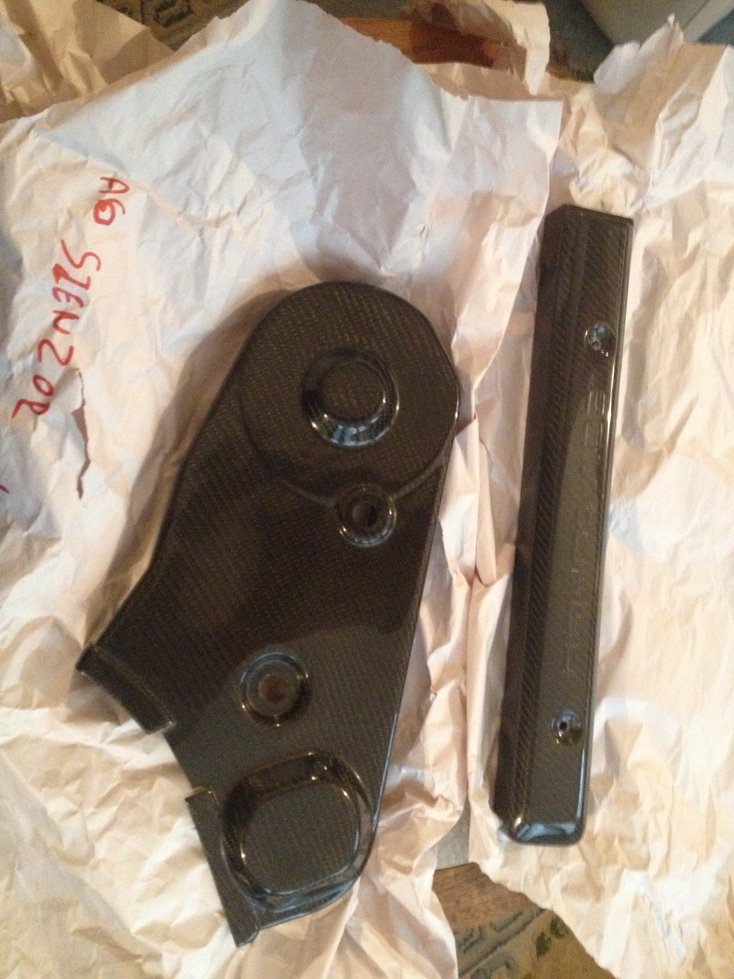

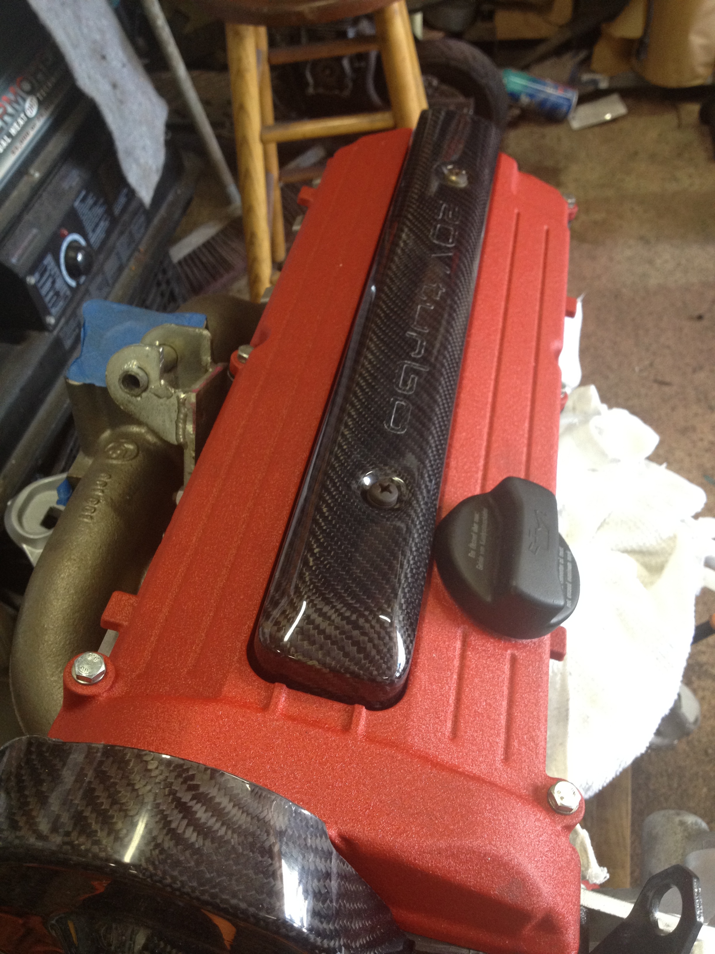

- some carbon fiber dressing along with red wrinkle powder coated valve cover, thermostat housing and water manifold.

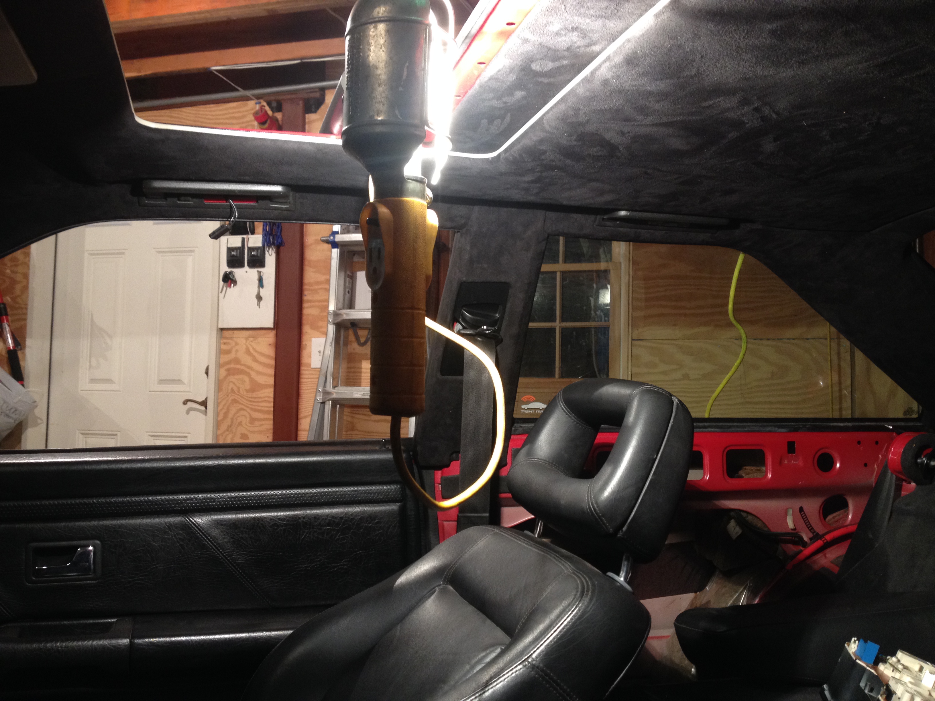

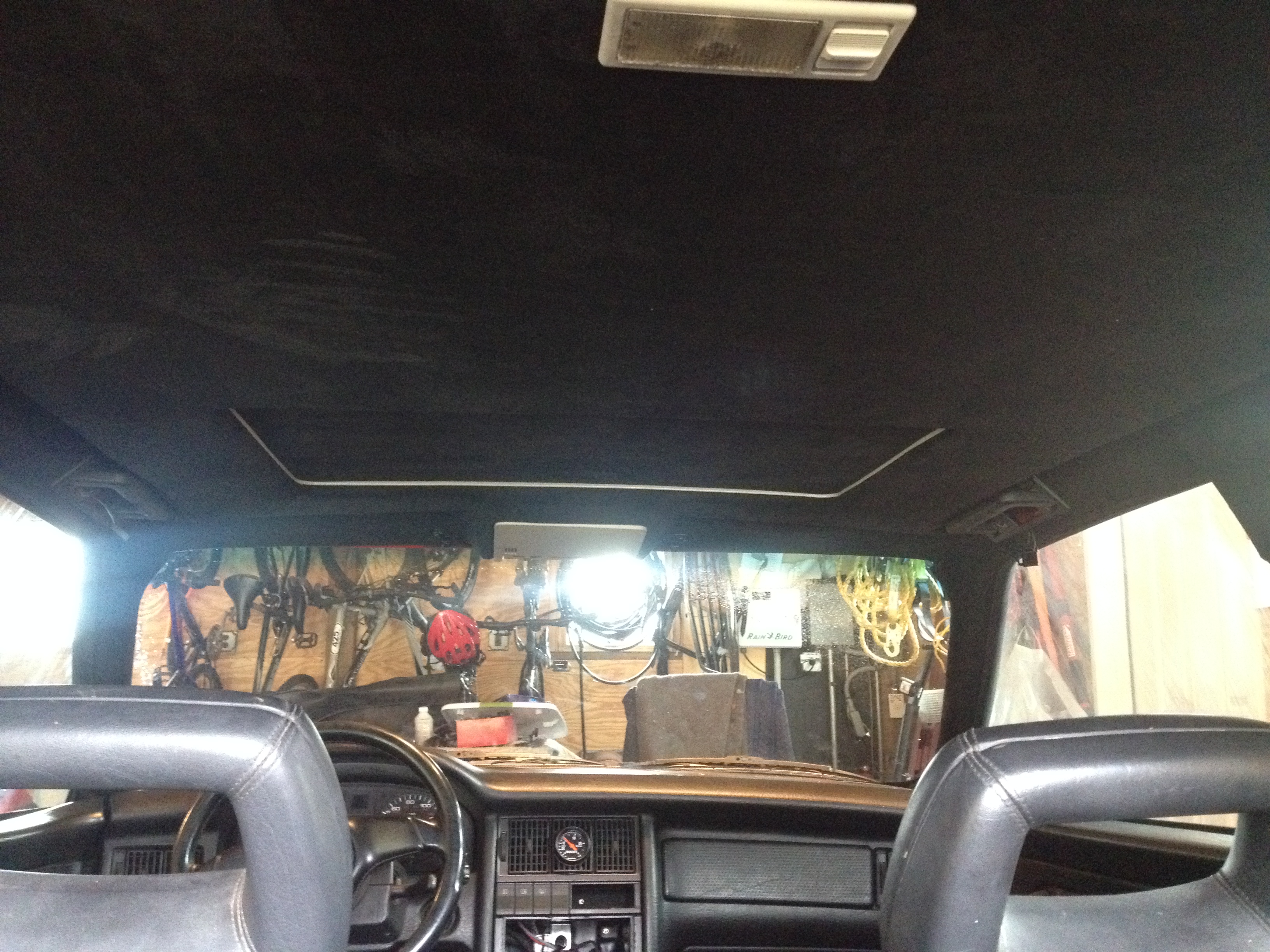

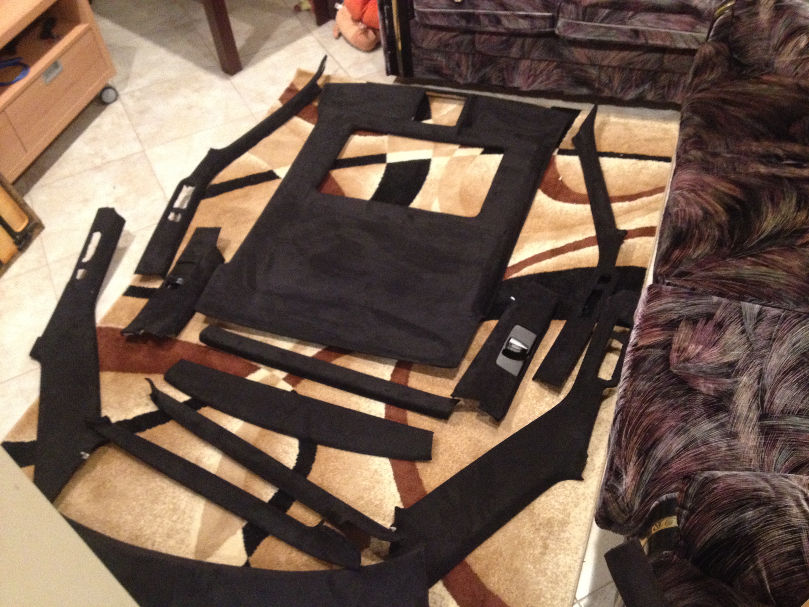

- All upper trim A B C pilars and head liner in black suede
- s2 black leather trim

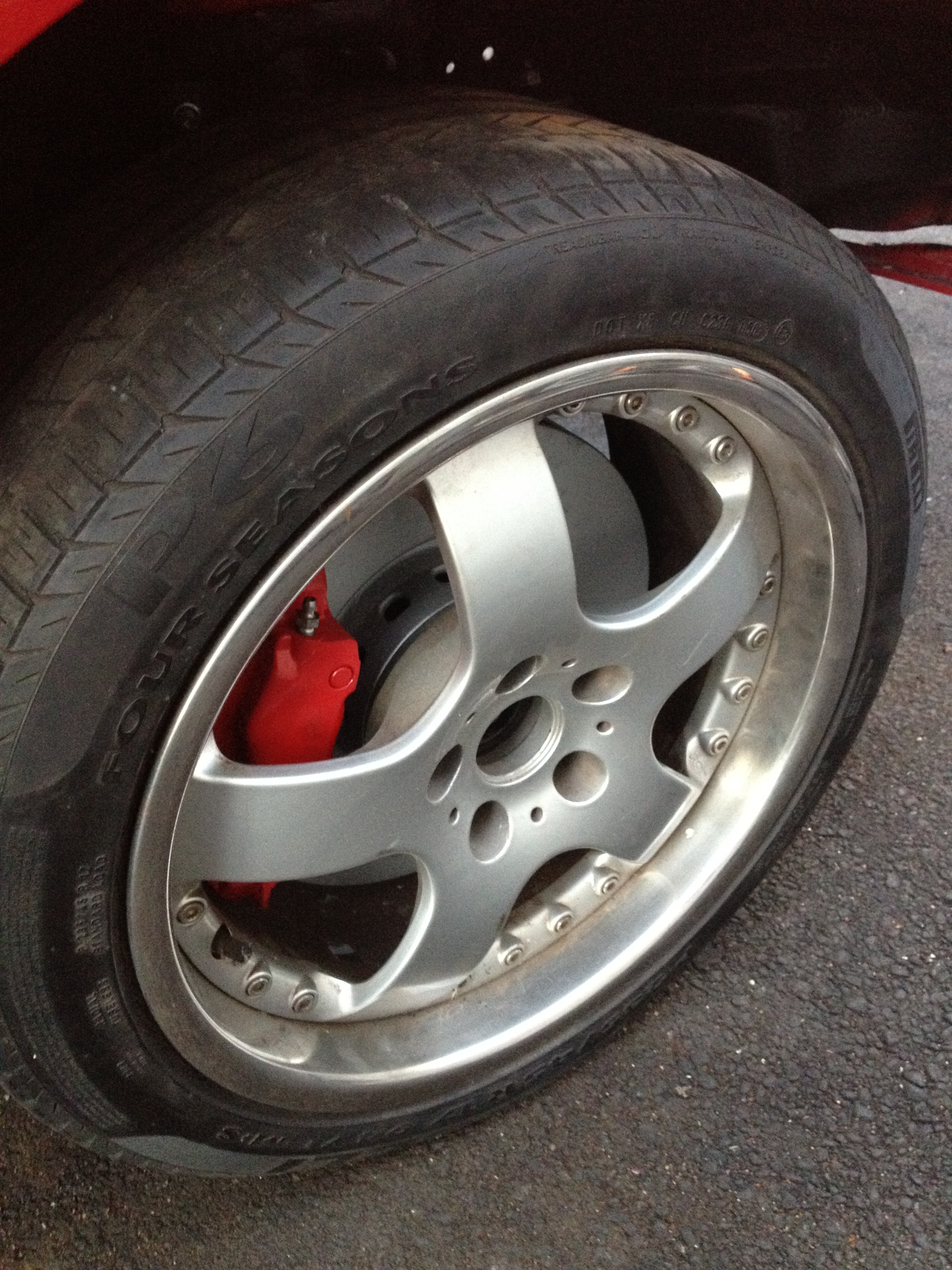

Front
- Porsche Boxter S calipers 4 piston
- Audi a8 323mm x 30 rotors
- Custom brackets
- ss braided lines
Rear
- Porsche Boxter S rear Calipers 4 piston
- Audi s4 b7 rotors 300mm x 22
- Custom brackets
- ss braided lines
- Hydraulic e-brake conversion - modified stock handle to accommodate the hydraulic cylinder under stock center console

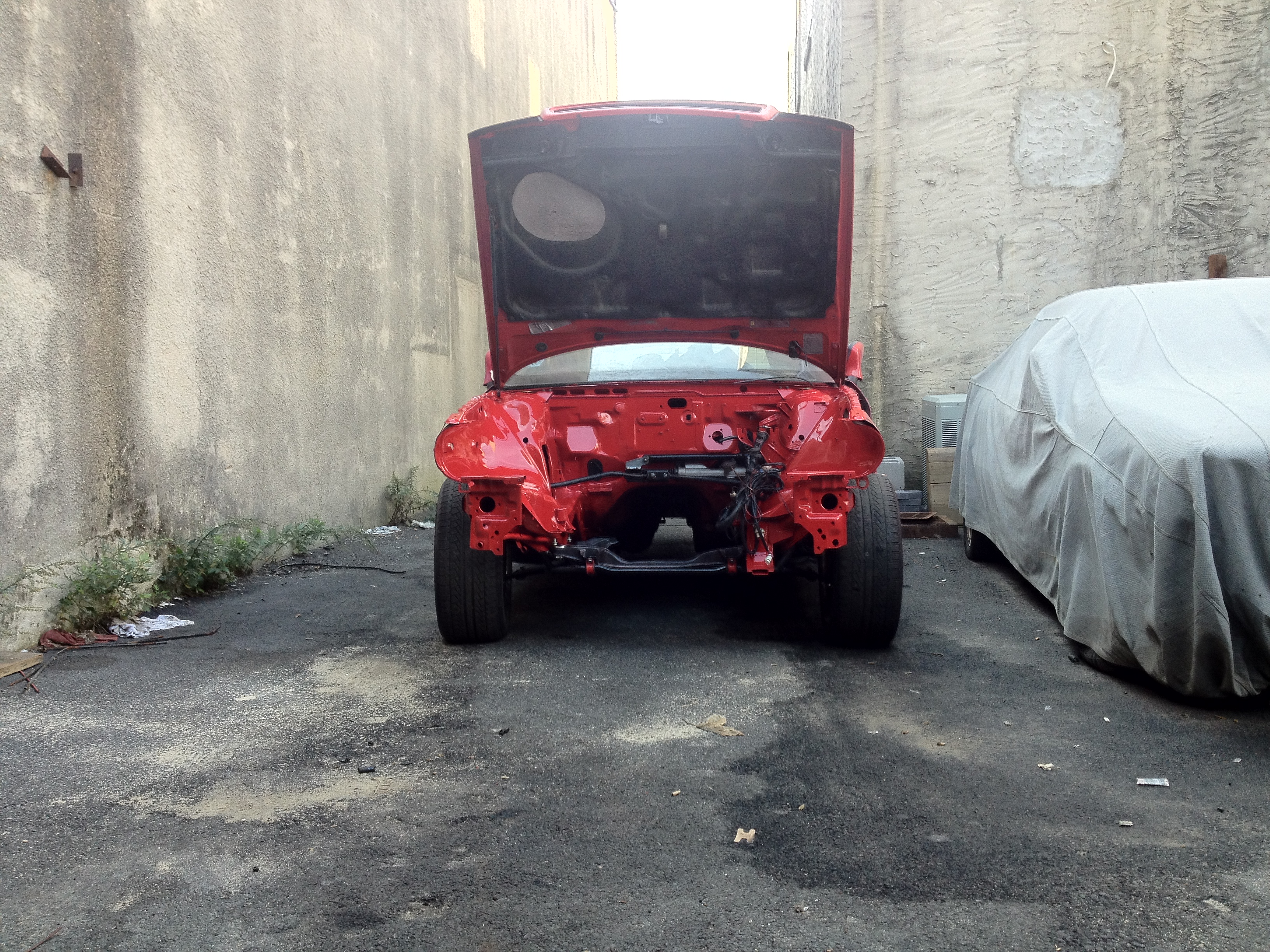

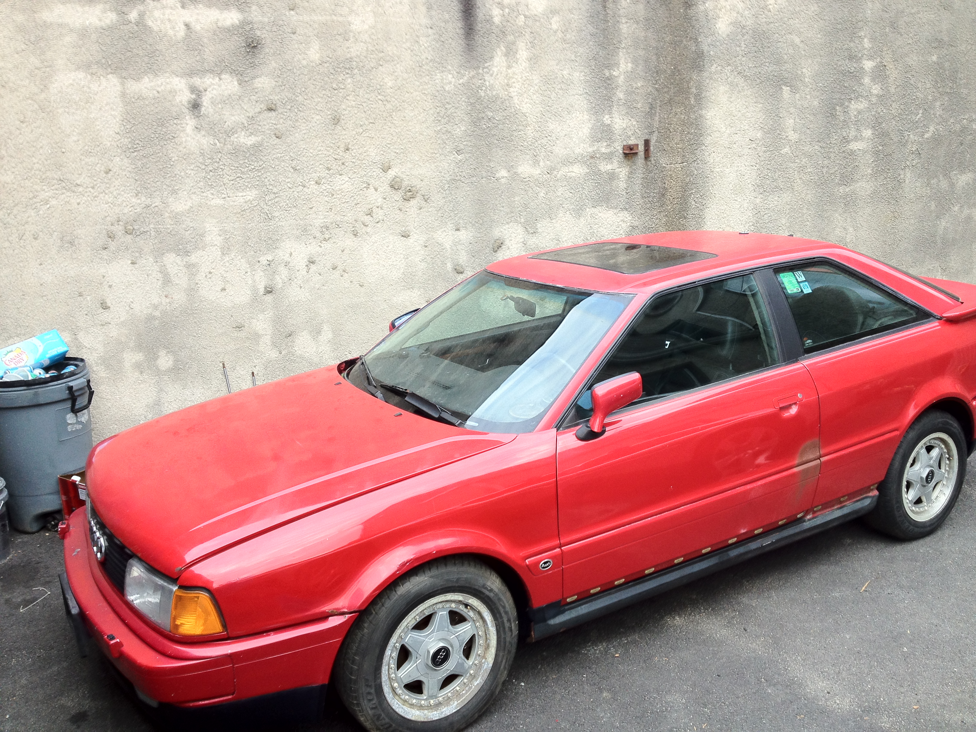

Sebastian's CQ91' winter .jpg (2.99 MiB) Viewed 42234 times
Sebastian's CQ91' road trip 4.JPG (2.54 MiB) Viewed 42234 times

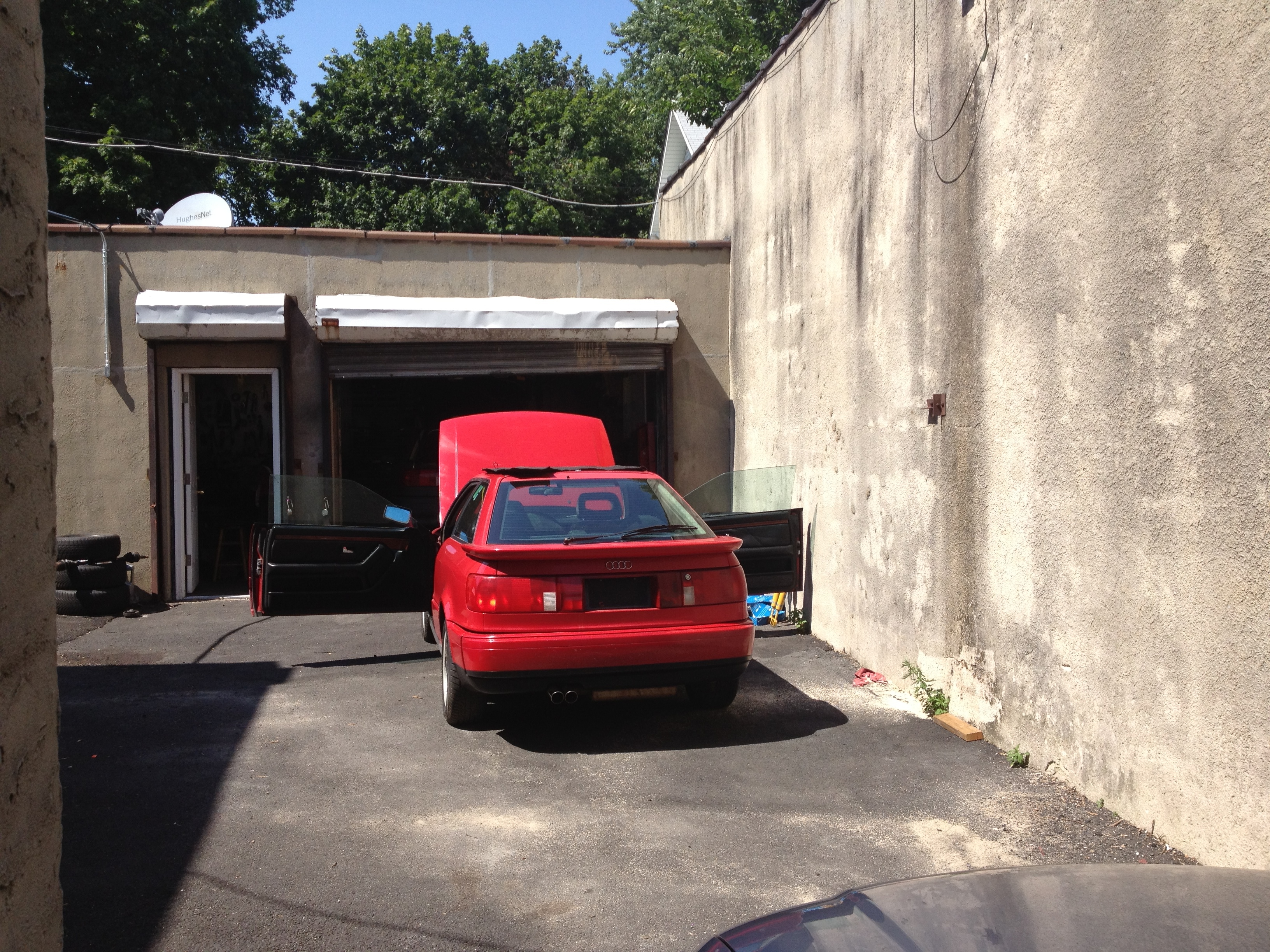

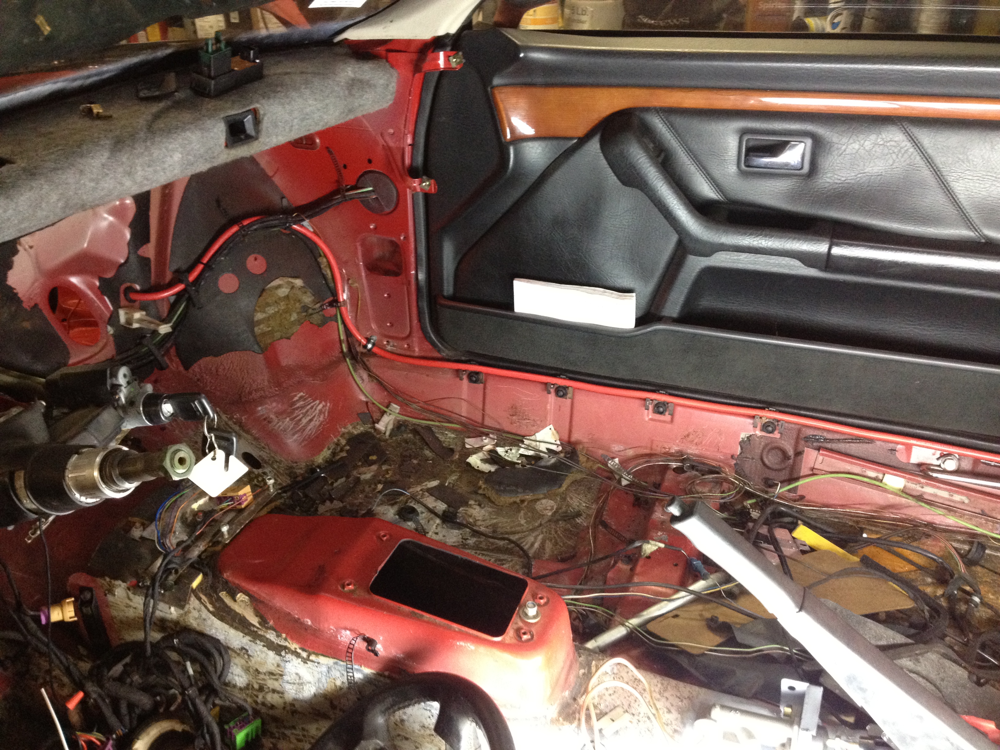

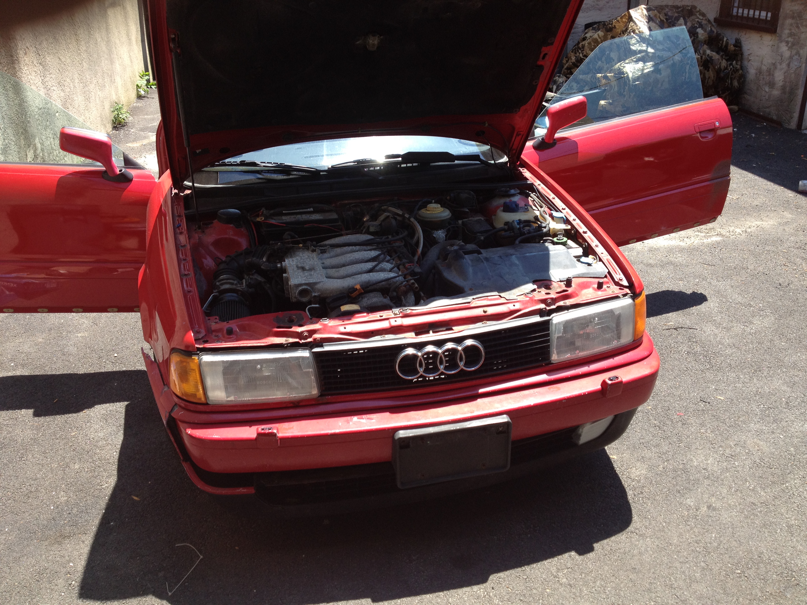

Sebastian's CQ91' initial inspection .JPG (2.97 MiB) Viewed 42234 times
Sebastian's CQ91' project 1.JPG (3.58 MiB) Viewed 42234 times

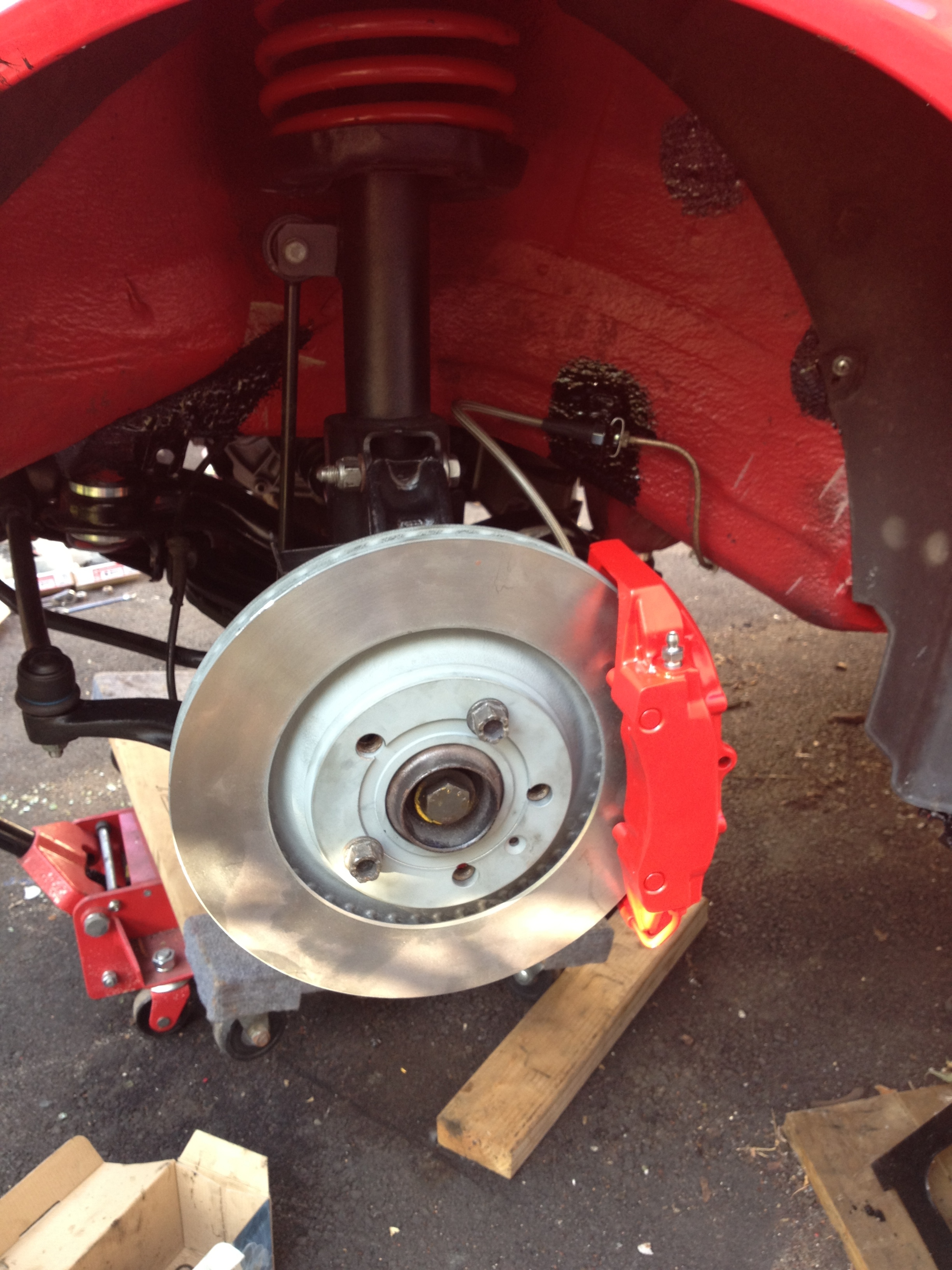

Sebastian's CQ91' initial inspection 3.jpg (3.97 MiB) Viewed 42234 times

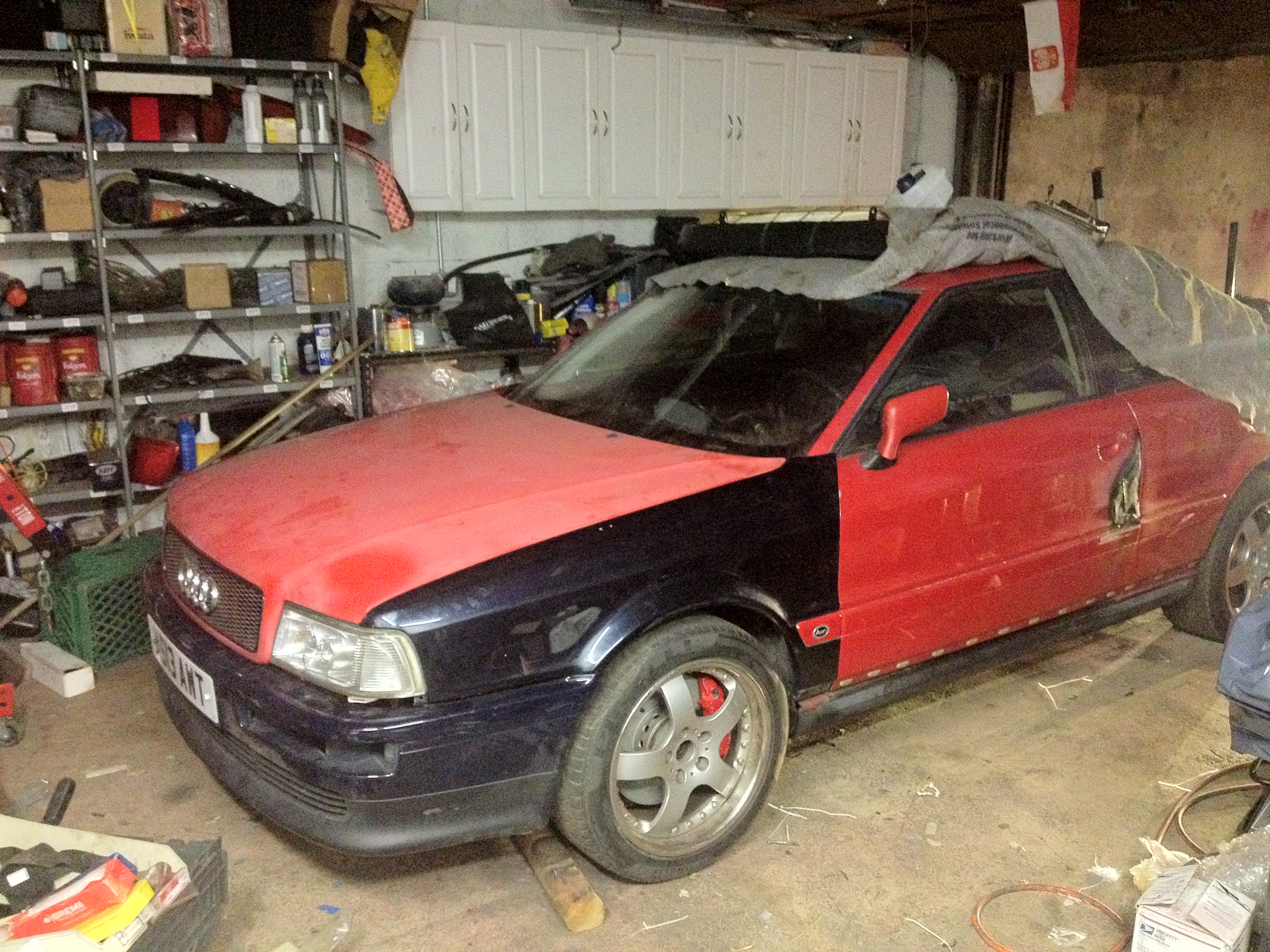

bit more of the b4 look
Sebastian's CQ91' old garrage storage 1.JPG (3.36 MiB) Viewed 42229 times
Sebastian's CQ91' body panels.jpg (2.04 MiB) Viewed 42229 times

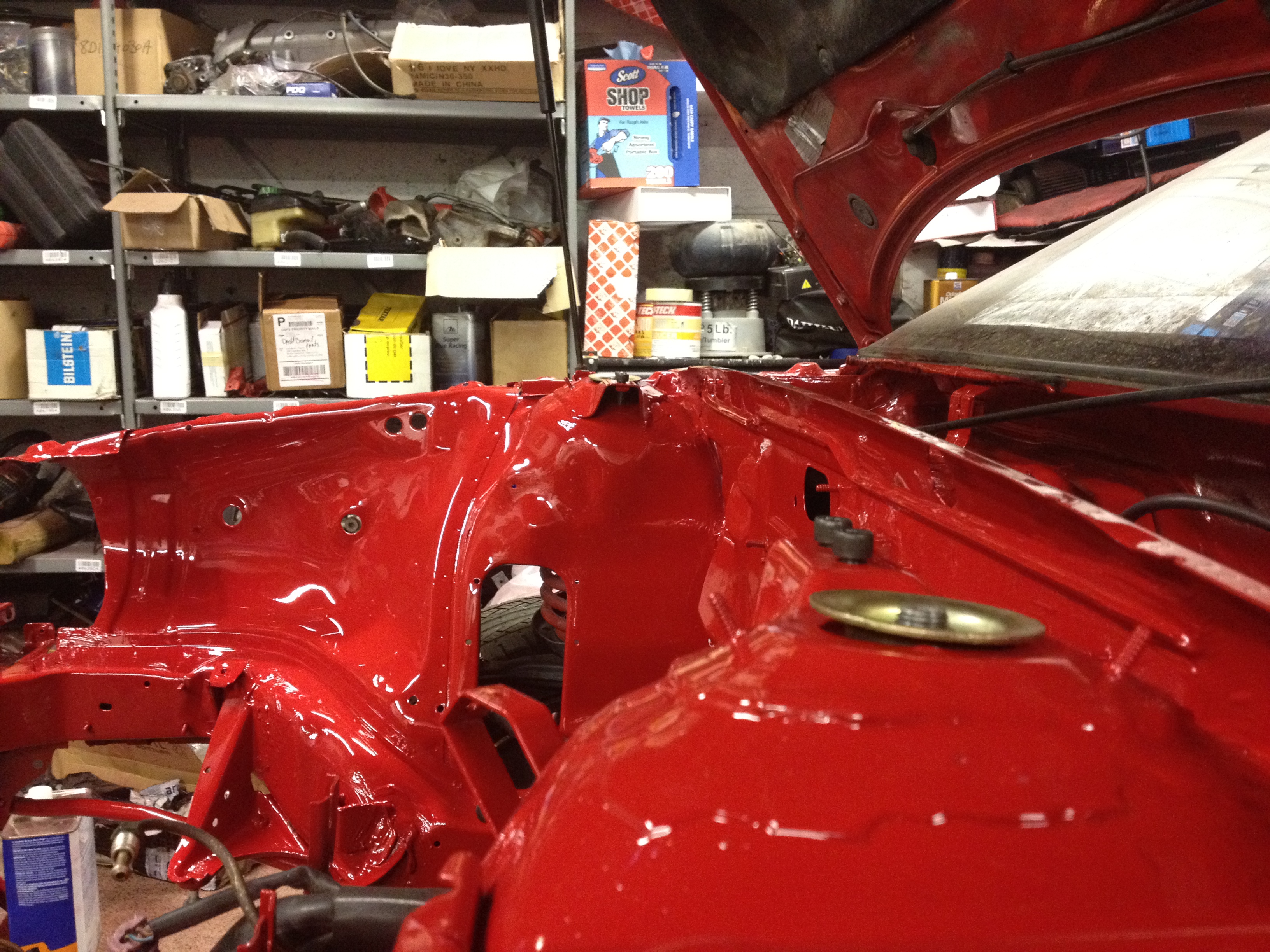

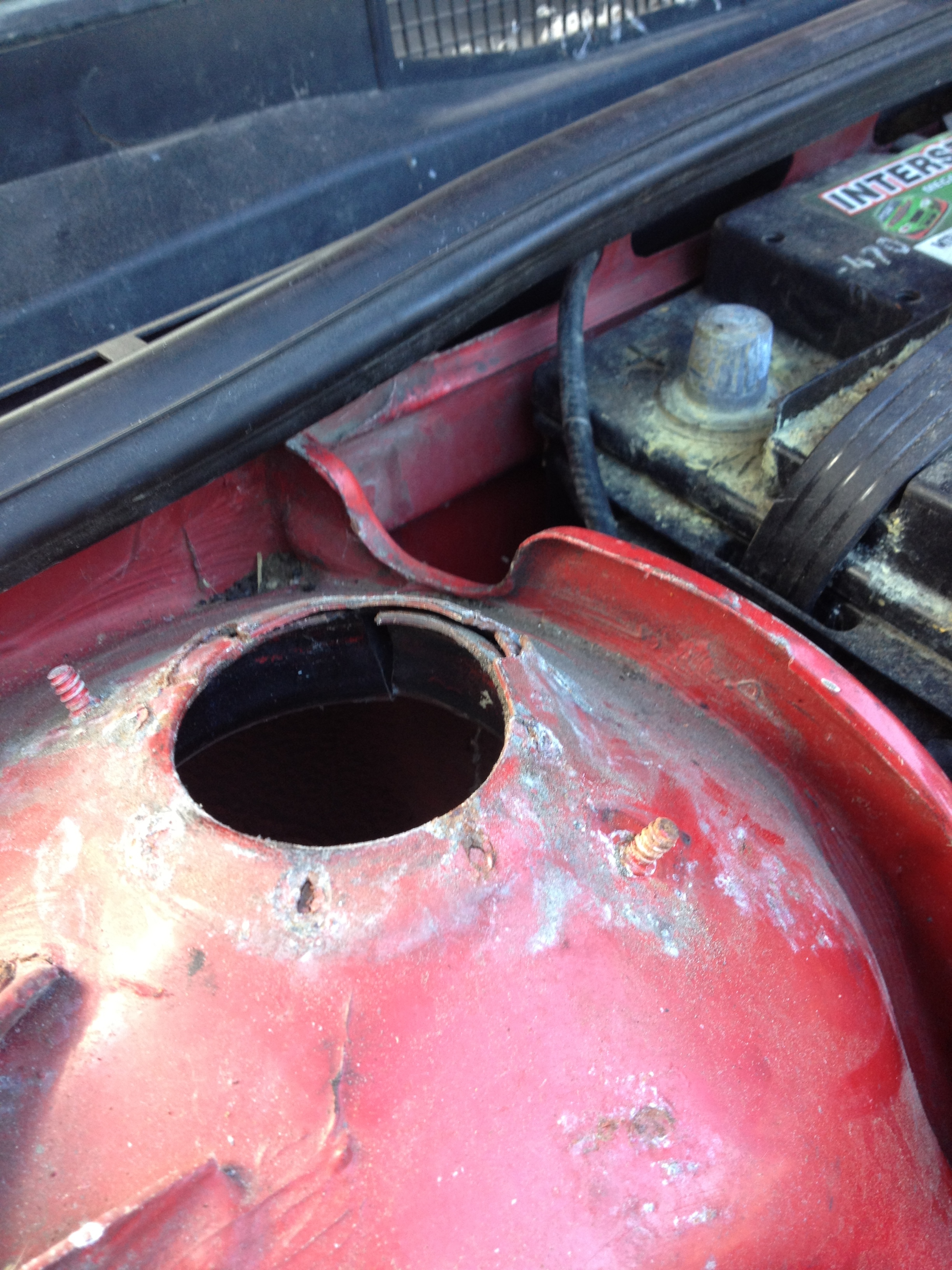

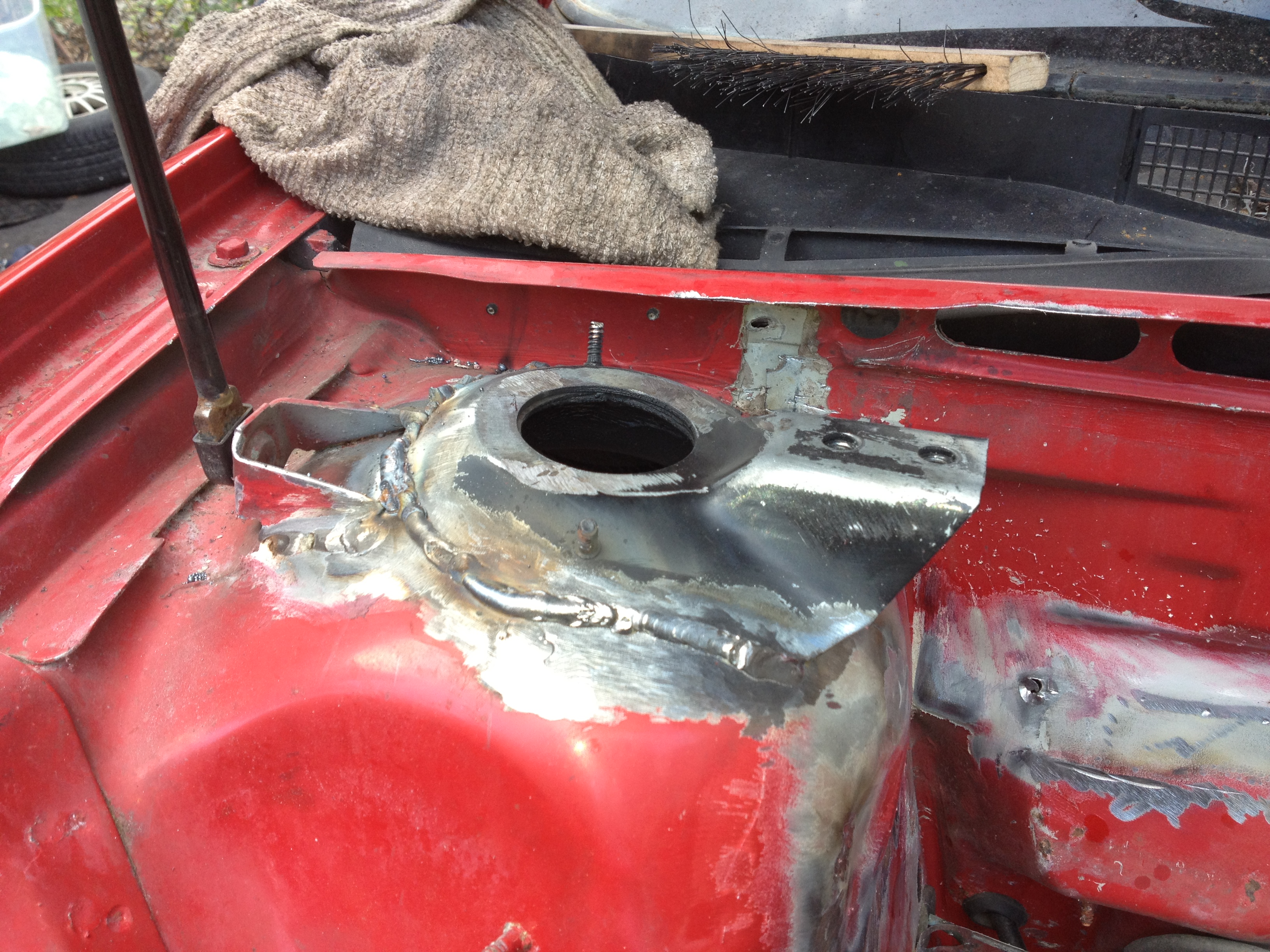

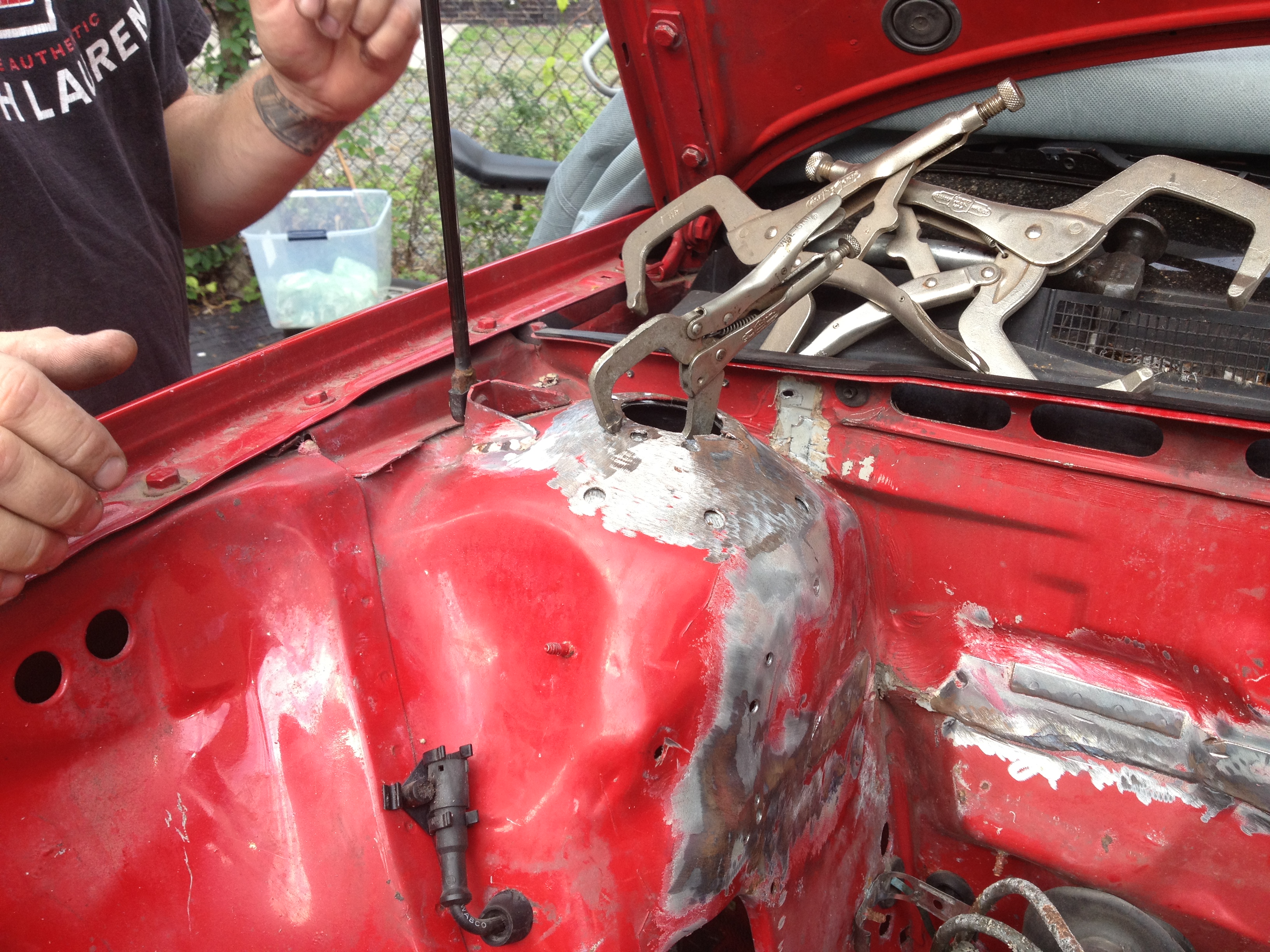

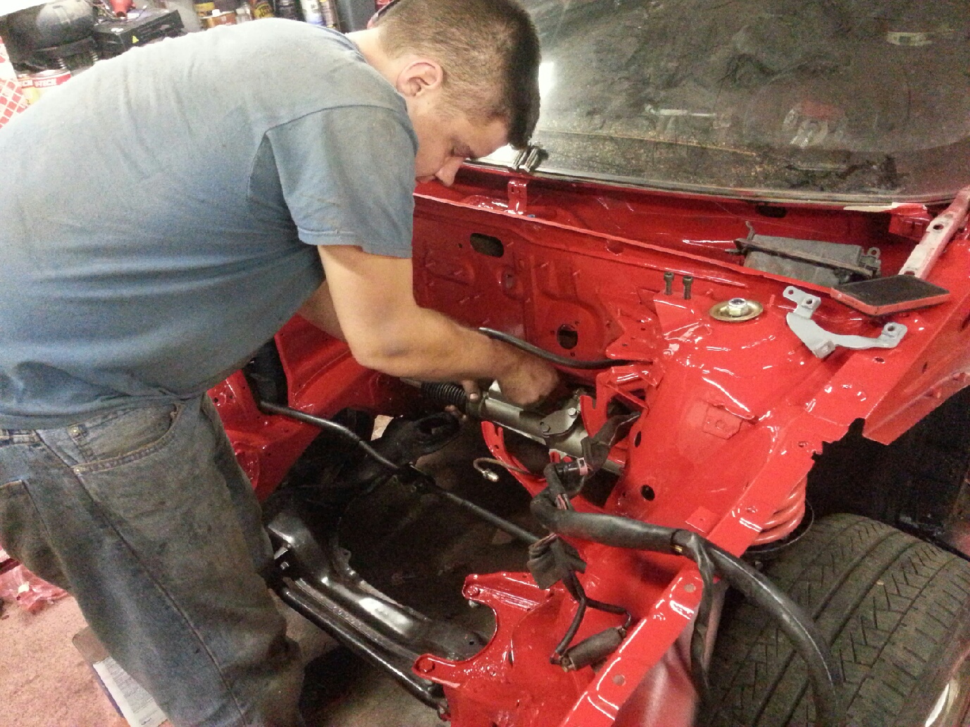

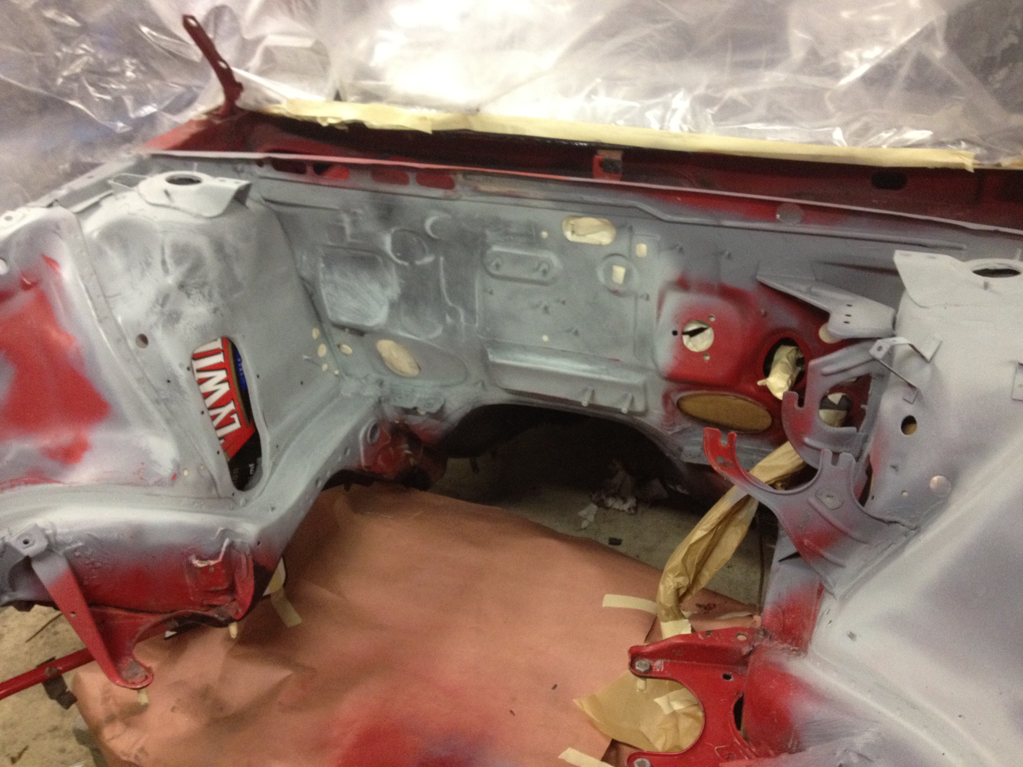

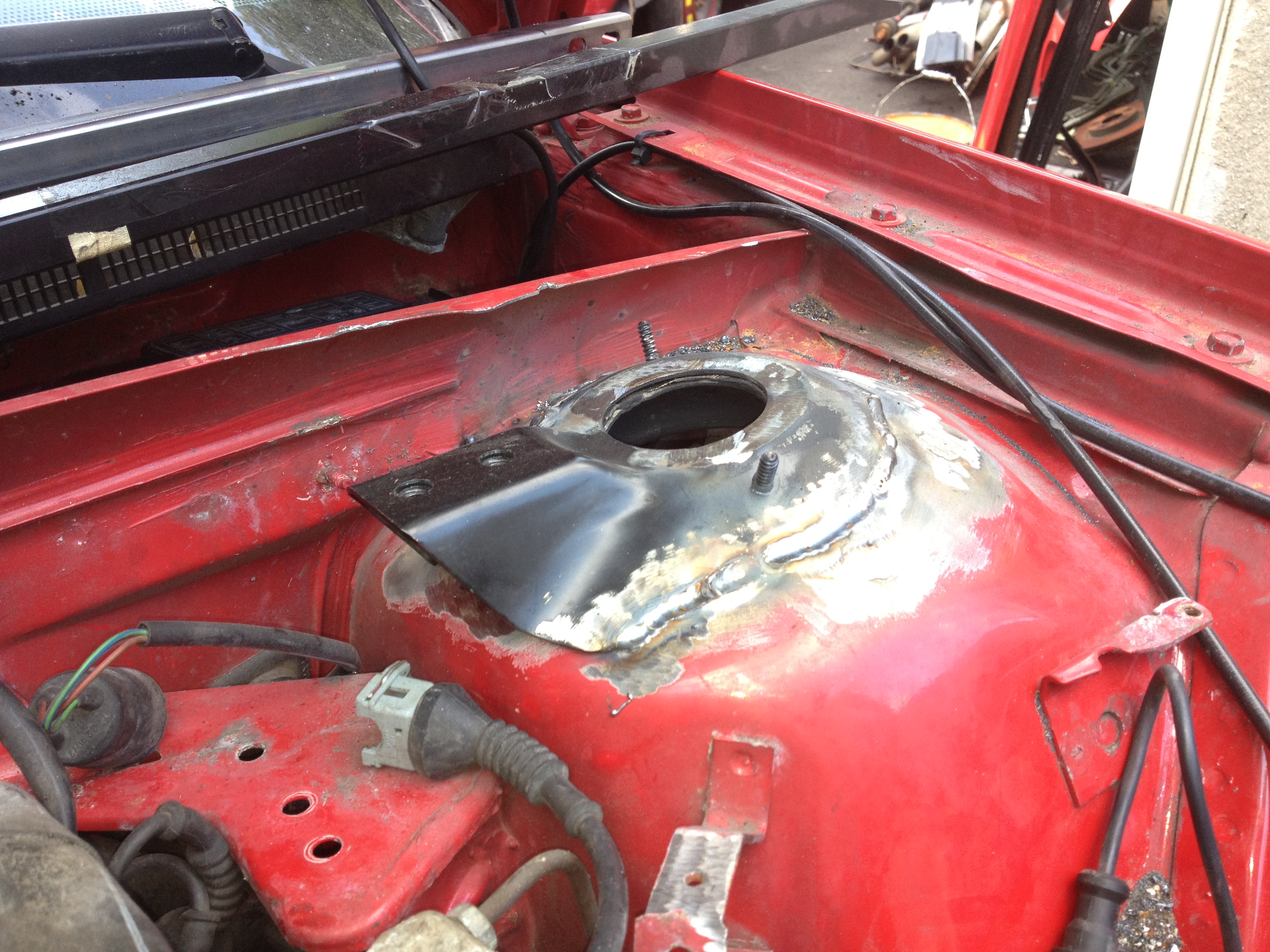

some engine bay prep work and strut tower fix and brace, battery relocation
Sebastian's CQ91' shot towers.jpg (2.57 MiB) Viewed 42228 times
Sebastian's CQ91' front tower fix 2.JPG (2.91 MiB) Viewed 42228 times
Sebastian's CQ91' front tower fix and strut bar mount.JPG (2.86 MiB) Viewed 42228 times
front tower strut brace mount.JPG (2.7 MiB) Viewed 42228 times
Sebastian's CQ91' engine paint prep.JPG (2.44 MiB) Viewed 42228 times

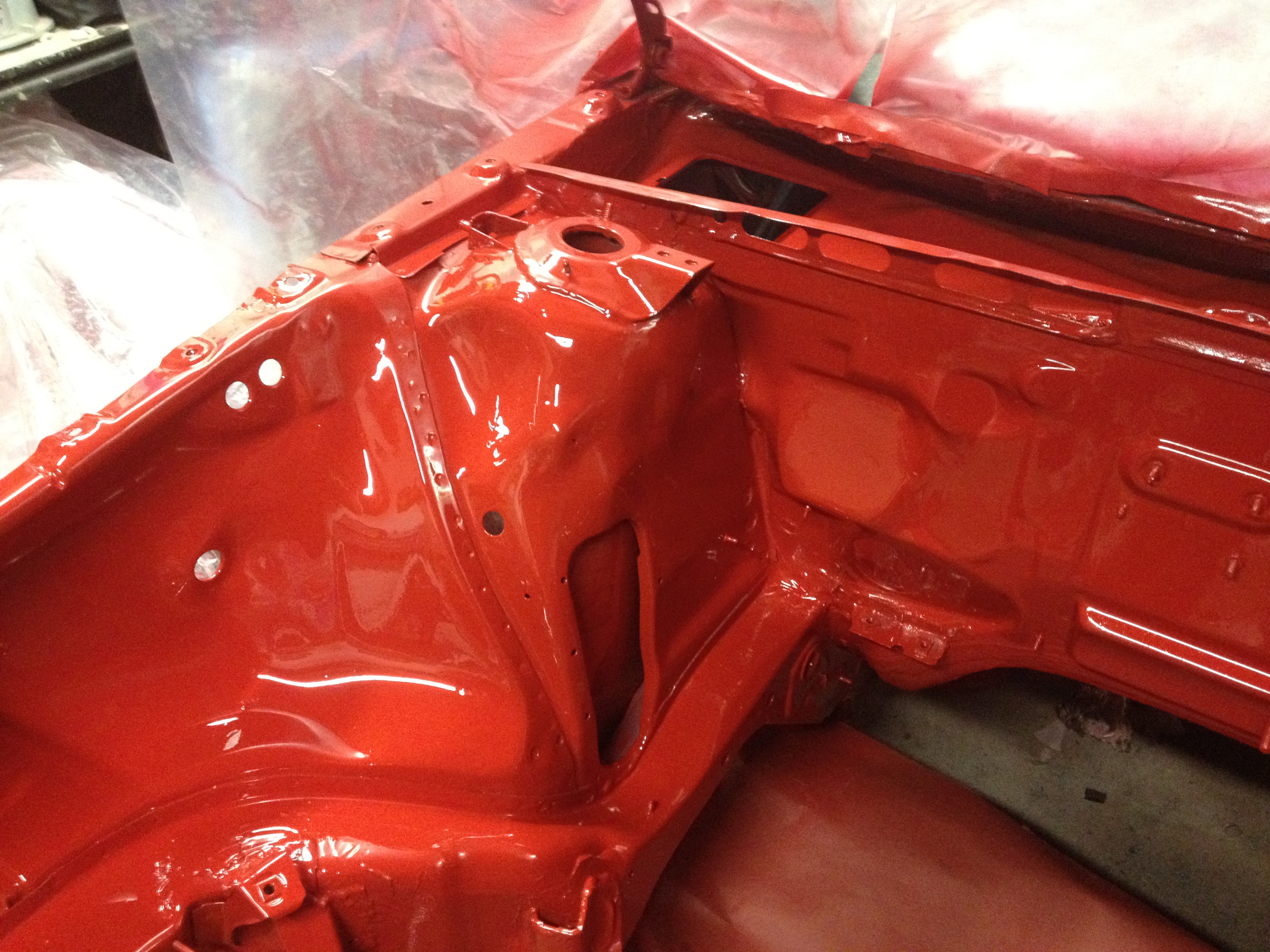

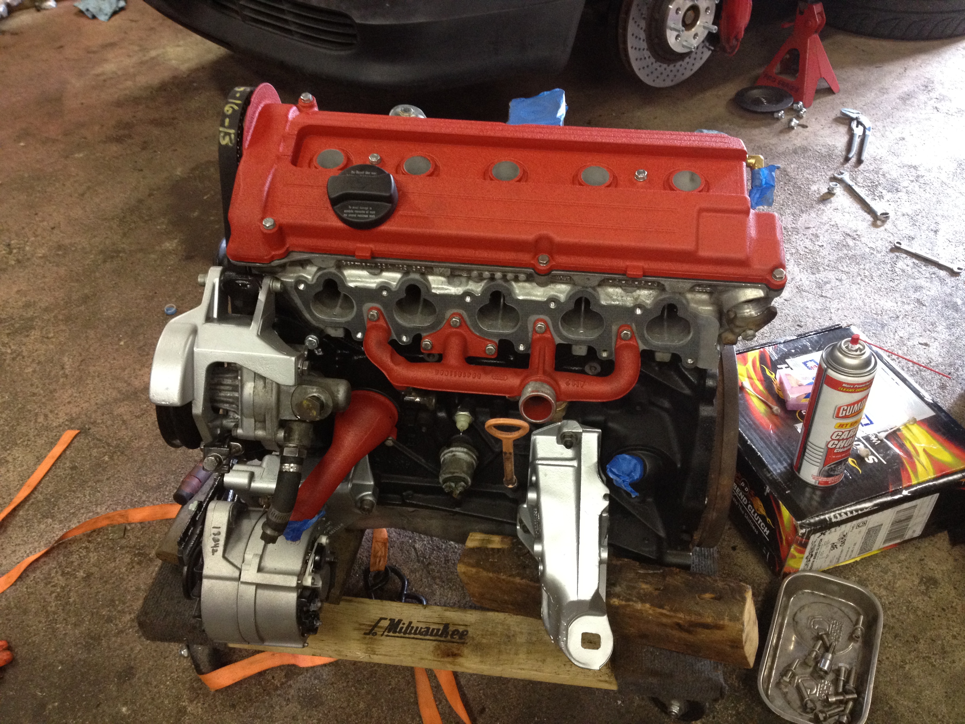

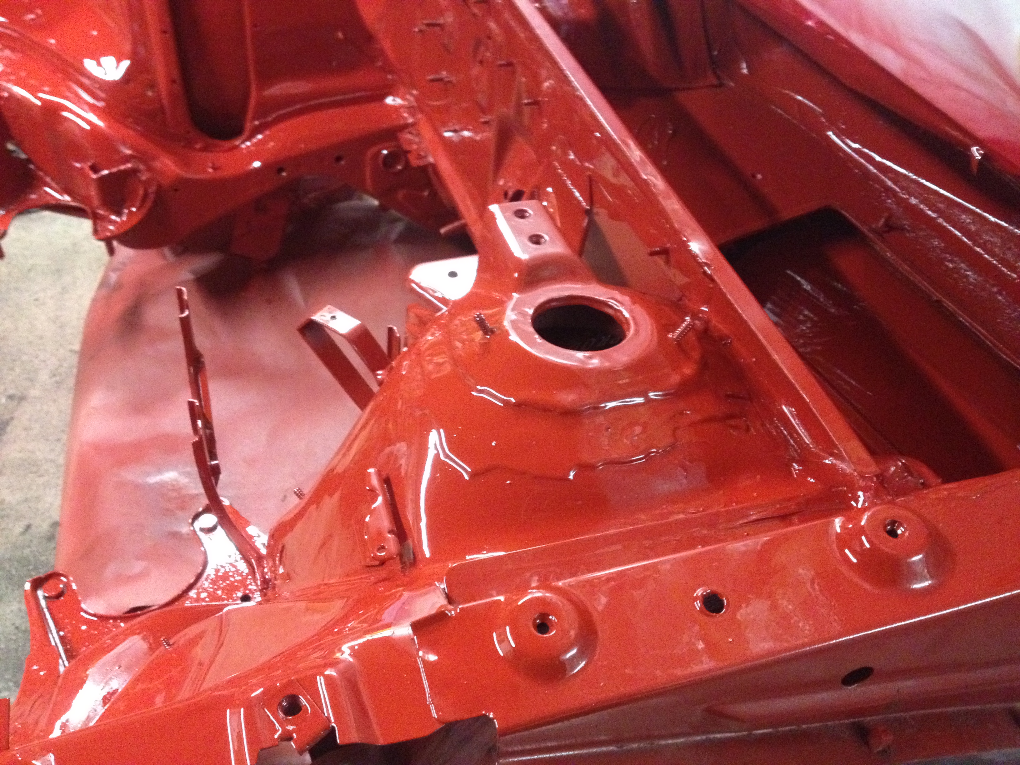

some color and steering
Sebastian's CQ91' engine bay paint 4.JPG (2.55 MiB) Viewed 42228 times
Sebastian's CQ91' engine bay paint .JPG (2.82 MiB) Viewed 42228 times
Sebastian's CQ91'engine bay finished paint .JPG (2.61 MiB) Viewed 42228 times
Sebastian's CQ91' power steering job.JPG (599.15 KiB) Viewed 42228 times
Sebastian's CQ91' engine paint finished.JPG (3.8 MiB) Viewed 42228 times
- Sebastian -

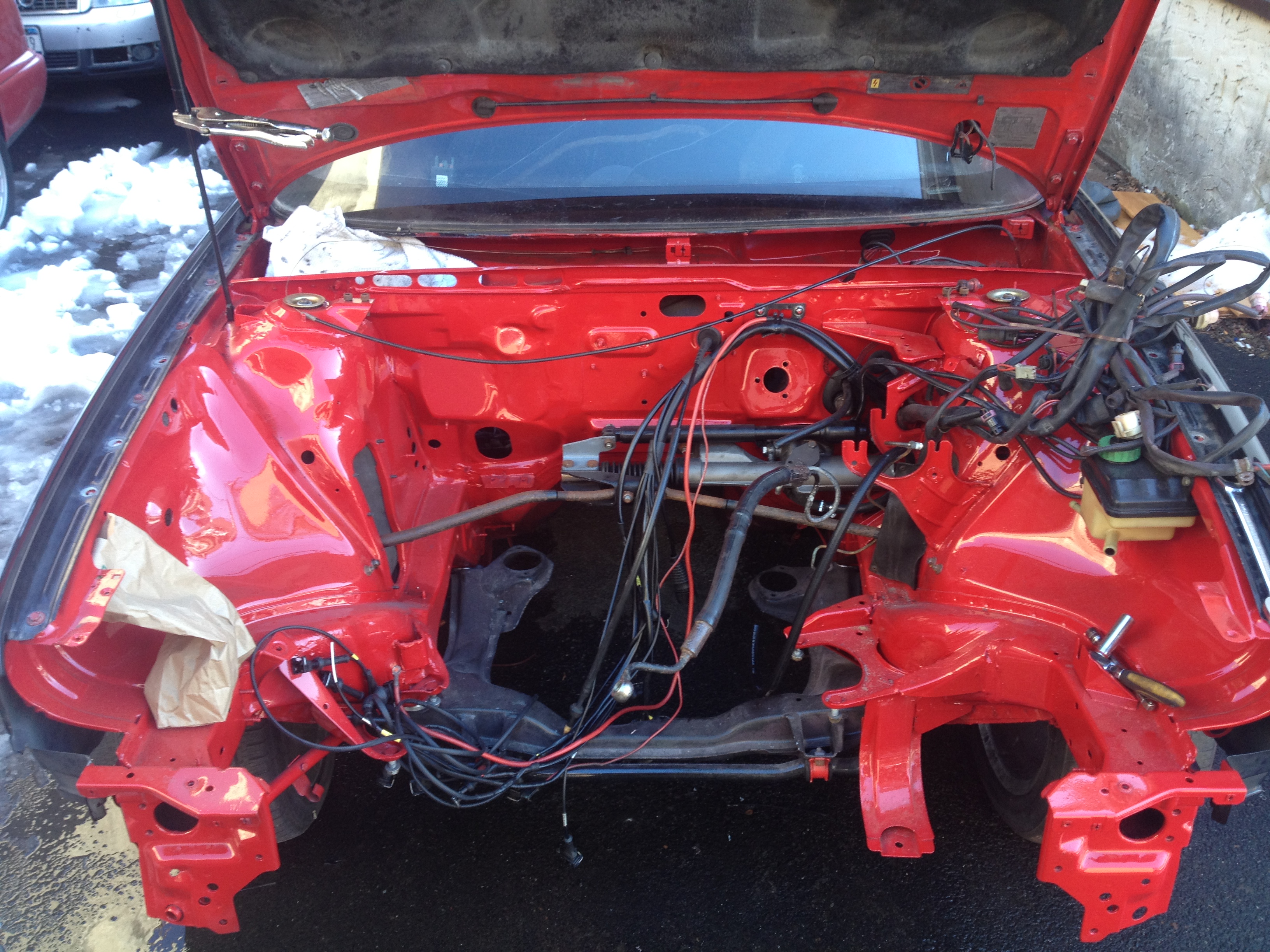

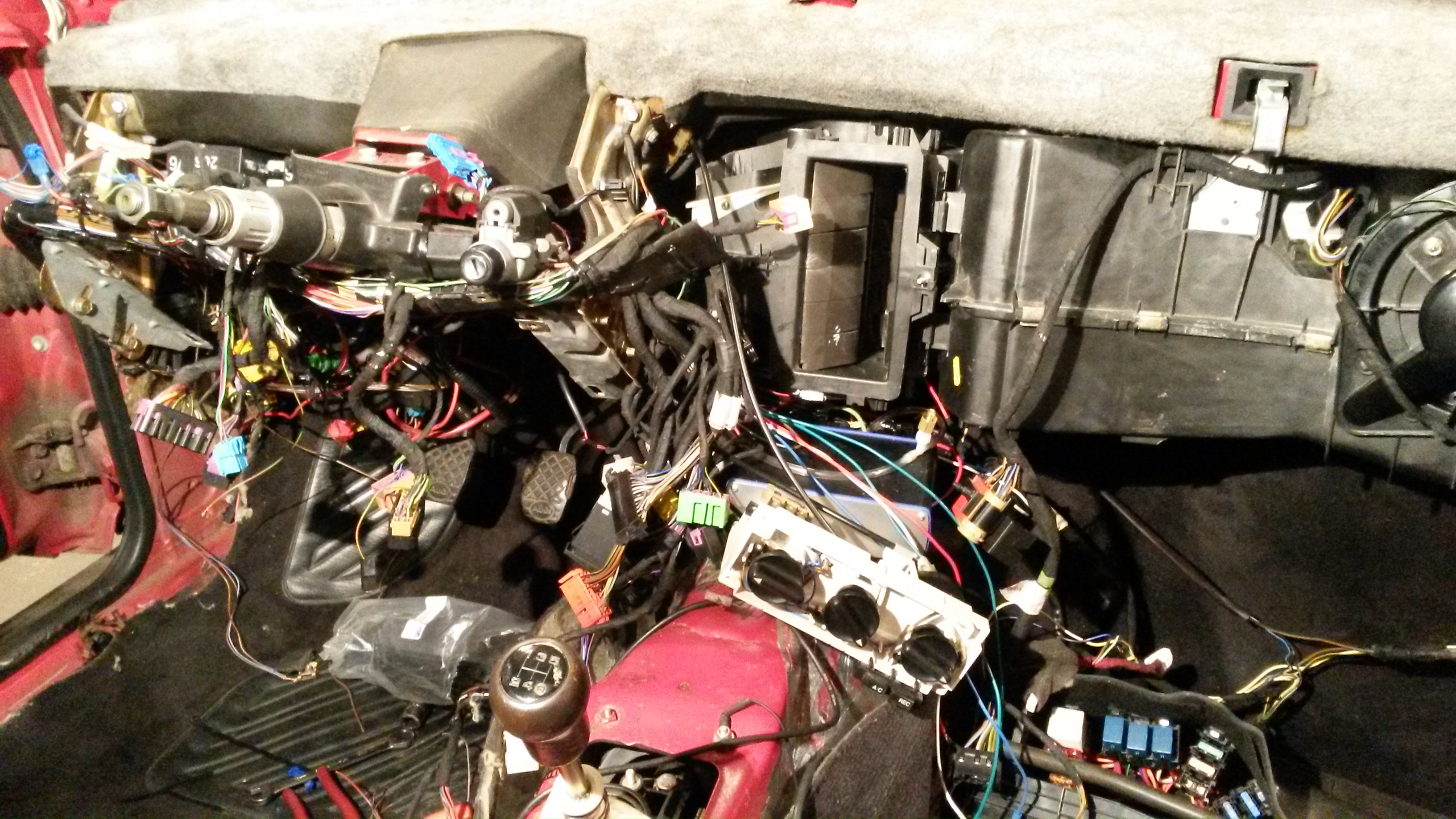

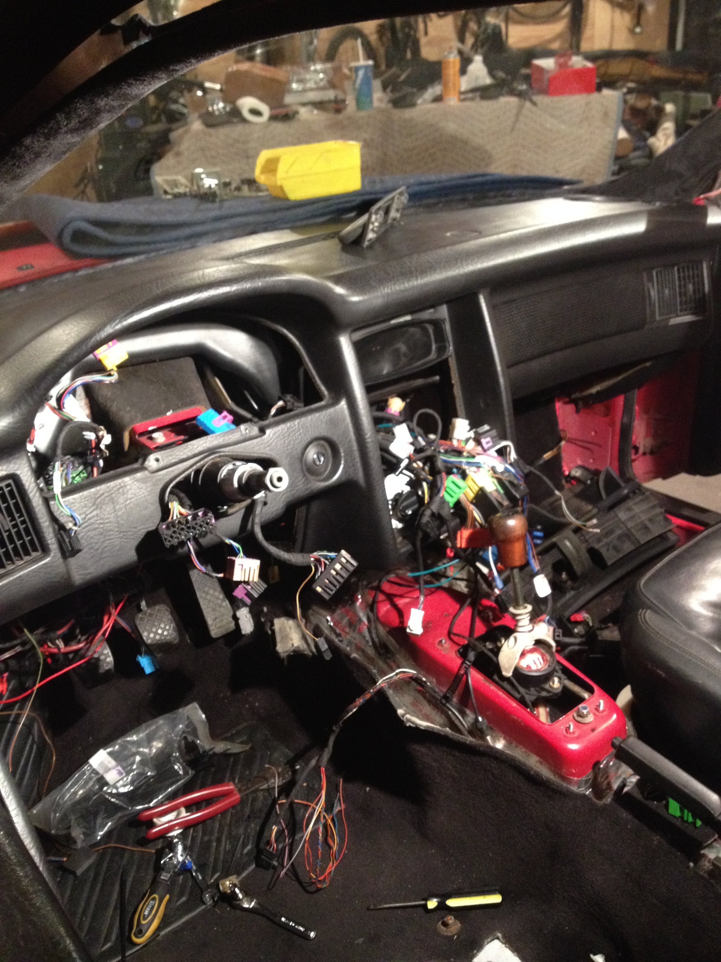

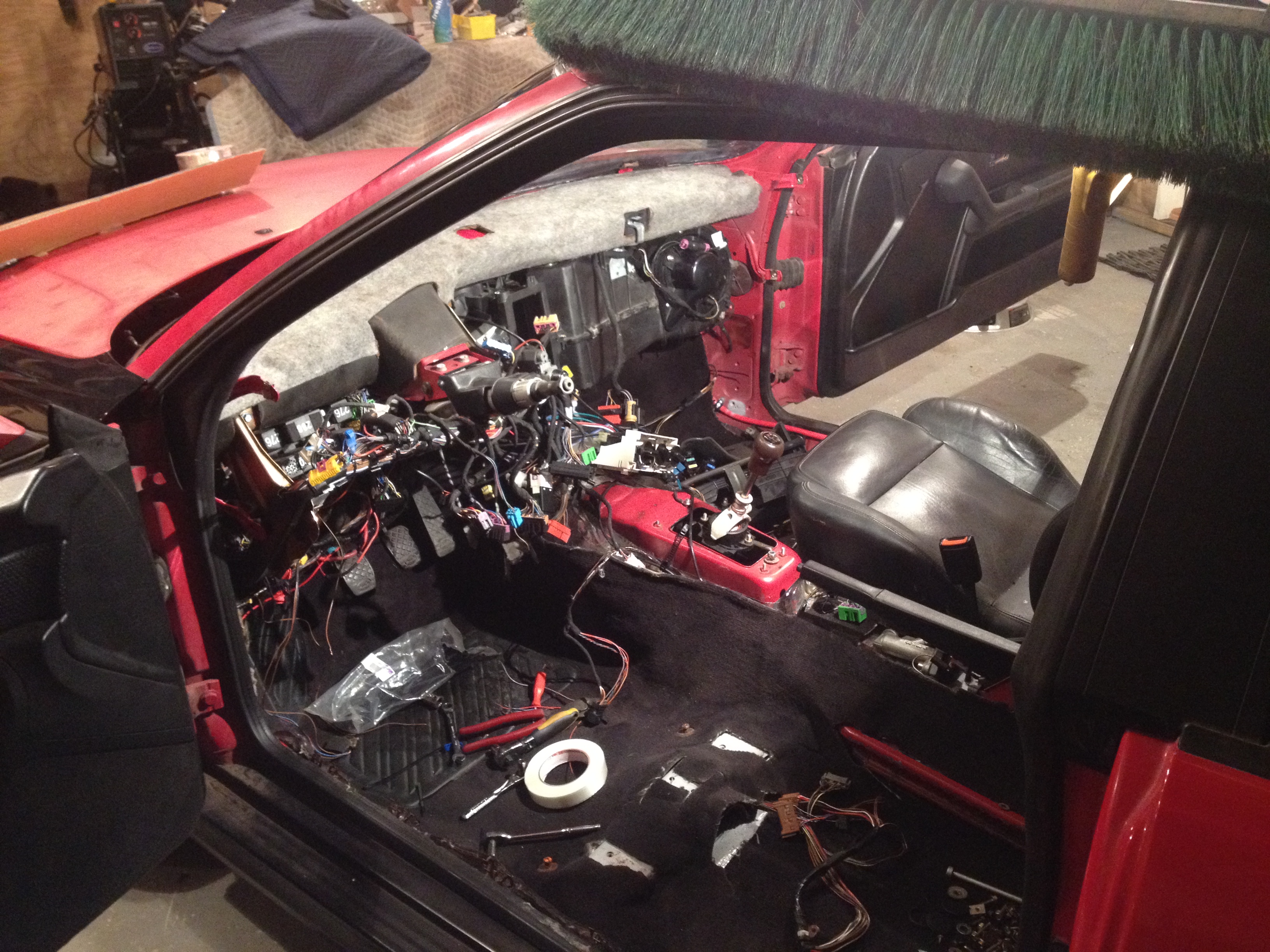

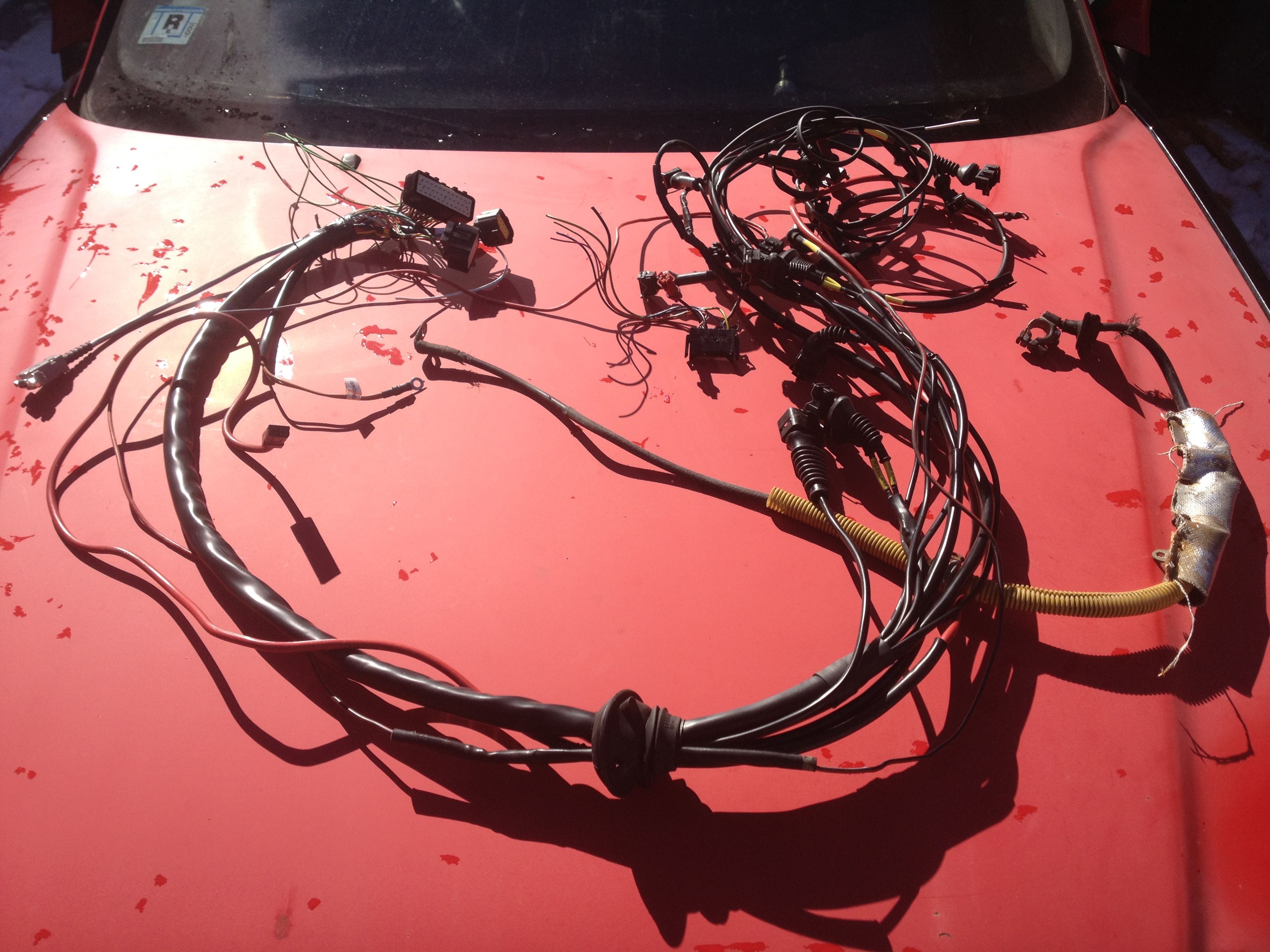

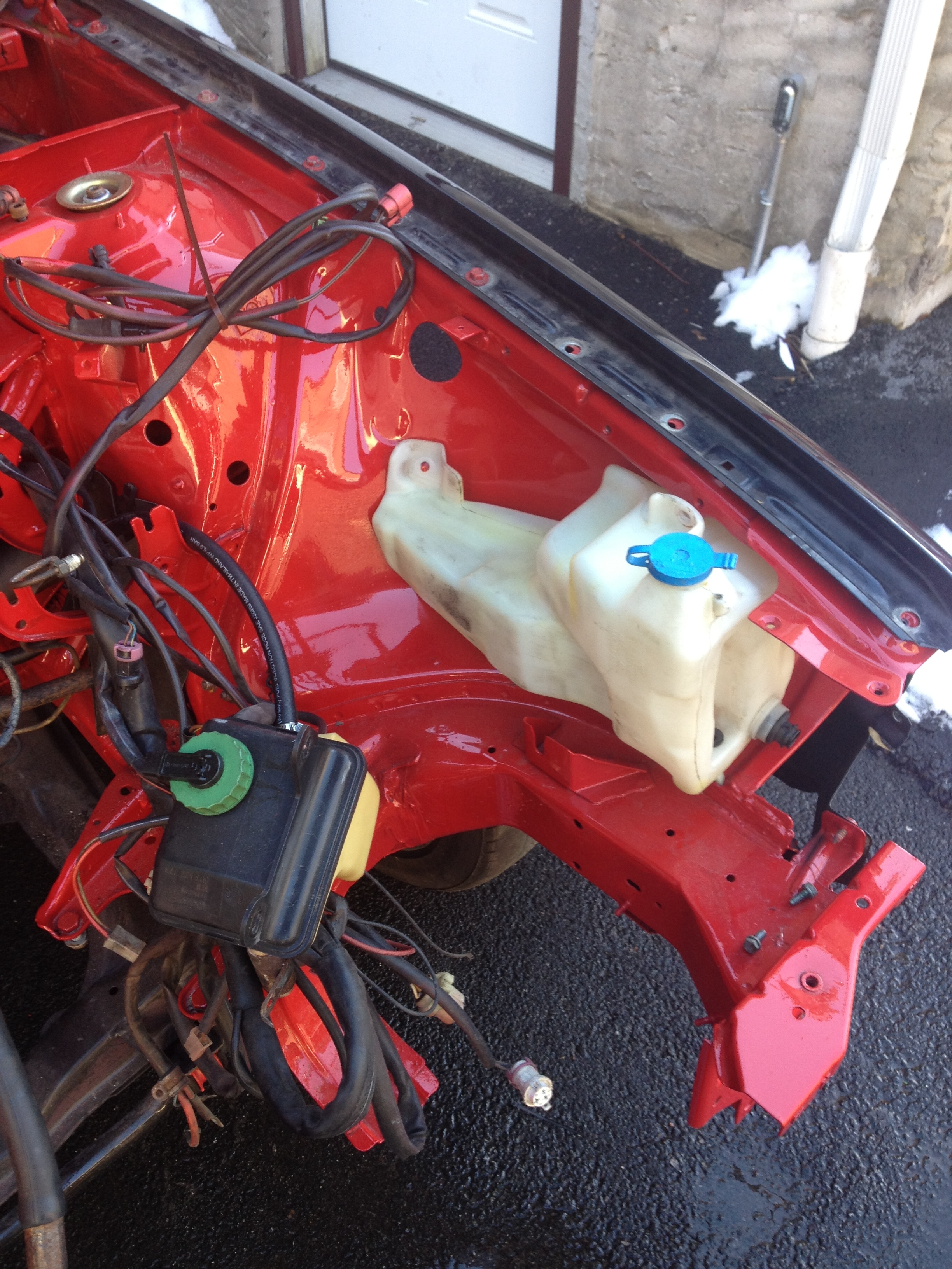

steering rack and fluid tanks installed with Vems harness and very slimmed down stock harness
Sebastian's CQ91' stock harness slimmed down.jpg (3.04 MiB) Viewed 42227 times
Sebastian's CQ91' vems harness EFI Express.JPG (2.25 MiB) Viewed 42227 times
Sebastian's CQ91' engine bay random shoot 2.JPG (2.58 MiB) Viewed 42227 times
Sebastian's CQ91' engine bay random shoot 1.jpg (2.85 MiB) Viewed 42227 times

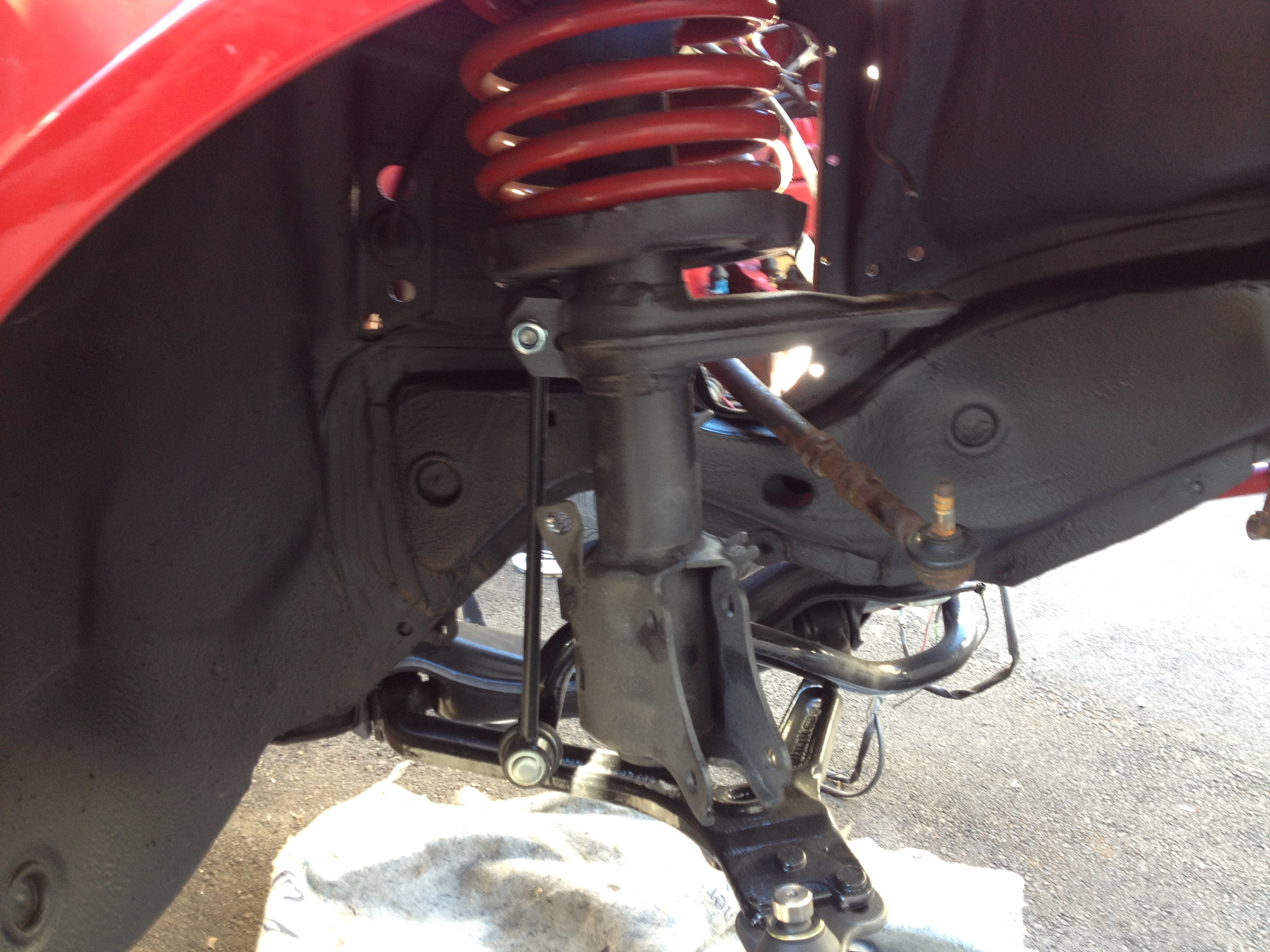

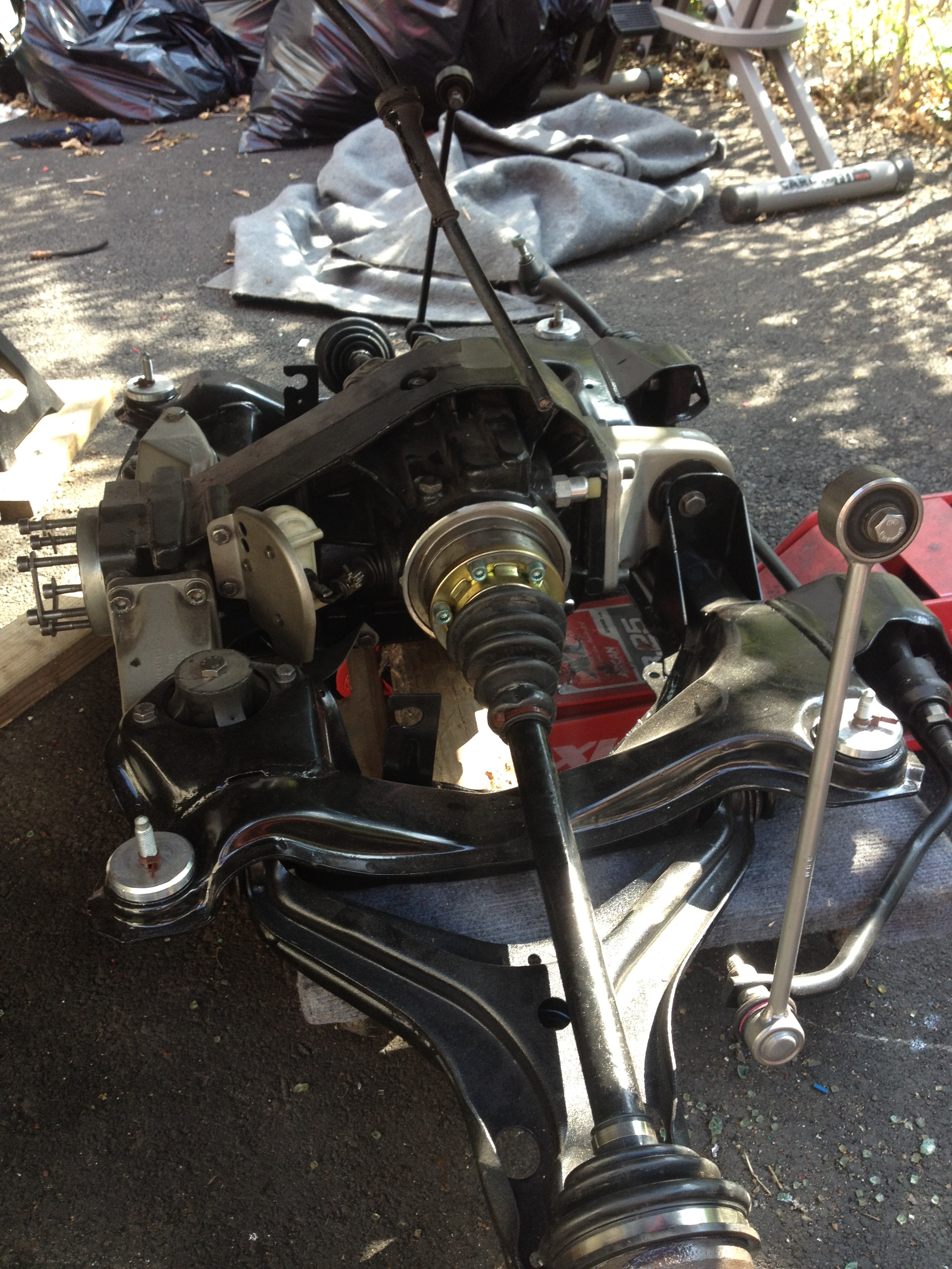

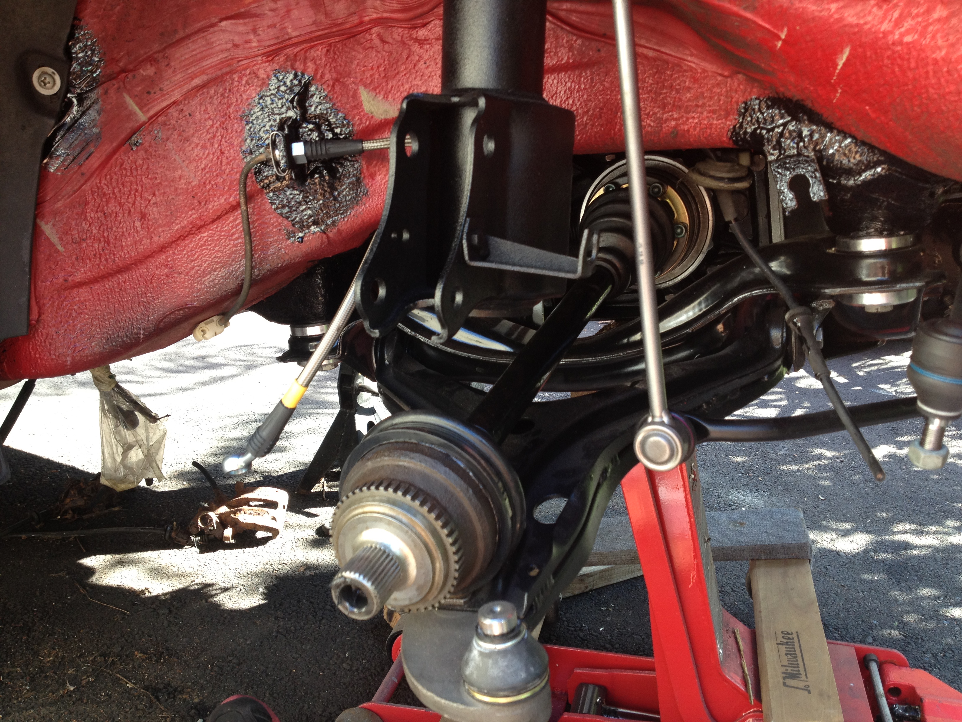

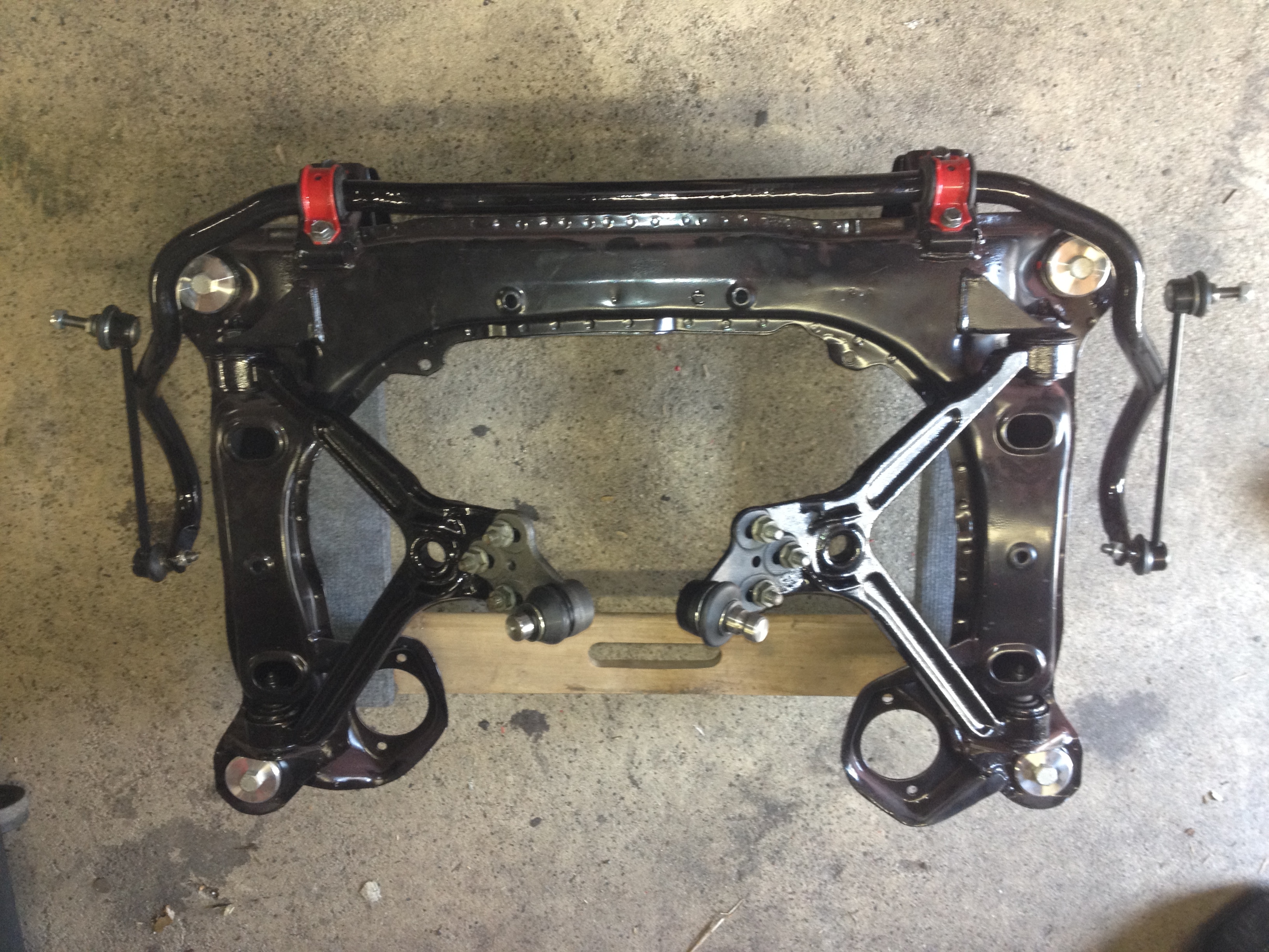

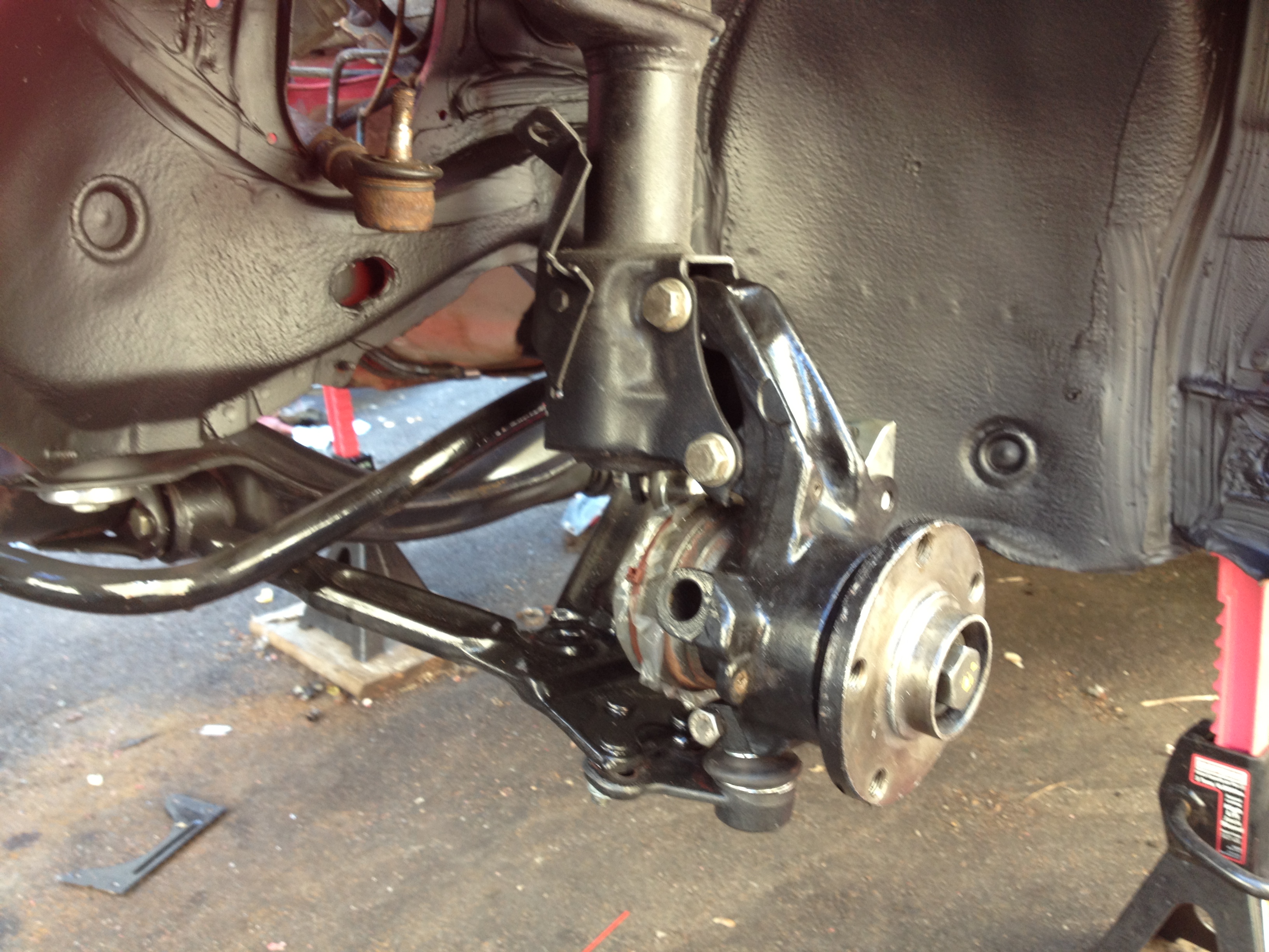

here is a bit of the under chassis and suspension work.
Sebastian's CQ91' front suspension assembly .jpg (2.84 MiB) Viewed 42191 times
Sebastian's CQ91' front suspension .JPG (2.12 MiB) Viewed 42191 times
Sebastian's CQ91' rear suspension assembly 1.jpg (3.06 MiB) Viewed 42191 times
Sebastian's CQ91' rear suspenssion shot.JPG (2.81 MiB) Viewed 42191 times
- Sebastian -

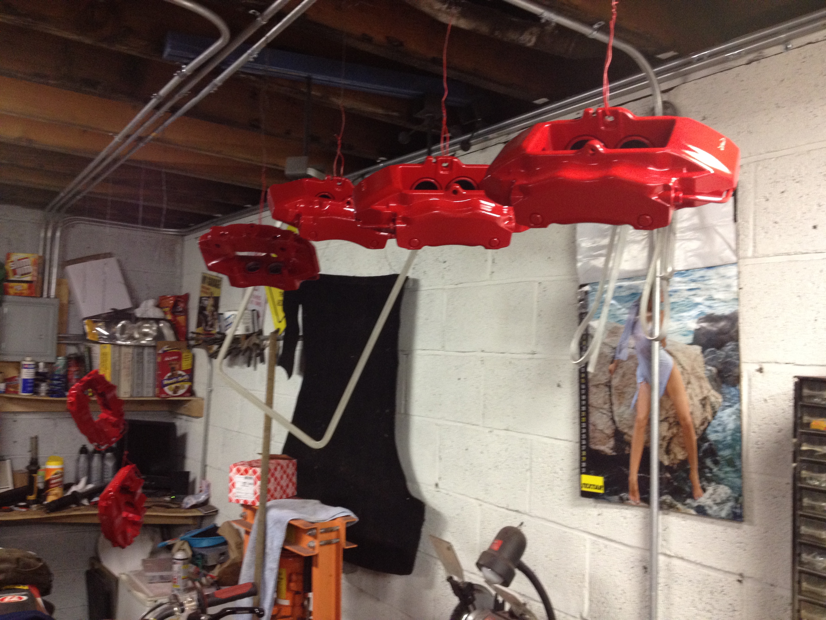

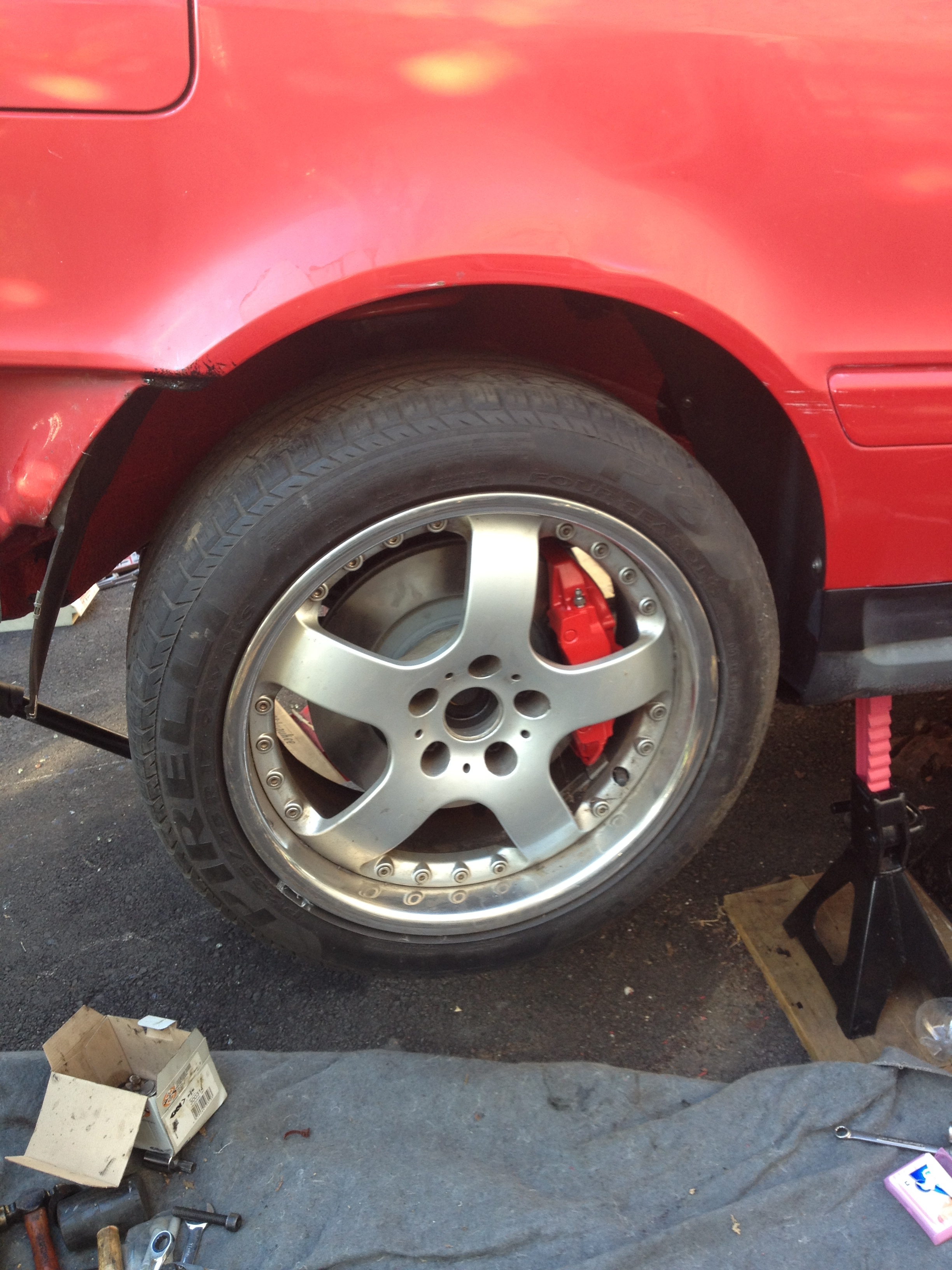

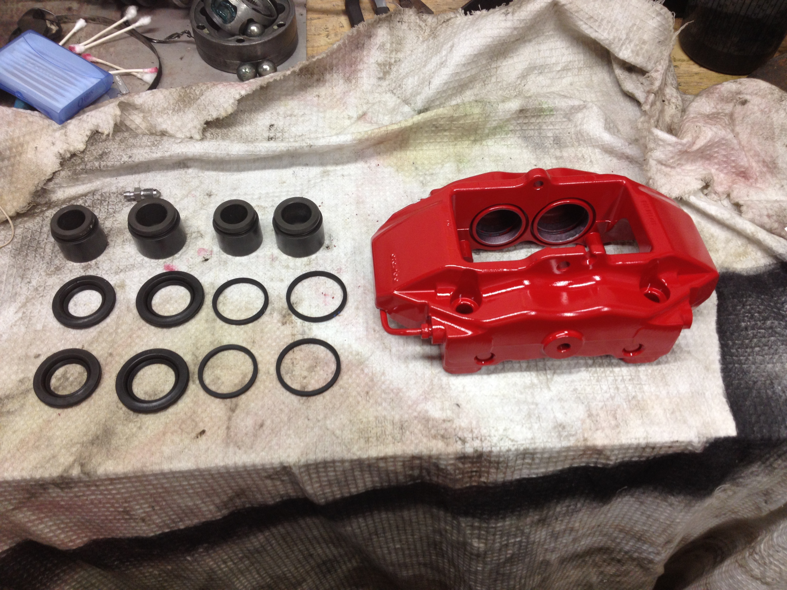

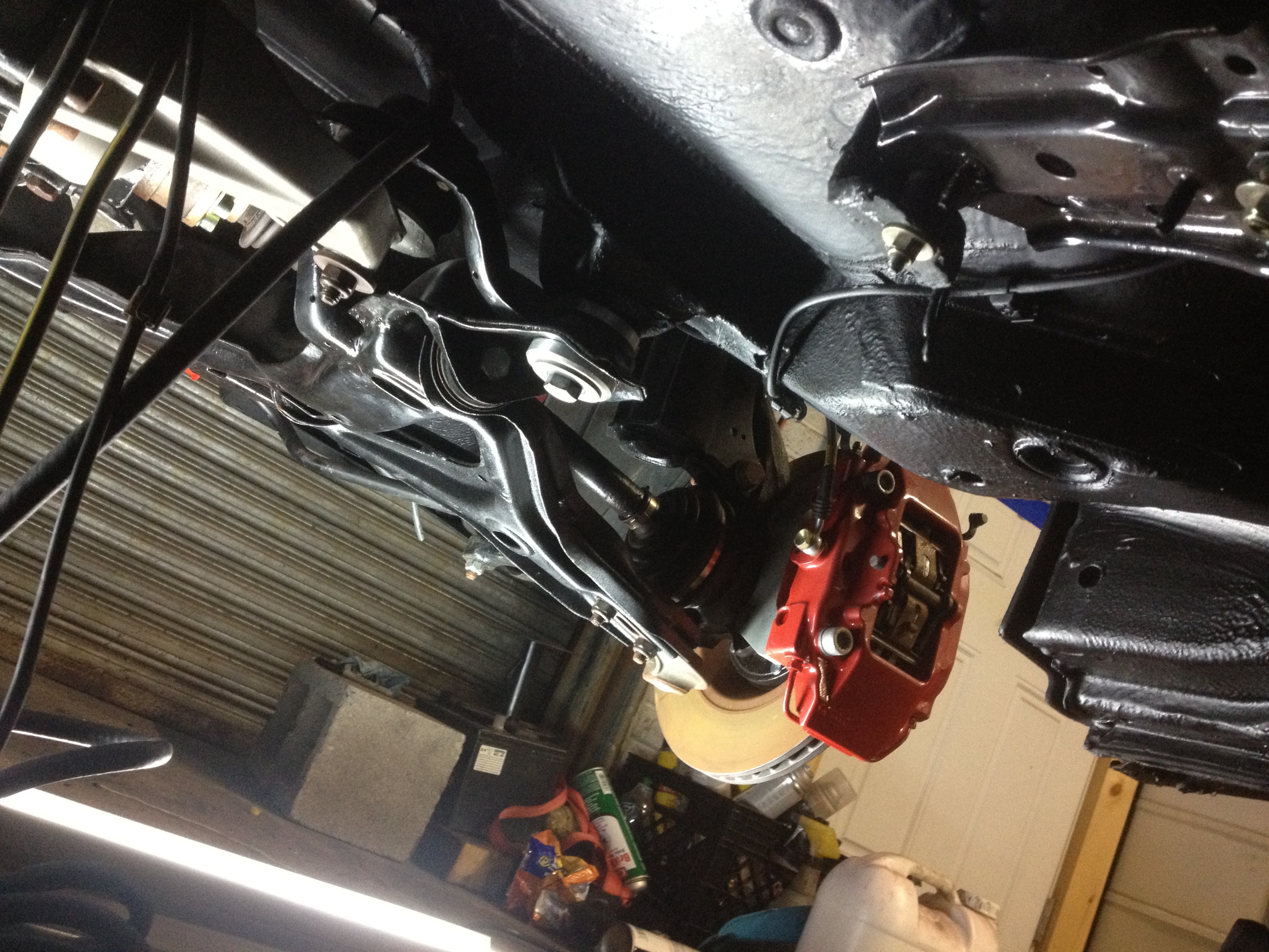

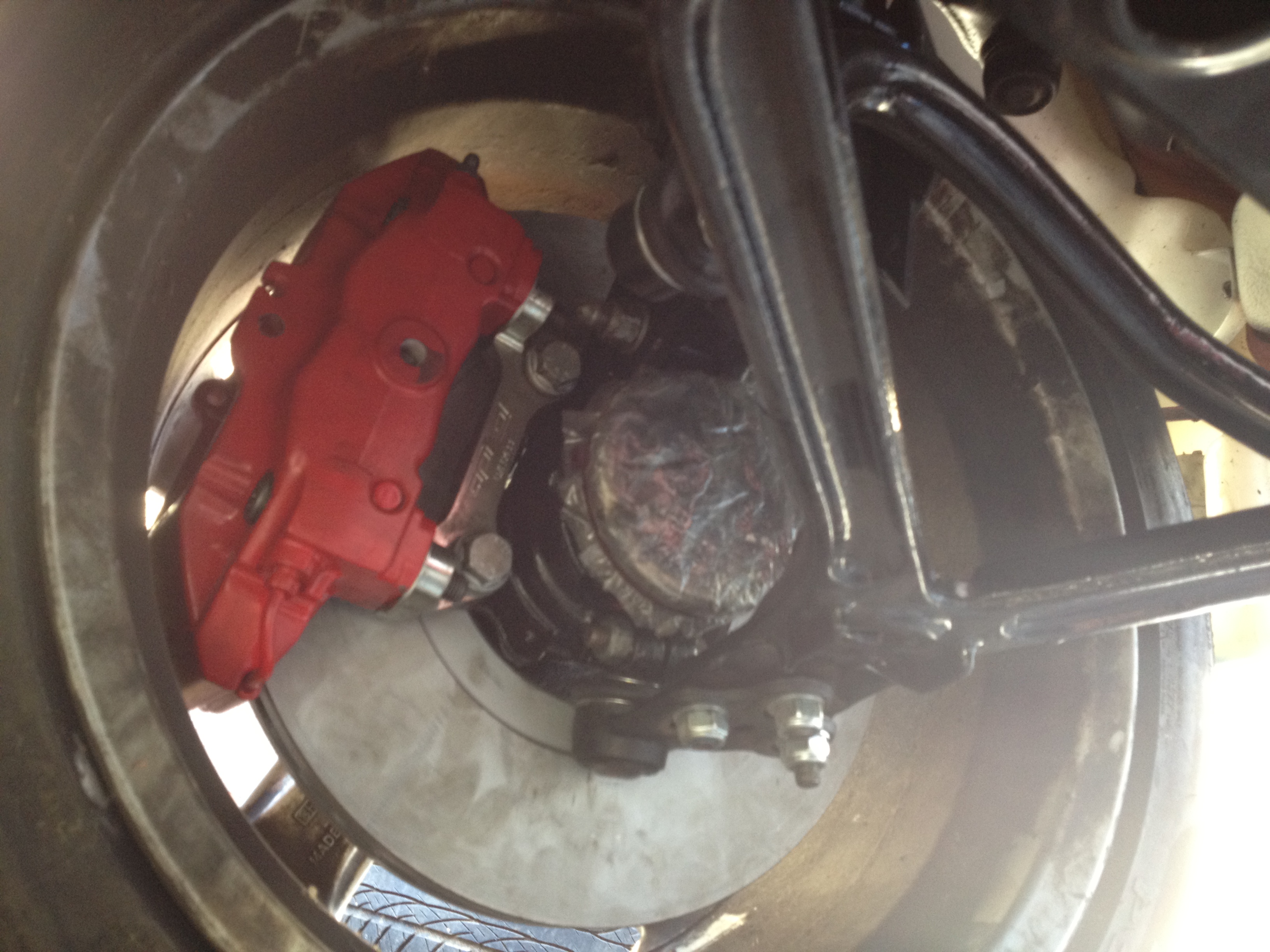

rear brakes
Sebastian's CQ91' caliper paint.JPG (2.35 MiB) Viewed 42180 times
Sebastian's CQ91' rebuild calipers.JPG (2.44 MiB) Viewed 42180 times
Sebastian's CQ91' rear brakes done 1.jpg (2 MiB) Viewed 42180 times
Sebastian's CQ91' rear brakes done.jpg (2.36 MiB) Viewed 42180 times
Sebastian's CQ91' rear brakes done 2.jpg (2.45 MiB) Viewed 42180 times

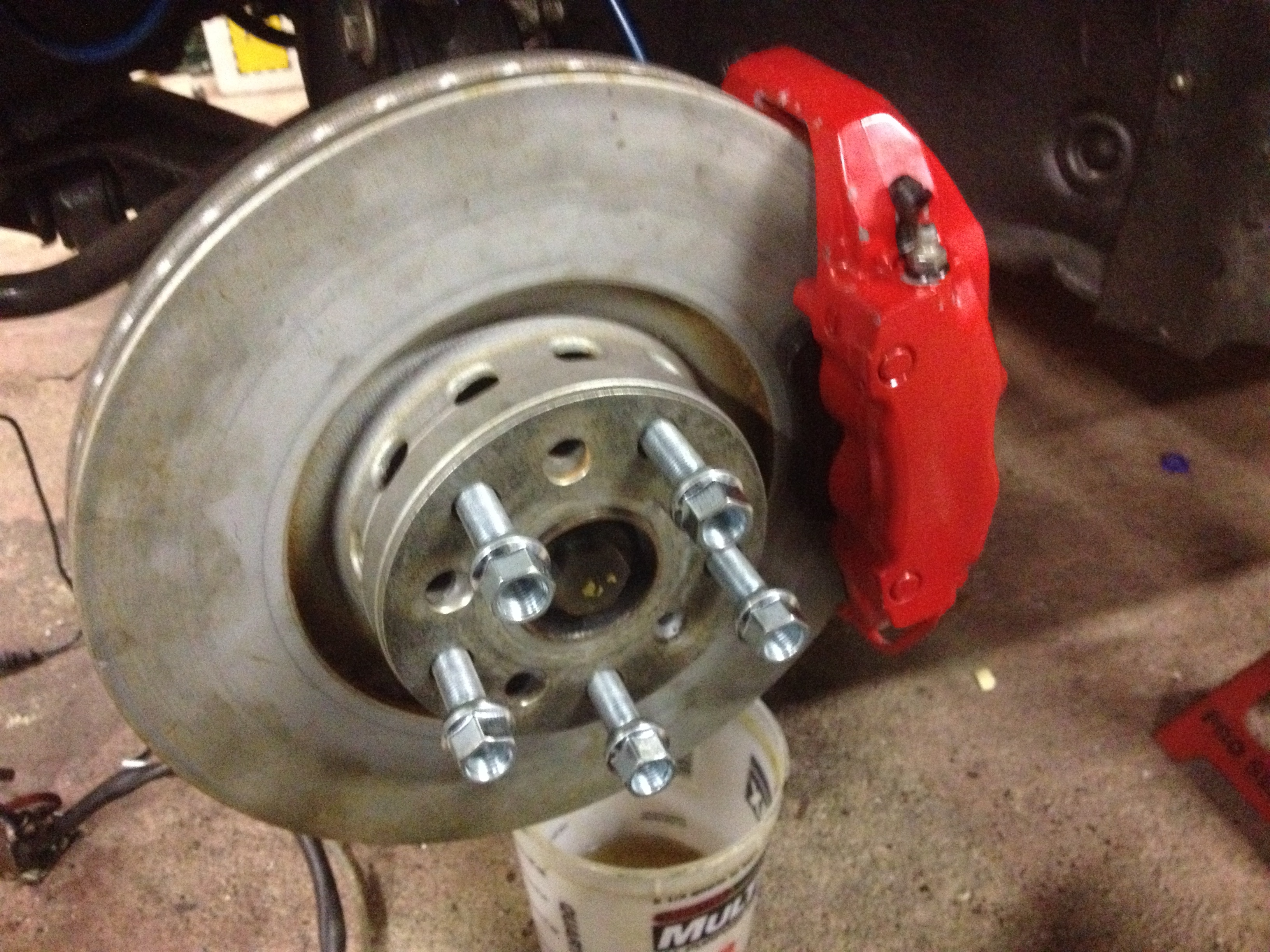

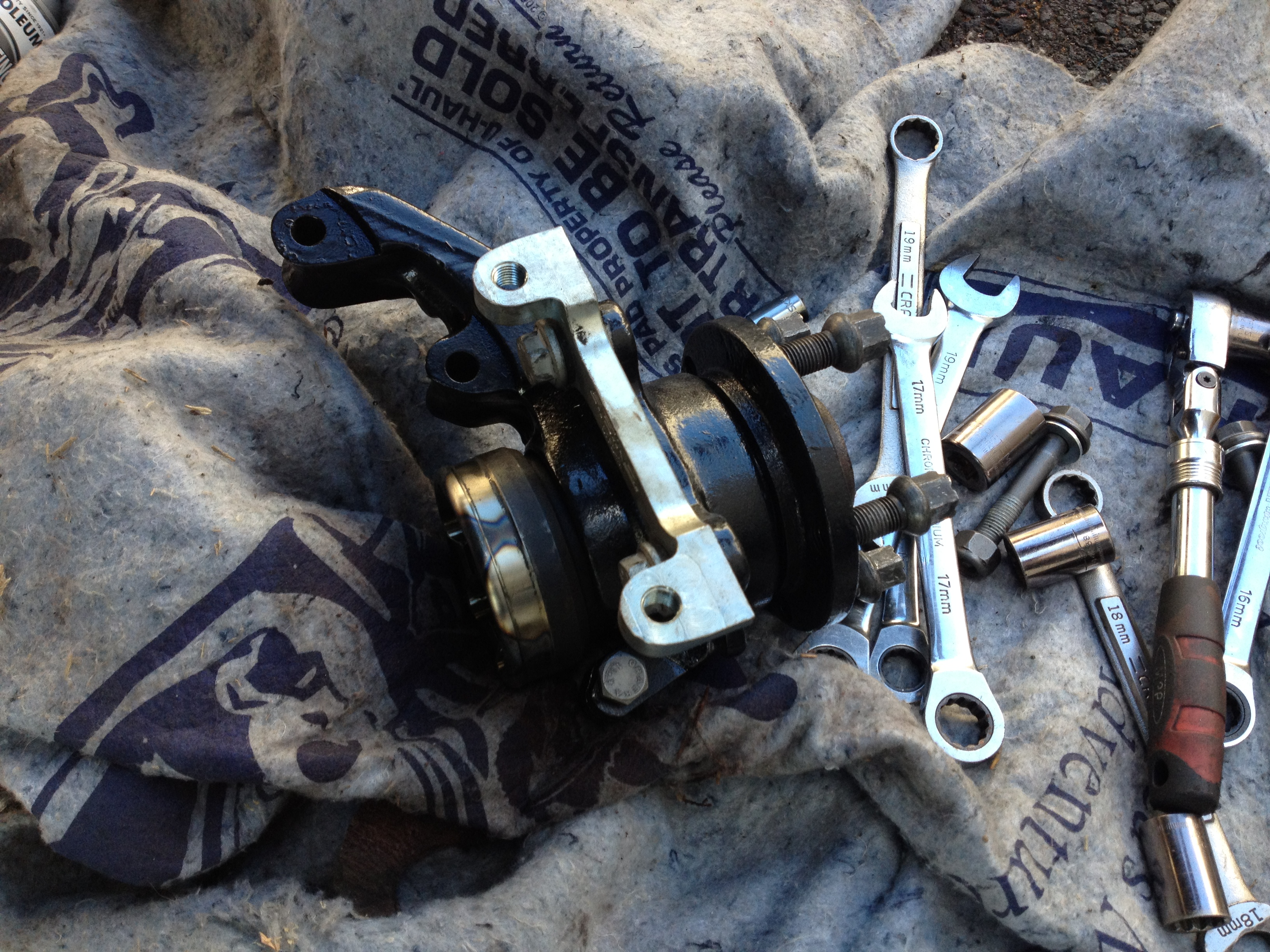

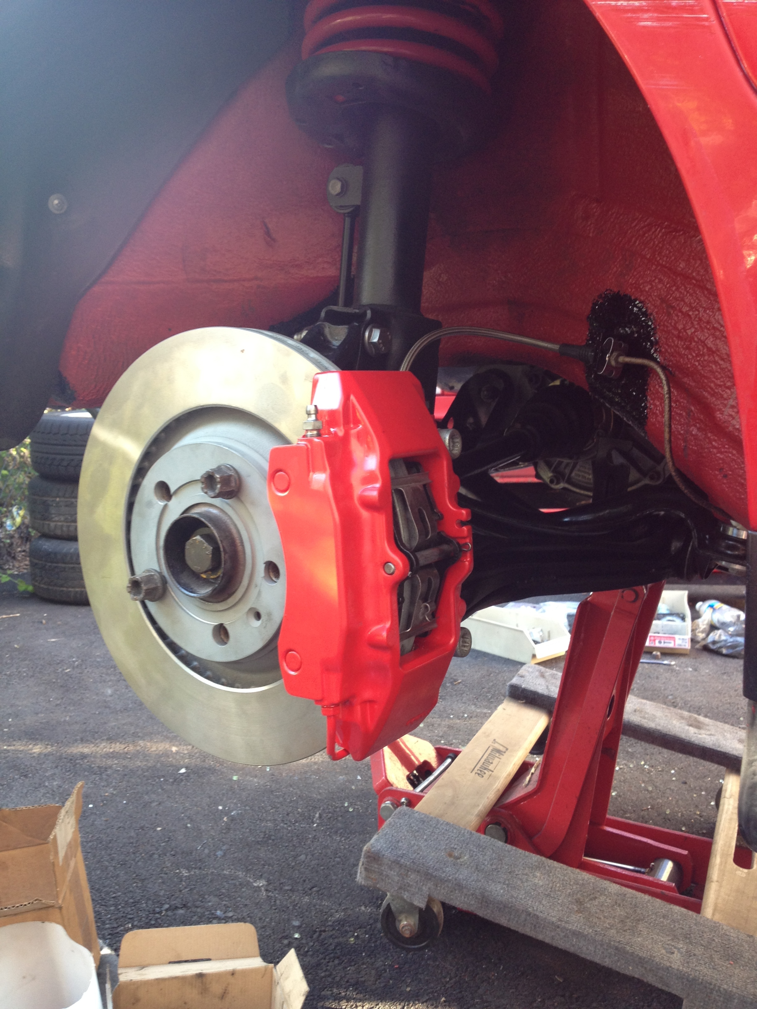

front brakes
Sebastian's CQ91' front brakes bracket .JPG (3.05 MiB) Viewed 42180 times
Sebastian's CQ91' brakes done.jpg (2.85 MiB) Viewed 42180 times
Sebastian's CQ91' front brakes .JPG (1.93 MiB) Viewed 42180 times
Sebastian's CQ91' wheels 17%22.jpg (2.98 MiB) Viewed 42180 times
- Sebastian -

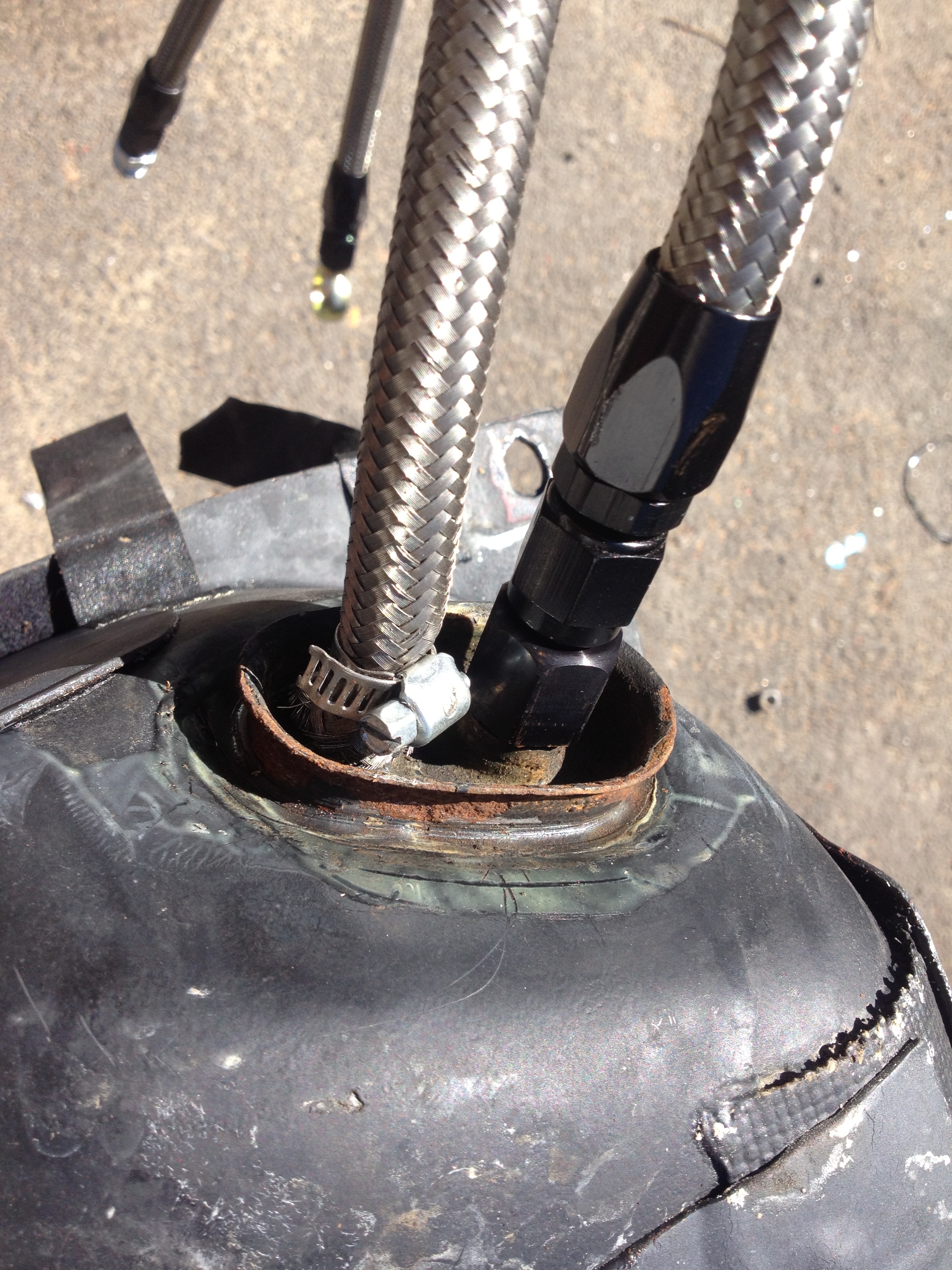

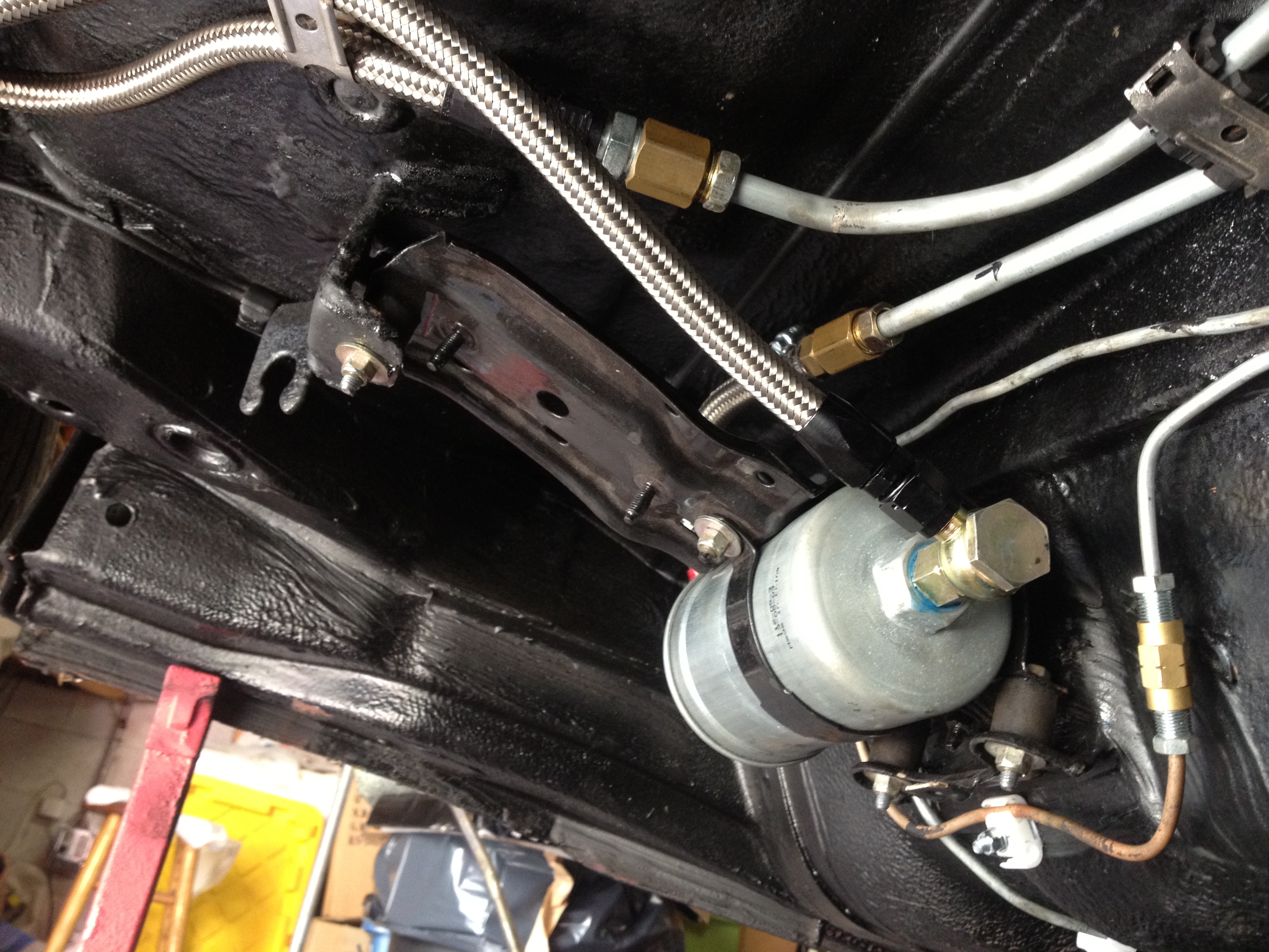

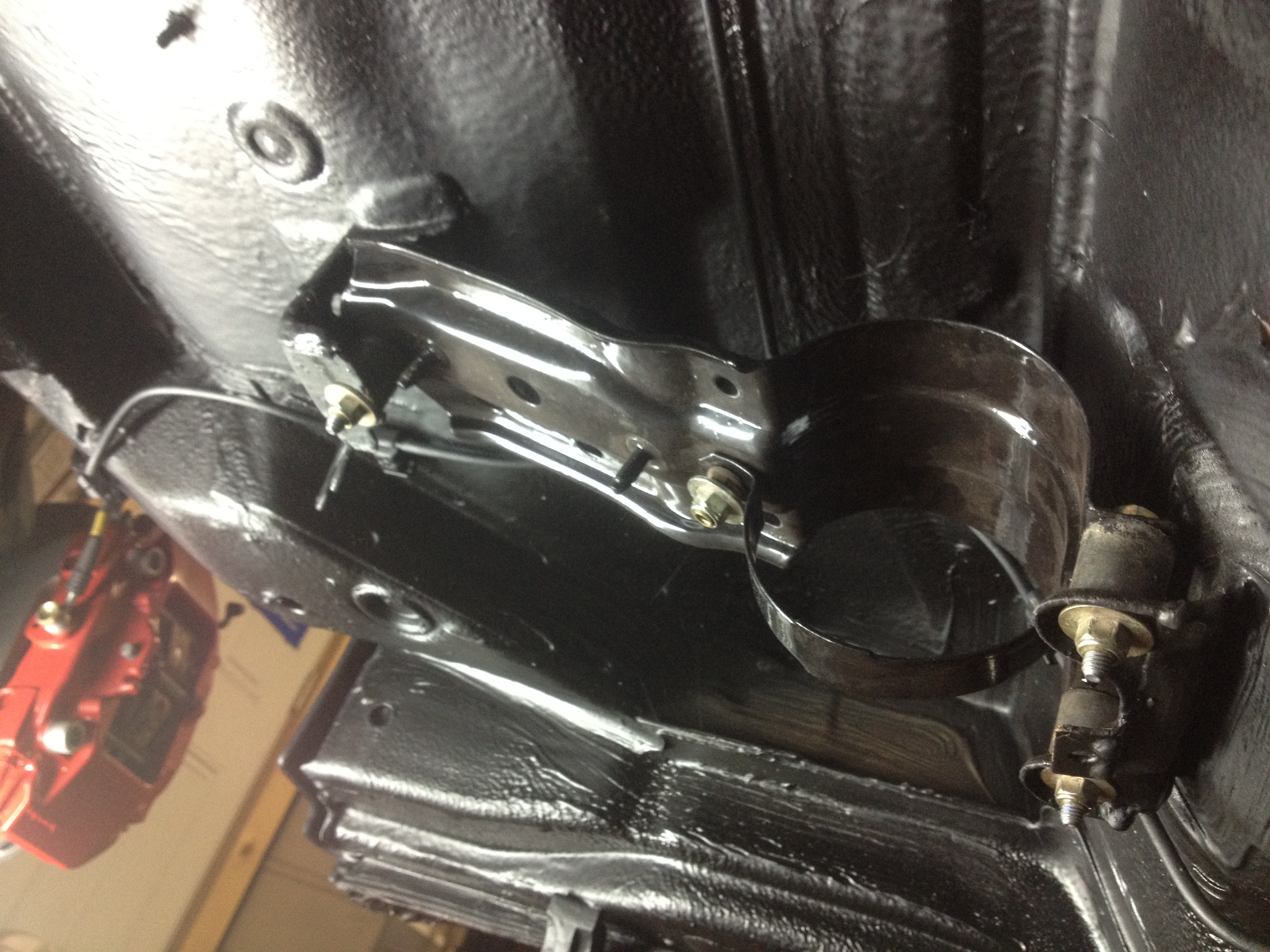

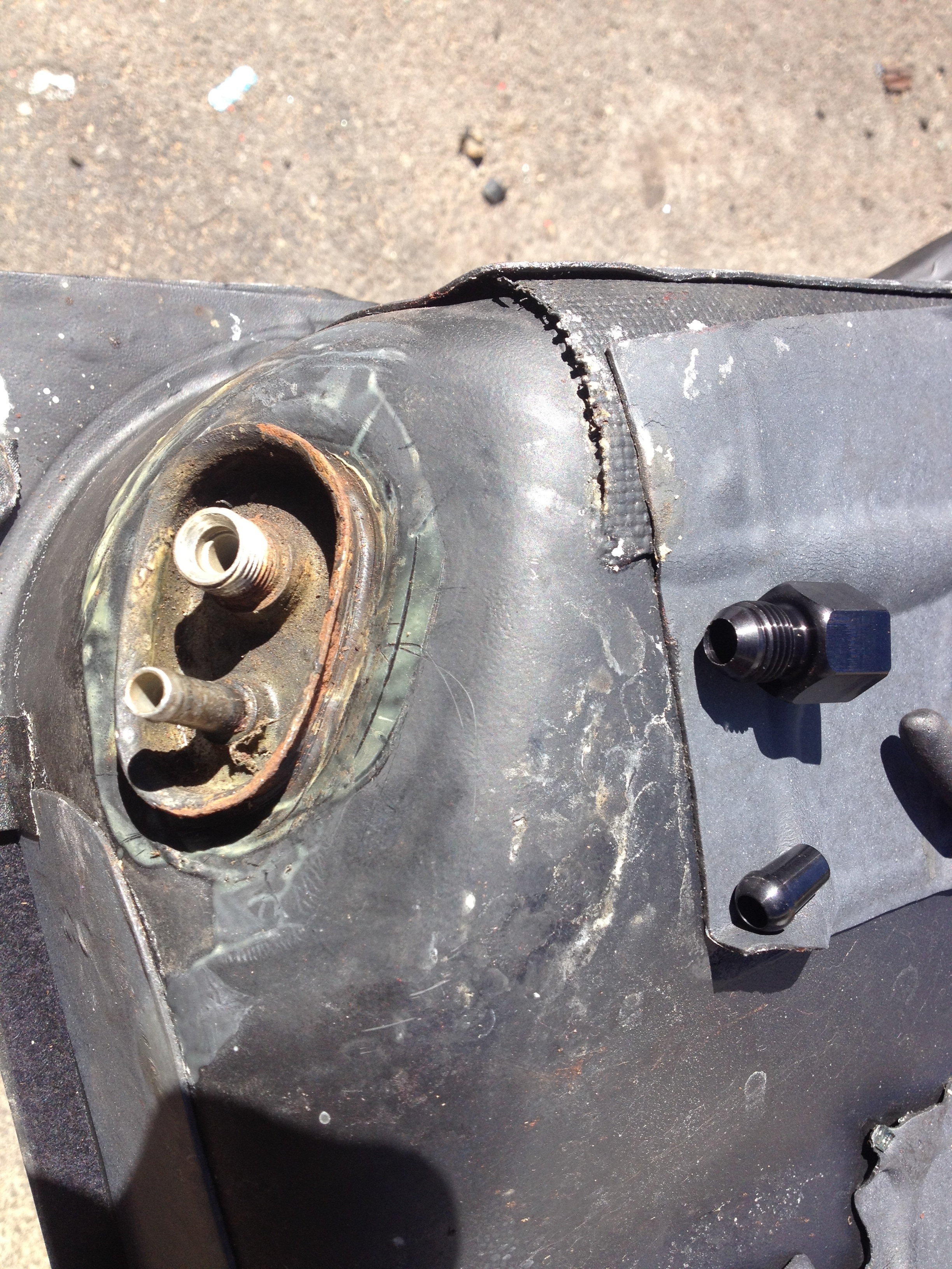

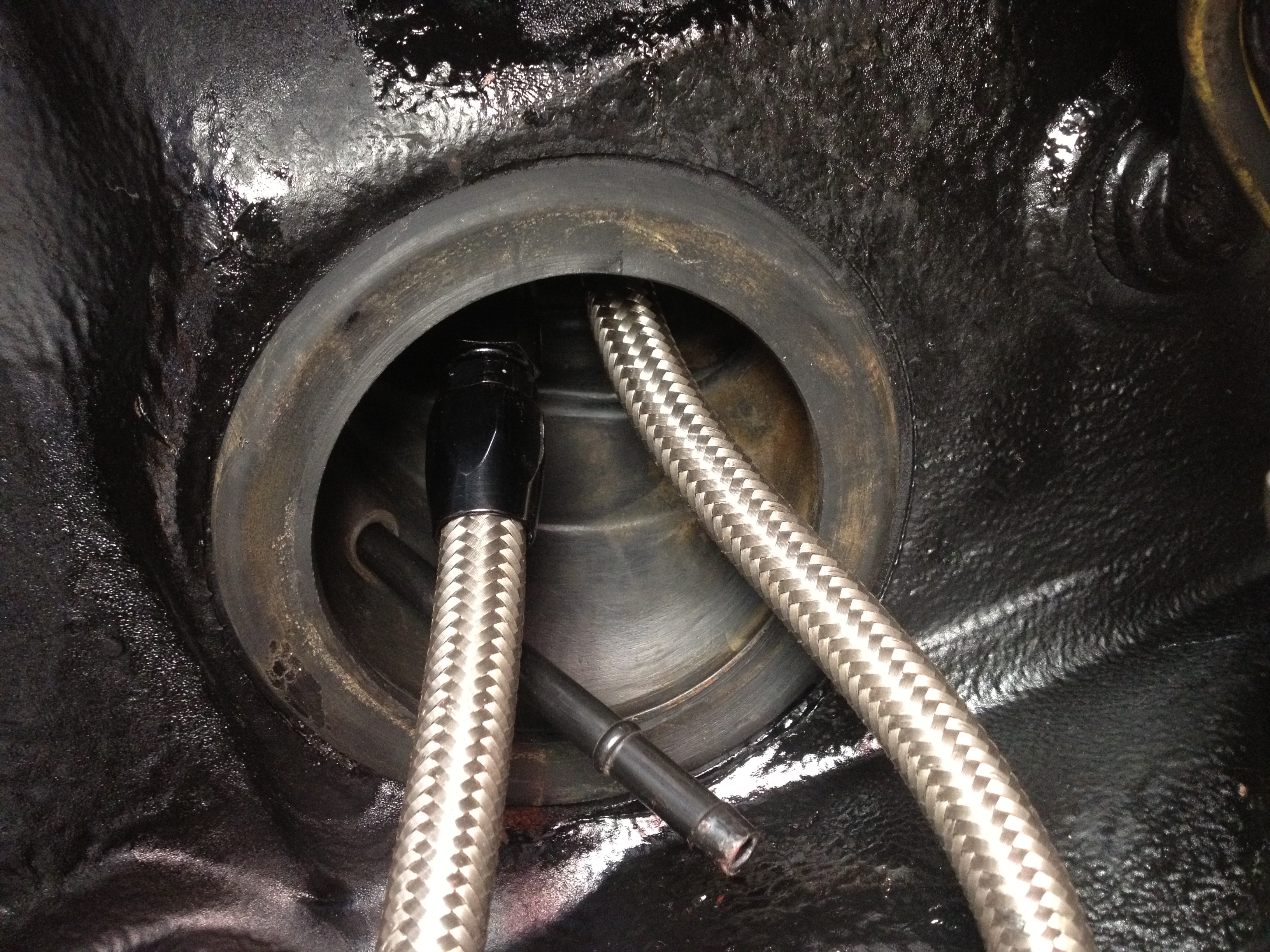

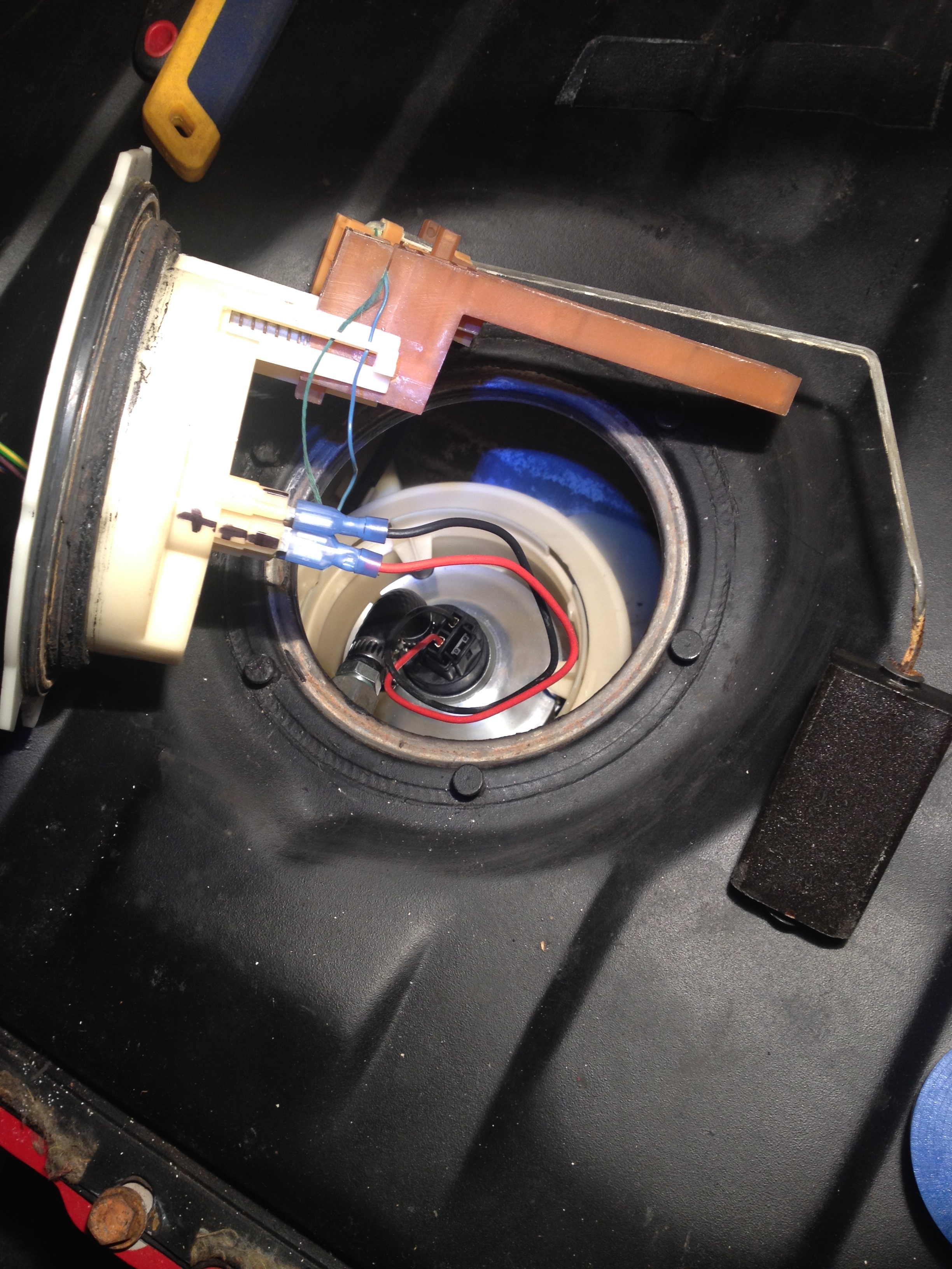

fuel lines, fuel tank connection with -6an fitting
Sebastian's CQ91' fuel tank plastic hose fix.jpg (3.21 MiB) Viewed 42161 times
Sebastian's CQ91' fuel tank lines.JPG (2.94 MiB) Viewed 42161 times
Sebastian's CQ91' fuel filter new lines.JPG (2.31 MiB) Viewed 42161 times

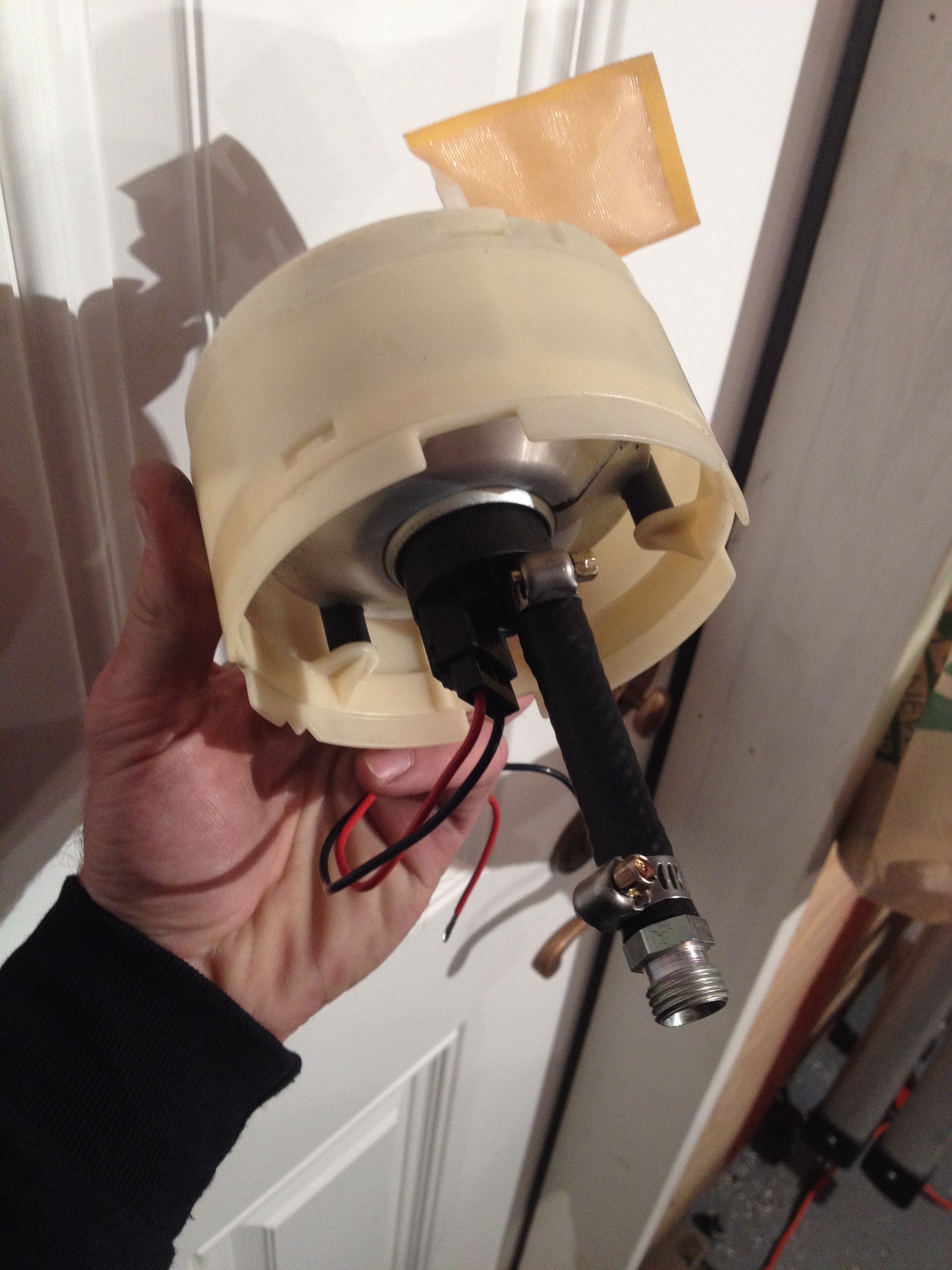

Post by Zaworek »

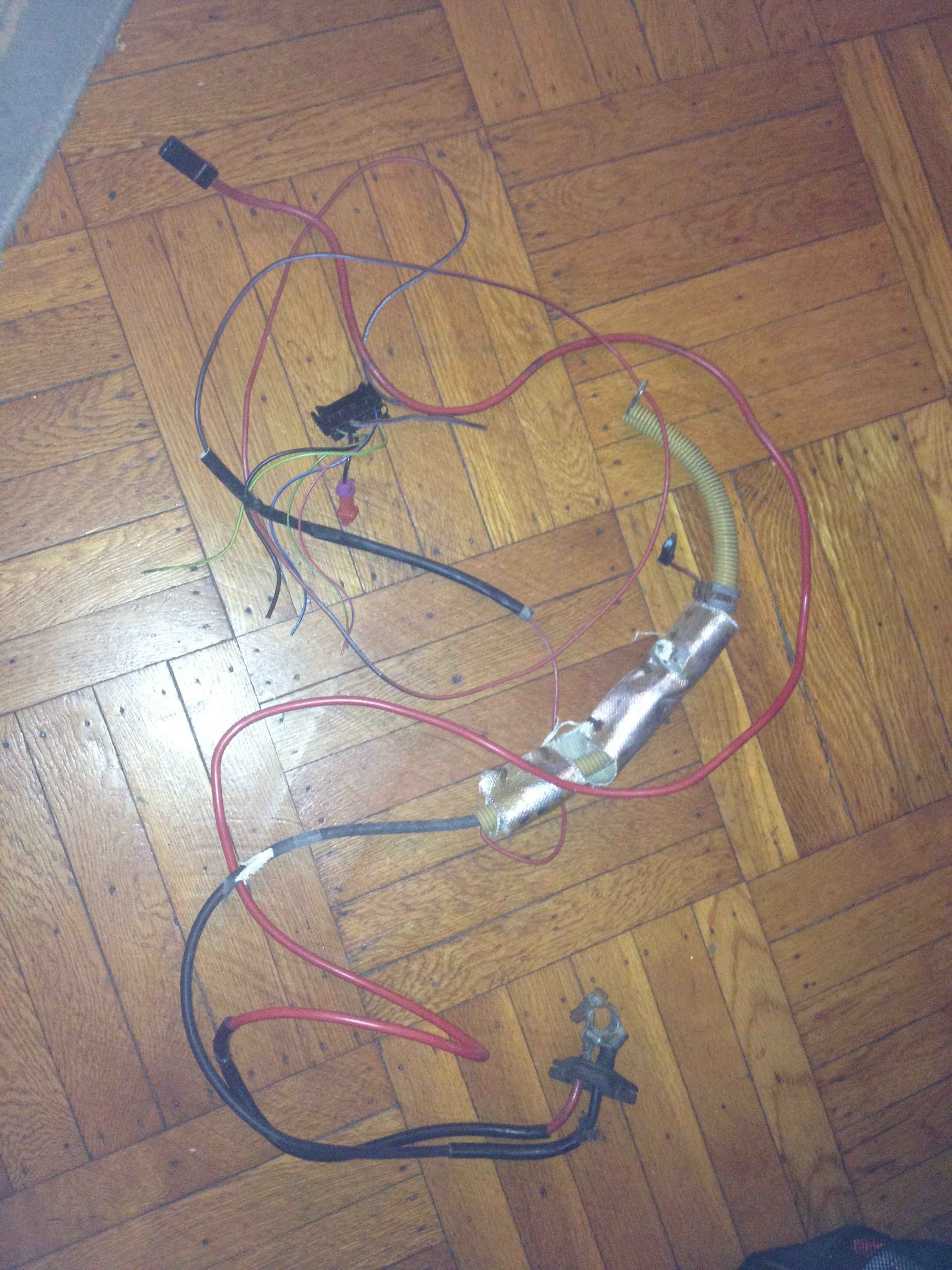

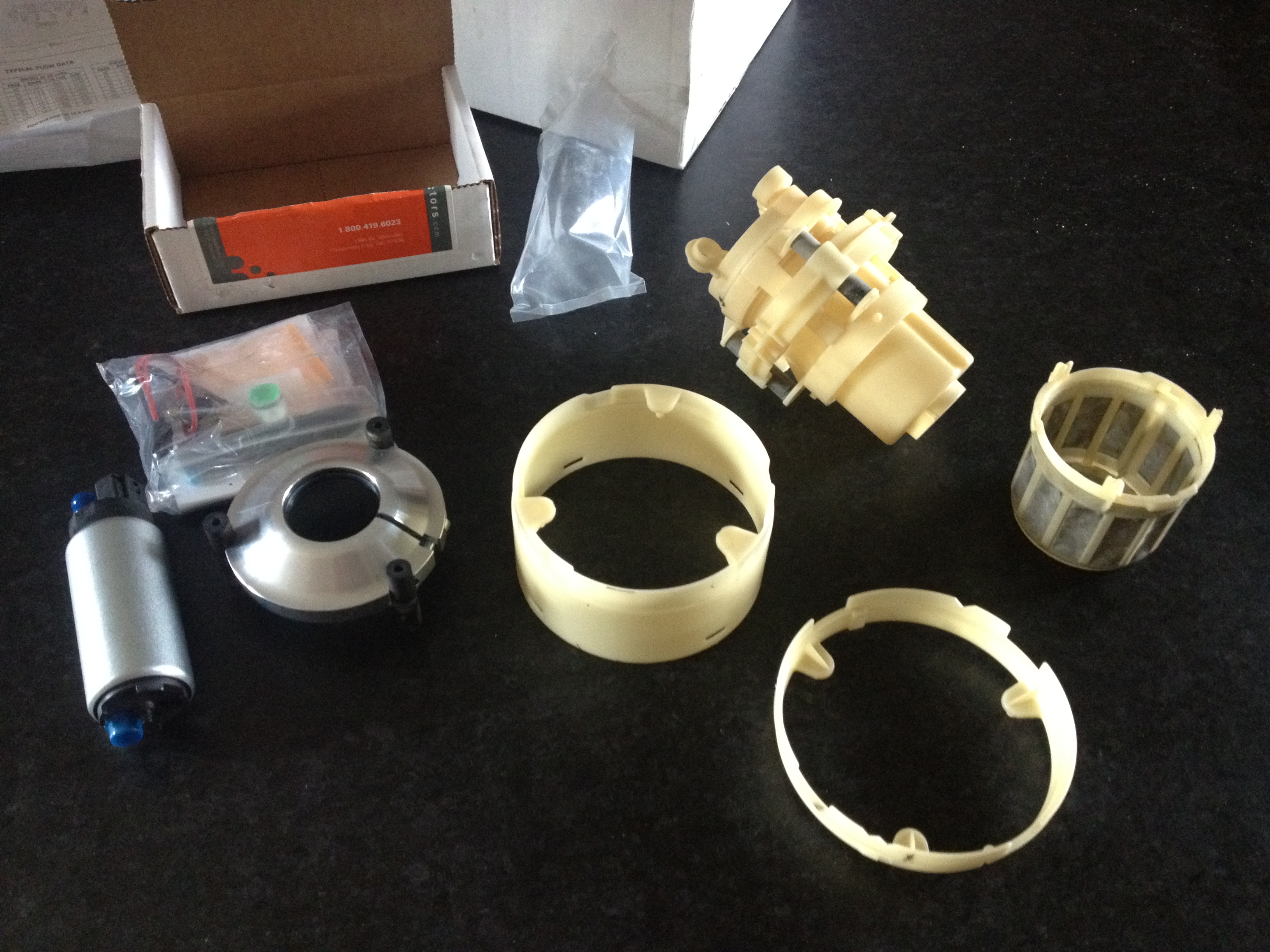

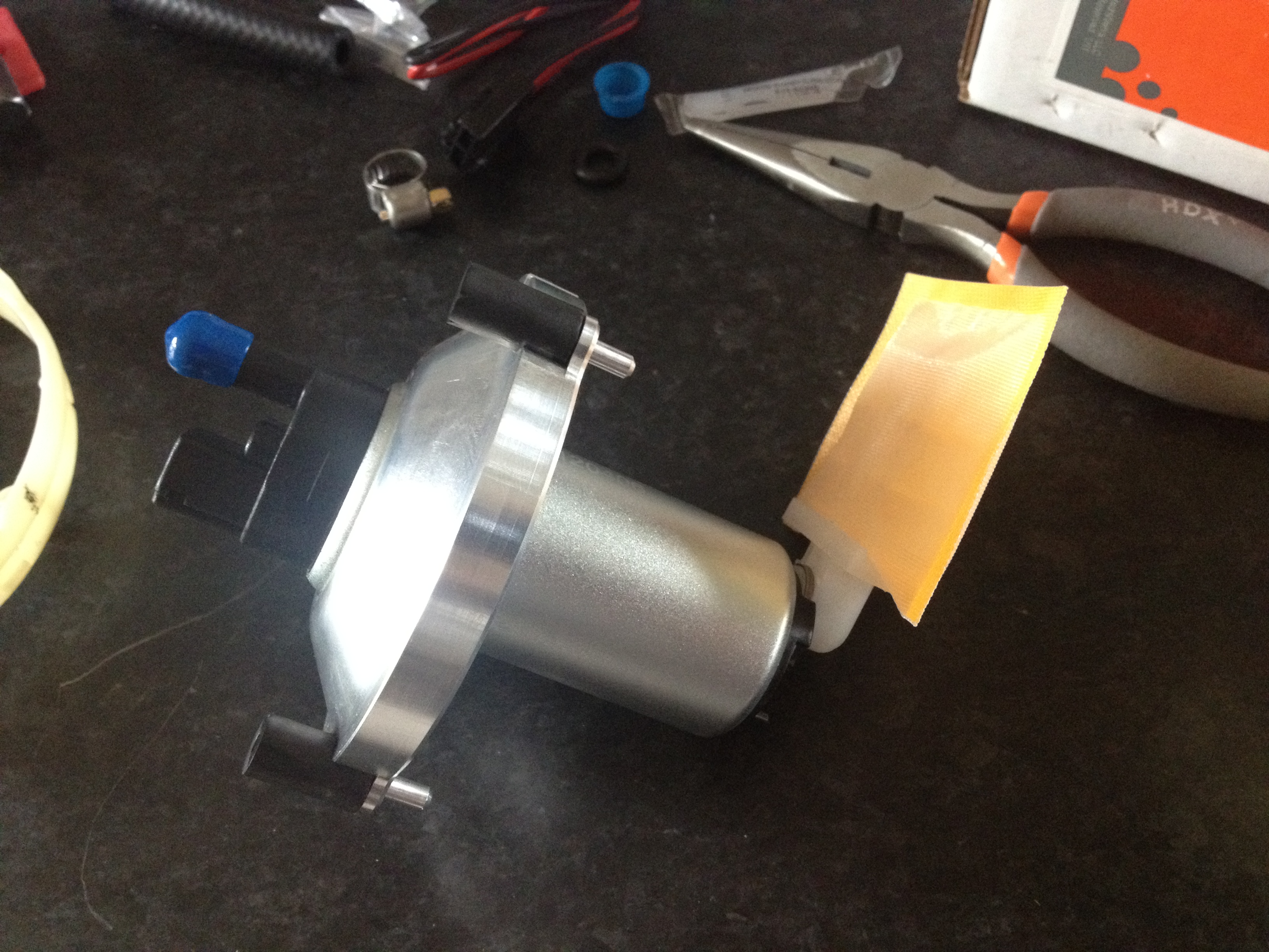

fuel pump and some wiring
Sebastian's CQ91' fuel pump setup.JPG (2.3 MiB) Viewed 42160 times
Sebastian's CQ91' fuel pump setup 3.JPG (2.39 MiB) Viewed 42160 times
Sebastian's CQ91' fuel pump setup 2.jpg (2.3 MiB) Viewed 42160 times

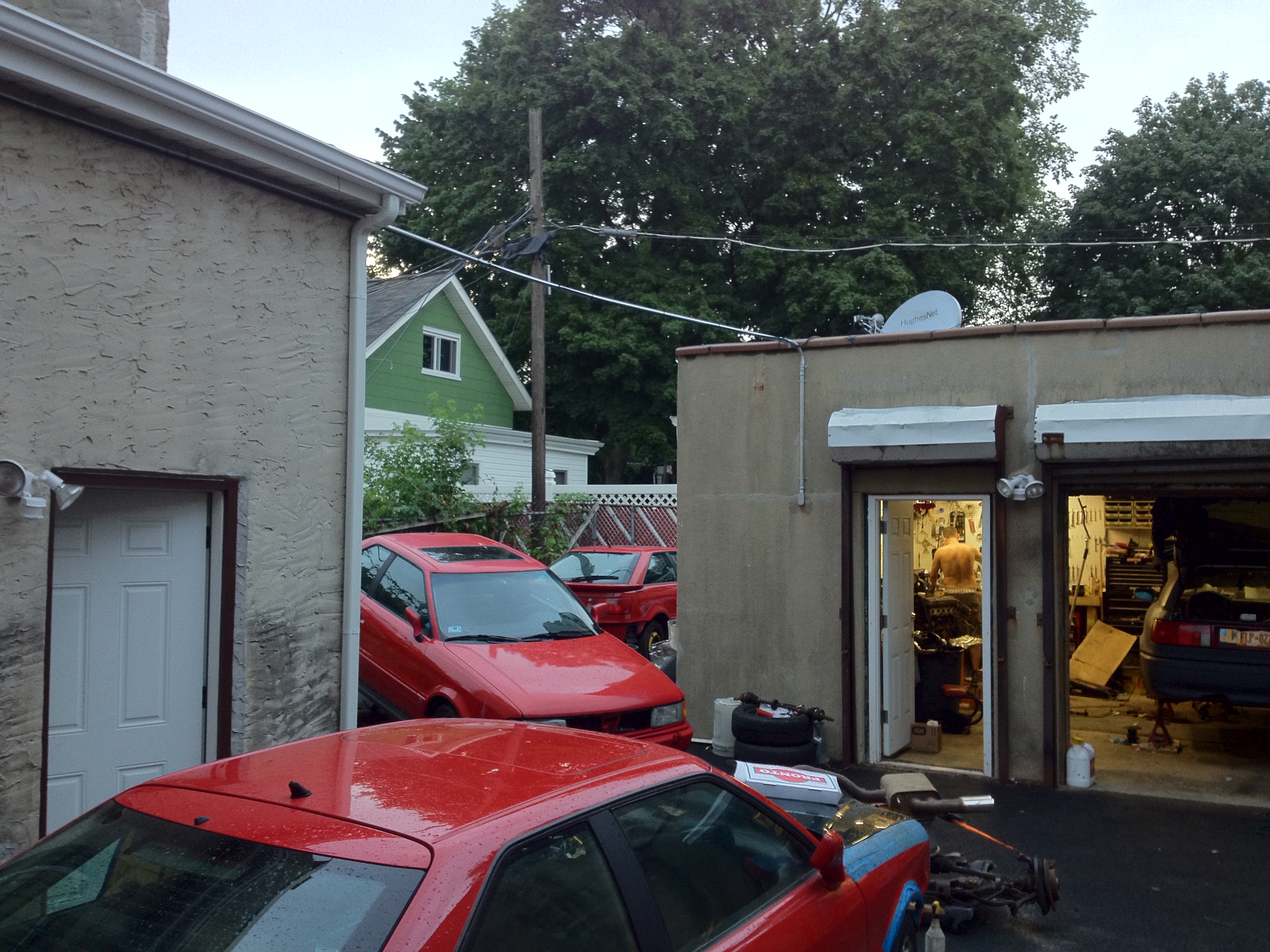

Our old shop (Mine and Adams) with two of my coupes far left, Danny's coupe with the blue tape and black primed Adam's full S2 built coupe inside.
Sebastian's CQ91' old shop with coupes 2.JPG (2.62 MiB) Viewed 42159 times

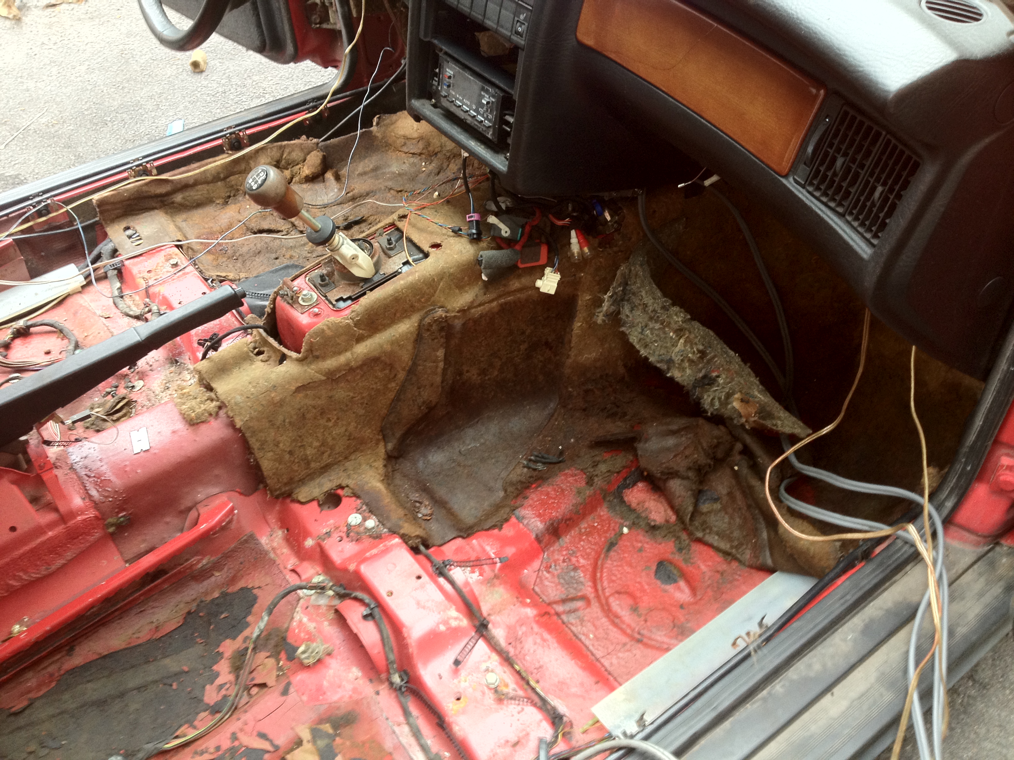

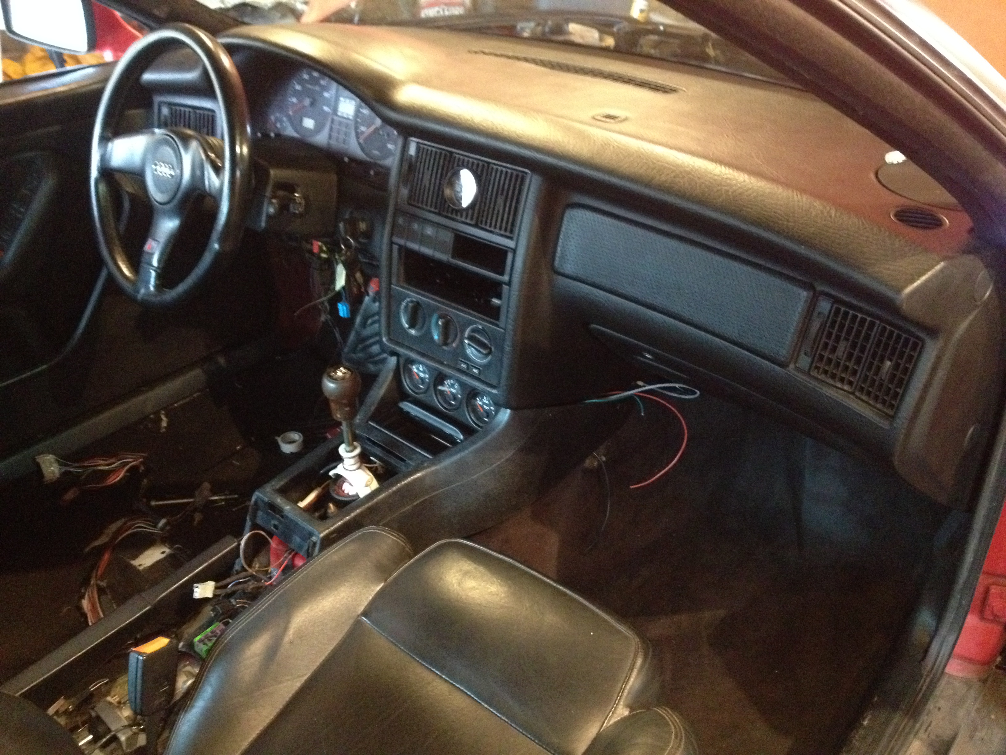

the whole interior got stripped of old heavy sound proofing and carpet under mat.
Sebastian's CQ91' interior strip down 3.JPG (2.83 MiB) Viewed 42159 times
Sebastian's CQ91' interior prep 1.JPG (2.86 MiB) Viewed 42159 times
Sebastian's CQ91' interior strip 2.JPG (2.83 MiB) Viewed 42159 times

Post by Zaworek »

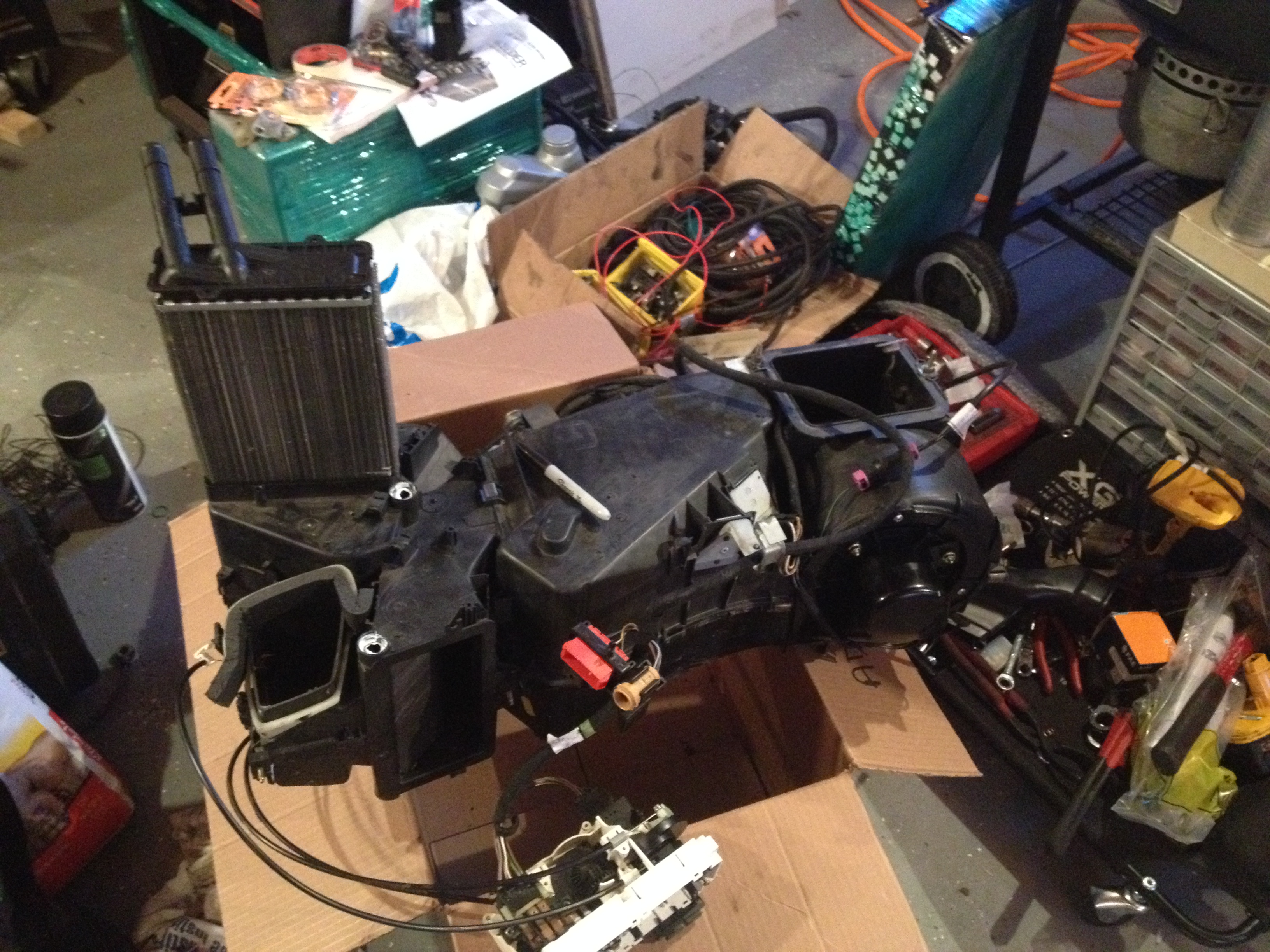

b4 manual climate control rebuild with new flapers and all black dash black leather trim also all old unused stock harness was cut out.
Sebastian's CQ91' manual box swap.jpg (2.15 MiB) Viewed 42158 times
Sebastian's CQ91' wiring 2.JPG (2.58 MiB) Viewed 42158 times
Sebastian's CQ91' dash .jpg (2.76 MiB) Viewed 42158 times
Sebastian's CQ91' interior black out.JPG (2.34 MiB) Viewed 42158 times

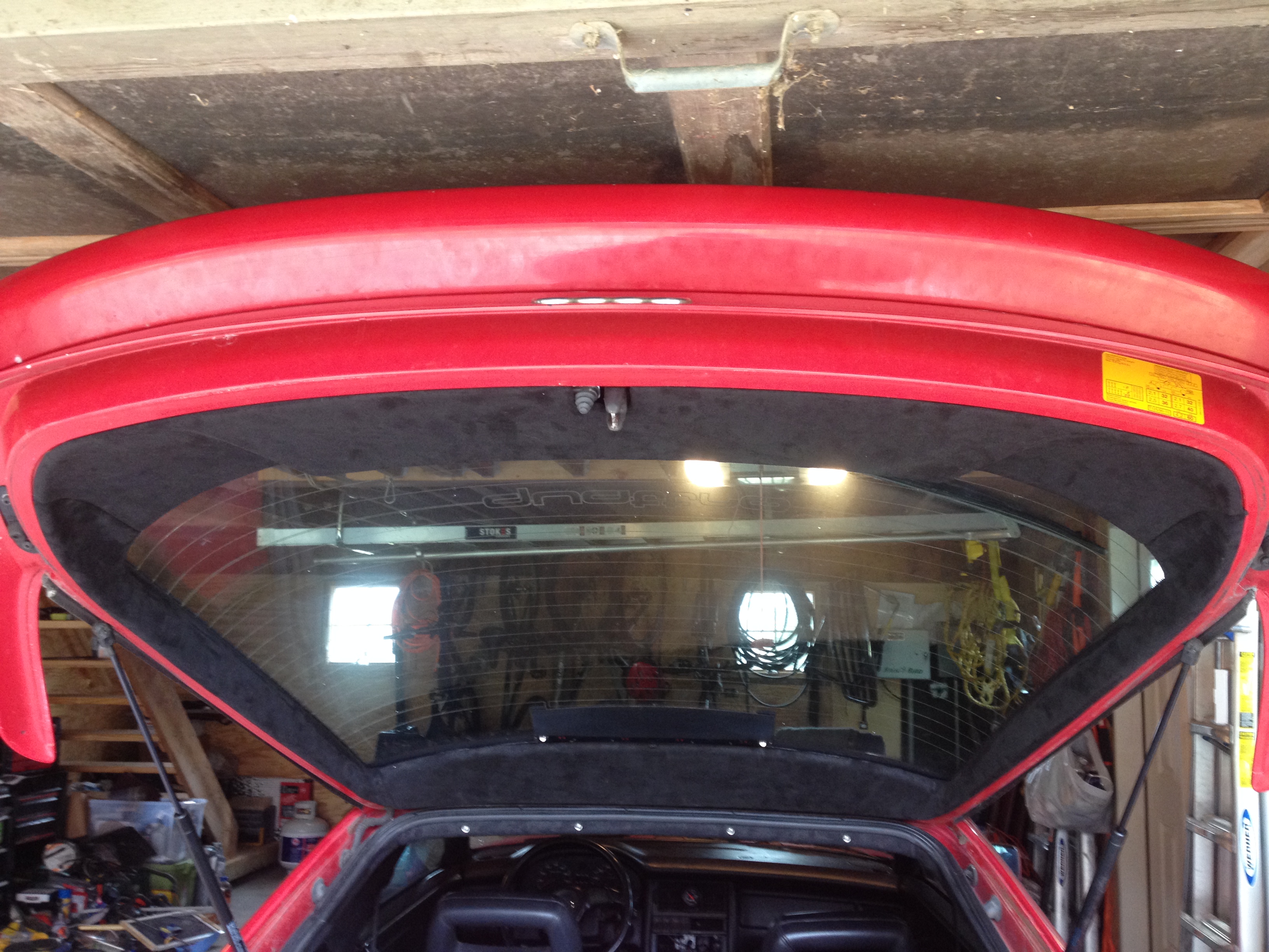

Post by Zaworek »
here is the upper trim of the interior that i have done in black suede it took two days to wrap it, my fiancee took snapped a picture of the material being applied
Sebastian's CQ91' suede hard labor.jpg (2.62 MiB) Viewed 42155 times
Sebastian's CQ91' suede complete uppper trim.JPG (2.65 MiB) Viewed 42155 times
Sebastian's CQ91' suede interior 2.JPG (1.95 MiB) Viewed 42155 times
Sebastian's CQ91' suede trunk.JPG (2.26 MiB) Viewed 42155 times
Sebastian's CQ91' suede headliner 1.JPG (2.62 MiB) Viewed 42155 times

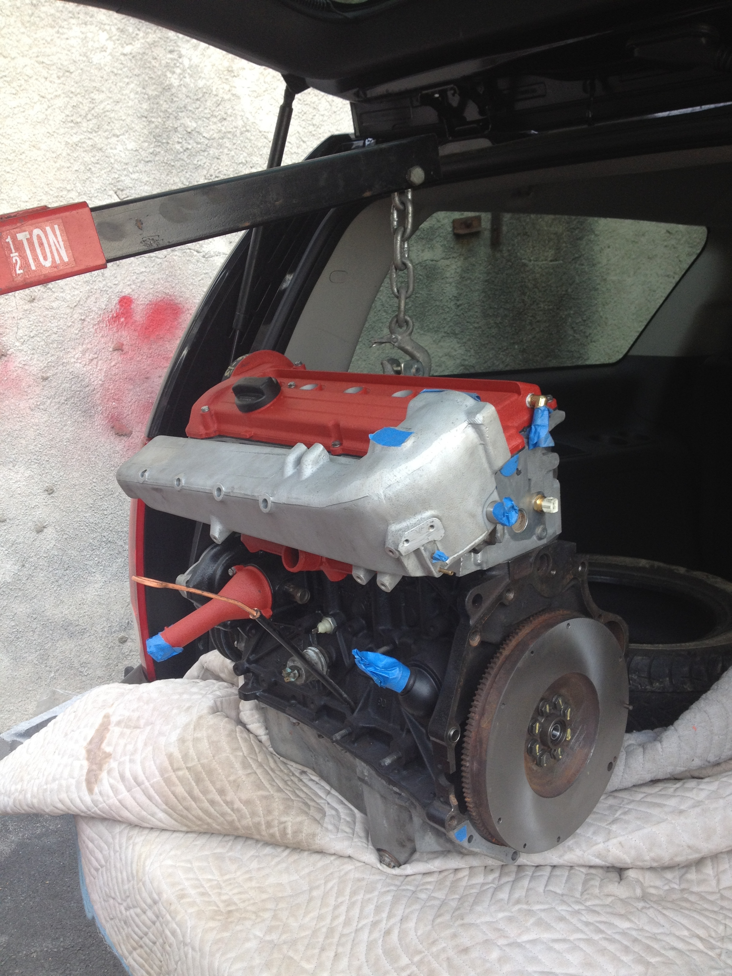

Post by Zaworek »

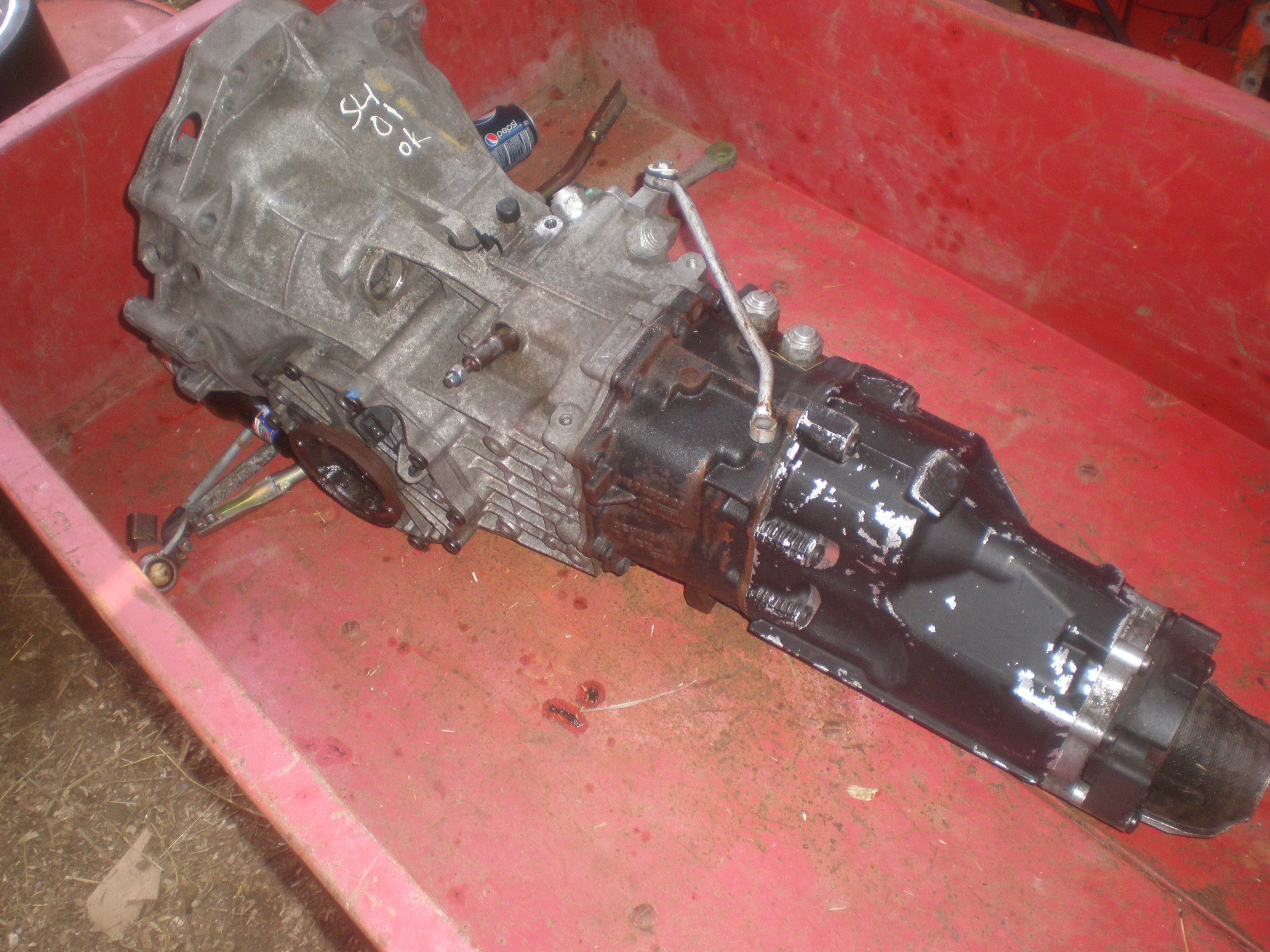

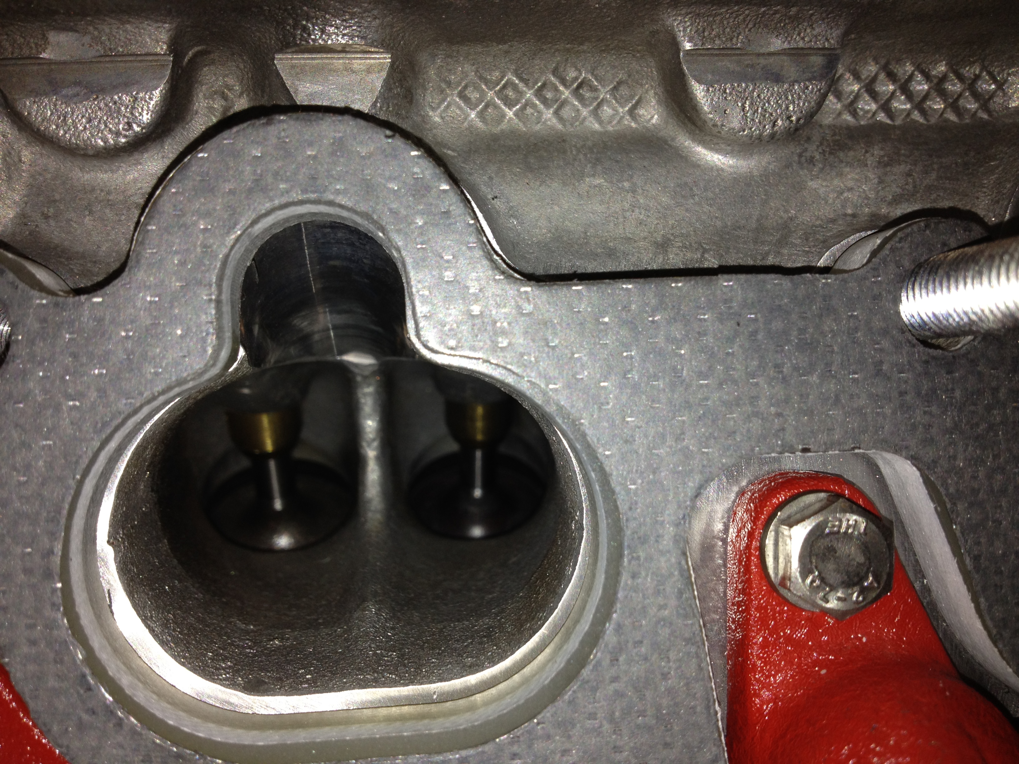

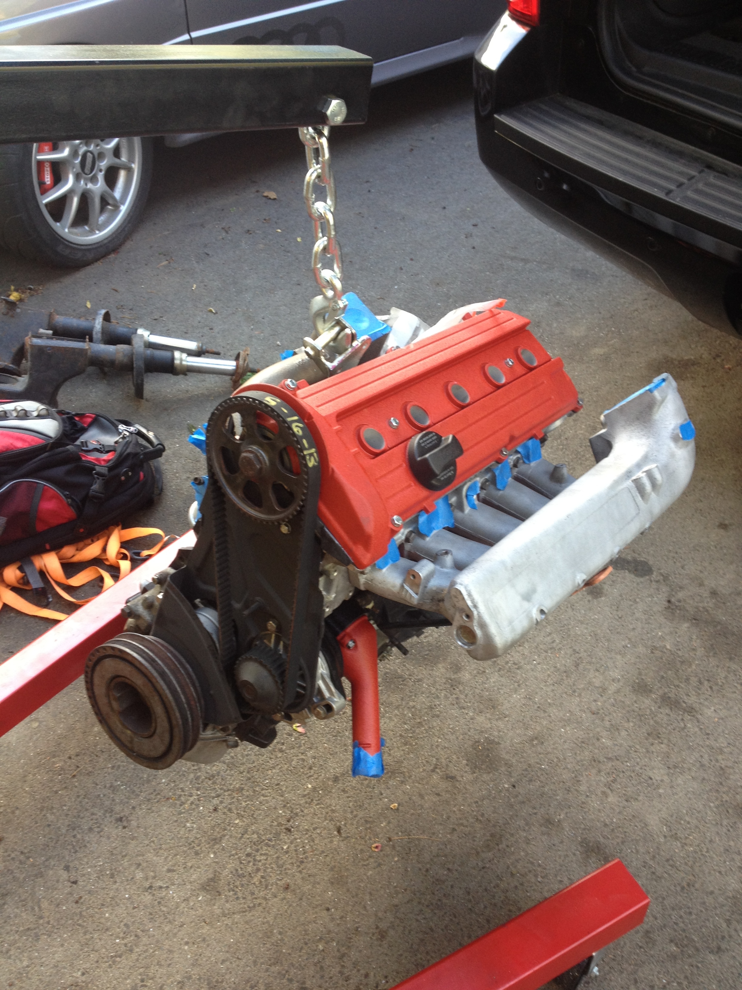

motor back at the garage and ready for further assembly along with 01e 6 speed from Dana here are some random shoots
the motor here is still with the rs2 exhaust manifold which was later upgraded to the Wagner Sport exhaust manifold.
Sebastian's CQ91' engine head valves.JPG (2.83 MiB) Viewed 42061 times
Sebastian's CQ91' engine carbon.jpg (2.86 MiB) Viewed 42061 times
Sebastian's CQ91' carbon parts 1.jpg (3.4 MiB) Viewed 42061 times
Sebastian's CQ91' 01e 6 speed.JPG (1.61 MiB) Viewed 42061 times
Sebastian's CQ91' motor and tranny stored.JPG (3.06 MiB) Viewed 42061 times

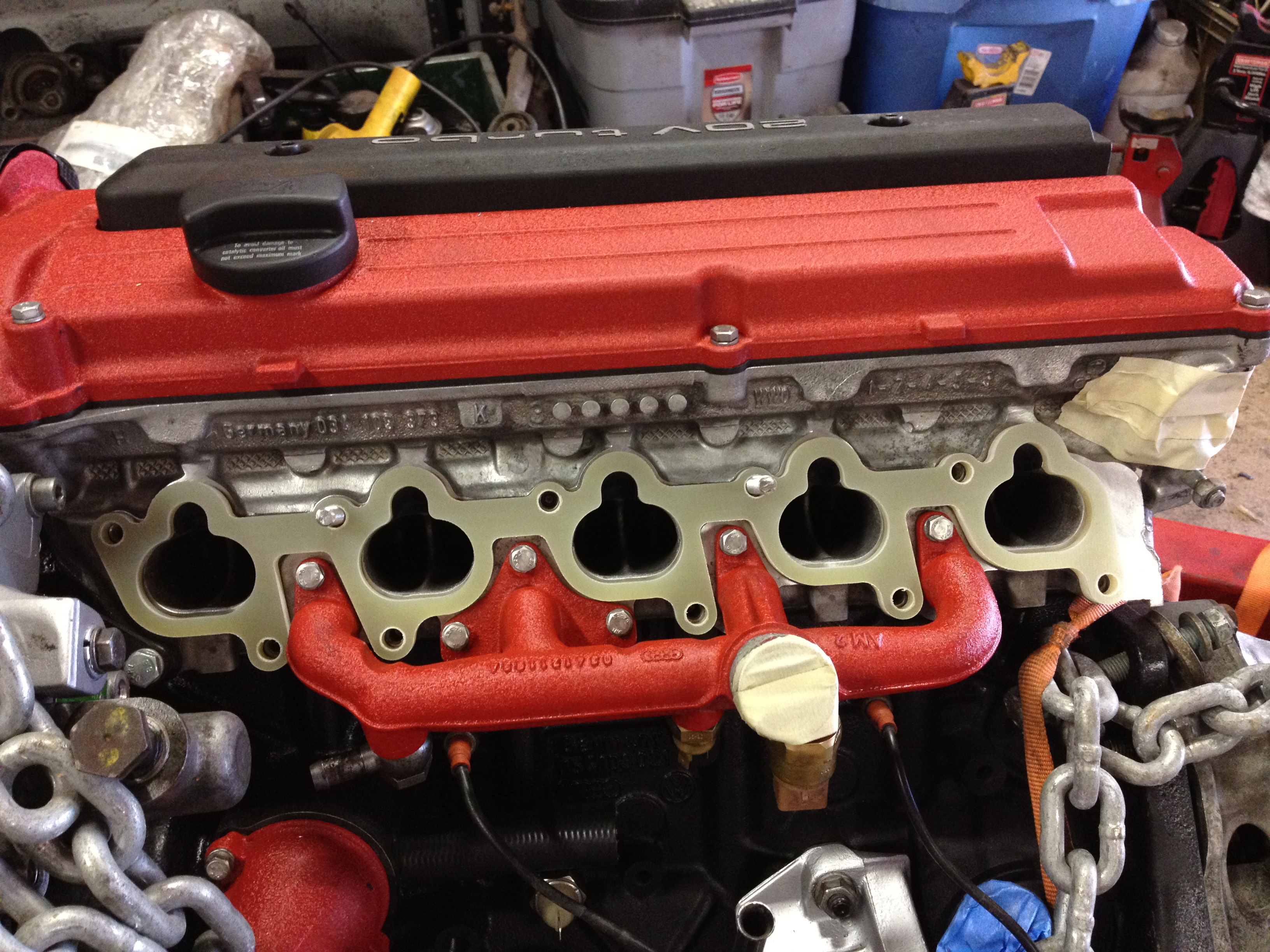

some red wrinkle powder coat with some carbon fiber trim
Sebastian's CQ91'engine random shoot 9.JPG (2.64 MiB) Viewed 42059 times
Sebastian's CQ91' engine random shoot 6.JPG (2.75 MiB) Viewed 42059 times
Sebastian's CQ91' engine carbon 2.jpg (2.44 MiB) Viewed 42059 times
- Sebastian -
