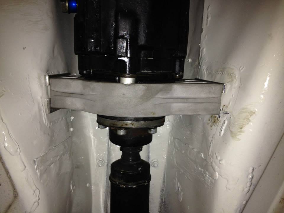

The fluid line is in place of a cooler I think. I just bypassed it by running a -6. The tie rod is for bigger down pipe clearance so they say. But I’m gonna find out. I’m getting a 01E rear mount from AK Motorsports soon. Let’s see how big of a task it will be to install. Anyone ever seen this?

Posted: Sun Dec 17, 2017 11:12 pm
by the german
rennenmsports wrote:
Tell me about this brace on the back of the transmission...
Re: Andy's 91' 80q
Posted: Mon Dec 18, 2017 5:23 am
by rennenmsports
Thank you! I had to make a bracket to hold the factory 80q power steering pump where I wanted it. The brace on the back of the transmission is made by AK Motorsports that is designed to eliminate the factory transmission mounts to run a bigger exhaust but I’m using it in conjunction with them to make it even stronger. We will see soon enough. Thats about next on my list.

Posted: Mon Dec 18, 2017 3:23 pm
by the german
rennenmsports wrote:The brace on the back of the transmission is made by AK Motorsports that is designed to eliminate the factory transmission mounts to run a bigger exhaust but I’m using it in conjunction with them to make it even stronger. We will see soon enough. Thats about next on my list.
Interesting, thank you!

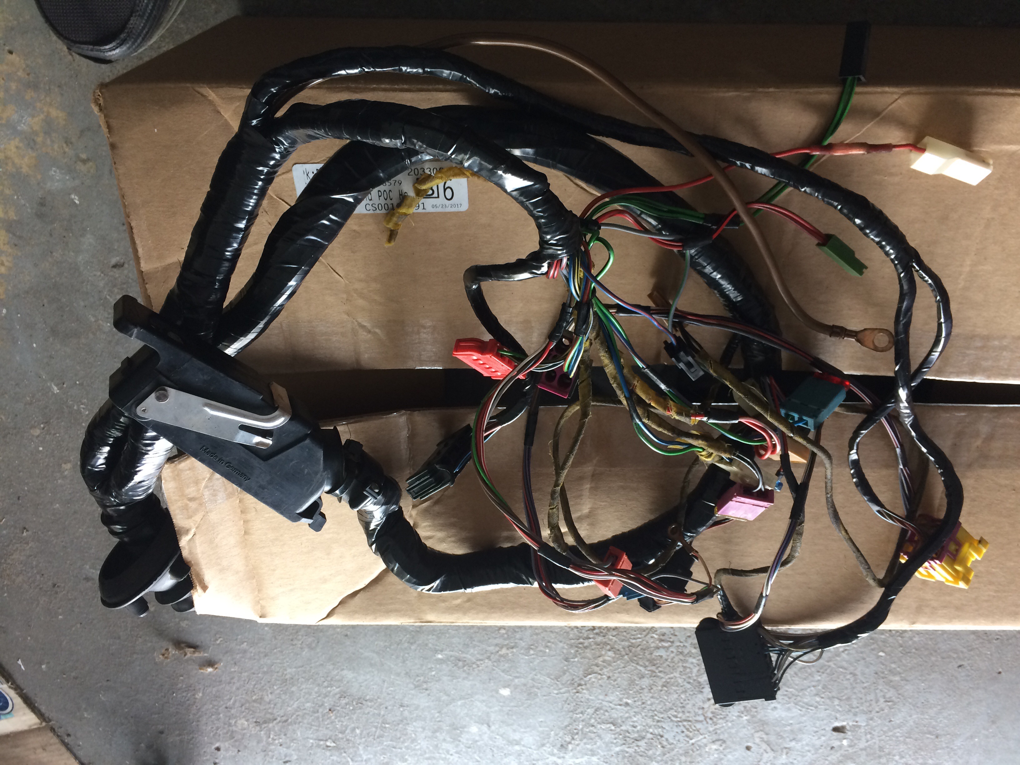

Anyone know what the green connector is for under the drivers dash? The right side of the connector goes through the firewall in its own rubber grommet where I cut and tapped up the wires in the engine compartment about a decade ago when I was drinking. I think it’s air conditioning but I’m not %100 sure. It may be airbag but I thought those were mandated yellow

by A1QSHIP
Definitely a/c. No connections thru the fire wall for any electrical components of the airbag system.

ABY harness ready to be stuffed through the firewall

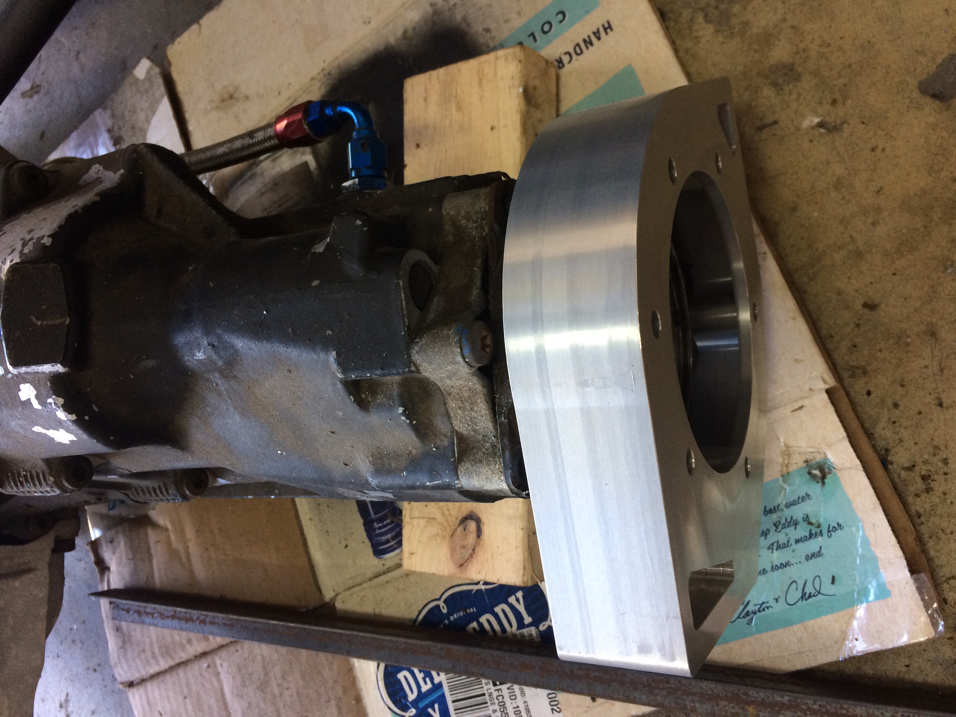

Posted: Sun Dec 24, 2017 11:59 pm
by rennenmsports
A nice piece of aluminum! Merry Christmas!

Any idea what happens when u take the 6 bolts off the back of an 01E? It appears to be spring loaded.
