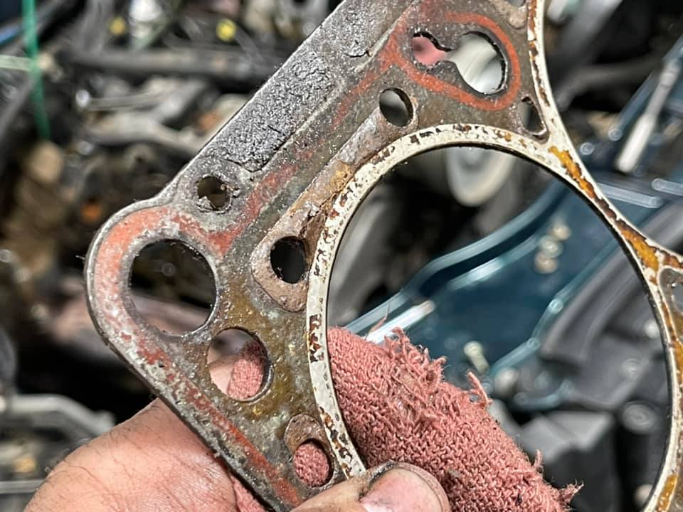

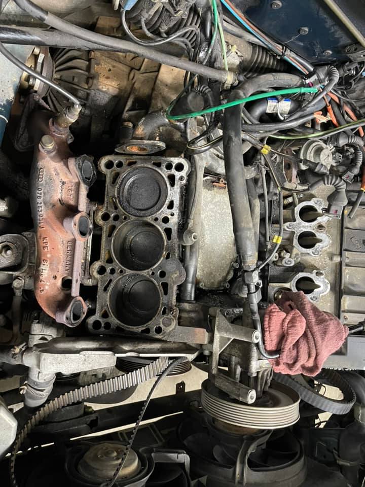

We ordered new brakes all around along with new CV's as the boots were tearing. Life was good with AYeet v2, until one night driving around town when the coolant warning light came on. I checked the level and it was fine, so I started digging on the forums for normal causes. Number 1 was a new coolant reservoir and sensor, nothing changed. We just continued to drive it thinking it was something with the circuit. Eventually steam started coming from the cowl, had the heater core just let go? The coolant leak was coming from the heater core outlet. So I ordered up a heater core and new hoses, the blower motor also had the typical squeak so I ordered a new blower as well. We tore it apart the next weekend and changed the core and the blower. I then bled out the cooling system, and air kept coming out of the bleeder on the crossover... and coming... and coming. After about 20 minutes of hissing, I knew something was up. At this point, everything pointed to the dreaded head gasket leak. I started collecting parts, Reinz head gasket set, Meyle head bolts, FCP assembled timing belt kit with the special sprocket holding tool, new Bosch water pump, new valley pan gasket.
block
block
headgasket
headgasket
We had the job done in 2 days worth of work, the exhaust manifold hardware being the worst part of it. All said and done, car running perfect. But wait, there's more.
