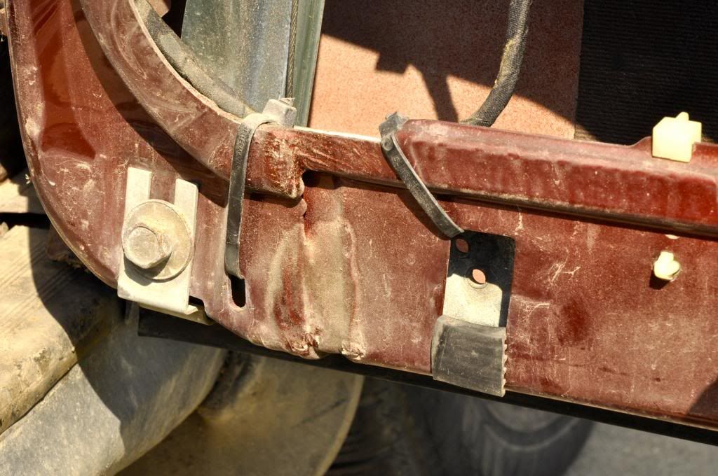

Lower front clip, make sure you pay attention before you remove as to how it goes in. Look up, from underneath to get the full view. Simple, out-in. Don't go full tight the first time to ensure proper alignment.
Take note of the zip ties, and reinstall when replacing the new parts.
