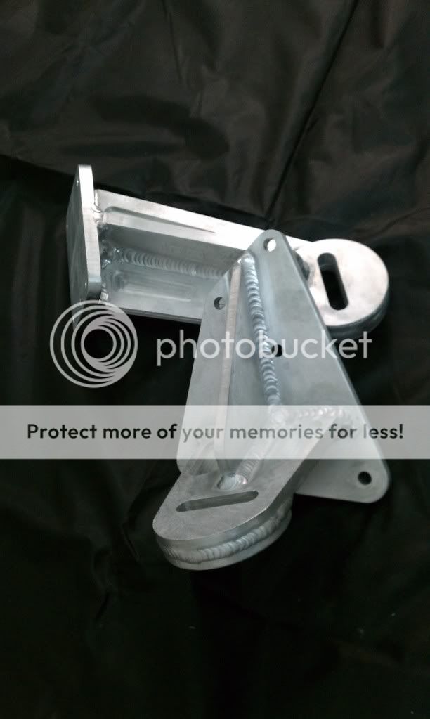

Alright guys, we have passed through the final revision of the 07k motor mounts for the b2/b3/c4/type44/URQ chassis. We have taken out some weight where they didn't need it, and added support where they needed it. These aluminum mounts should take 1000whp worth of abuse and not flex.
Should I anodize or keep them raw?

I prefer the raw however the option for anodizing would be nice.

Annodizing welded parts doesnt come out great. Powdercoat would be a better bet.
They will need some form of coating to stop corrosion but I figure that can be on the end users end of things.

HT Motorsport wrote:Annodizing welded parts doesnt come out great. Powdercoat would be a better bet.
Nice parts as ever Hank
Have you tried different rod Haydn? 4043 is terrible in anodizing apps, but 5356 does a pretty good job. A little more gray on the heat affected zone, but not bad really.

I have Hank, as you say 5356 is Ok, but still never looks as nice as a machined part.
