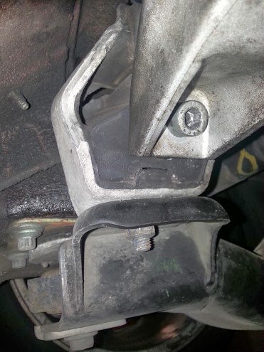

So I think I found the root of the grinding noise i'm getting at low RPM's. I took a look at my transmission mounts and this is what I found....
bad trans mount.jpg (52.88 KiB) Viewed 53760 times
Both sides are completely shot. Luckily was in the seattle area and saw a craigslist ad for a guy selling his 034 track density mounts. I will be installing them tomorrow. Anybody have experience with these? Is the NVH really bad? Either way it will be a huge improvement.

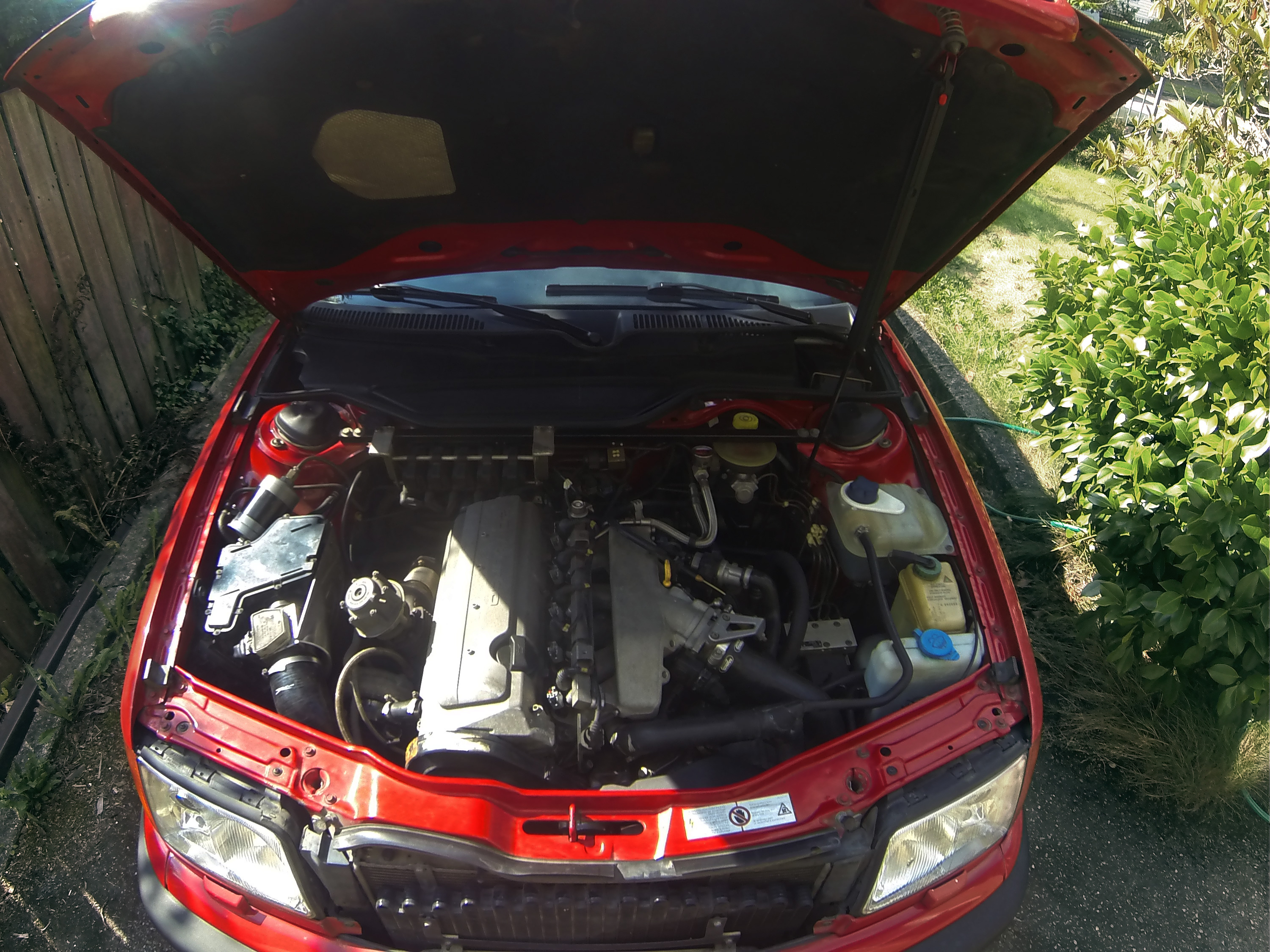

In other news I installed clear corners, messed with building an intake that I think should work, blacked out the grill (not sure if I like it) and played around in the snow. :thumbsup:
Not sure how much I like this intake set up. Looks kinda crappy, but the location of the filter seems good and it sounds great too... :D

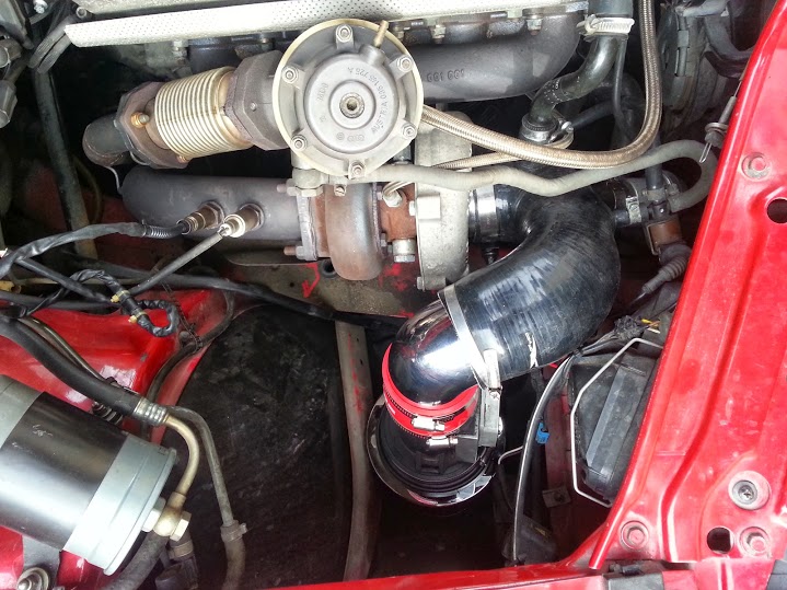

Here's a picture of the fitment with the stock box. As you can see its about to slip off the turbo and the maf.
